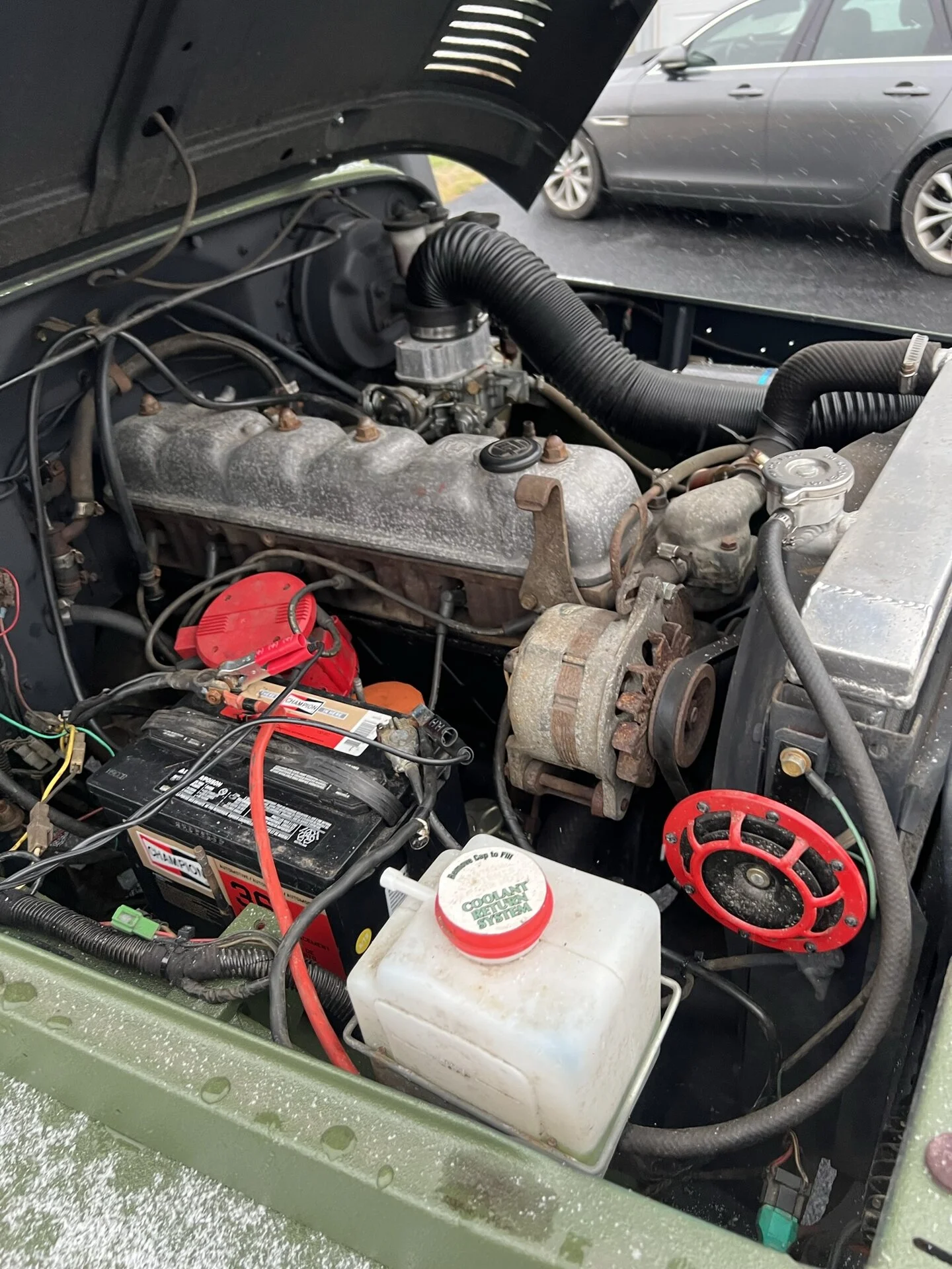

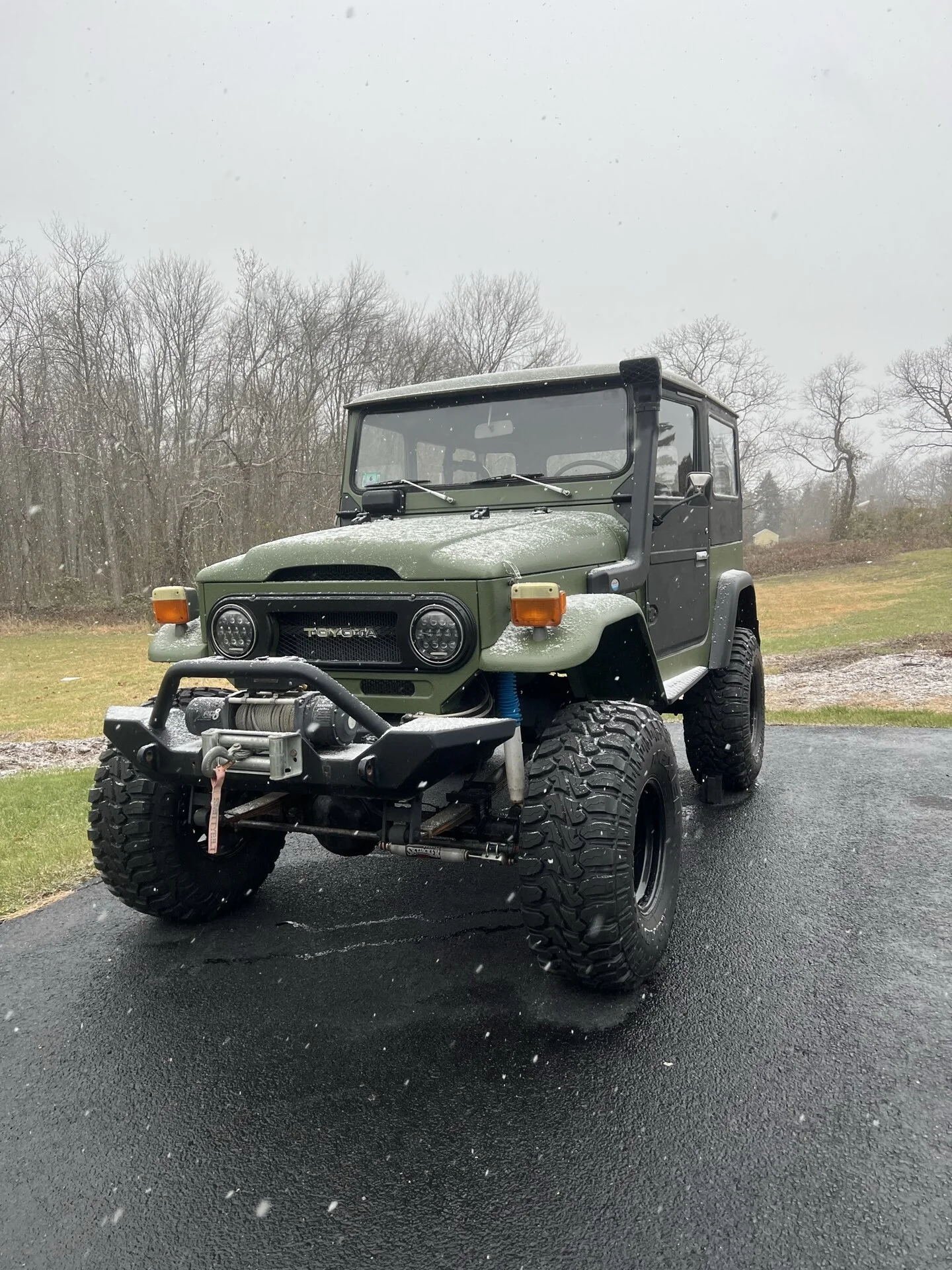

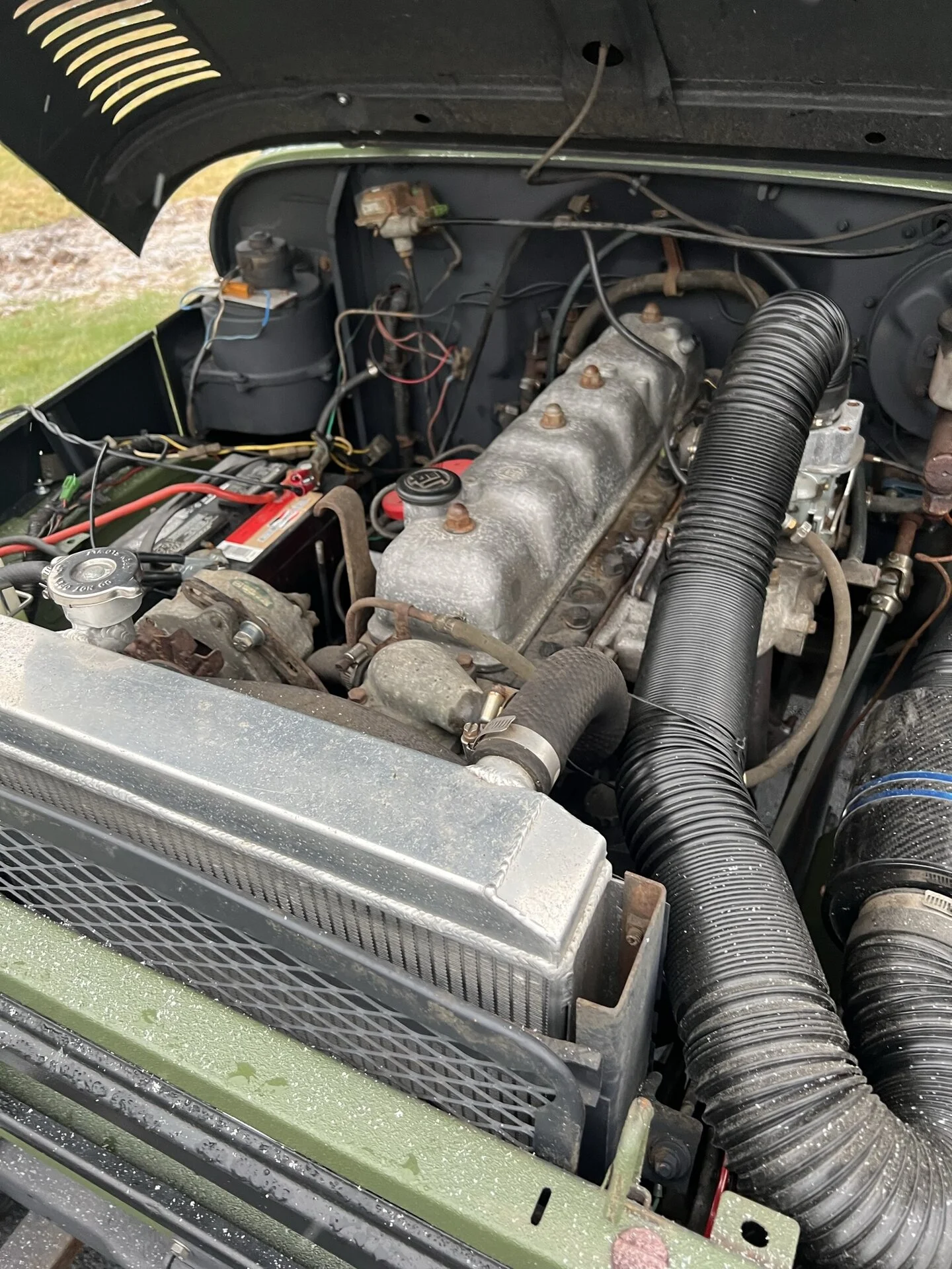

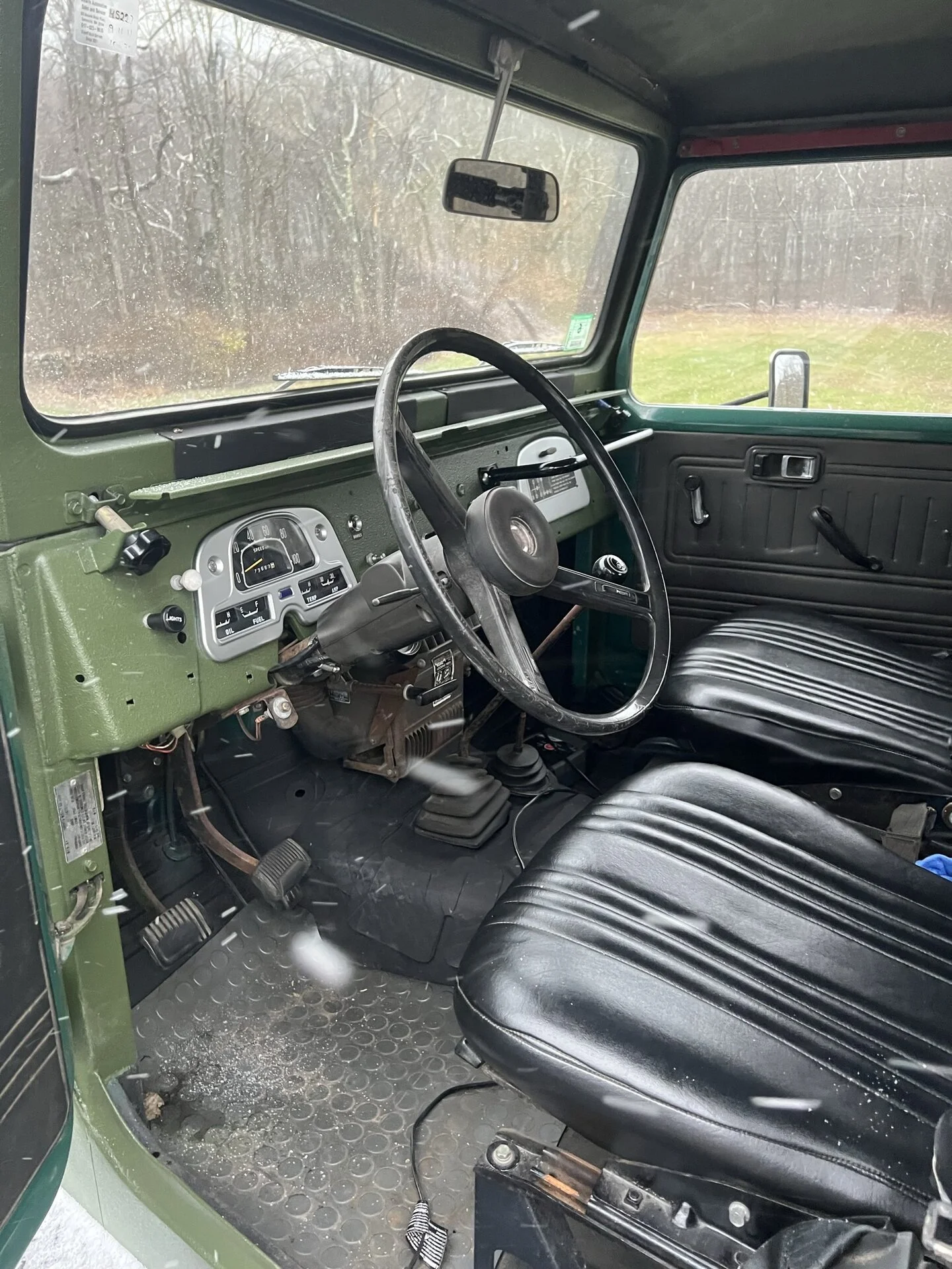

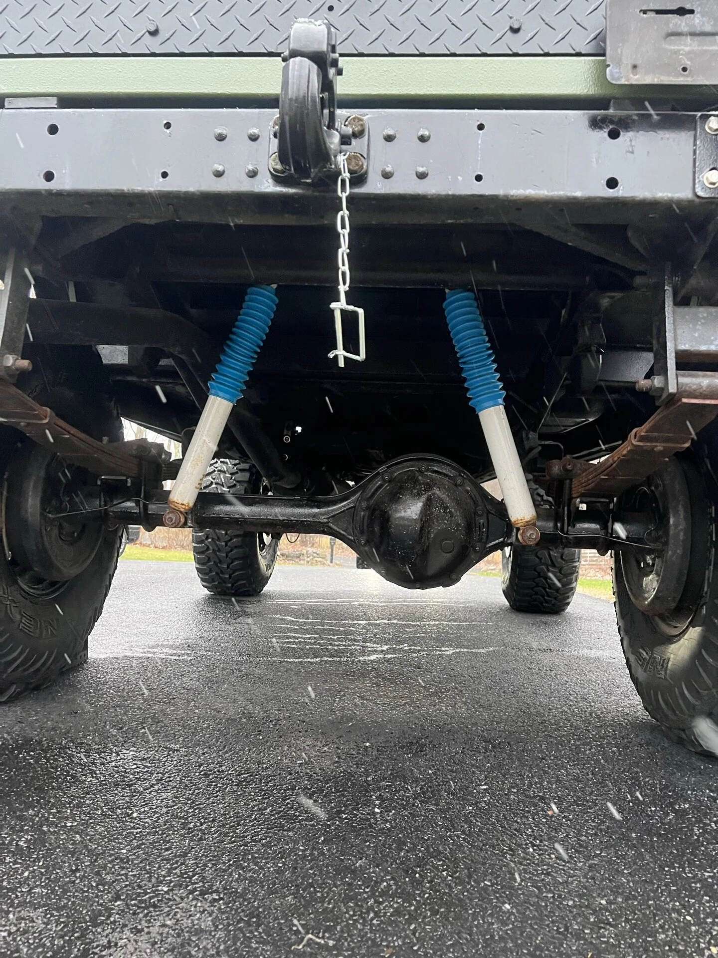

Hey everyone,
Just bought my first ever Toyota. It's a 1975 and makes me happy every time I see it. I wanted to get an idea of anything you all recommend in terms of maintenance/upgrades that are really useful/crucial. I plan on Holley EFI swapping, cutting that snorkel length and fixing manifold gasket leaks first!
Appreciate any input!
Only let me upload 5 pictures, here's the imgur album link:

looks in good shape! i also would drive it. maybe get an OEM carb and air cleaner assy.:cheers:
Drive It is what I'd do!
Maybe down the road some new suspension to improve the ride, those springs look a little tired
For a spring over, you want them relatively flat. Keeps the center of gravity lower and better ride.

Consider upgrading your knuckle steering arms to move the tie rod above the springs. Especially if you plan to wheel on rock and boulder infested trails.
Looks pretty good. Immediately, something to hold down the battery. Driving and stopping well. Base line it, check or change fluids, check brakes and such. Look for upper and lower dash pads. Most importantly have fun. I'd be curious to see how the steering links are from the box to the knuckles.
Looks like defrost vents are blocked off🤔

What distributor is that? (Cant tell from the photos)
I would recommend verifying the make/model of the disty to make sure its correct for a 2F.
Some folks buy cruisers that have a disty for a chevy I-6 engine, the drive gear on the disty isnt *exactly" the same and the disty can get pushed up and disengage from the oil pump, which completely genades the engine!
I bought mine with an incorrect disty and was lucky that nothing was damaged. Swapped it out for an electronic trollhole disty.
Nice looking ride! If you're talking about the length of the snorkel, leave the exterior parts alone and only shorten what is under the hood. A little cleaning is all that I would do other than address maintenance items.
Not planning on going on any crazy trails right now, just getting into the overland/off-road scene, but I will take a look at upgrading the steering arms.
Some HEI, I've heard this happen before, someone on FB told me about their locking experience with their distributor not engaging correctly. Previous owner had driven around with this distributor for a while I am assuming its okay but I will have to do a bit more research.
Just the inside, the tubing is crazy. Outside is perfect length. TLC is the name of the game!
Very nice find!! I’d like more info on that snorkel setup! What’s leaking?
Exhaust leak, I think something is warped, theres a lot of gasket sealer.

I would paint that bezel white first thing. Then I’d sit back and admire the rig while I made a list of the recommendations above.
