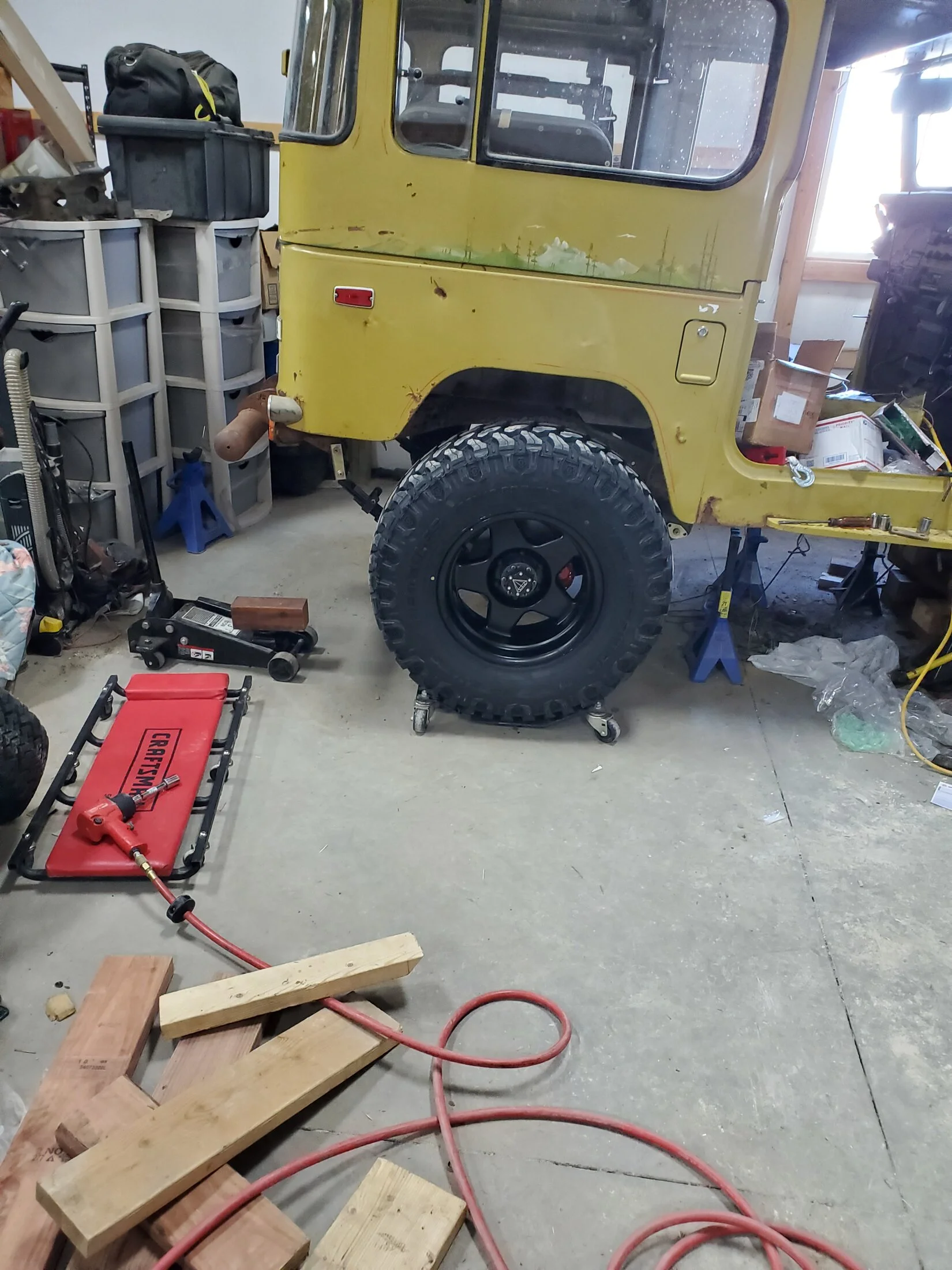

At my age and level of fitness I am resorting to using a shovel to lift my 35X12R17s back on to the hubs of my 40 series Land Cruiser with a 4" suspension lift. This method works good in the shop but have not tested it in the field.

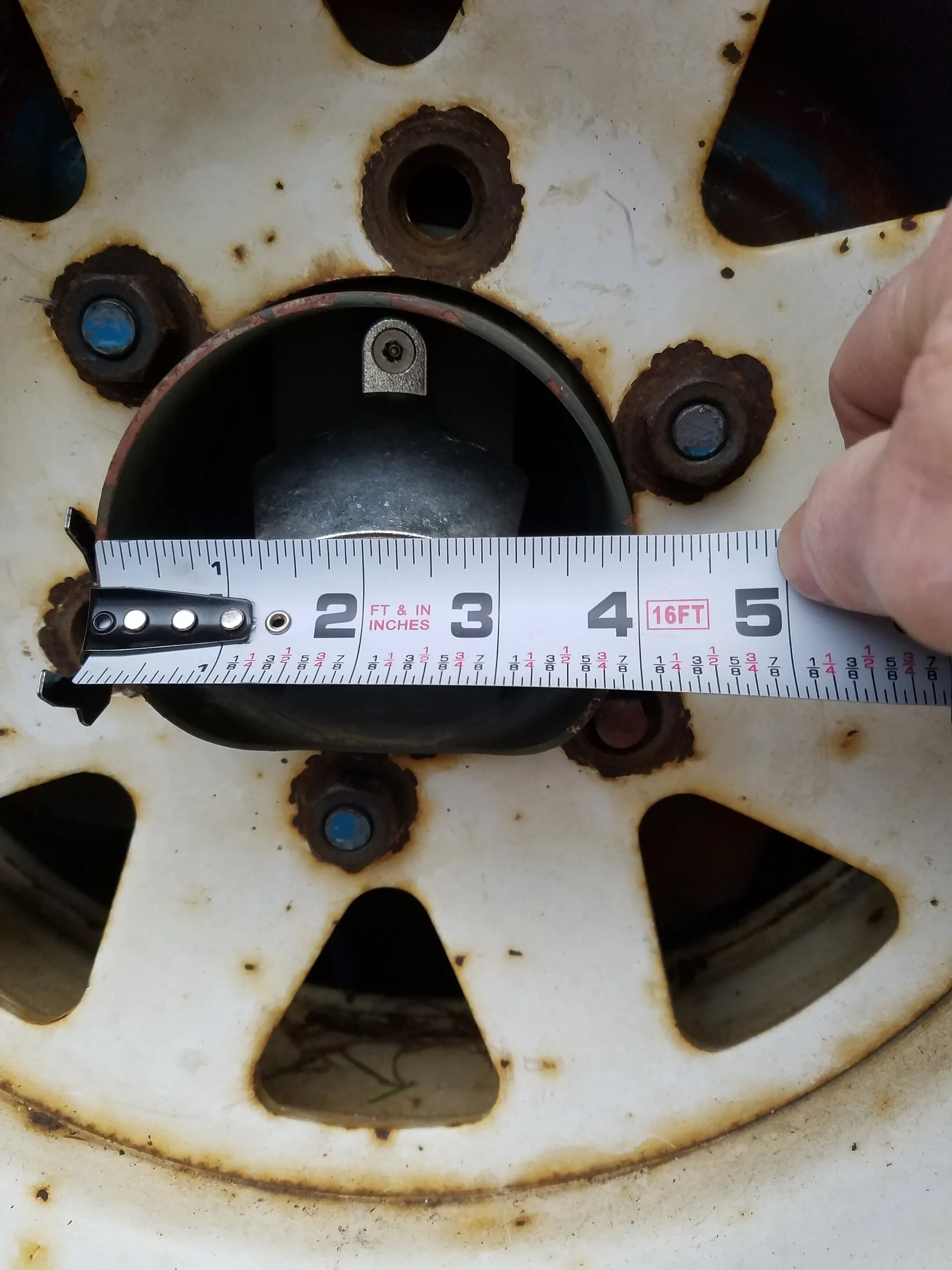

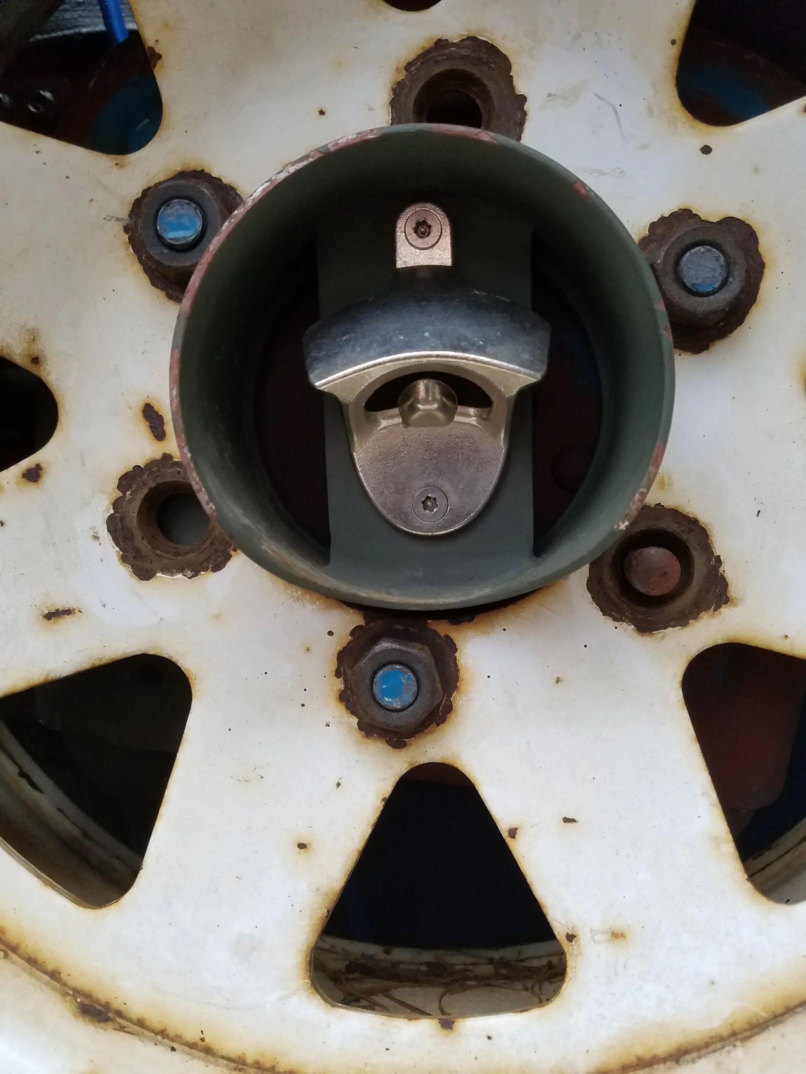

I have the same problem as you. I'm a geezer and its difficult lifting a 35 inch x 12 inch tire and placing it over the three lugs of the carrier. I can't solve the lifting problem, but I made it easier to get it on the carrier once lifted. It's always been relatively easy to get a wheel on the front hub, so I made a part to simulate the front hub on the carrier. It's just a piece of 4" diameter pipe welded to a flat piece of steel, and the flat steel plate is drilled to mount over the lugs on the carrier. It's held in place by a tinnerman nut on one or two lugs. So, I just have to heft the tire up to the mount and it is pretty simple to place it onto the fake hub. Then I can rotate the wheel until it lines up with the lugs. I eventually modified it to include a bottle opener, since there was some extra real estate there. It all works pretty well.

My problem is not that I can lift the tire and rim and move it where I want. But with the lift and being on the floor or ground I don't have the strength anymore to get it up on the hub. But a sleaver bar makes all the difference to get it up on the hub
