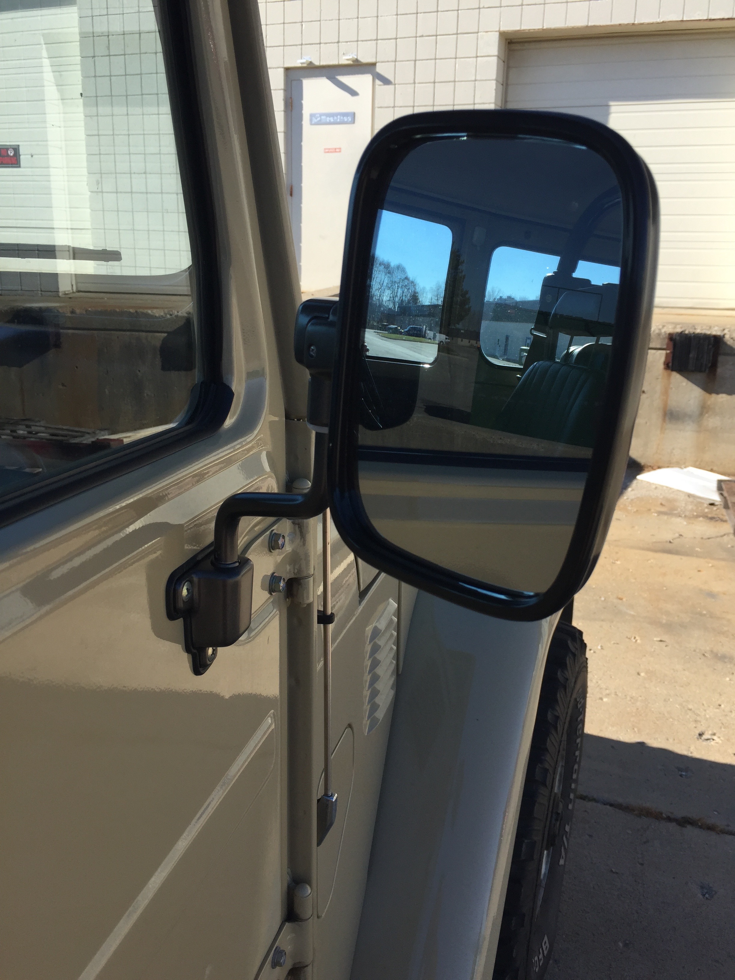

Replaced my floppy annoying mirrors with new ones from Racer65. I was surprised that both mirrors are wide view rather than the usual wide view on the passenger side and normal view on the drivers side but I am sure after some adjustment it will be fine to have a wide view on the driver side as well. They really look nice.

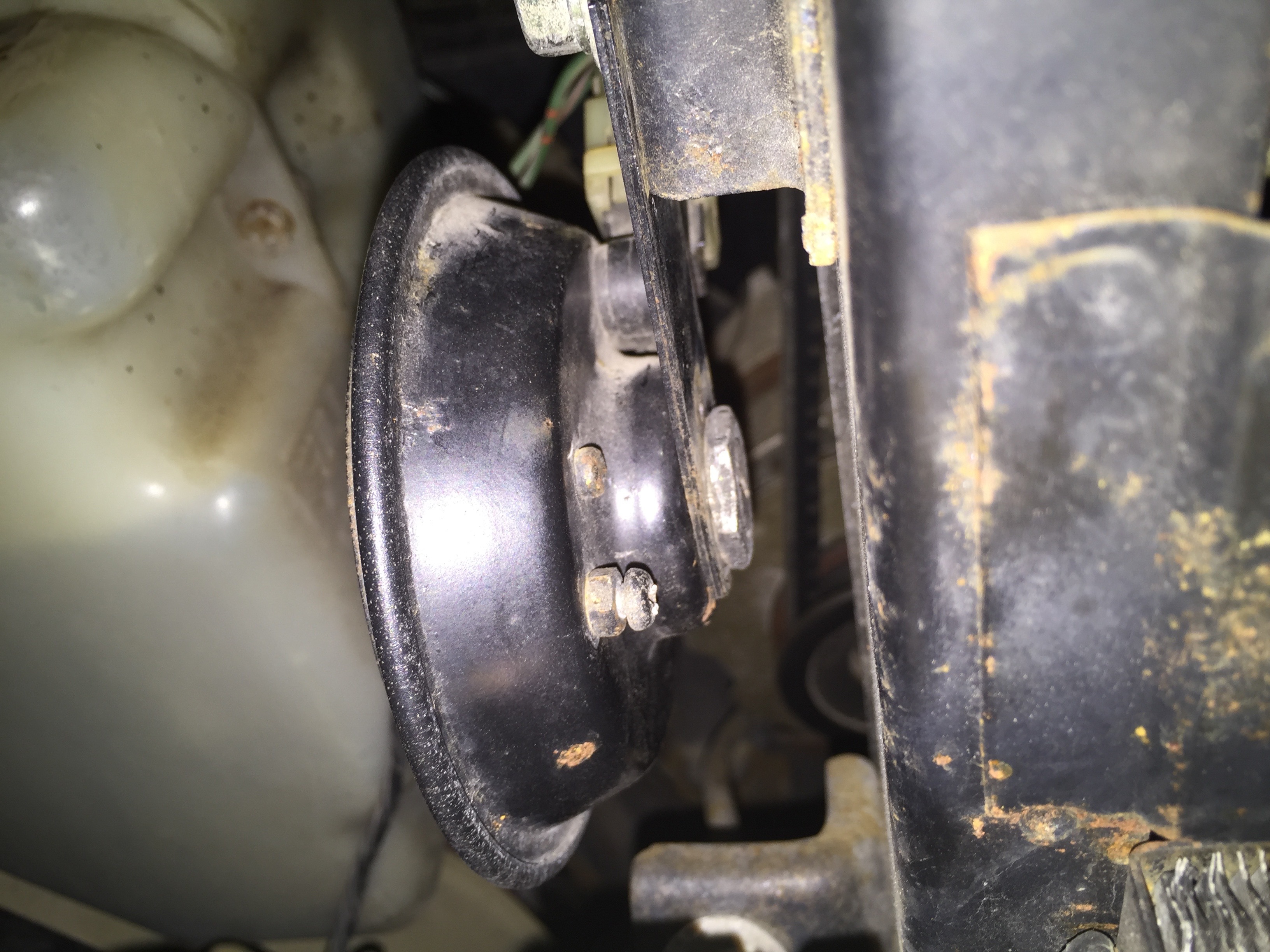

For the nearly 16 years that I've owned my truck the horn has been really anemic. The last time I used it I was embarrassed that I even bothered, it was hardly audible to the person I was was honking at and turned heads on the sidewalk from people wondering "what is that lame buzzing noise?" So, I bought the Harbor Freight horns that get generally good reviews, seem to be loud, and certainly cheap ($8) and went to install them today. After taking off one of my factory horns I was surprised how well made they seemed to be and got to wondering what the various screws I see did. Turns out they are tunable, yea. I turned out the center back screw that sets the depth of the magnet and also turned in the little adjustment screw (see pic) on the back that does, well, adjusting... They are 10 times louder than they've ever been! They are now as loud or louder than the HF horns and while a little higher pitched are still attention getting! Very much easier than mounting and bodge-wiring the HF ones!

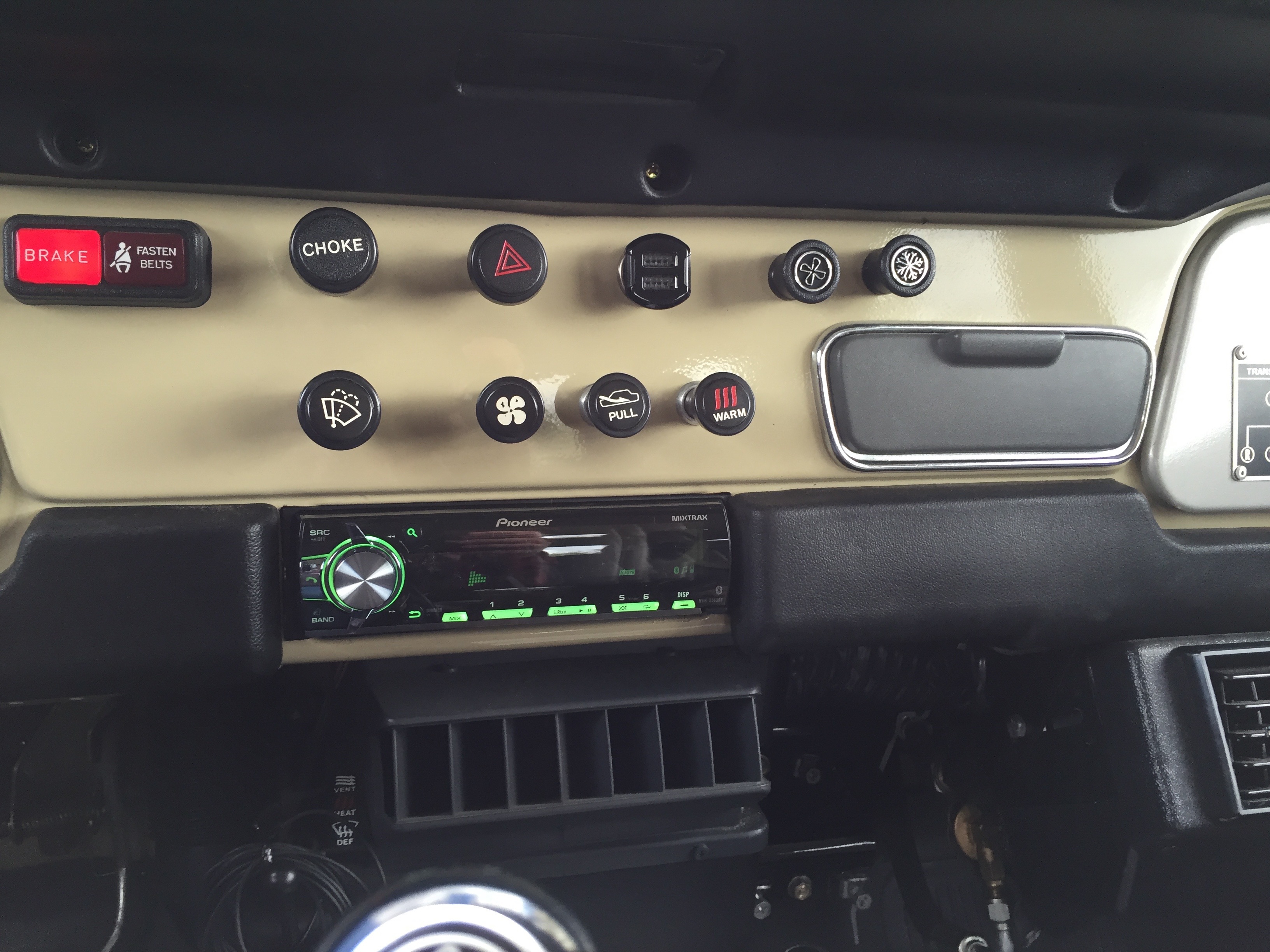

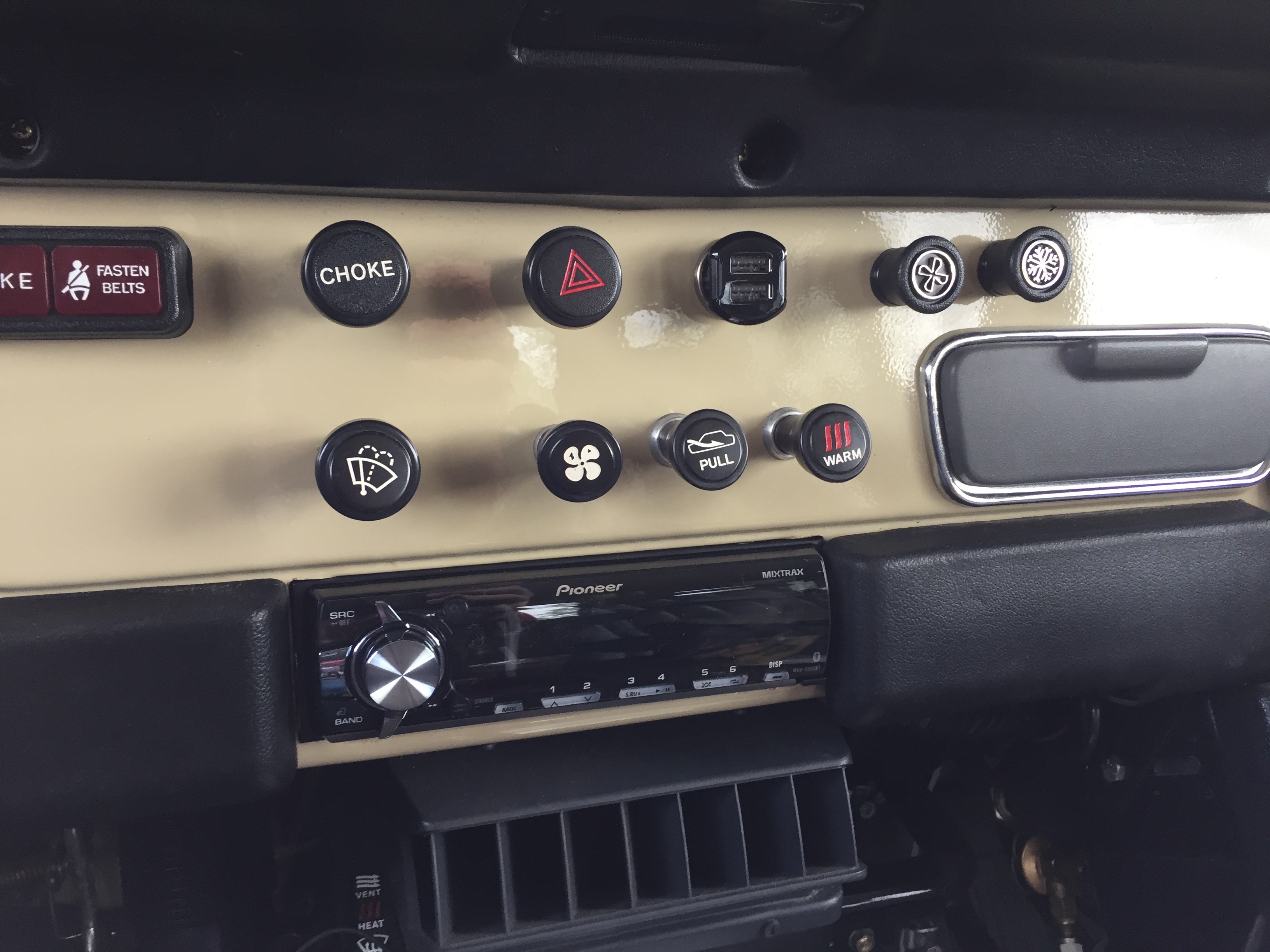

Not this week, but a few weeks ago I got around to getting some tunes into my fj40. My radio only worked intermittently and the single speaker that is nearly impossible to get to in my truck (due to an aftermarket A/C unit installed) sounded like crap, couldn't even understand voices on the news.
I read the various threads here and I was thinking of going the route of rebuilding my factory radio into a bluetooth receiver to keep the original look on the dash. I investigated the retrofitters and electronics for sale for modding the factory radio. That seemed overly expensive for what you get and I decided I was going to head down the path of taking a spare Raspberry Pi and making it a media server and hiding it in the radio carcass and installing an amp somewhere.

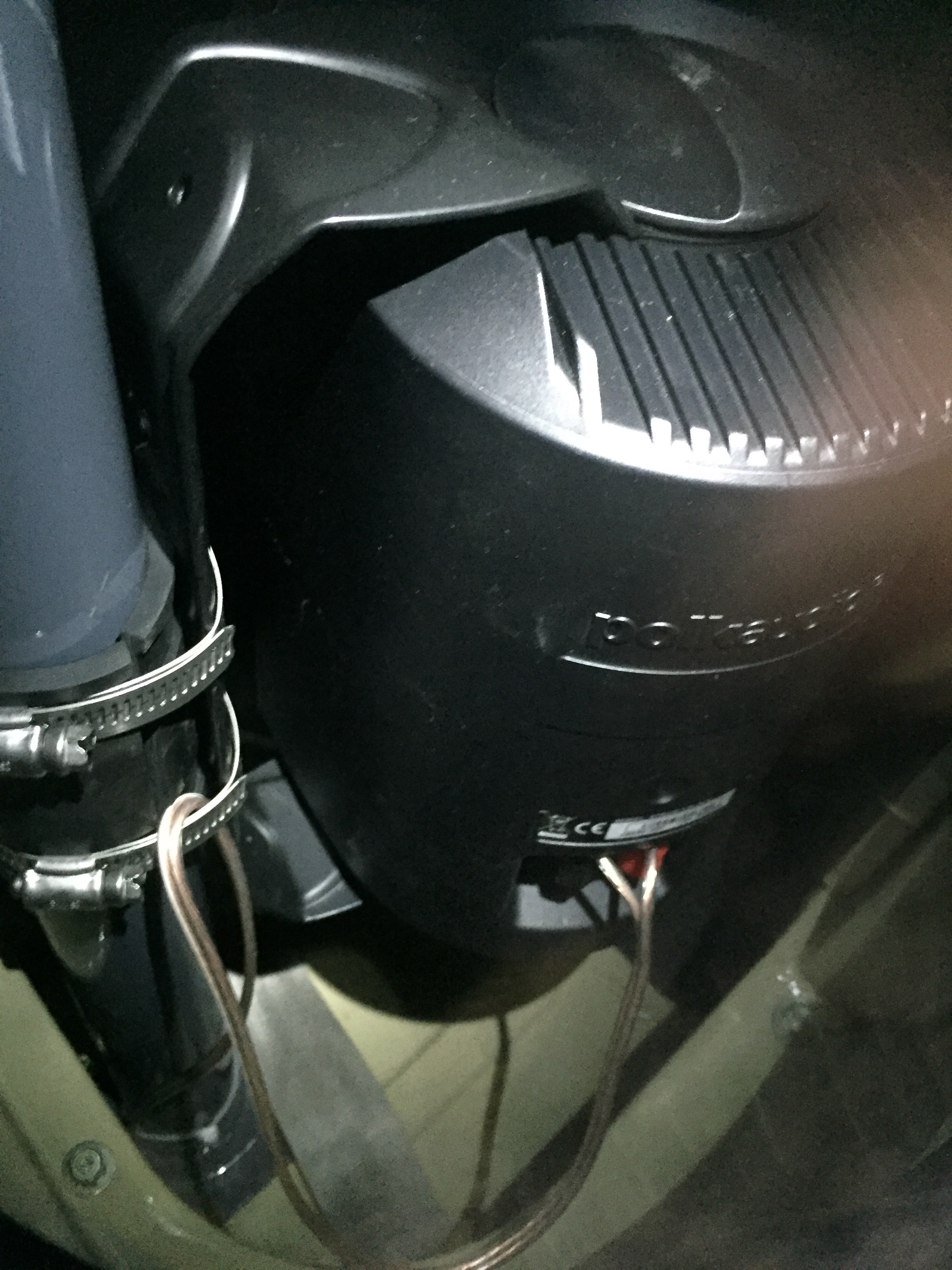

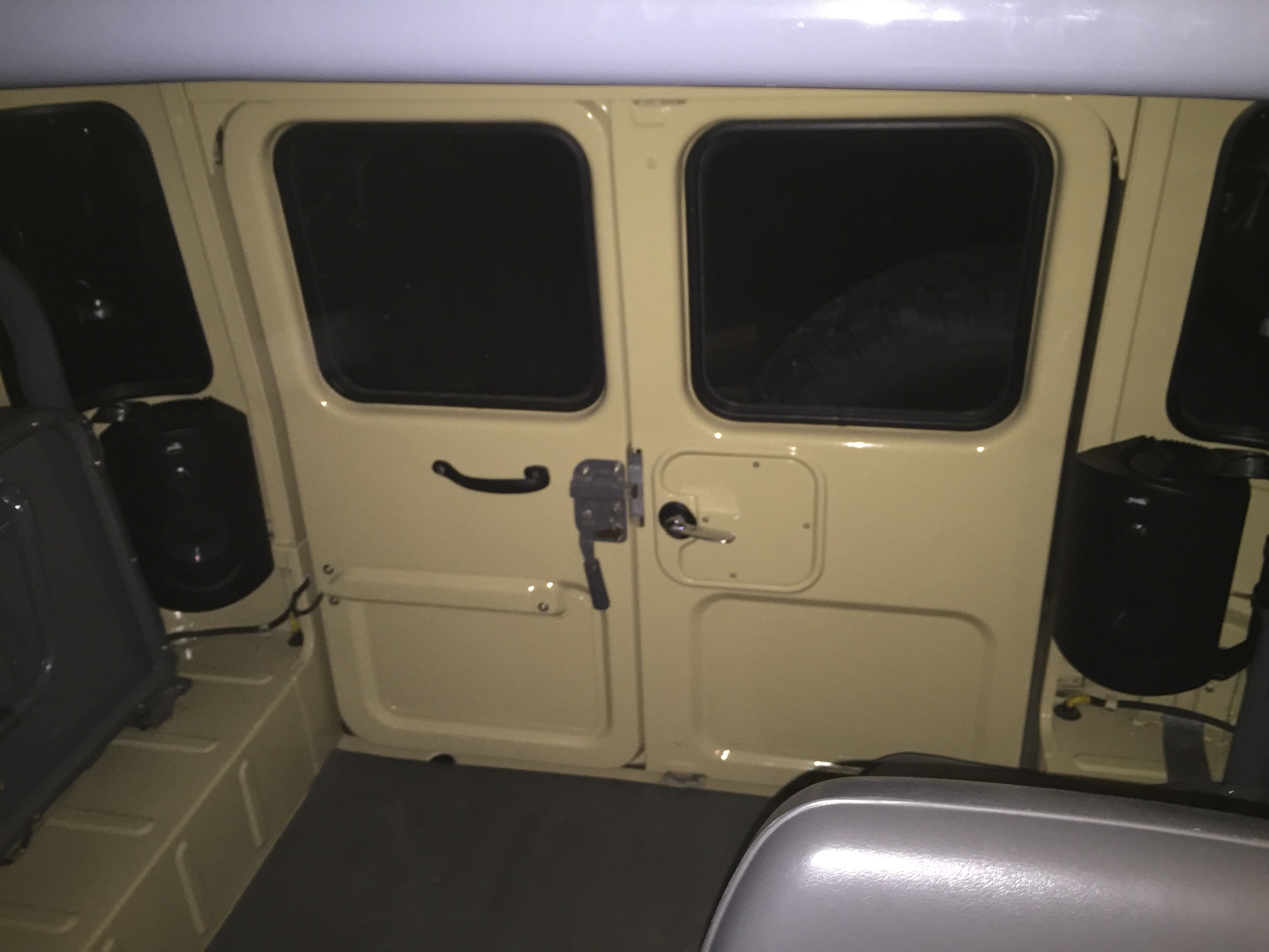

I already decided I was going to buy some outdoor speakers and mount them to the roll cage uprights in the back as user fj718 had done in this thread: stereo speakers in a FJ40. Thanks for the idea fj718, works great!
While buying the speakers I happened upon a Pioneer radio that didn't look too flashy, most of them look stupid, IMO, with all their multi-color flashing lights and star-trek style face plates. Just looks out of place in the FJ40. This one is fairly plain (as they go) and you can set the light color to match your dash. So, I took the easy way out and bought the Pioneer, some Polk Atrium 5s and wired it up. It sounds pretty good considering the acoustics of an FJ40 to begin with, and the fact that my cell phone speaker sounds better than what I had! It is fairly subdued especially when off so I don't mind it.
I had to ditch the housing that Pioneer supplies that one is suppose to mount in the hole in the dash and then slide the unit into because it is 1/8" too large in both dimensions. But the radio unit itself fits perfectly in the hole with no trim pieces around it and one can easily remove the face plate to thwart thieves if need be. It is the MVHX560BT if anyone cares.
If you didn't use the housing supplied with the radio, how did you secure it in the dash?
