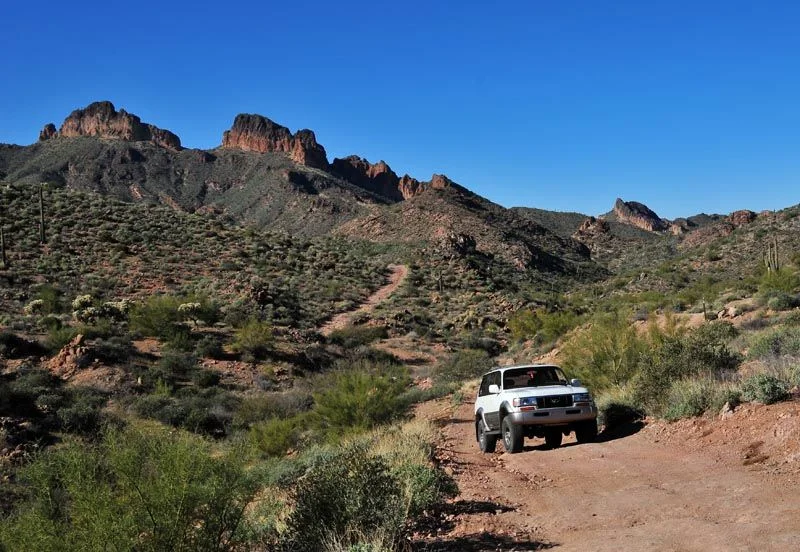

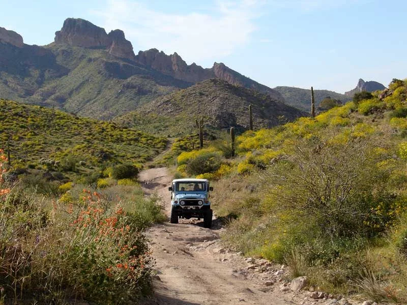

so, today we tried -on memory alone, 8 years later- to find the exact spot where the pic was taken that came just before my Brimmer calendar shot: this one
attachment.php
we came just so close . . .
attachment.php
guess we have to go back and be more precise ;p

pristine desert, no 10 miles from the big metropolitan area :cool:
Nice pics. Maybe a few hundred feet or so further up the road?

actually, the first pic was taken a bit further down - the climb that I remember is no longer there
