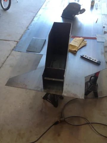

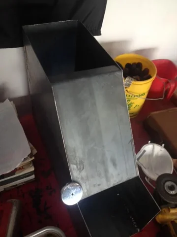

Got a little more done on the console ready to burn it in whenever.
