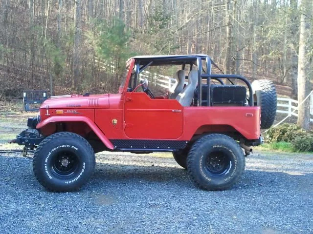

Removed 30lbs of previous owner trailer hitch. Also removed the hard top to get ready for my transmission swap. Just to make things easy to get to.
Took her back to her real home....

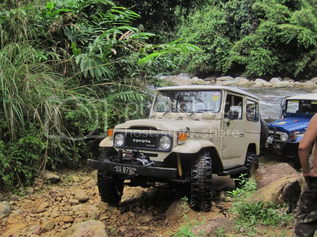

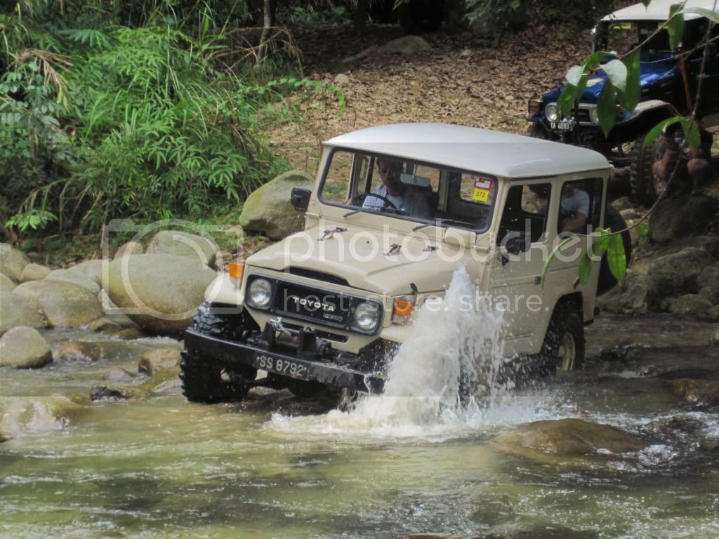

Drove from tennant creek to uluru a round trip of 2000 kms heater hose failed but fixed that and all is good
I don't know if you realise that there is a garbage dump in the middle of the desert:whoops:
That photo was strangely missing from my tourism brochure!?
