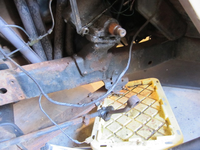

Got the pitman arm off. Toasted my gear puller, used a borrowed one from Advance Auto parts, and that plus torch got it off. Wow. Way tougher to get off than any suspension/steering stuff.
Results

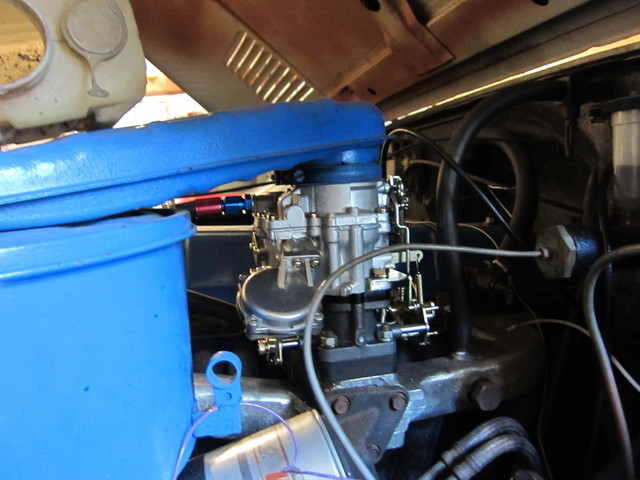

Blame the PO for the crazy brake lines and blue paint

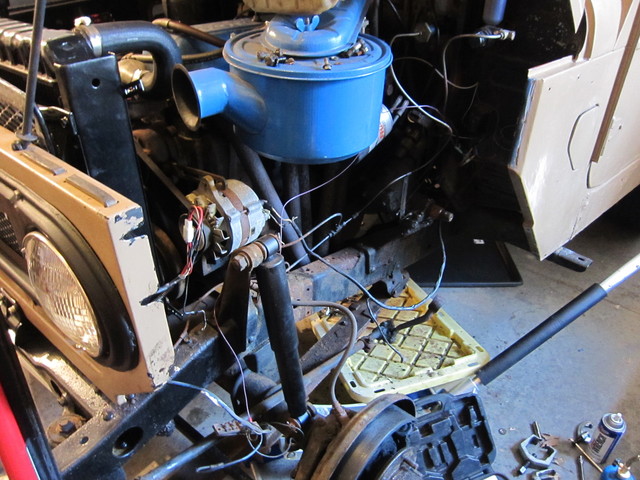

Two weeks ago I got the Trollhole all installed and happy.
Whoever said that you'd break all the bolts getting the fender off was right.
