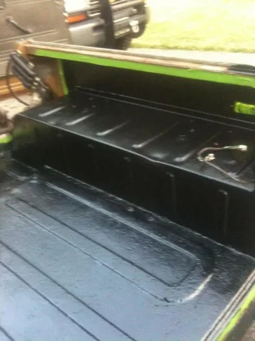

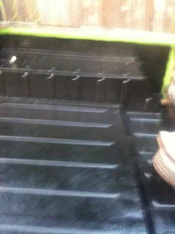

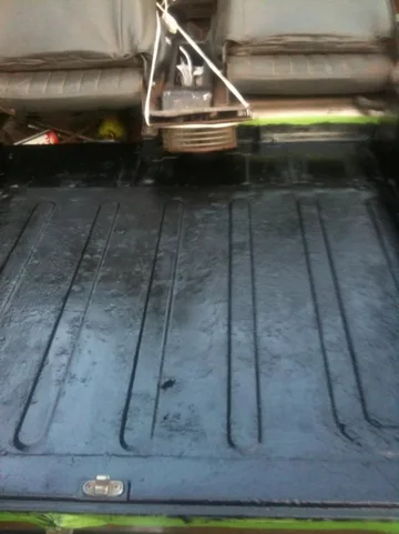

I finally started the Chassis Saver project! Wire wheeled and sanded the back floor and fender wheels. It took me over 2 hours to remove everything from the back. All of the bolts to the roll bar were locked in tight. Lots grinding and shop vac'n and air spraying until I had a good surface. Only thing that I left hanging was the rear heater. When I do the front half the heater will be removed.
I will need to apply a 2nd coat tomorrow. I am hoping I shouldn't have to do any prep work.
Not sure if I will put bedliner down after or paint or leave the Chassis Saver on. Any suggestions please!!
Got home and put the second coat of chassis saver on. Much easier than the first coat and so far it looks good. I may just leave the chassis saver but I need to see if it needs some sort of topcoat to keep it protected. I would suggest this product so far. Very easy to work with!!

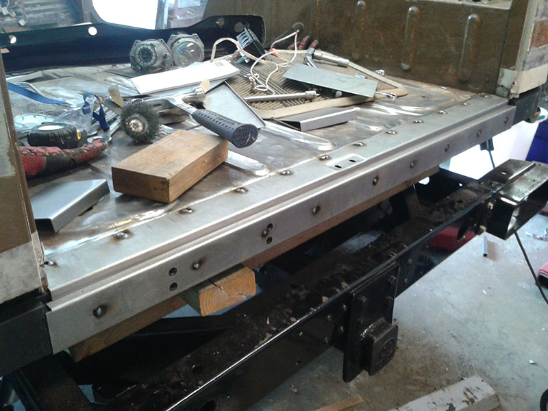

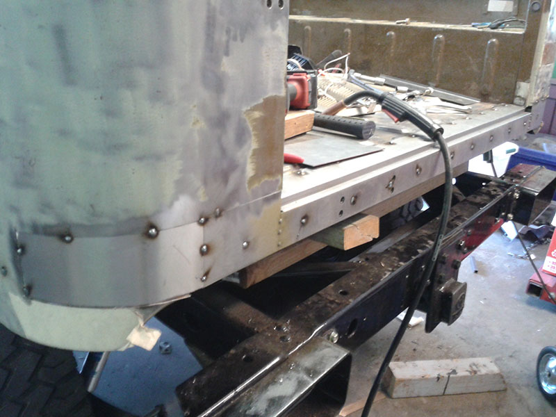

Installed CCOT rear sill, which despite some comments, fit perfectly and I'd recommend it to anybody

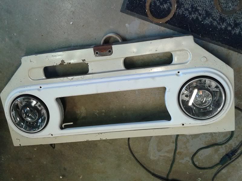

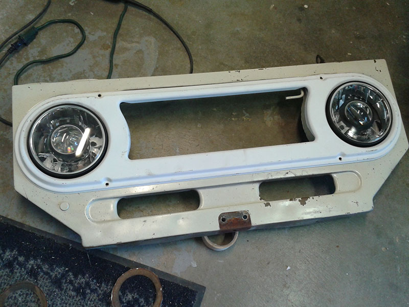

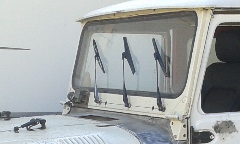

Finished my headlight project. Rampage glass lenses with 2012 BMW projectors, black bezels, and 6000k HID's
Finished triple wipers (yes they work, and yes, the blades will all match)

Damn, that looks great. More details, please.
Lights and wipers. I need to swap out my wiper assemblies soon. Always liked the LX triple wiper look.
I really like the look too, hence the reason I did it. I had an overseas member send me his measurements between his wiper posts, so I used them with some small changes. Next, I used my linkage as well as a different linkage I bought from a member and made my own that supports 3 wipers. I also had to modify my wiper motor so it turned in a smaller radius, in turn reducing the movement of the wipers.
It definitely wasn't easy, and it took a LOT of trial and error. I will post more pictures and measurements on it in my build thread.
More info on the beemer hid's please.
Well, I definitely wanted clear glass lenses, so those were the first things I bought. Next, I wanted a very crisp cutoff line (I love nice headlights in cars, like my stock S2000 lights), so I looked around for a good projector that is a bi-xenon (low and hi beam). I cut off the back of the new lights to accommodate the projector lenses, made up a spacer out of ABS plastic, and thats about it. The good thing is that they will still aim like the factory bowls.
I chose 6,000k HID's, as I wanted good output with a hint of blue. I will get more pictures for my build thread. The Rampage bowls were around $80, the bi-xenons were $160 (ebay), and the HID kid with ballasts was $150, so close to $400 in total. It should be plenty bright, especially with my Rigid spot lights up front.
