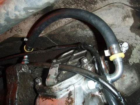

Got off my duff in the sweltering Texas humidity and installed a bypass hose across the fill plugs of the transmission to the TC. Been almost two years since the TC rebuild, oil was clean and the transmission was not overfilled; so this is insurance only at this point in time. Yep I know the speedo cable looks a little frayed from rubbing against the old header, but it still works so I anchored it out of the way for the time being.;)TC Bypass Hose.webp

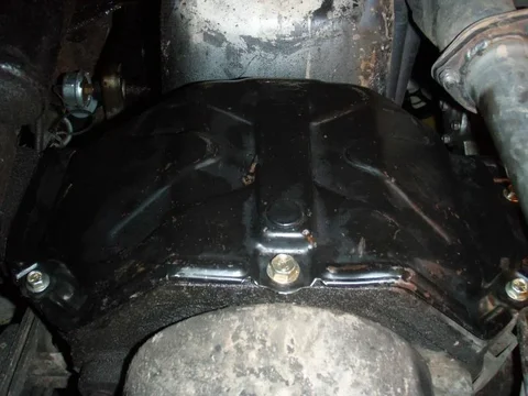

Also cleaned up the clutch cover plate I picked up from a fellow Mudster and got it installed.

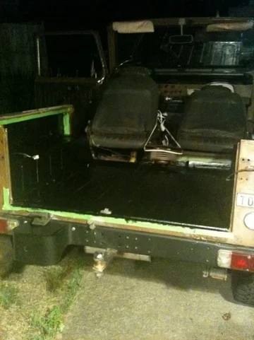

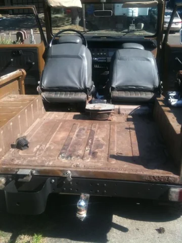

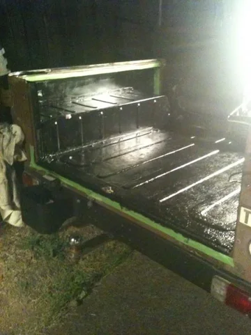

I finally started the Chassis Saver project! Wire wheeled and sanded the back floor and fender wheels. It took me over 2 hours to remove everything from the back. All of the bolts to the roll bar were locked in tight. Lots grinding and shop vac'n and air spraying until I had a good surface. Only thing that I left hanging was the rear heater. When I do the front half the heater will be removed.
I will need to apply a 2nd coat tomorrow. I am hoping I shouldn't have to do any prep work.
Not sure if I will put bedliner down after or paint or leave the Chassis Saver on. Any suggestions please!!
Carlosfj80... That's the eternal question: To liner or Not to! Are you a purist? If so then don't, but if your not and it will make you happy then do it. Just keep in mind it's permanent. Just my 2cents.
