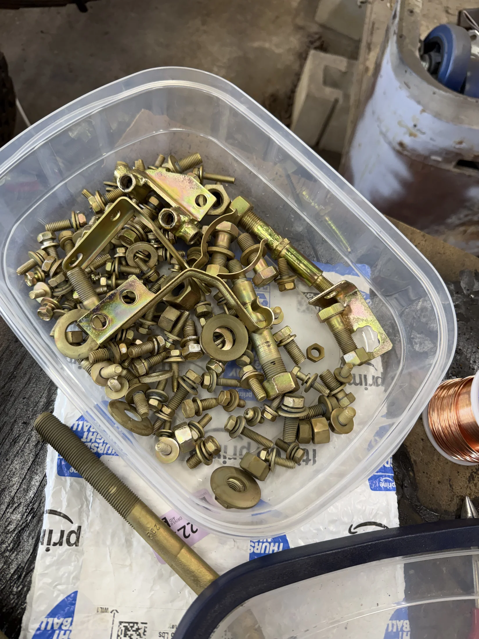

I thought energy suspension mounts came with new hdw? Mine did, and it was SAE
Thanks, the kit came with all new hardware and plates.Be prepared to cut bolts out using sawzall, cut off wheel (stinks like crazy from burnt rubber) or using oscillating saw (best with carbide ends) so you can get into tight corners. Way faster. Buy all new hardware too, old stuff likely pitted.
To not have to realign everything, loosen it all but replace as you go and tighten it all down last.
Is there a good source for the correct hardware all sorted out without having to piecemeal each nut and bolt?

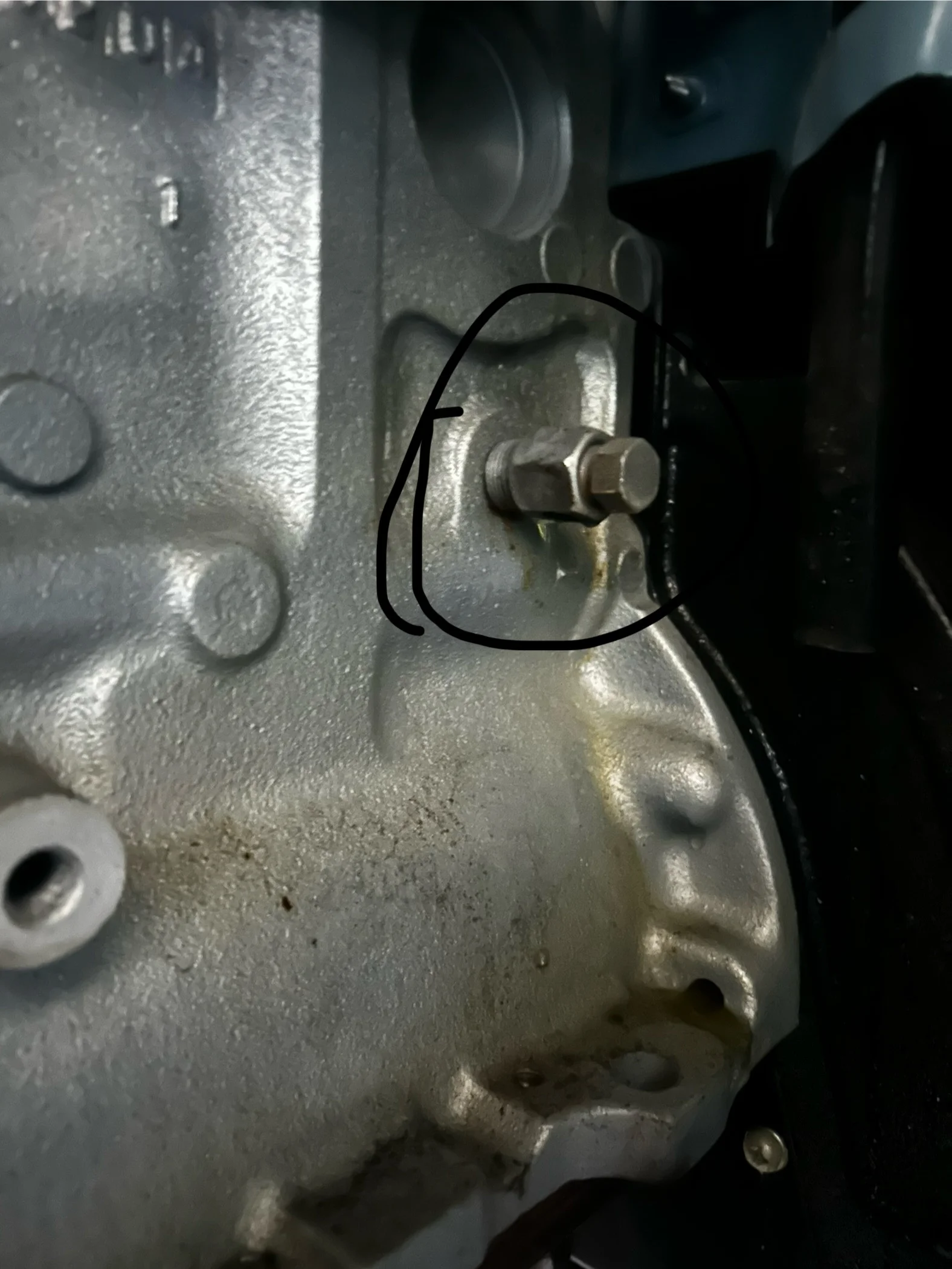

So I replaced the drain cock on the block over a week ago and still noticed a leak and realized it was coming from behind the exhaust manifold closest to the firewall.So I rented a radiator and cap test kit and found out that my coolant is leaking at the drain plug on the block. I believe I still have a small leak more so on the passenger side but can’t determine yet weather it’s from the same leak on the plug.
I’m going to still run the UV dye hopefully this weekend to make sure that are leaks are addressed.
Thanks for the link! To answer your question it hasn’t overheated. It has only been warmed up once since a rebuild on the motor.Has it been overheated? Could be a head gasket - check for milky oil. You could try and retorque them in sequence. There might be some freeze plugs in the head. Look in the manuals free download Land Cruiser Factory Service Manuals (FSMs) - https://www.cruisercult.com/factory-service-manuals
Use an inspection mirror and check the freeze plug because sometimes brand new ones weep a bit before they seal up.Thanks for the link! To answer your question it hasn’t overheated. It has only been warmed up once since a rebuild on the motor.
