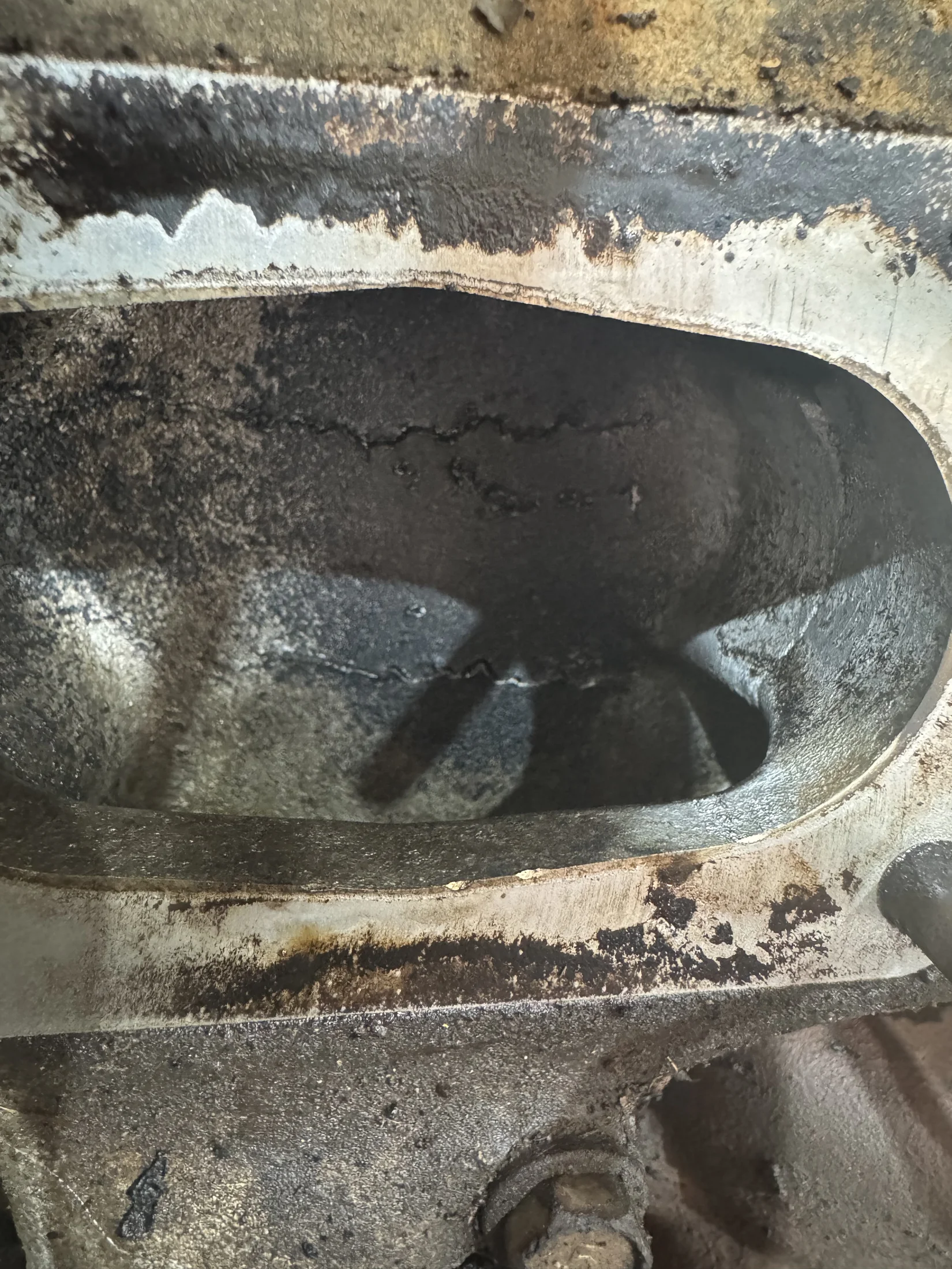

I had that issue as well and had to get the cracks welded.
How is that holding up? I’ve never used a tig, and didn’t think this was the thing to learn on.
I ended up going with the heat riser block off from cruiser outfitters/ cruiser teq.

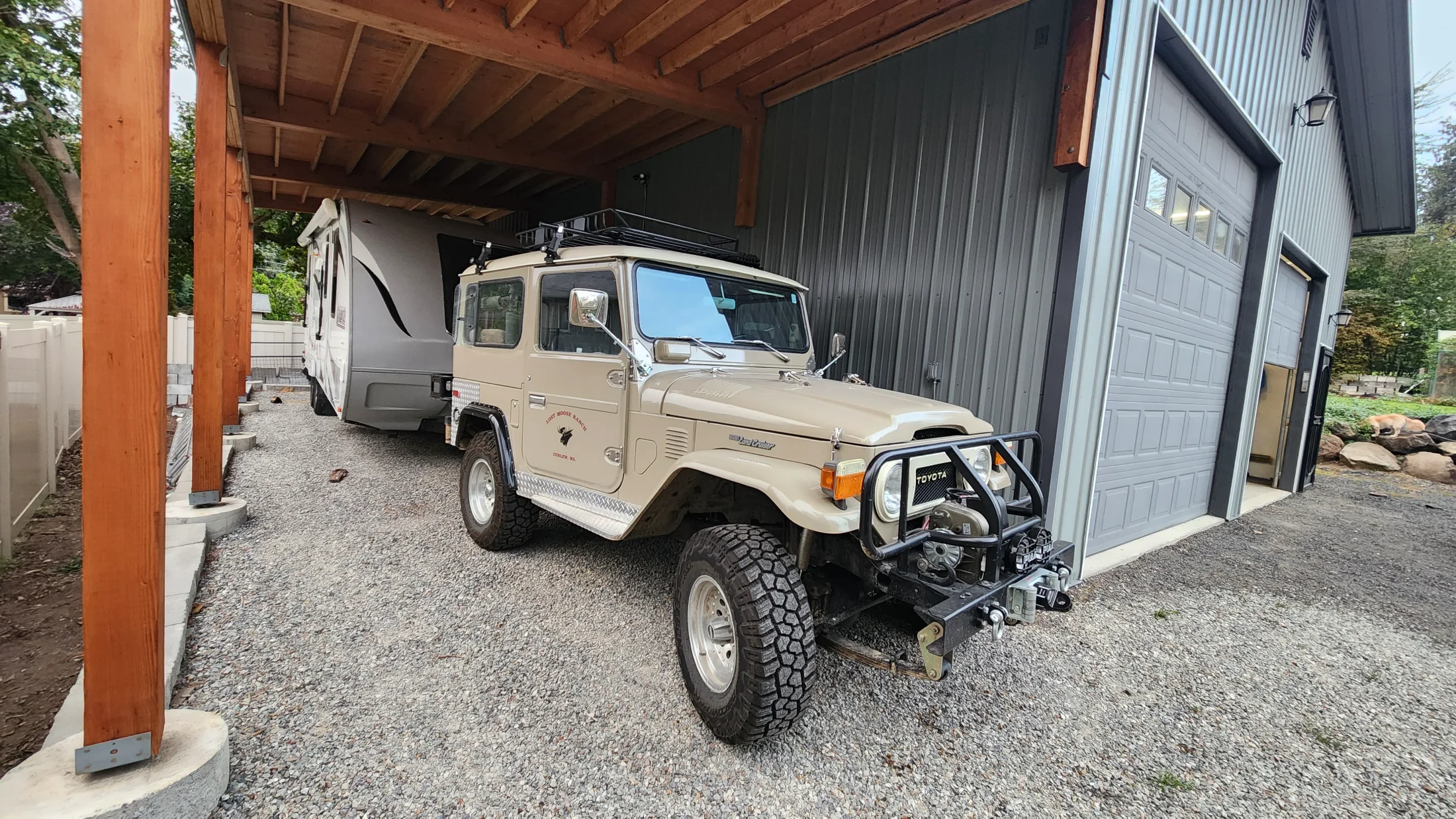

The FJ40 works better than the F150 for wiggling the trailer back into it's hidy hole.
I have a HUMMER trailer that is very hard to back up with with long wheel base 1-ton but I can back it up with my small John Deere tractor and put it where I want it. I am hoping that I can back it up with my 40 since I plan to convert the trailer to an off road trailer.
