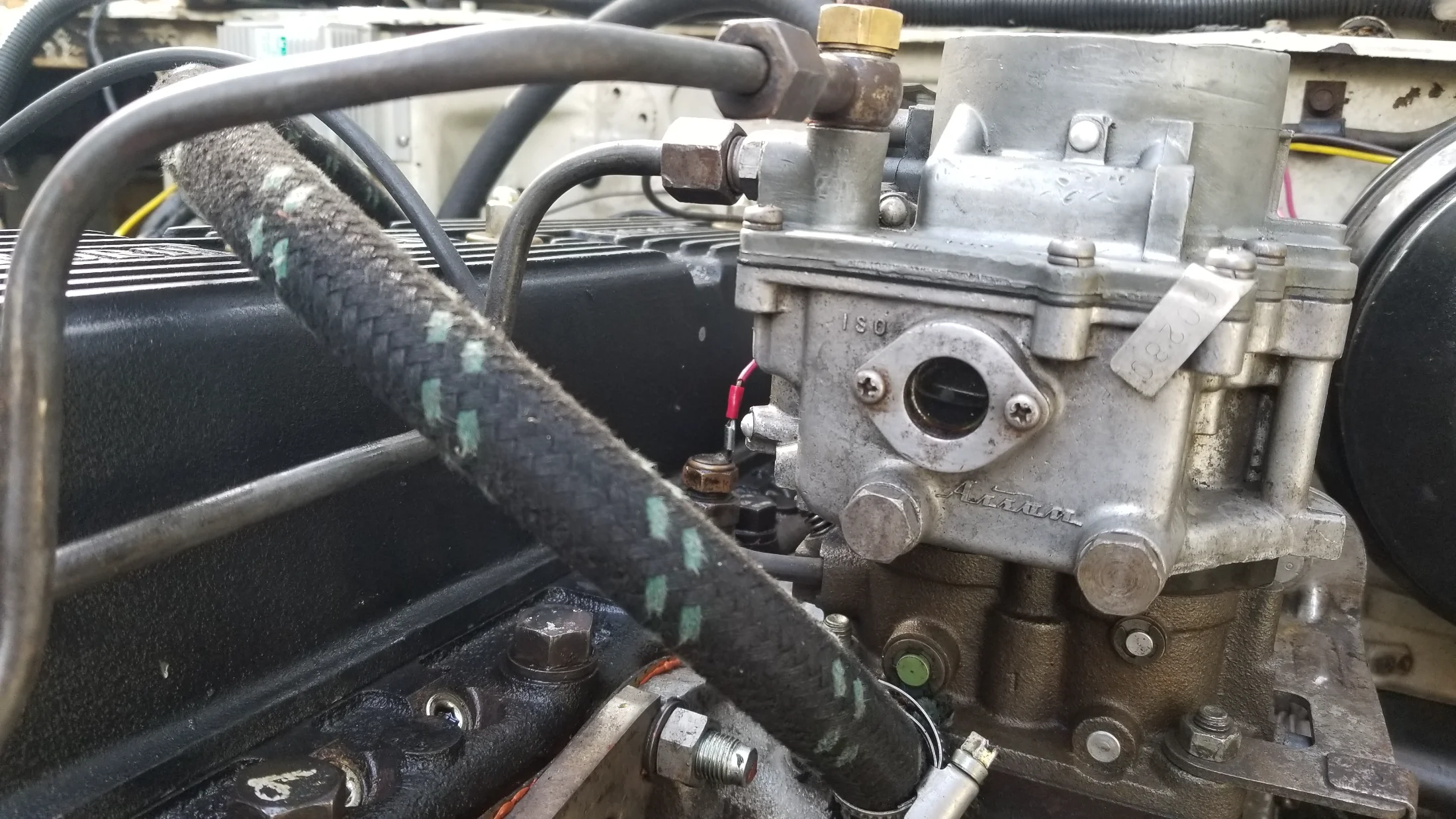

I’ve been playing with this pos carb for 2 years. I obviously don’t get it. This summer, out of the blue it decided to run just fine for 3-4 weeks until it didn’t. Then I found the bad plunger. Now the more I mess with it, it just gets worse. I can’t get it to idle and it’s backfiring out of the top of the carb. I’m not smart enough to figure it out and I lack probably some key tools.

A Backfire thru the carb could be a lean condition also, it could have a vacuum leak.
When I was running a Weber carb and DUI distributor, the 40 ran ok.. timing was set to the factory 7*… it usually started hard and coughed until it warmed up. I did advance it about 1/4” pass the mark ( turned out to be around 11*) and the truck ran much better and not nearly as sluggish.
Since all of the Sniper stuff was already on my shelf, I did convert it all to electronic but timing could be your next thing to rule out
Just because you bought and installed new parts don't mean they are still good. You can check the fuel pump, after engine is idling enough to run. Shut it off, disconnect the fuel hose at the carb and put it in a coffee can. Start engine and watch the fuel flow - smooth pulsing is fine; surges as in fuel flow then nothing then fuel flow again isn't good.
One thing I have noticed is the idle mixture screw seems to have no effect (by ear anyway) on rpms.
According to the carb video above you back it out to raise the rpms, then turn the idle screw to bring them back down, and repeat.
I had it all the way in and several turns out with no change. 🤷🏼‍♂️

Happened to me once, I put a gasket in backwards and partially blocked the air passage that goes to the mixture screw. Take it apart and follow that internal passage with little zip ties to see where it goes and is clear.
^^^^^^this is where I'd start:^^^
Your idle circuit could be blocked or clogged.
The carb is suppling fuel or air thru another circuit. Are the venturis leaking fuel at idle? Are the throttle plates closing? Make sure nothing is stopping them from closing. They could be hanging up on a gasket, linkage or dirt.
Tried to fix this nightmare of a carburetor and failed, again.
I was warned.
The accelerator rod plunger failed for the second time, so I got the city racer one with the leather boot.
Installed, everything seemed hunky dory, albeit with a slight miss.
The timing is set with the bb on the line.
Took it for a test drive and same old same old.
It drove fine under acceleration but when I decelerated, it backfired bad and died. Bump started it and drove back home where it alternated between dying at stop signs or high idling.
Pulled into the front yard and it high idled, so I fiddled with it.
I had the mixture screw out 1.5 turns so I turned it in .5 turn. Didn’t seem to make much difference. I revved it a couple times and it returned to idle for about 15 seconds, then died.
I’m out of ideas because I don’t know what I’m doing in the first place.
I can’t afford efi and I don’t mind a carburetor, if I could just get one to work.
