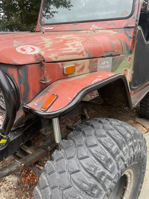

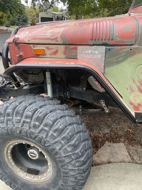

After 23 years my 40 finally has it's set of NLA Metal Tech 40 tube fenders. I retained the oem inner fender brace and welded tube to it. I did not delete the apron so I just used the original fender and cut it back.

I remember talking about this and you showing me the tubes when I stayed at your house! Wasn’t that like 18 years ago? You told me then that you were going to try and retain the aprons and I told you then that I liked that idea.
I still do.😊
65swb45, thank you, I thought it was 02' 03', could have been later, either way, past due for sure.
This vision has been in my head for that long, sense of closure now, feels satisfying. Mark A., it is unique to share a thought/concept with someone and having them around at it's finality, I like the " Remember when we talked about this years ago " comment, I guess it makes me feel like I actually completed a task/ wishlist item regardless of how large a task it was. I appreciate being able to share that with you.
Want a laugh? I also remember being so impressed with your idea that I asked you to consider building me a pair!
I’m not waiting another 18 years!😛
Well now I know exactly how to do it, do it better the second time & make them bolt on if nec., it was kinda fun. I also got to delete those lites, the new ones are metal bodied ( not plastic) LED , have park & blink, and because I have filament rear bulbs the flasher still works and they cover the holes.
The fitment of the cut back skin is tough because the fender isnt square, bent over the years, etc. & after looking at my hood overhang and reading your post I checked, sure enough driver side front cab mount area is bent due to repeated smashes at rear of rocker which is tied to frame & tub right there. No way could you make them without vehicle in hand.
