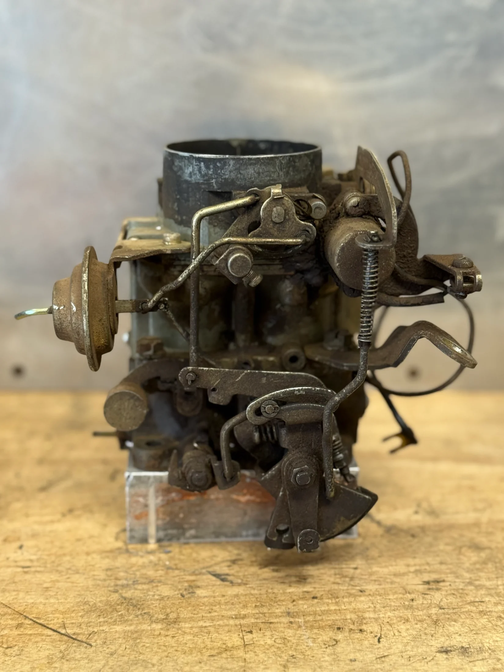

Started my 40 today to make sure she’s running properly before converting to a sniper only to find out that I have antifreeze leaking underneath my bell housing.
This makes me sick to my stomach.
