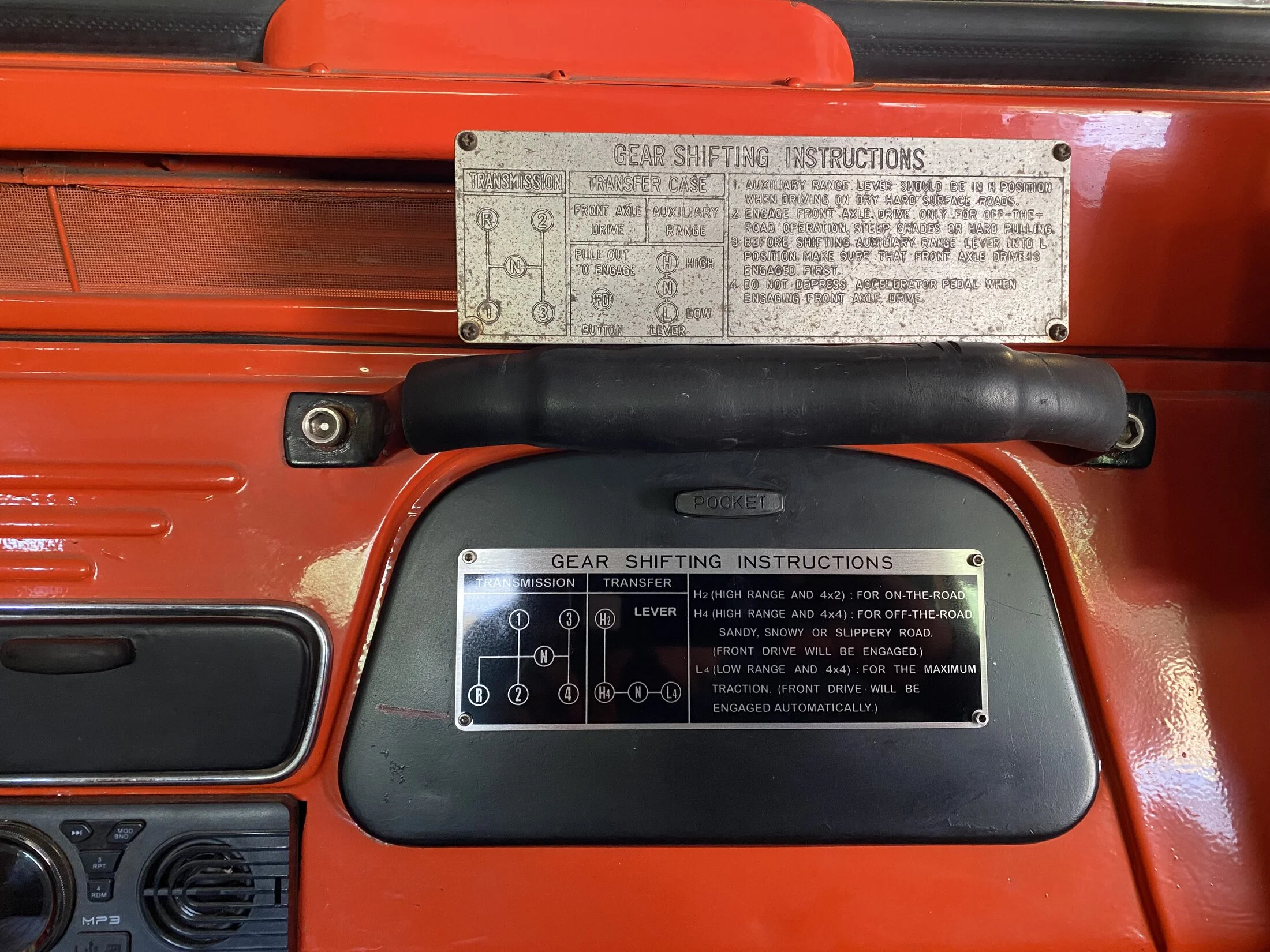

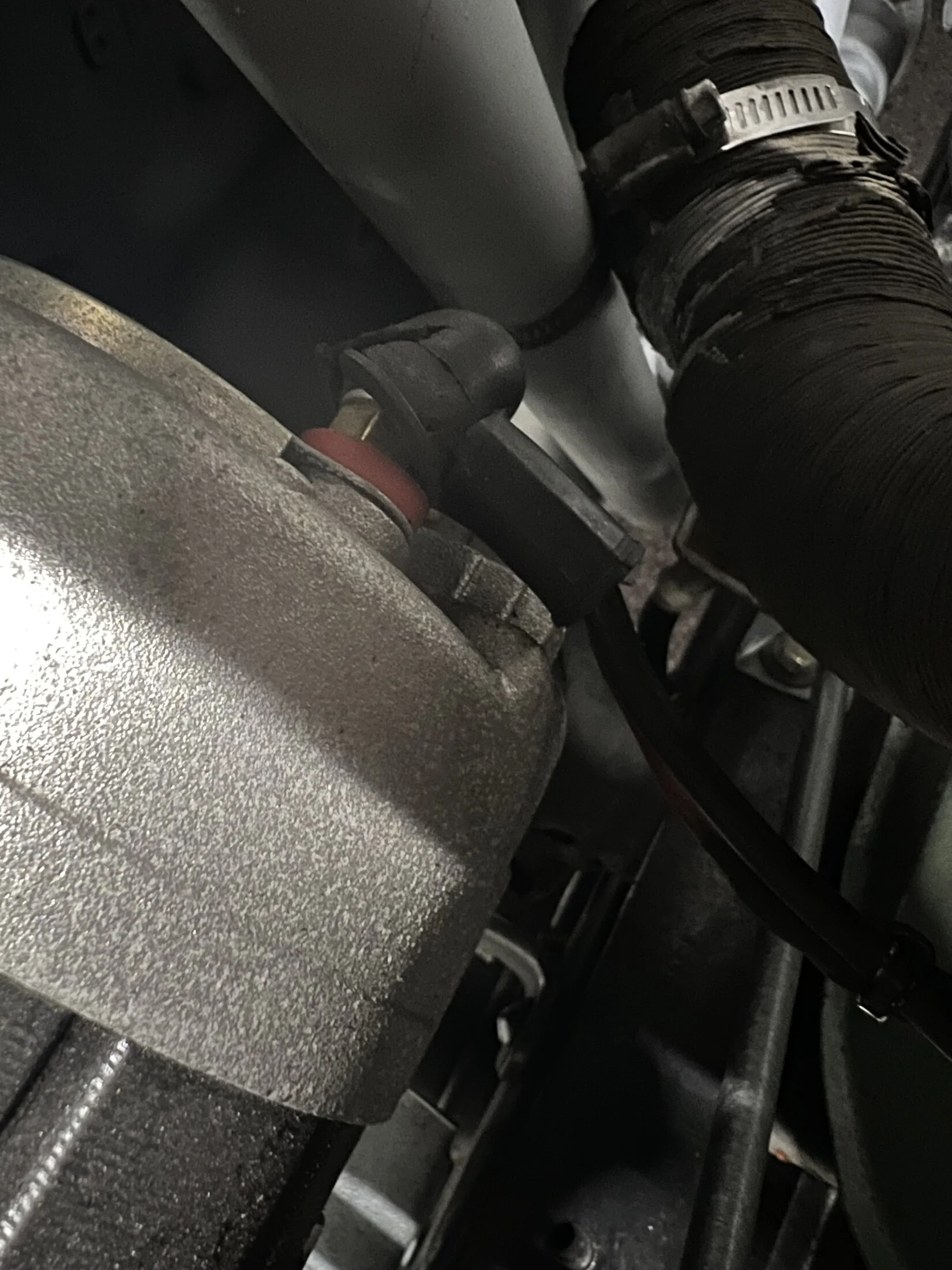

Out with the old, in with the new thanks to @shipmag! A top quality product by the way. (That's the 62 year old original sitting on the grab bar.)

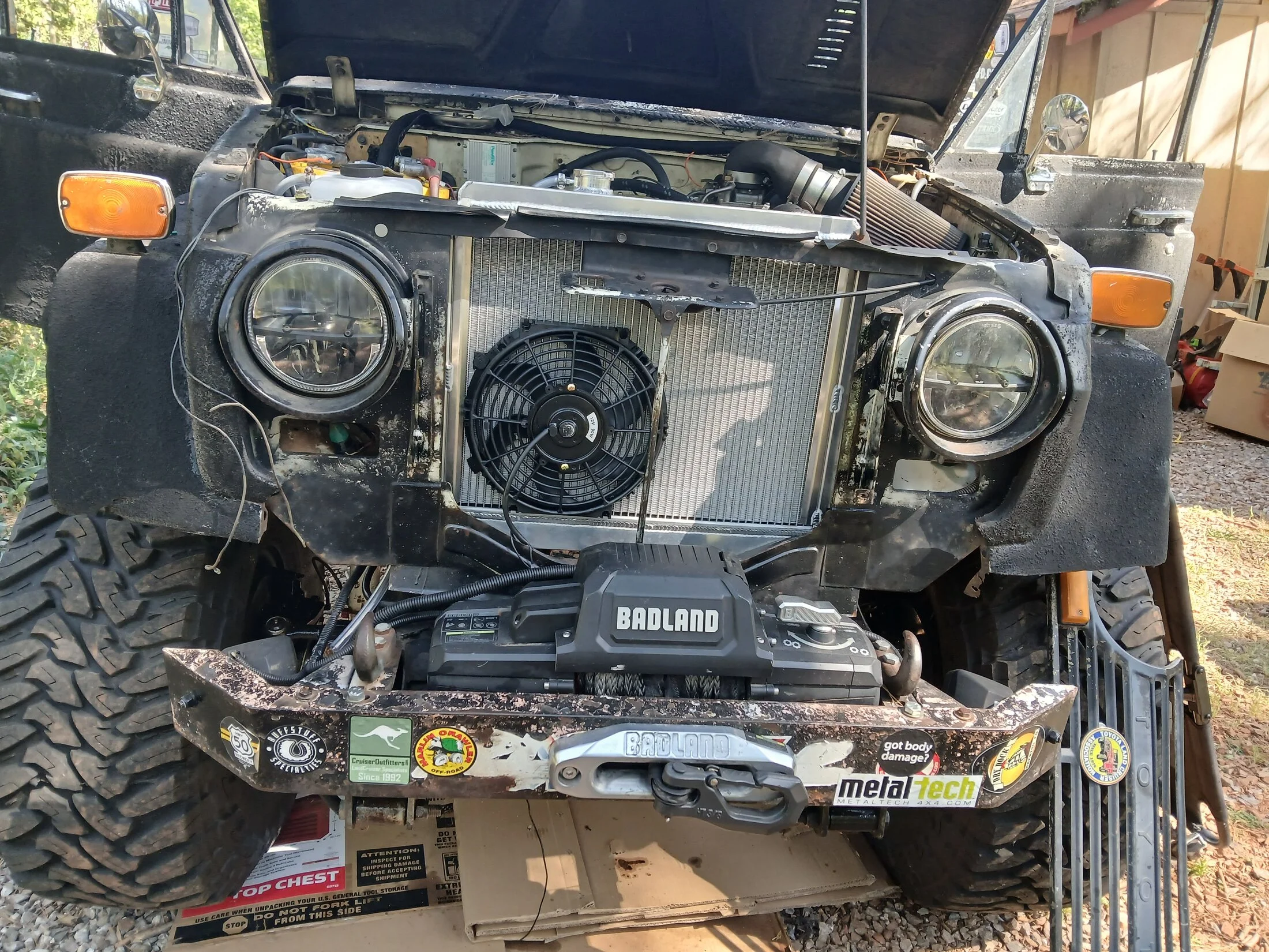

I did a wiring thing, and I am not a wirer. Electricity is a type of magic and insulation is a myth. And I do not have an overheating problem, I swear I do not. It only got hot that one time, on the Rubithon, in the afternoon, crawling in low/low/1st uphill for a long time temp got up to the mid 230s, which was new.
So, 2 weeks before Rubithon, I decided to address that. New waterpump, new fanbelts, new aluminum radiator and now a little fan maybe to help when the speeds get real slow. I just needed to get the electricity to do what I want when I want. A small box from Painless helped. Now I've got fingertip convenience for the fan AND my rocklights. Need to find two more electrical things to power to fill the empty spots in my switch panel.

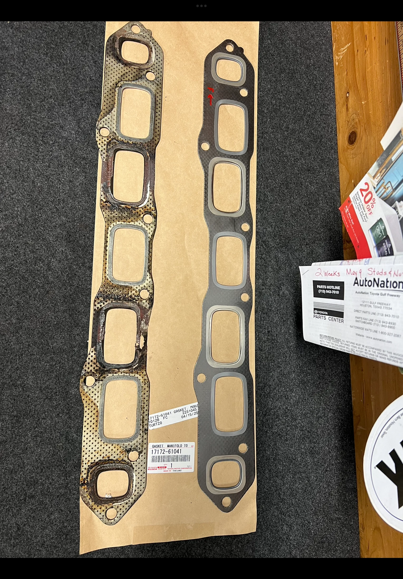

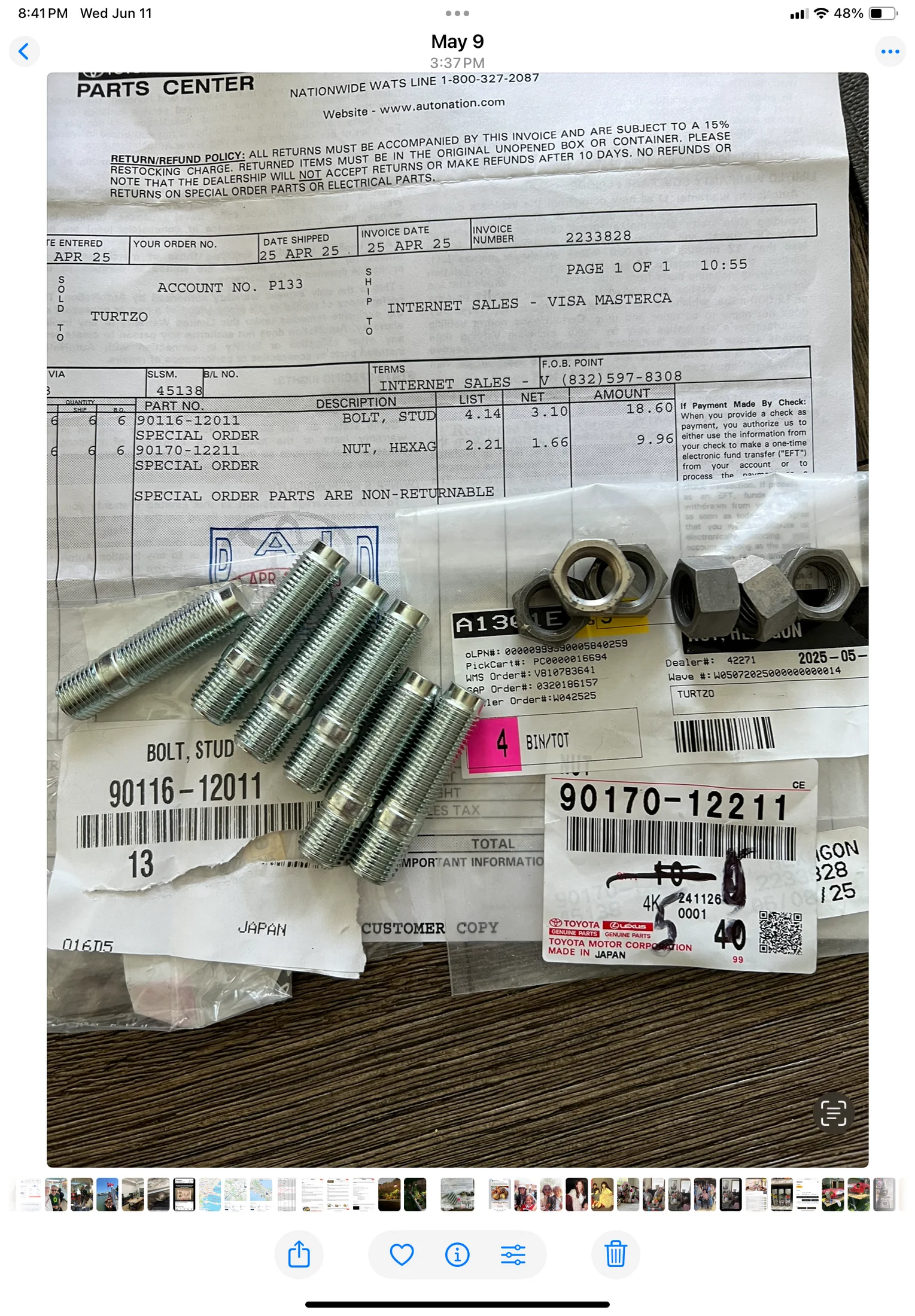

I heard an exhaust leak, it actually turned out to be two leaks. One was in the collector, which I was able to repair with torch & brass rod. I’m happy about that because the cost of new ones has gotten ridiculous. Not pretty but it worked. Also replaced the gaskets on both ends of the header. Here’s the Toyota gasket, stud and nut part numbers FYI.

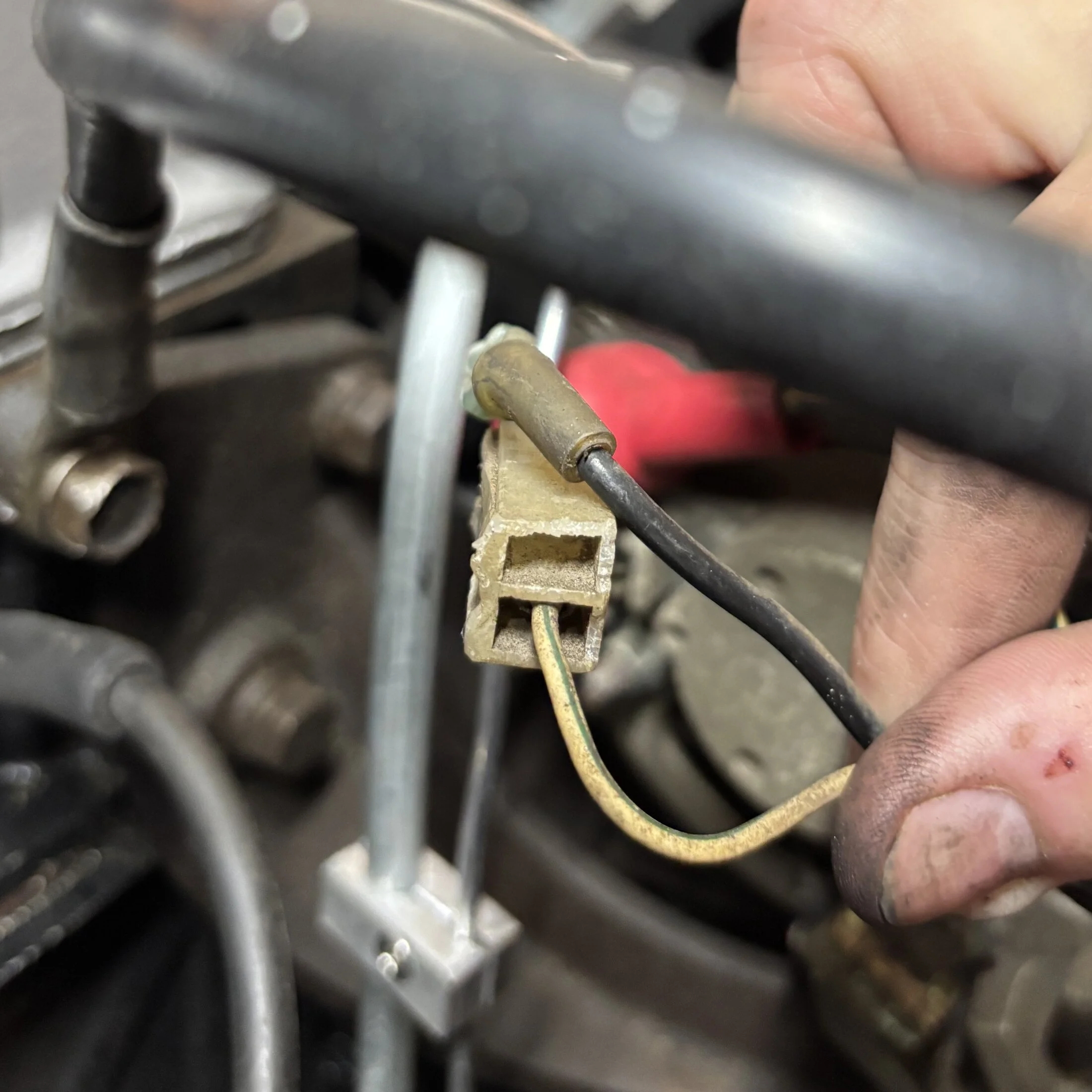

I spent some time on the ignition issue on the 1978. Coil seems fine upon further testing. Once the engine is warm, the spark becomes very weak and barely fires and then stalls. The spark is definitely not strong - it is an orange/ yellow color. Not white/ blue. And both the coil and igniter are very, very hot. Too hot to touch.
I ran through most of the checks in the manual, but the only thing I couldn't verify was 12V power from the resistor wire from the ignition switch, but I was a little confused as to how to actually test for 12V with it unplugged. Or why it ever would be. Time to search deeper into the history.
