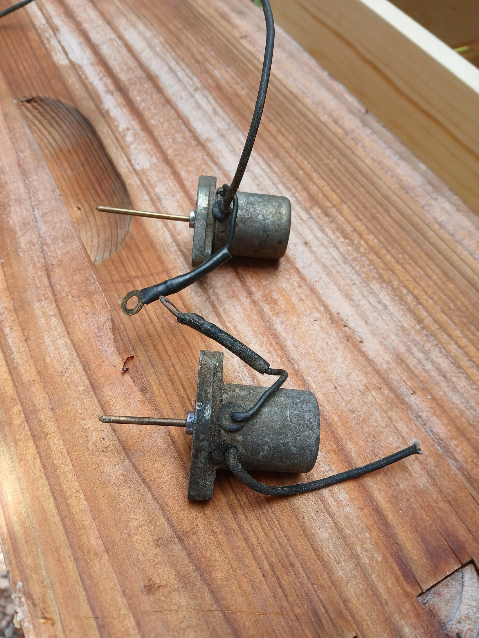

So I checked power to the idle solenoid and it's all 11.85. I have the key on and disconnected the solenoid and reconnected it and I don't hear any clicking? I removed the solenoid and white wired it to the battery with two loose wire and it clicks but there is not a a rod or anything coming out the end. Shouldn't a rod come out?
...HOT wired it.....
What is the hole in the end for? I read that some do. Maybe a different vehicle.
Thanks.
What hole? pics might help.
Here's my spare solenoids, maybe '73 or '74ish. They get more complicated later.
This hole for the idle solenoid. I thought a rod pushed out. It's not clicking when hooked to power at its connection but does if I connect it to power at the charcoal connection canister for testing.
Oh, that hole. No idea.
But, if you found a way to make it click then try running it while clicked. If that works, you found your problem and you can fix it in another thread...
It grounds to the carb body so when testing plug one end to the harness and tap the solenoid to the block and the rod should click with 12v
