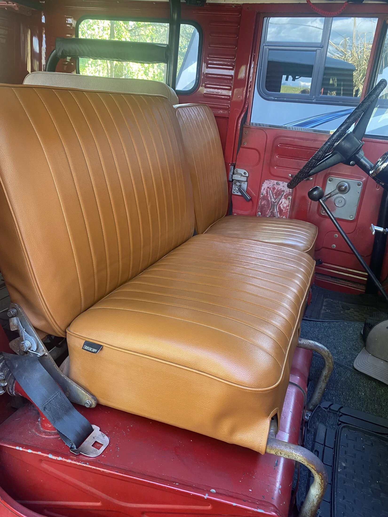

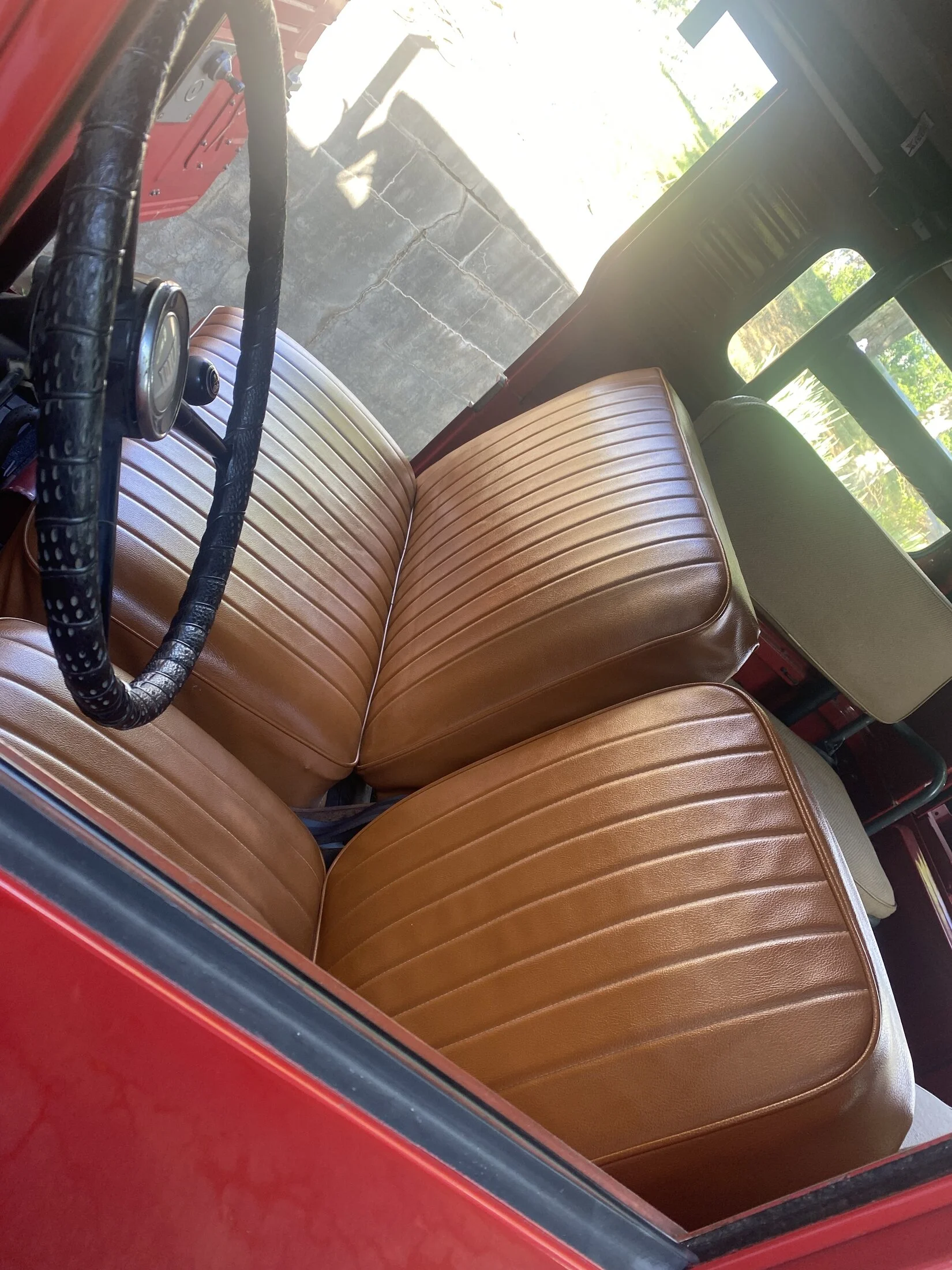

Got the bench seats in. If I’m being honest, I love the look, but don’t *love* the seats. The driver seat is about 2-3” lower than my previous seats, they are squishy, the driver seat bottom is smaller than the previous seat I had so it is kind of like balancing (I’m not a big guy…170lbs) and they are slippery. Maybe I will get used to it. I might have to figure out a way to raise the driver seat. Passenger seat is fine and not as squishy to sit in. It feels different driving bc I’m so low. But they look good….lol.

They look soo Good in there!

Smoking deal from @clrussell!! ;)
Drive 10 hours yesterday to get them after we were able to get them to KY.
They are the Cruiser Corps covers. Good news is I can do the rear jump seats to match.
No idea on the foam, etc. @clrussell did all of that. Maybe if I add some firmer foam to the driver side…hmmm.

I agree. They look amazing. They will oook better once I pull them back out and refinish all the metal. I just couldn’t wait.

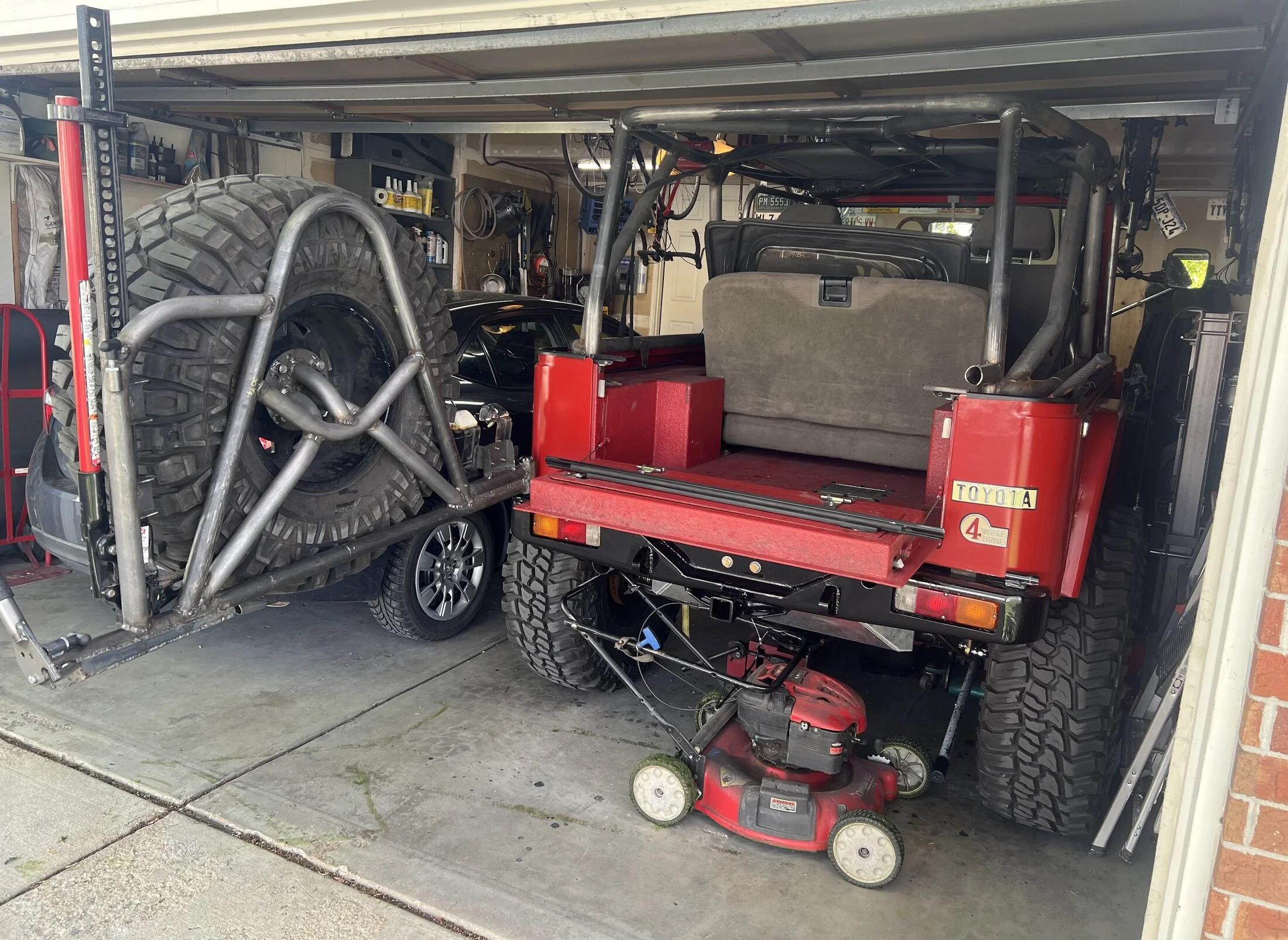

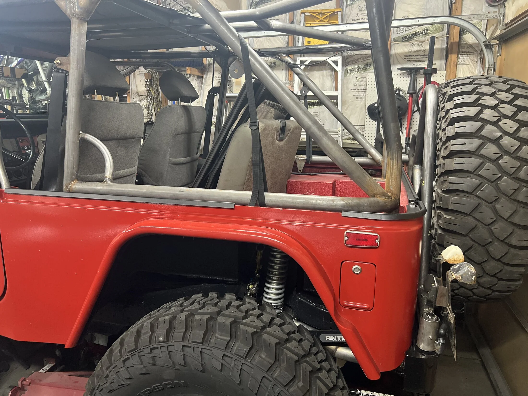

The tire carrier is almost done.

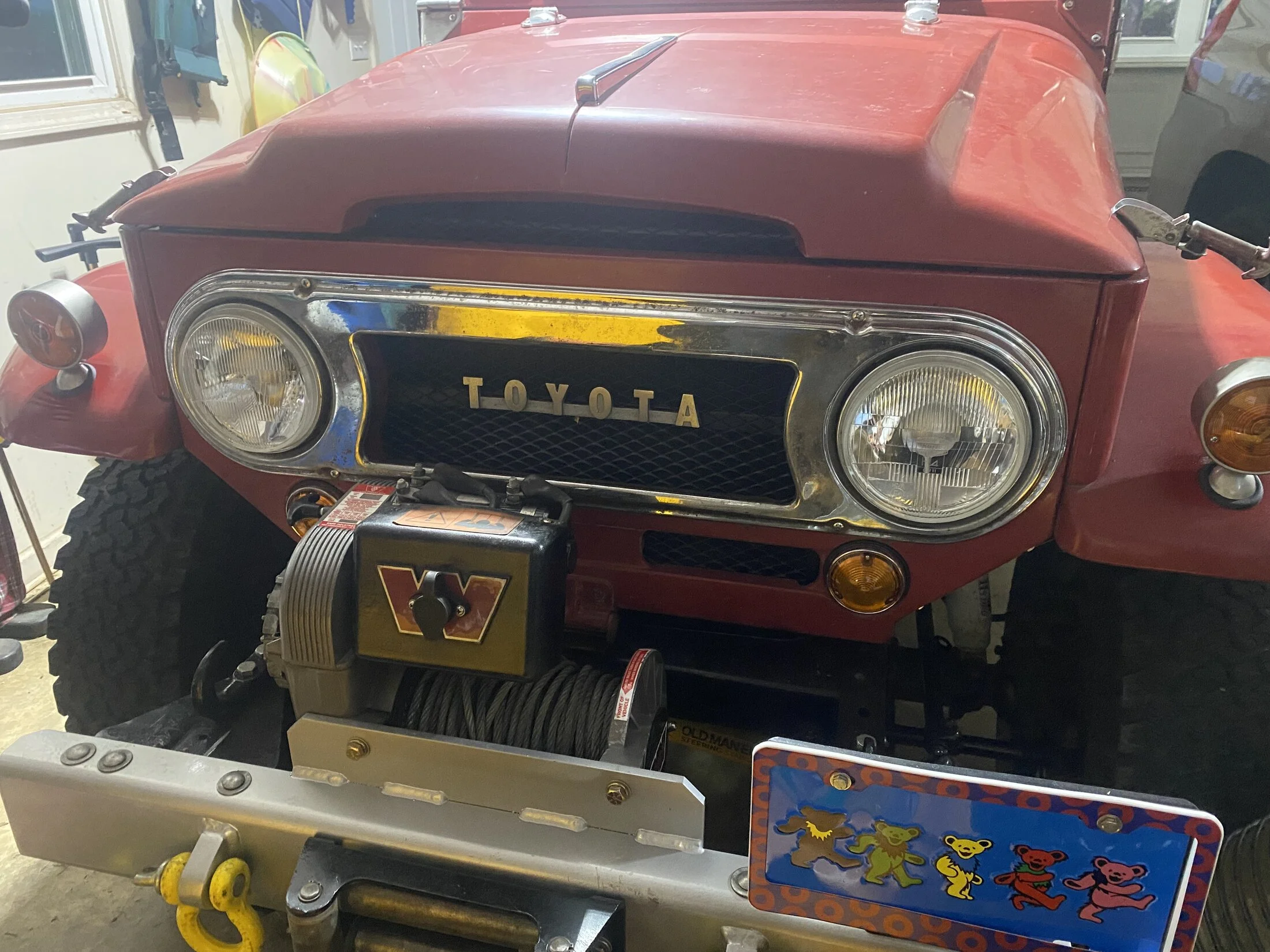

Took out the City Racer led headlights and put in the Koitos that I bought from the @CruiserTrash website. I hooked them up today and love the warmer light with the 40 and of course the old school (original) look. I’ll hook up the harness this week and see if the HBI lights up as I put a led in my indicator a while back and some have had luck with just doing that. If it doesn’t I’m hoping to test out the solution that @CruiserTrash has since mine is an early model

This is why I went to later 40 buckets. I loved the look and nostalgia of the original benches, even after restoring them, but they are not comfortable for me at 6'2" 220 lb. and you do slip and slide around. I hated to swap them out, but functionality over form won. I found that the springs were the issue in mine. Adding foam may have firmed the seat a bit, but the weak springs seemed to be the culprit. I didn't try this but maybe you can build up something under the springs to prevent them from sagging so much...??

I am 5’10 170lbs and I have the same issue. I am going to try adding an additional 2” of foam padding and some polyfill and see if that helps any.

I was going to recommend doing just that. The upholstery looks a tad loose, so you have room for more padding. Once filled, the upholstery should pull very tight on a warm day. You could also add a spring or two. I replaced 6 and added 2 springs to my LV Bench seat. I used 9 AWG 1"x2" "No sag" bulk spring and bent my own.

Awesome! The warm light definitely suits a 40. Love the license plate too!

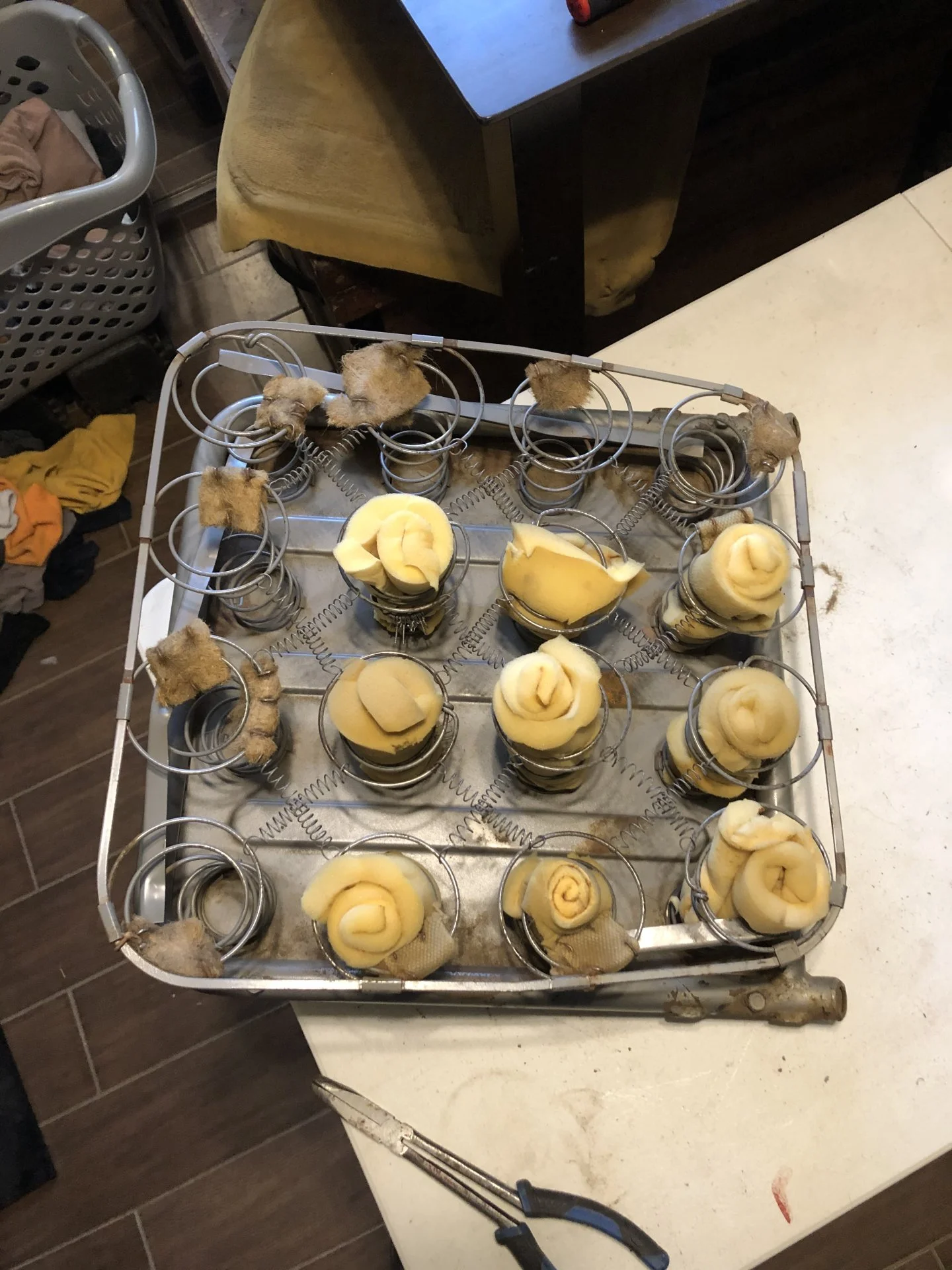

I stuffed mine with polyfill. No photos in that post, but you get the idea. The seat is too firm for my tastes being completely stuffed, but its easy enough to remove some and "tune" it to my weight when it bothers me enough. My '71 has same seat but not polyfill stuffed, and I actually like the support and bounce. Makes me feel like i'm driving an old truck, which is why I drive 40's.

Thanks. So you put the foam inside the springs as in your picture…and then polyfill in all of the other open space? And sounds like you packed it full and just pulled it out until it was dialed in.

Can't say the foam in the springs does anything, but yes I stuffed the void with polyfill. I did not pull any out yet, but its not too hard to take the seat out and adjust to your liking.
