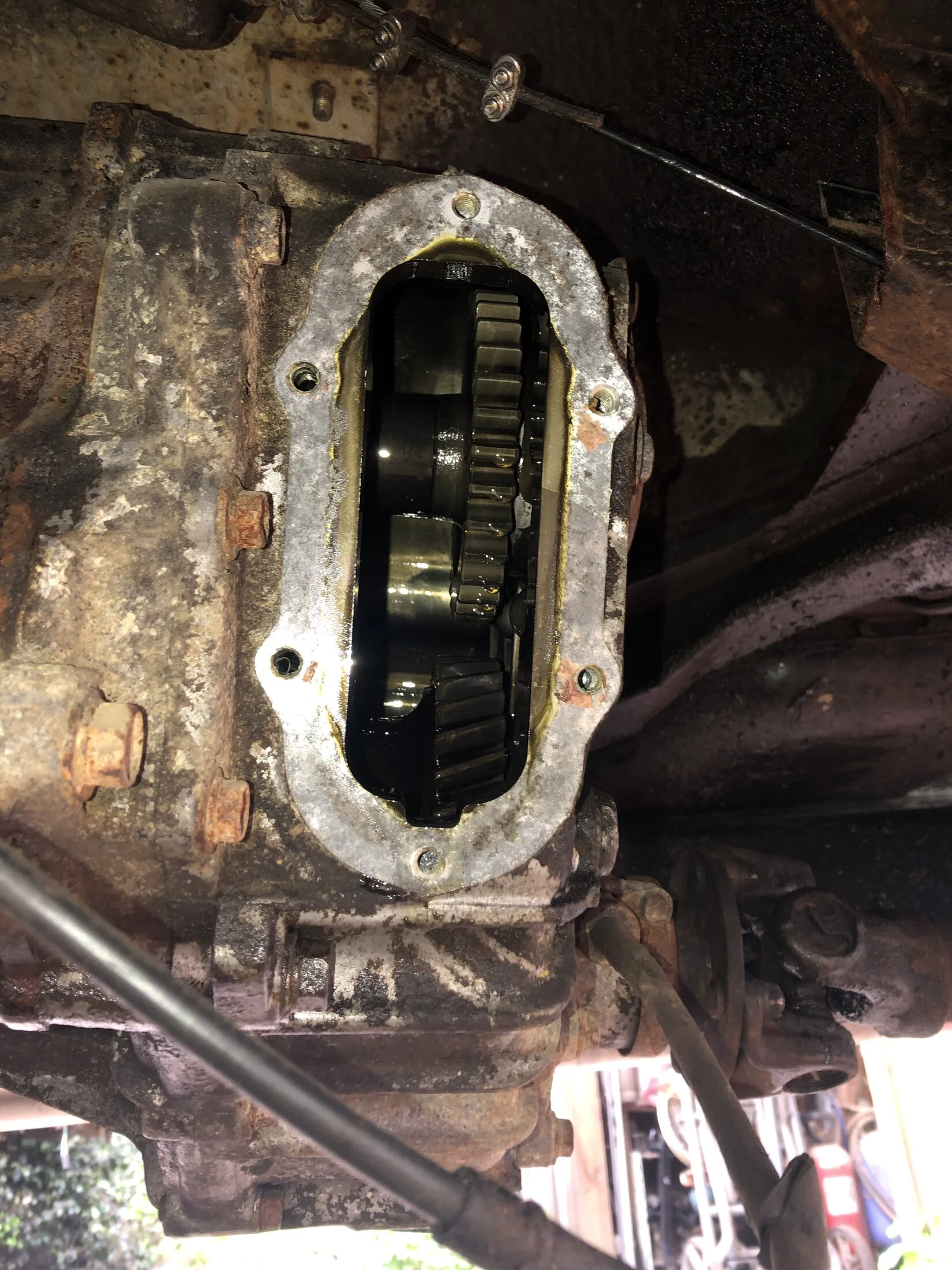

Got my Pto winch mounted. Just have to install the drive shaft and Pto in cab lever.

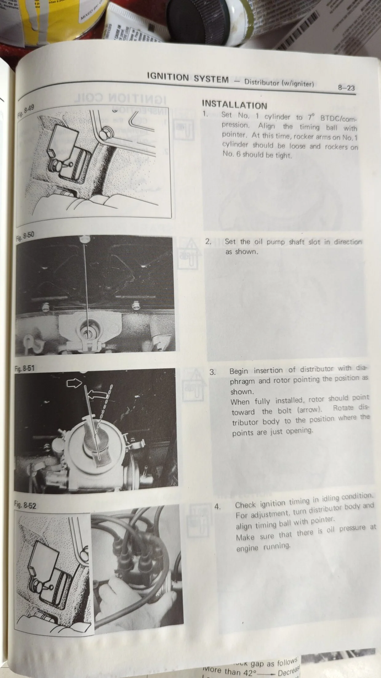

I just pulled my distributor with the BB on the market and fwd cylinder full up. Distrb arm is pointing to #4. Looking at the manual it looks like it should be pointed more towards left side of the side cover top center bolt? Photo attached from book
Back to the store.....💲💲💲
Save your money.
If the BB is in the window. Lower the idle using the idle screw until you aren't drawing fuel through the venturi.
You'll know because you'll have the ability to run in the mixture screw and starve out the engine.
Get it off the venturi and drawing fuel through the idle circuit at idle...
