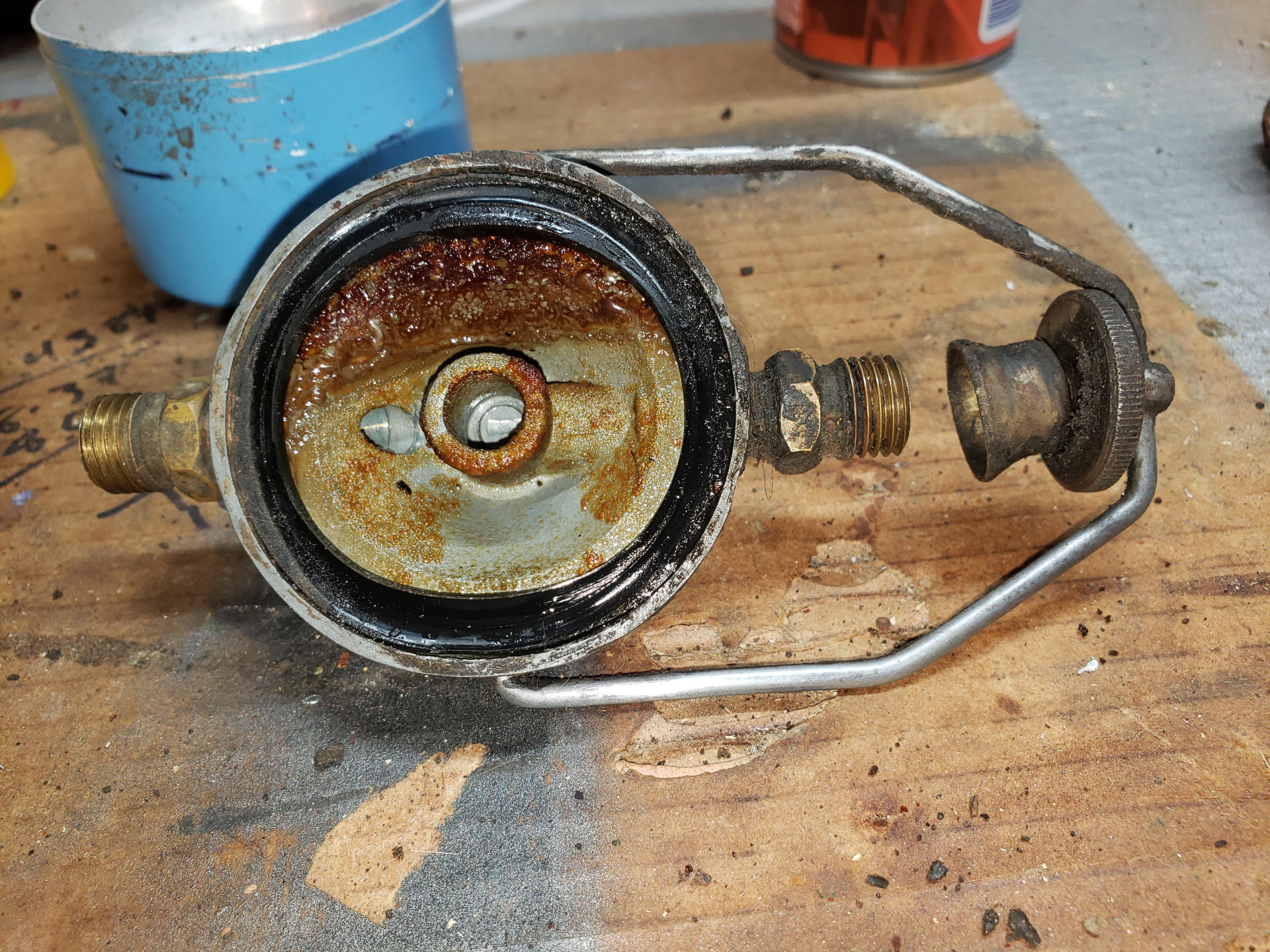

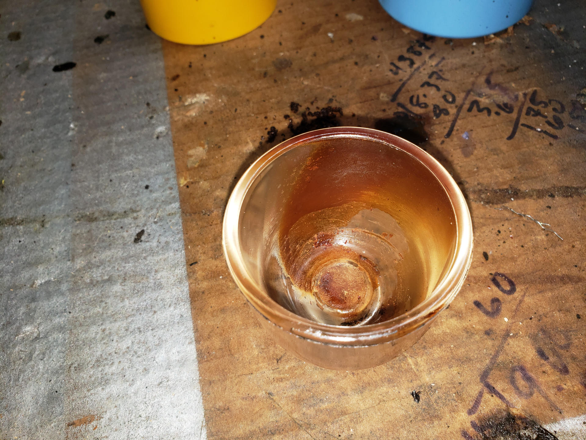

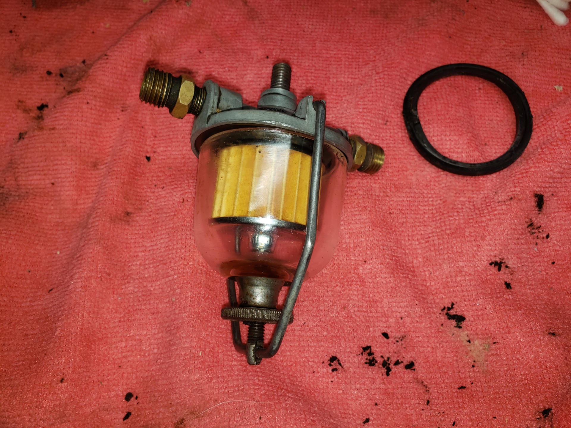

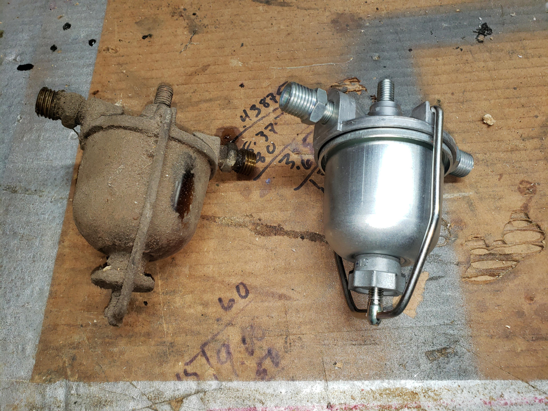

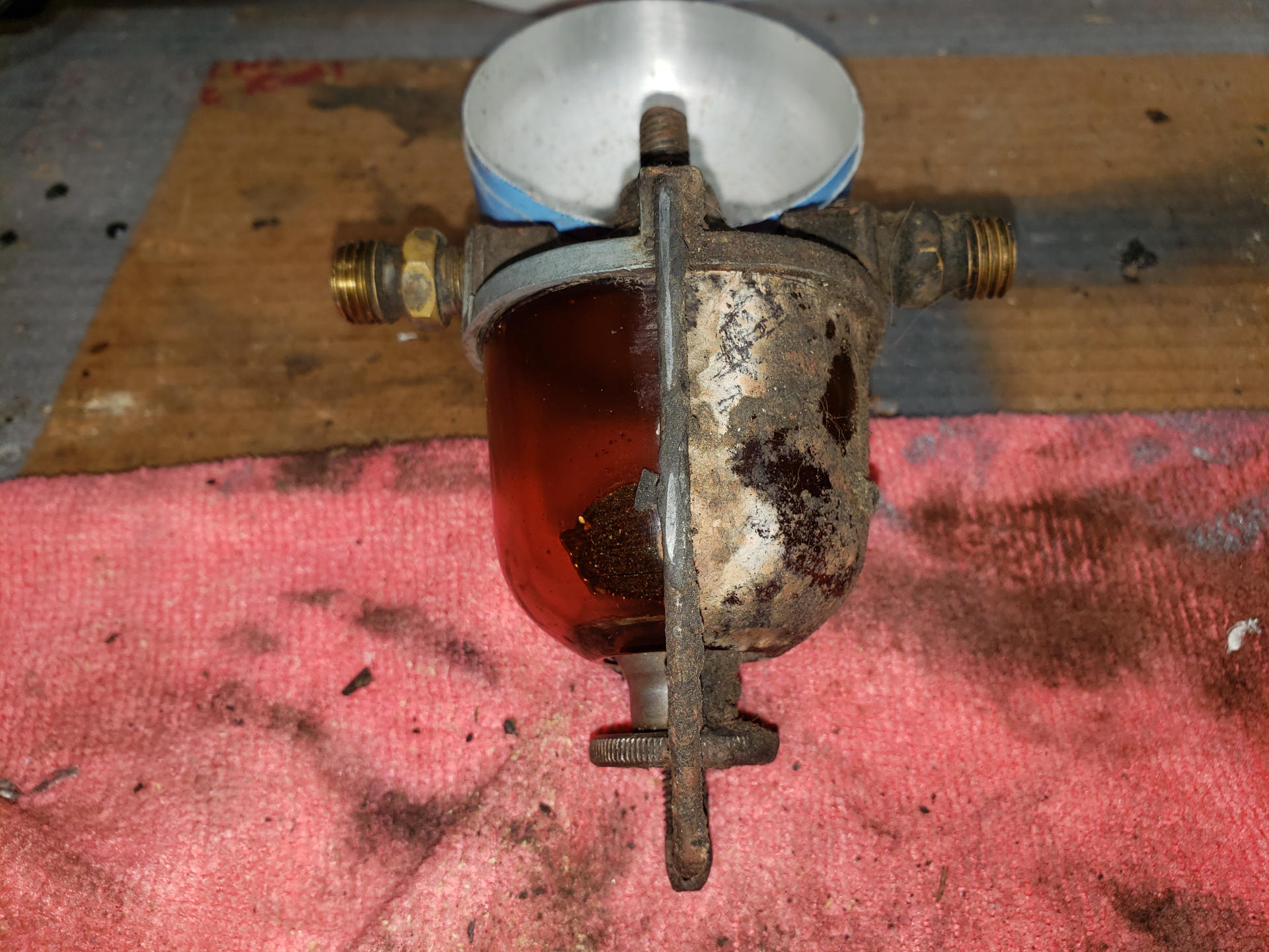

I cleaned and rebuilt my old fuel bowl tonite. Looks pretty good now! I kinda like the glass bowl version vs. the new, spare one on the right. Now I have to figure out where I put the bracket.
I scraped out the varnish with my thumbnail.
There's still a little cleaning to do, but it looks much better than in the first pic...

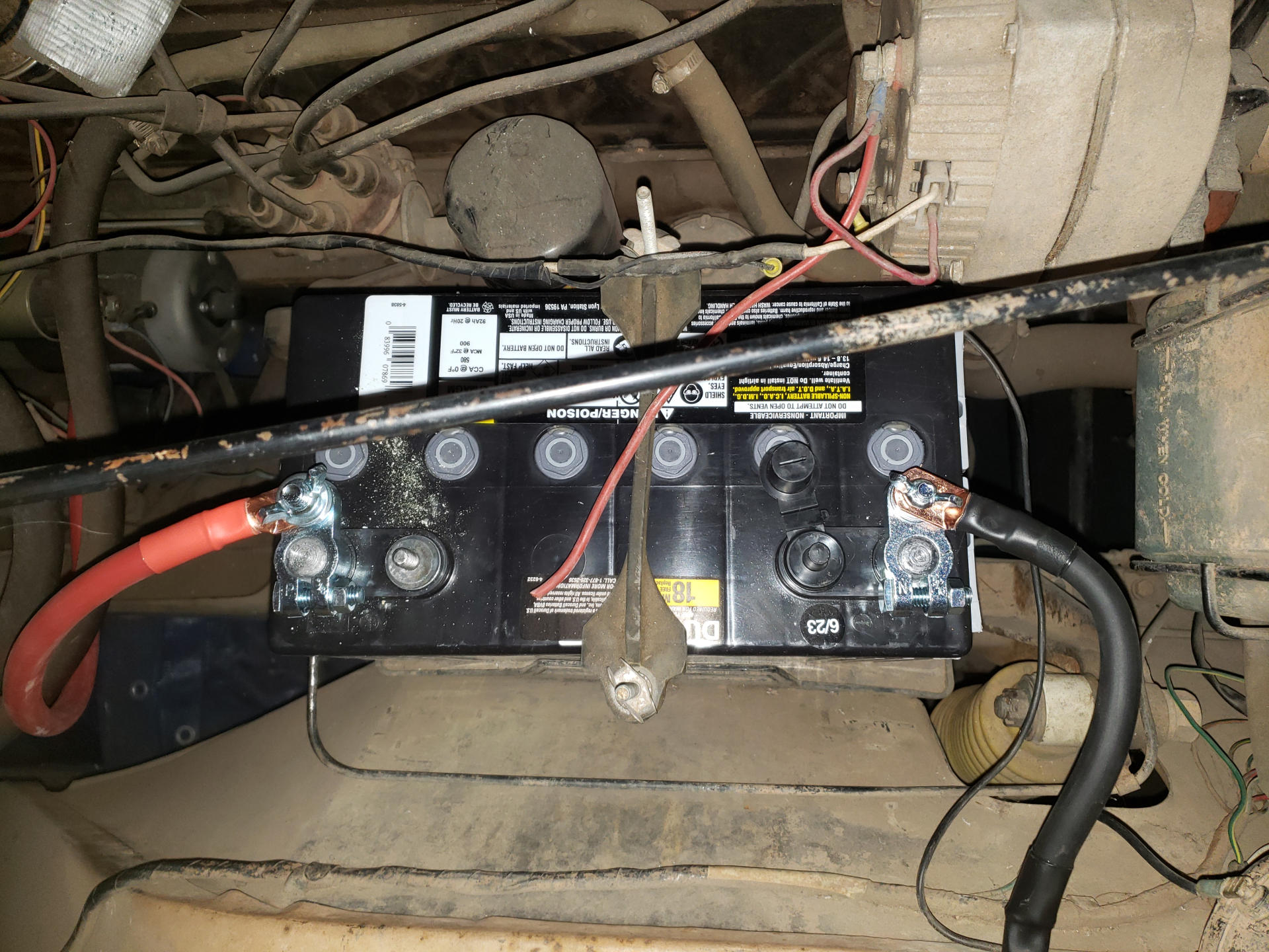

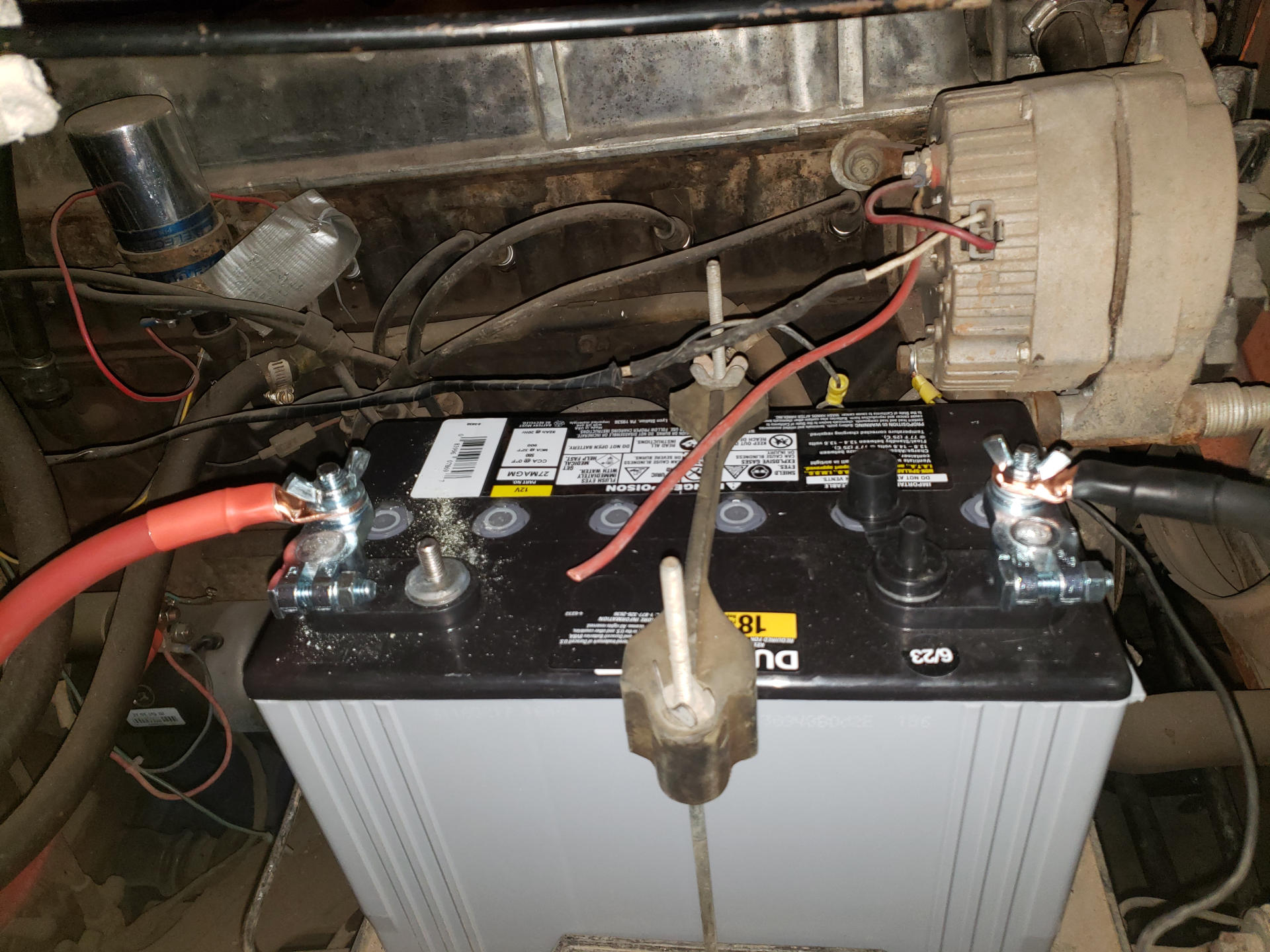

I built some new battery cables last nite from 1/0 welding cable. I'm using marine terminals for now, as the wingnuts make things easier to remove while I'm troubleshooting my lights. I'll probably swap over to MilSpec terminals when I've figured it all out. I have a new starter ==> frame ground strap on order, but think I'd rather build a cable for that too. Can someone tell me what size wire to use? Almost forgot: I have new copper lugs on order for the alt cable too. The old one was corroded badly. I'll splice in new wire and shrink tube the junction. BTW, the battery is a Duracell Grp 27 AGM with dual posts Marine battery I picked up at Sam's Club. I originally bought a 31, but it bumped against the alternator.
