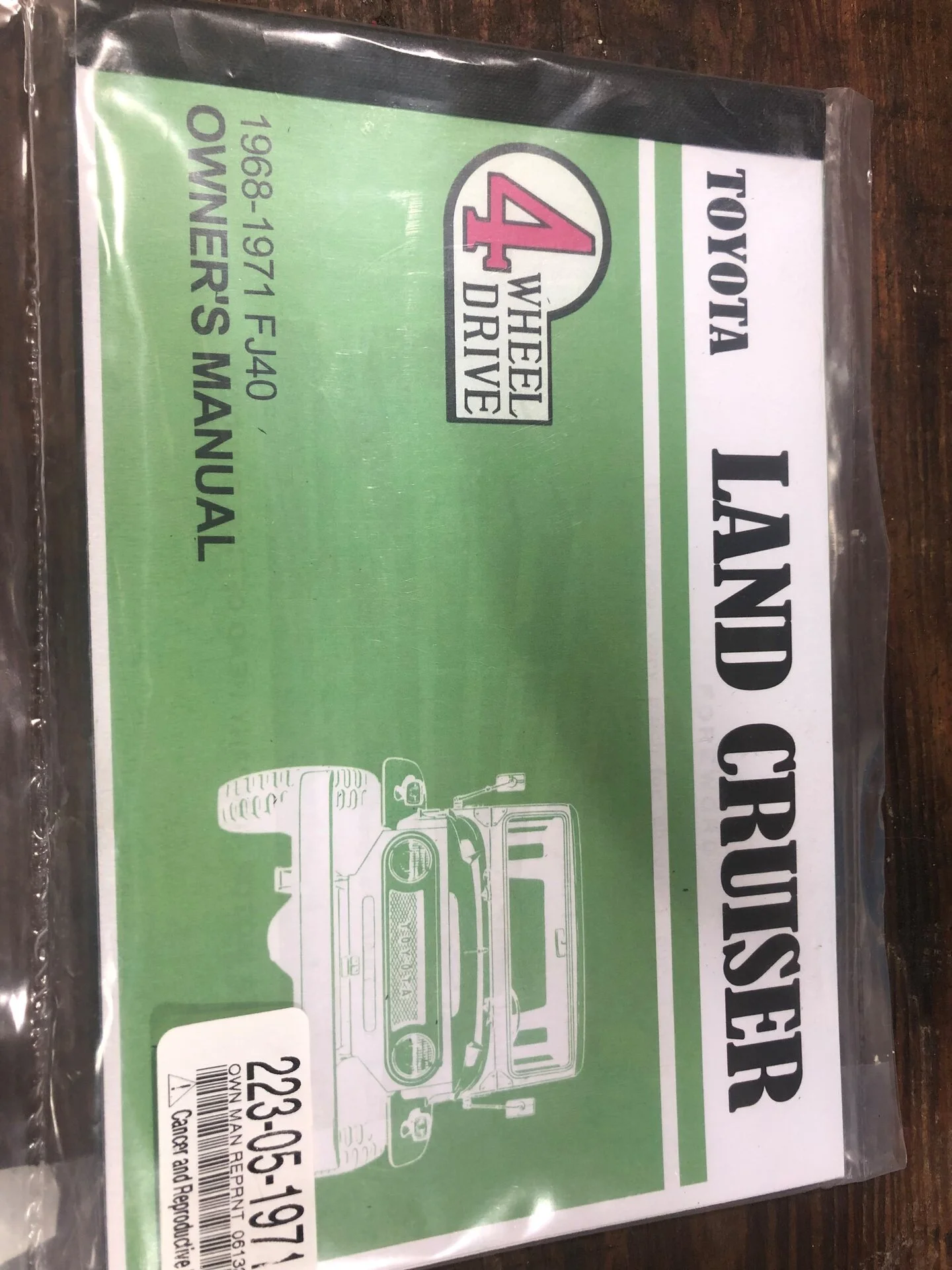

Ordered a reproduction Owner's Manual. Pleased with the production quality.

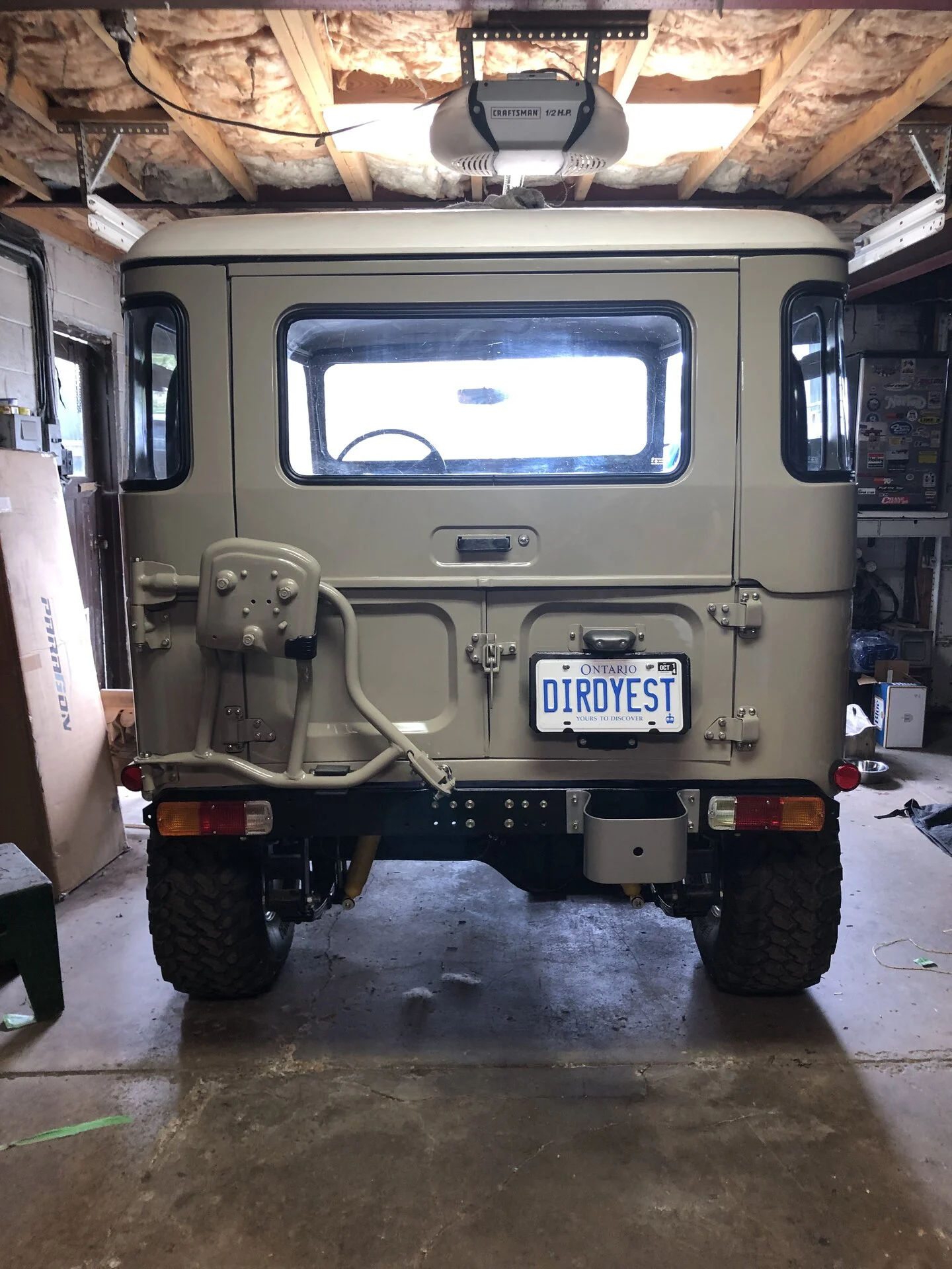

Added a recovery point in the rear along with a new kinetic rope and soft shackles.

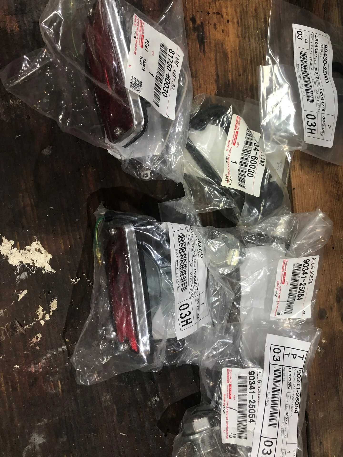

It is always cool to open a box of parts from the Toyota dealer. New rear side marker lights and drain plugs & gaskets.
You won't want to use that recovery attachment if you receiver is the common FJ40 type that bolts to, and hangs just below the rear crossmember. If your stuck and pull on it, it will bend the bottom of rear crossmember up and out. Fyi.

There is no doubt that the rear cross member is not a very great mounting for the receiver hitch and is susceptible to bending at the midpoint. However, our off road use is on the beach. So, to the extent needed, recover should be for extraction from soft sand. 😀. The kinetic tow rope hopefully prevents any sudden snap. We will see.

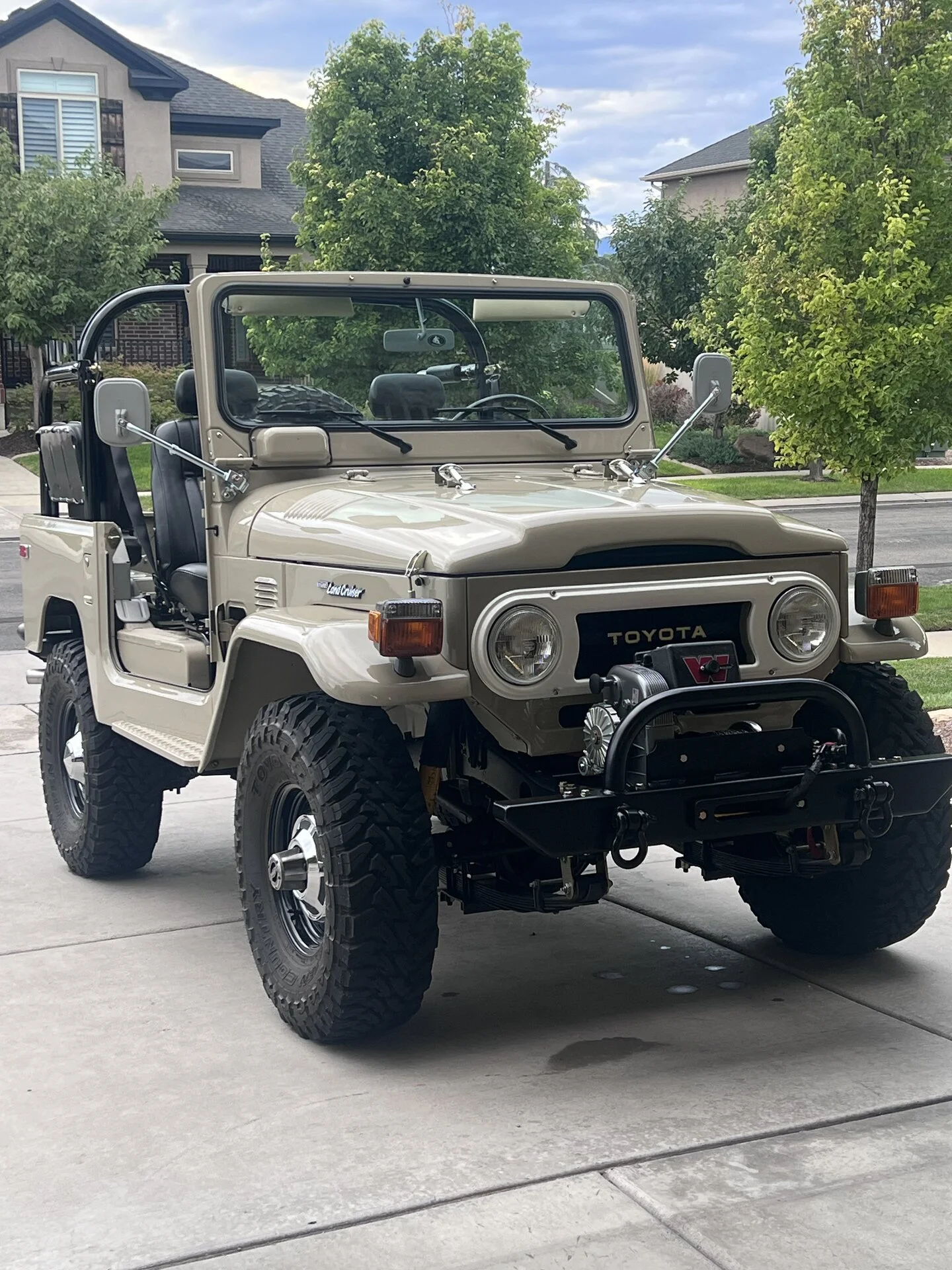

Basically over the last couple of months

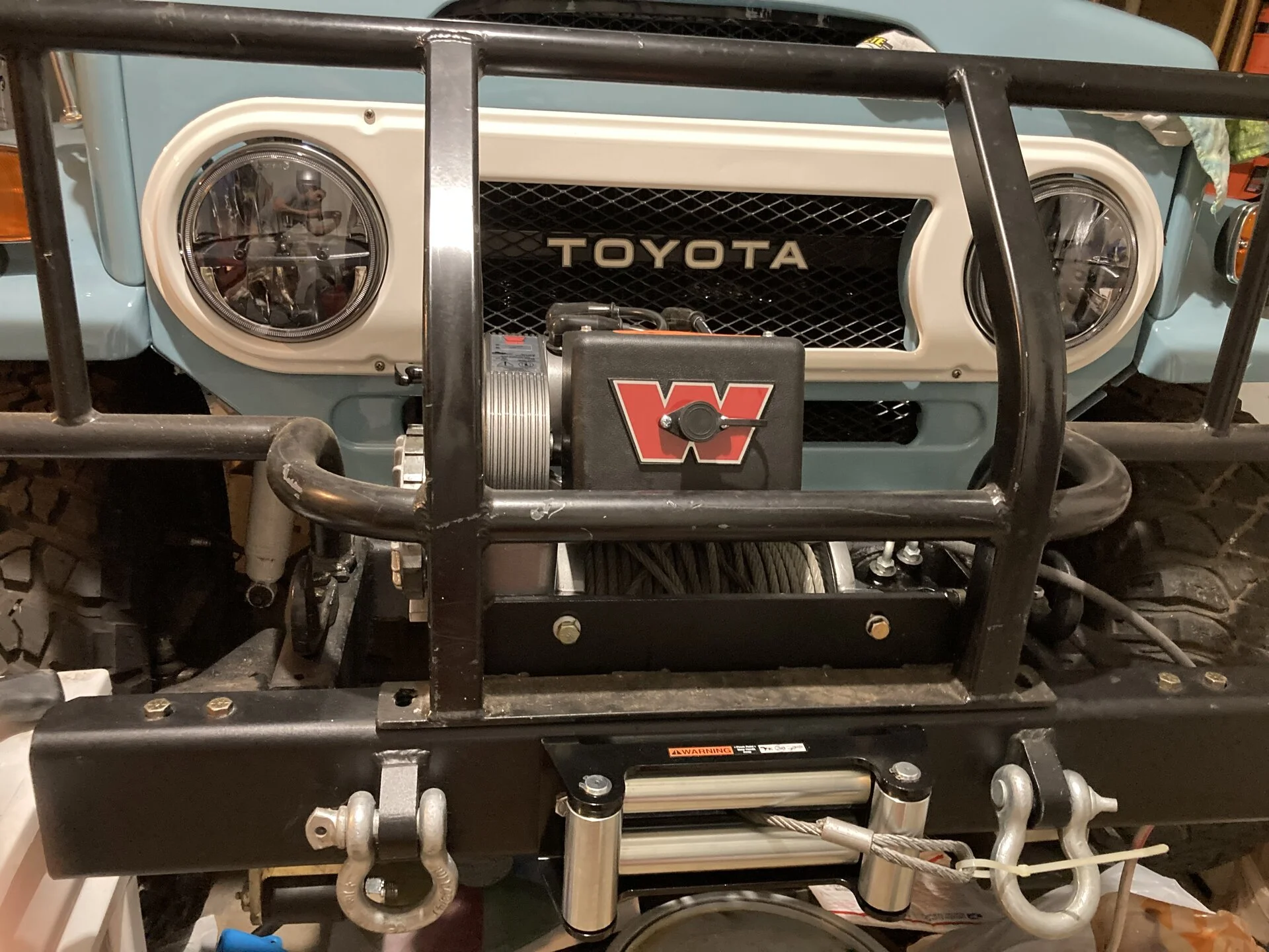

Restored an 8274

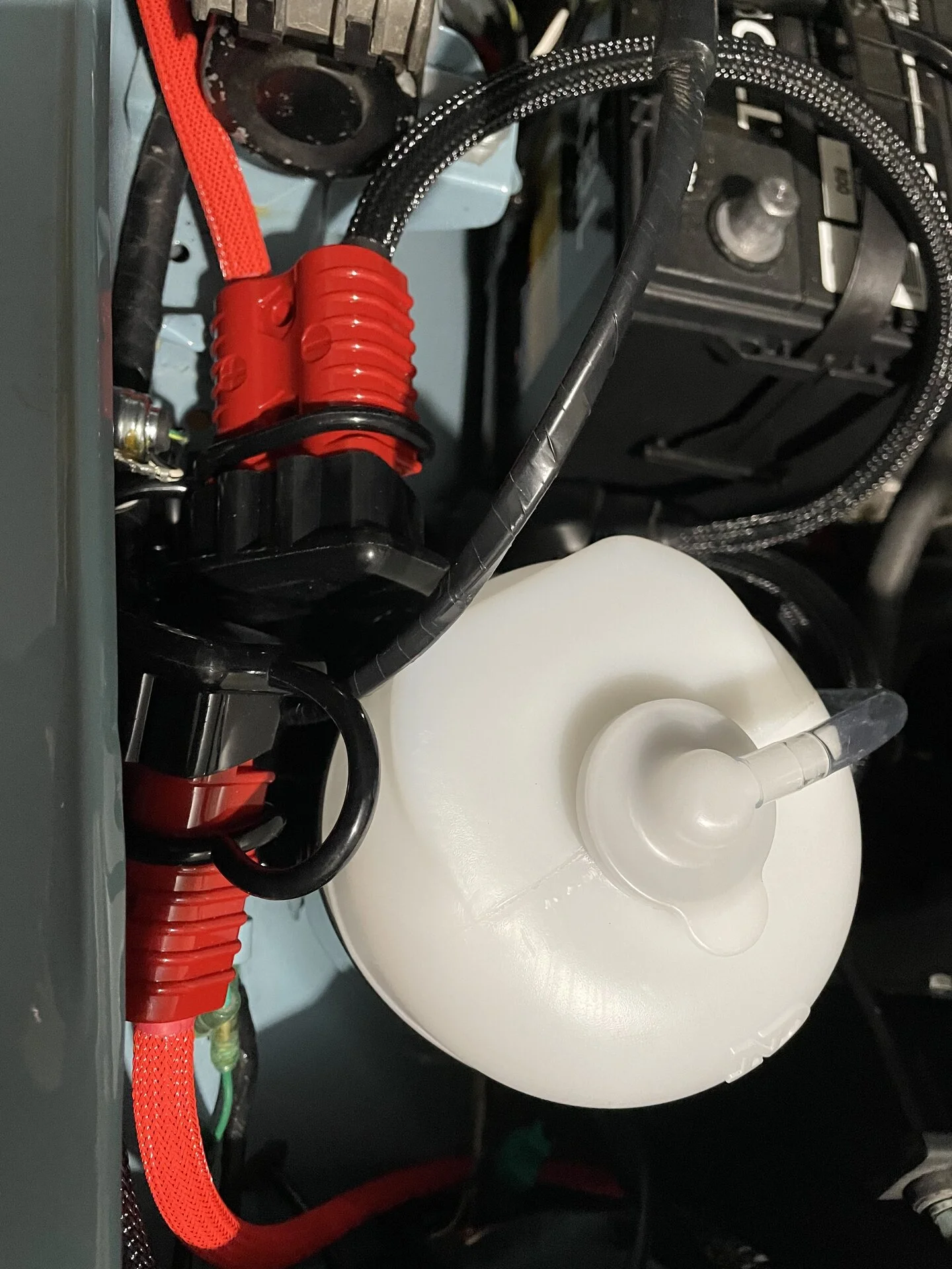

Bought a cable disconnect from @Fourrunner for the winch
Overflow radiator bottle from city racer and powder coated the bracket.
Have done other things as well.

The kinetic strap will help a lot. So will a little digging before you try to pull out the stuck jeep you’re rescuing.
My hitch got bent inwards when I lost traction on steep bedrock and slid backwards and it hit. A few years later I dragged a broken Chevy back to the road with a chain (don’t recommend)… after that it was straight again. ;)
