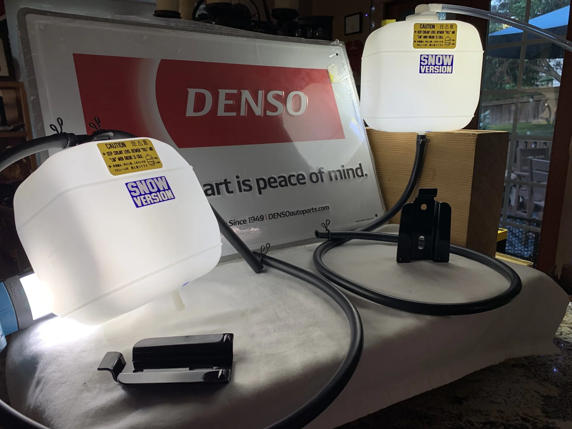

16470-24010 is now a permanent fixture ......
100% MADE IN JAPAN Genuine NipponDenso ....
- Can be Bottom-Fed or TOP-Fed\
- comes with the correct profile OEM mounting bracket too ....
- Lower-FED comes with a generous 36" of oem overflow hose
- x 3 OEM spring clamps too
- or
- Traditional TOP - FED type , same length your choice

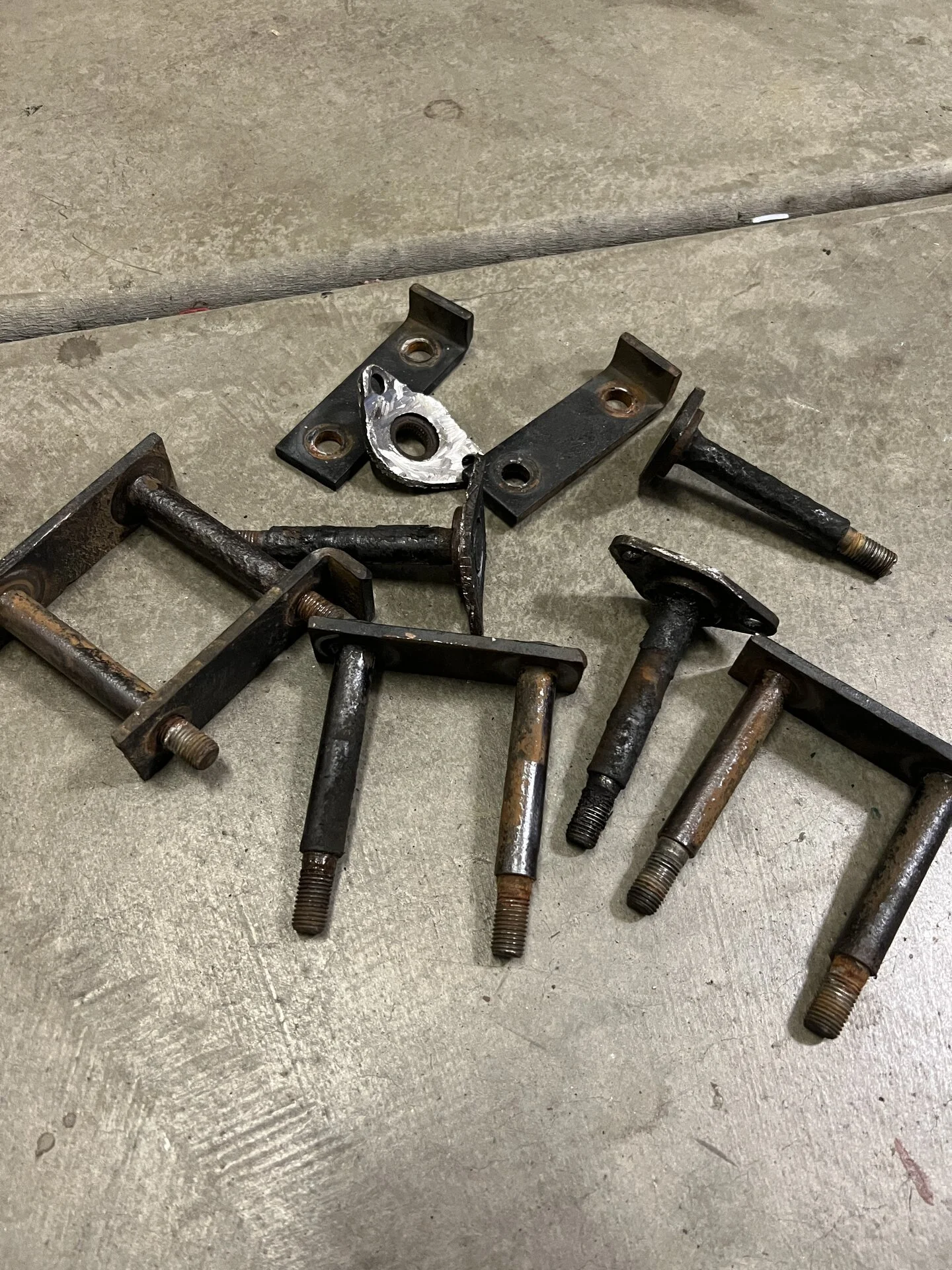

Out with the old and in with the new. The shackles were a breeze, but the pins were a pain in the arse.
The PO put poly bushings on the shackles many years ago, so they came right out. However, the pins were the original rubber bushings and were seized on.
I had to burn them out.
It's true what they say about the handling... way better with new bushings! Unfortunately, I had to cut my exhaust to make room for the shackle, but I will fix it this week.

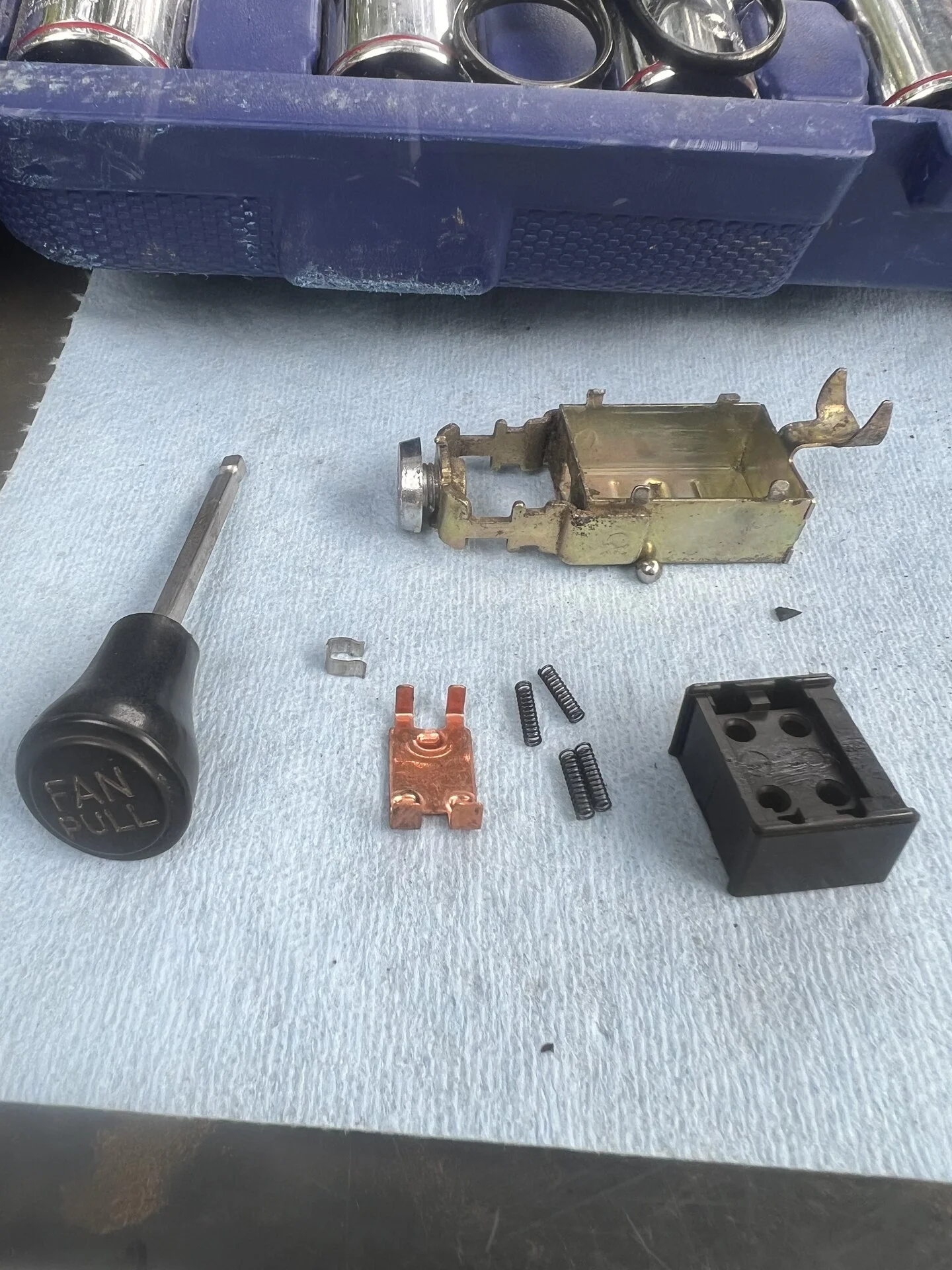

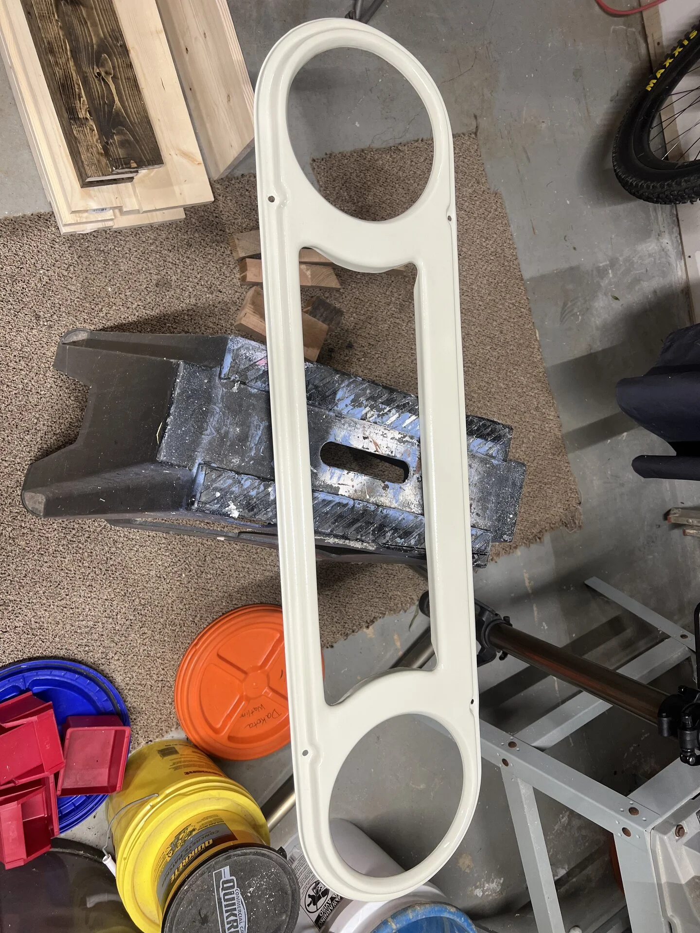

Rebuilt (really just crazy glued the plastic insert that holds the contacts and pull rod in back together) the fan switch as when I pulled it the rod just fell out and no fan!! Pics attached. Also repainted the front bezel (it was poorly done 1st time around by PO with bubbles/chips) with Cruiser Corps spray Cygnus White. Turned out pretty good. Pics as well
