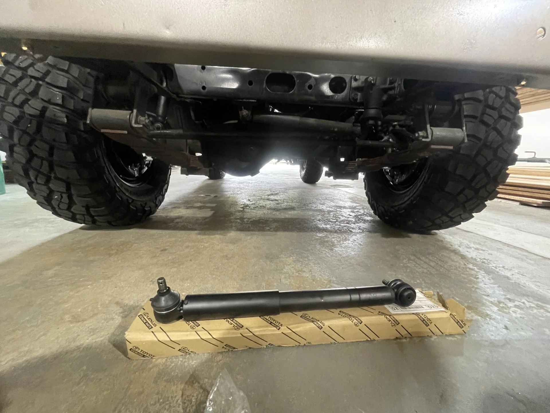

Installed some oem Toyota steering stabilizer goodness this evening. Couldn’t believe the original pins and castle nuts came off in one piece. OTC tool kit made it pretty easy, which I used on the tie rod ends earlier this summer also. No affiliation with otc.

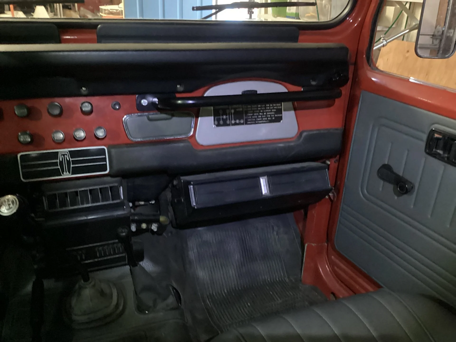

Got parking brake done - speedo cable installed, and added a lock for the ambulance door, and heater valve. Drove 5 miles - all smiles. Rattles with passenger door and wd40 did the trick - sort of.

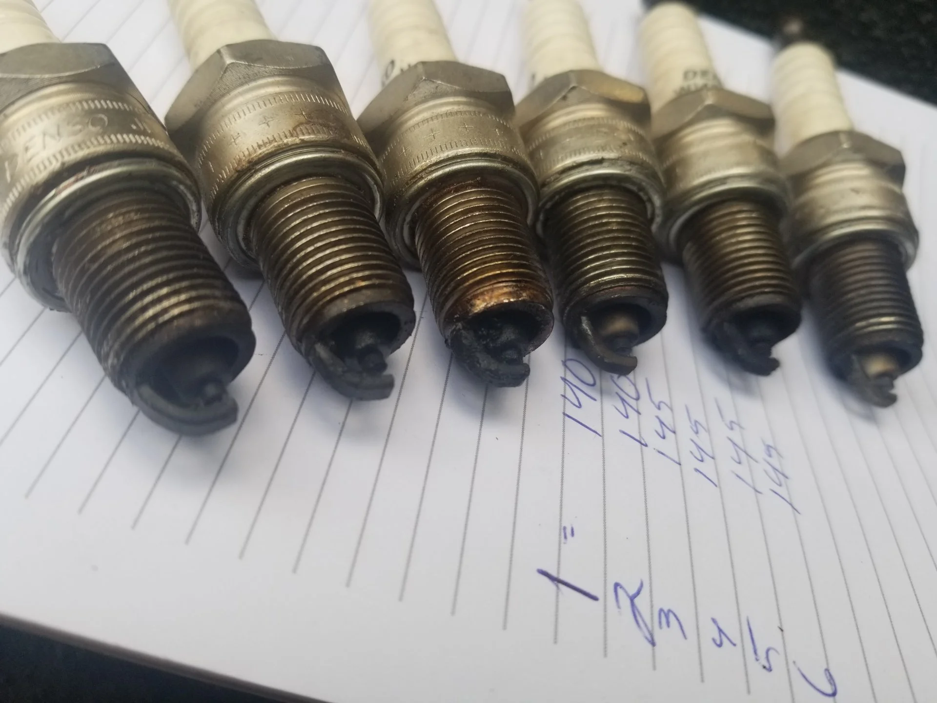

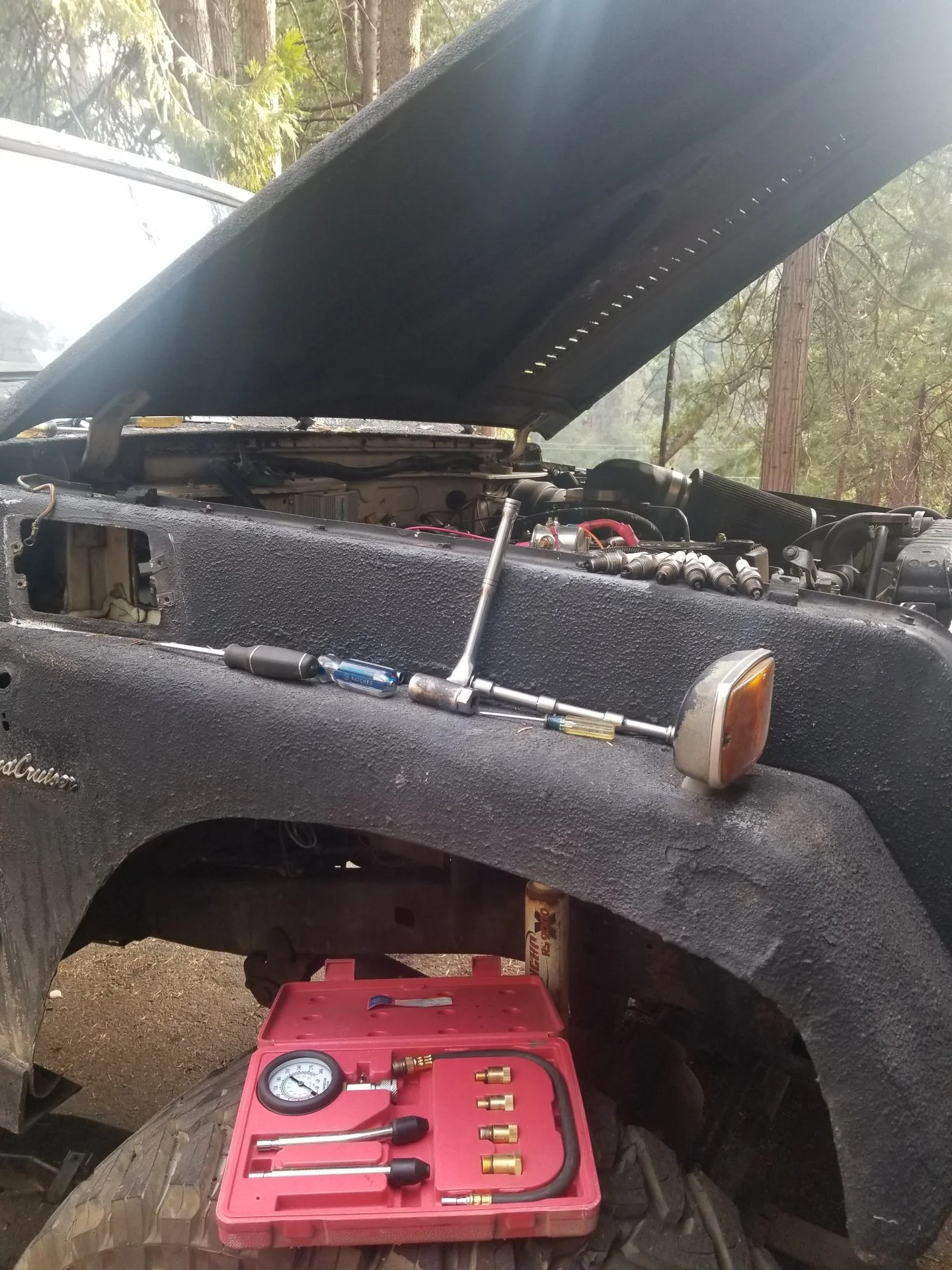

First tune up since the Rubithon, which was very taxing on both driver and vehicle. Pig even over heated a bit one day. So, waited for the shade of the trees, warmed it up, shut it down, pulled the valve cover and adjusted valves, put some new glue on the cork valve cover gasket, pulled the sparkplugs (they looked awful. Oil-fouled mostly, and they were new a month before Rubithon. Valve seals?) Borrowed a compression tester because i don't trust my harbor freight compression testers, did a compression test, don't trust those numbers either because it's also from harbor freight but it still had it's plastic box. Cleaned up the plugs and put them back in. Started it up and checked the timing, I'll leave it at 18BTDC for now.

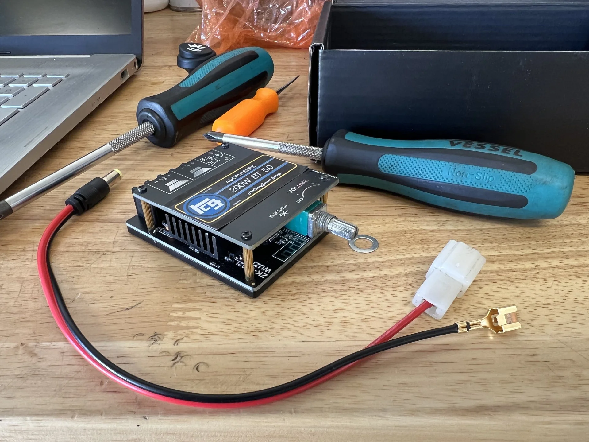

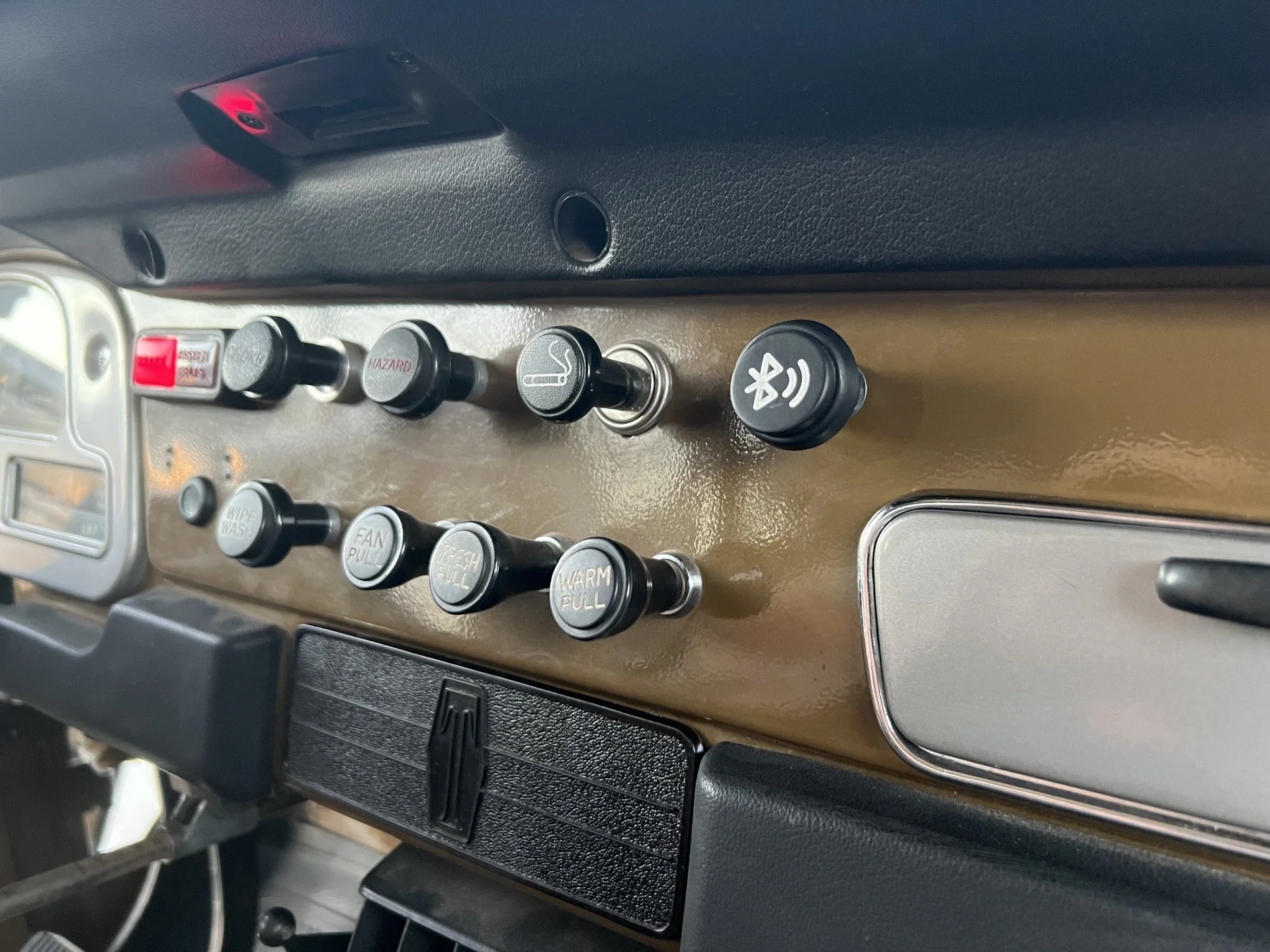

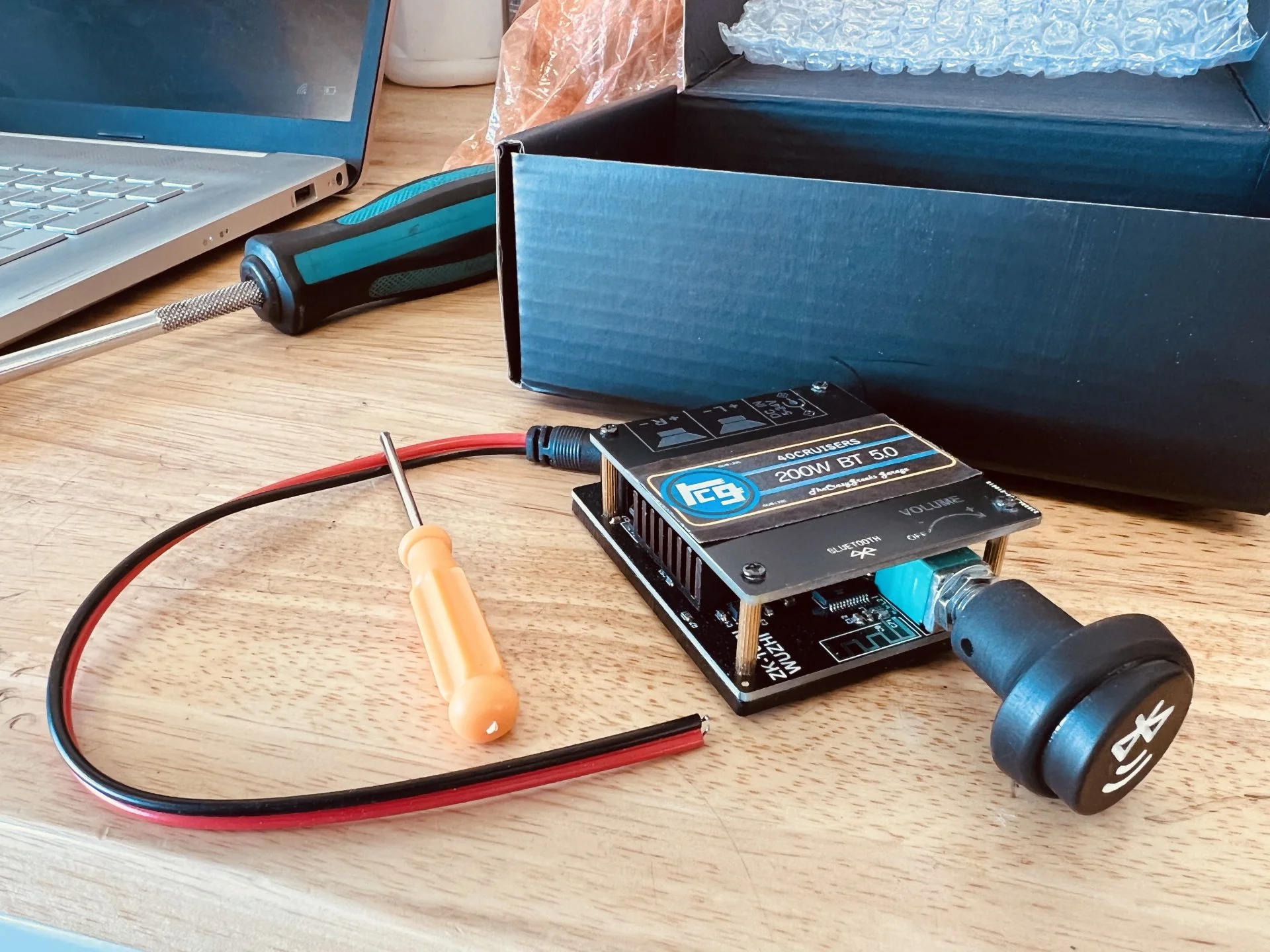

Installed @thecrazygreek ’s amp. Works great, sync’s quick to phone and with just a single 4x6 in the factory mount, it’s plenty loud for me. I’ll probably find a place to put the other 4x6 I have, just havent decided where. Whipped up a couple connectors so it all works with the factory connectors and no one is the wiser aside from the Bluetooth knob. Even used the factory spade on cigarette lighter for a ground, it really is a neat way to have audio and not have an ugly radio in the dash.
@mattressking Mind sharing the source for the bullet style electrical connectors you used here?
Those are leftovers from cycle terminal - had a bunch when I used to wire up motorcycles. Once I'm out of them, I'm ordering Yazaki stuff since it matches the factory sheaths. Eastern Beaver is a good resource for it, haven't looked around in a while to see who else sells Yazaki by the bulk.
