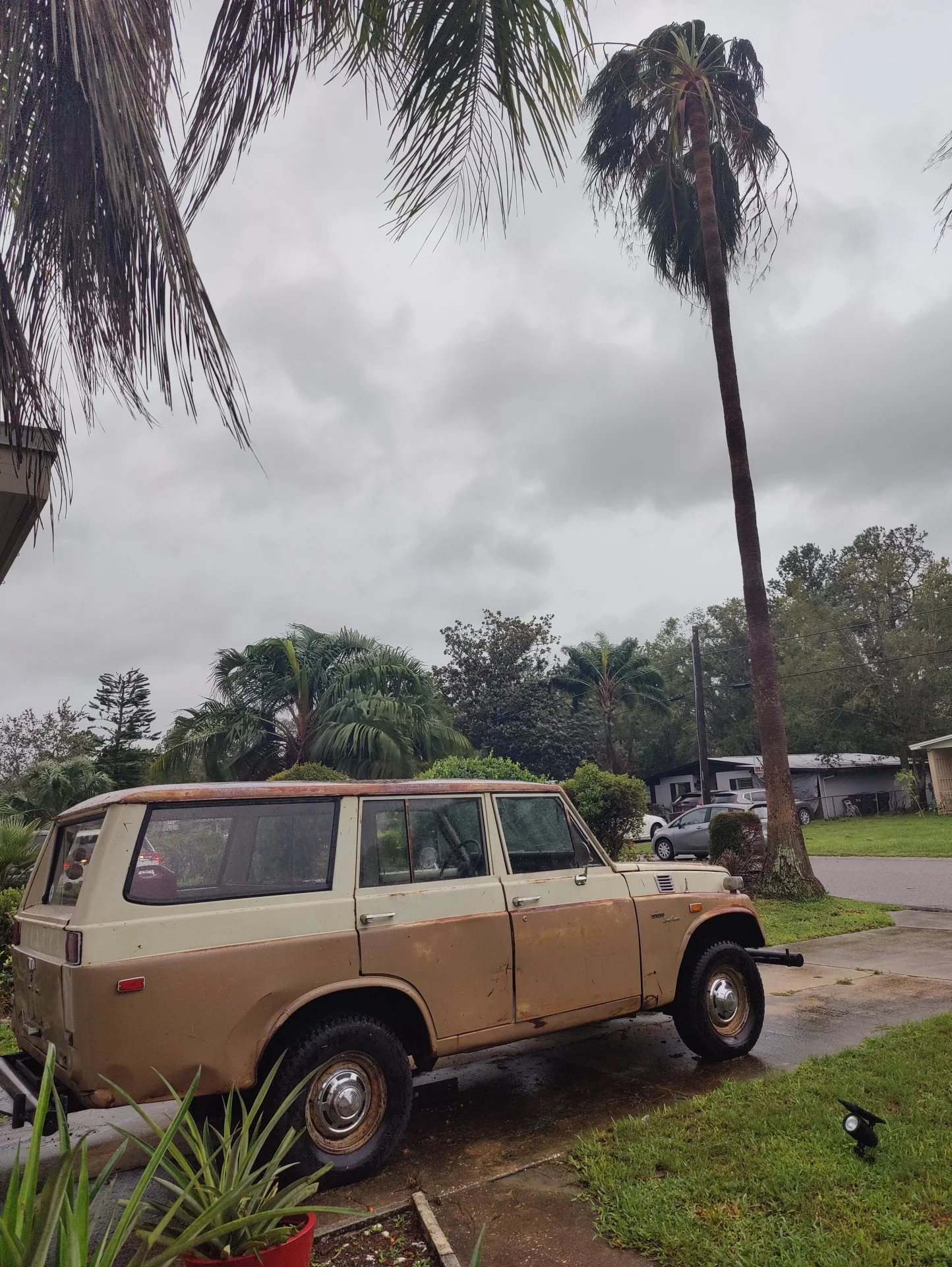

Nice cool Florida morning. Took daughters to school and drove to work. Gave her a good rip from a stop light in town and got a text from a buddy a little bit later:grinpimp:

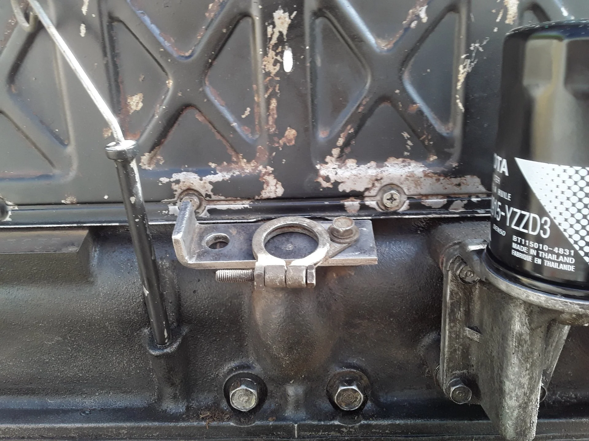

After I reinstall the spark plugs, which were removed to make the crank turn with only a 3/8"-Pittsburgh-ratchet, I replaced the hole in the block, where the distributor was, with an old shackle plate so that the mice don't get in. The carb and ignition don't stay outside, no matter how bad I might think they really are. Duct tape over the exhaust and intake on the head - keeps the mice out, because engines are horrible to maintain around bird feeders. I'll do a full oil change when I get the crane out, or I'll just keep manually turning the oil pump with the filter off.

You might consider backing off the rocker arms so the valves are all closed to seal the cylders and it relieves the pressure on the valve springs.

Just trying to keep up with the one that is on the road / spinning. I should have used my old-time oiler to put a coat on top of the pistons when the plugs were out. These things will 'last forever' (outlast me), if you keep up with them. Which reminds me, check the PVC for wasps, and maybe use a loose fitting bolt screw to keep stuff from entering that passage as well.

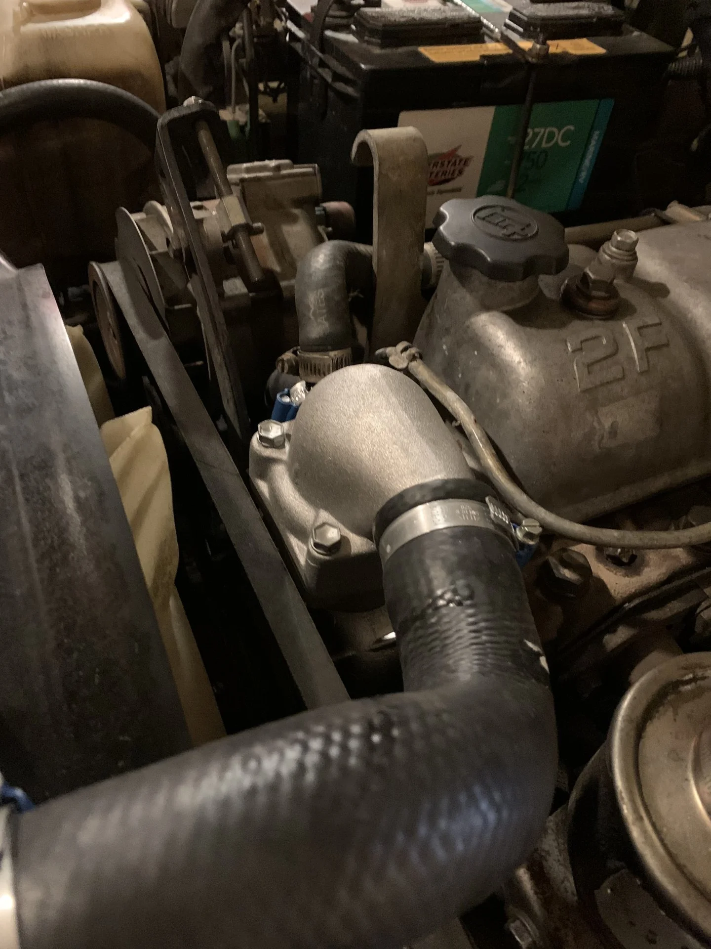

With the straight 6 that does run, quite a bit of vapor collects at the PCV valve. That part is cold, and the blow-by is vapor rich because my rings and bores are tired. I should go to the auto store, and use some exhaust-wrap to make an insulating sock for that area of the side cover panel and PCV valve tube. Fortunately, I don't have oil entering back into the intake. Pull the PCV valve after the temp drops below 20F, and if you have foam there, consider an oil change more than once a year.

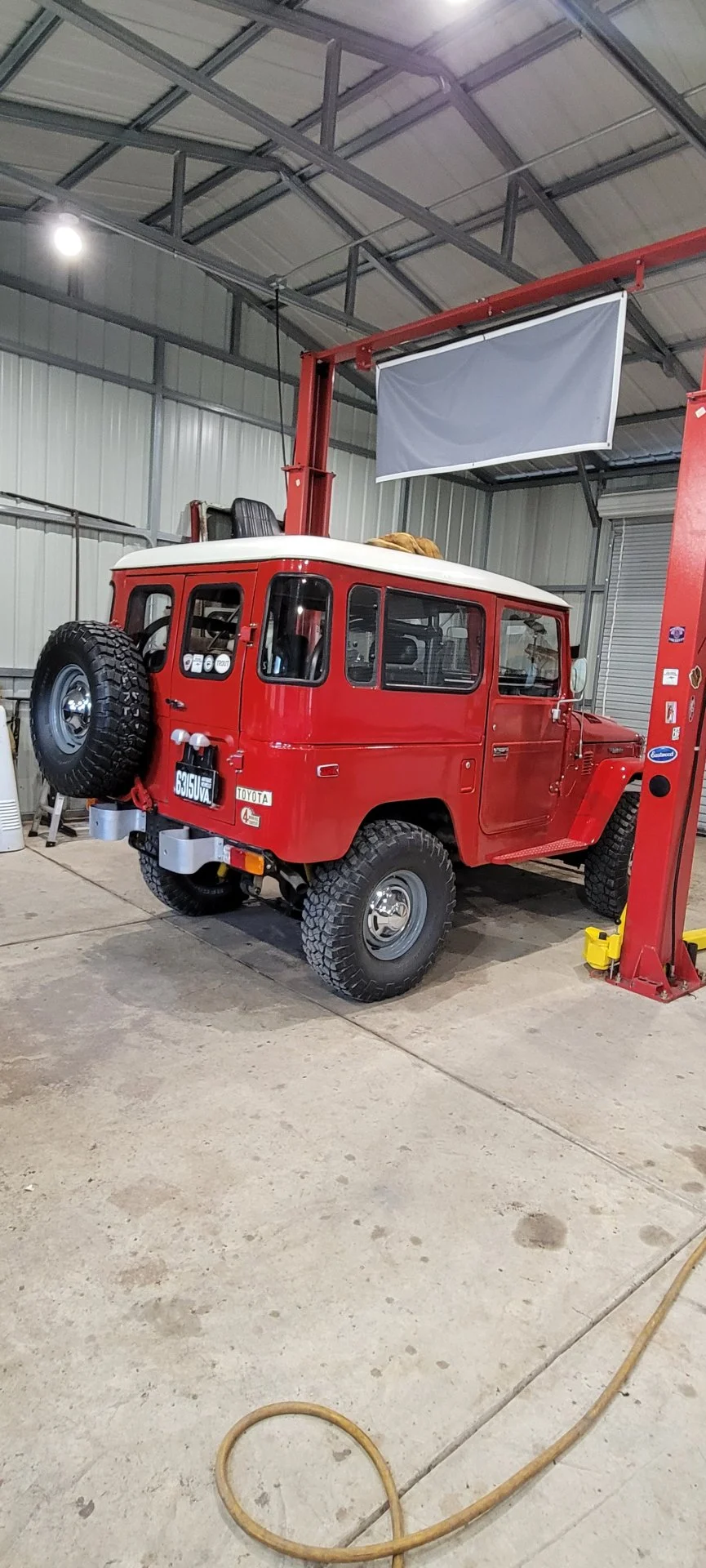

Rainy day here in VA. Got the top on and the PSA in place.
