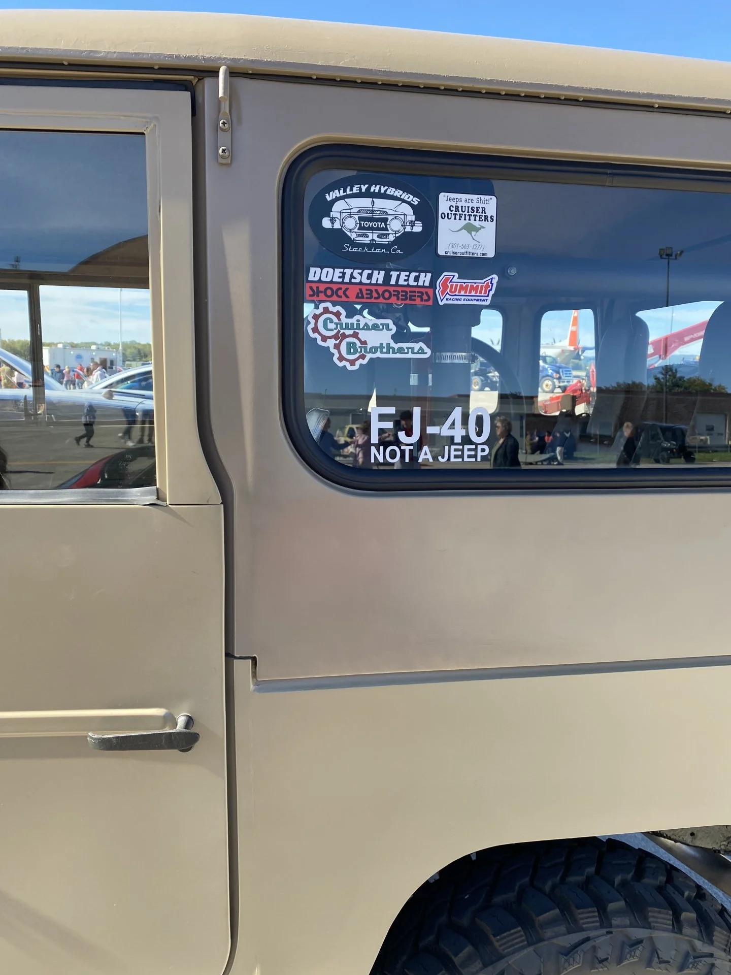

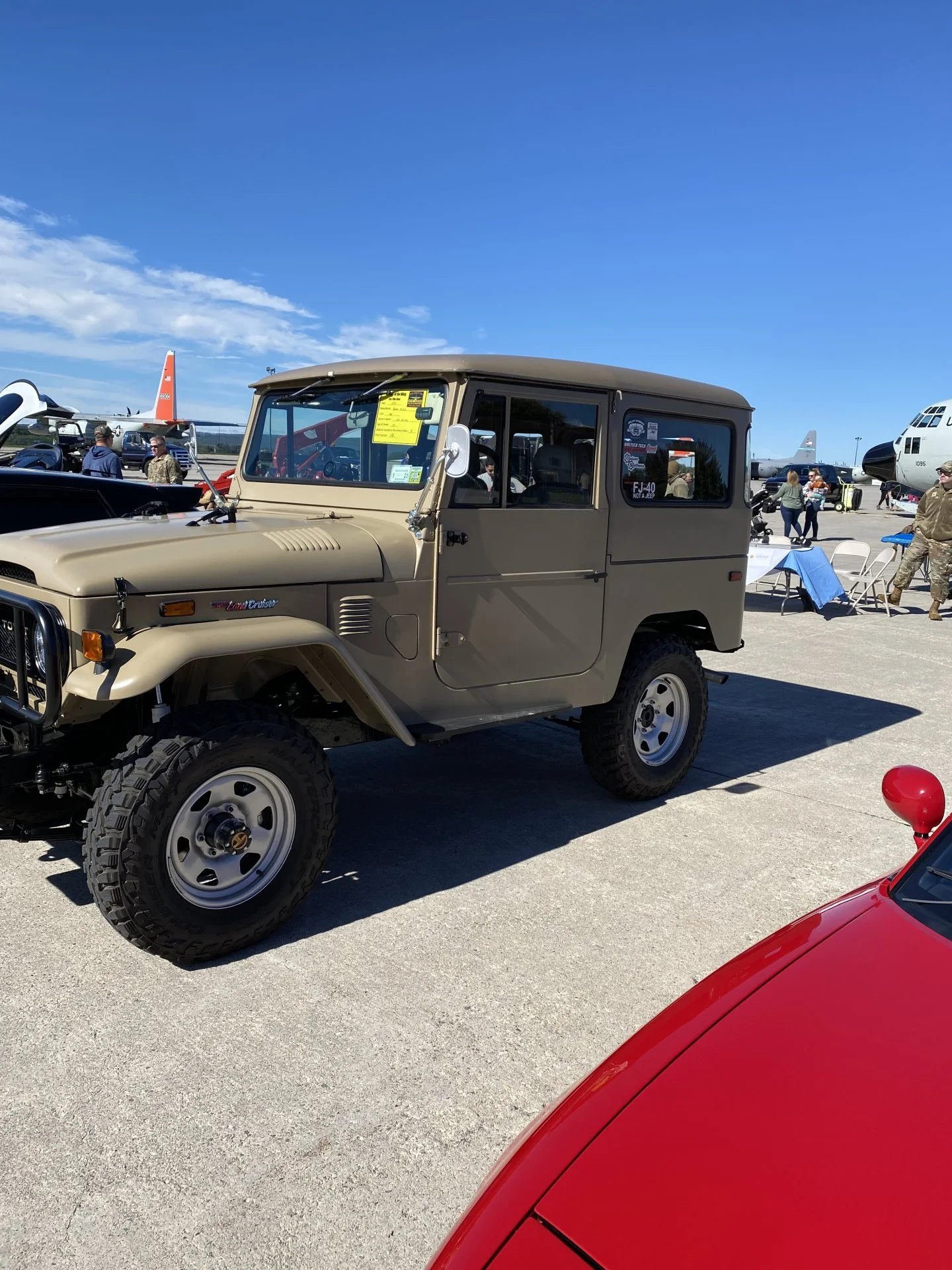

Went to a car show at the local Air Guard
base

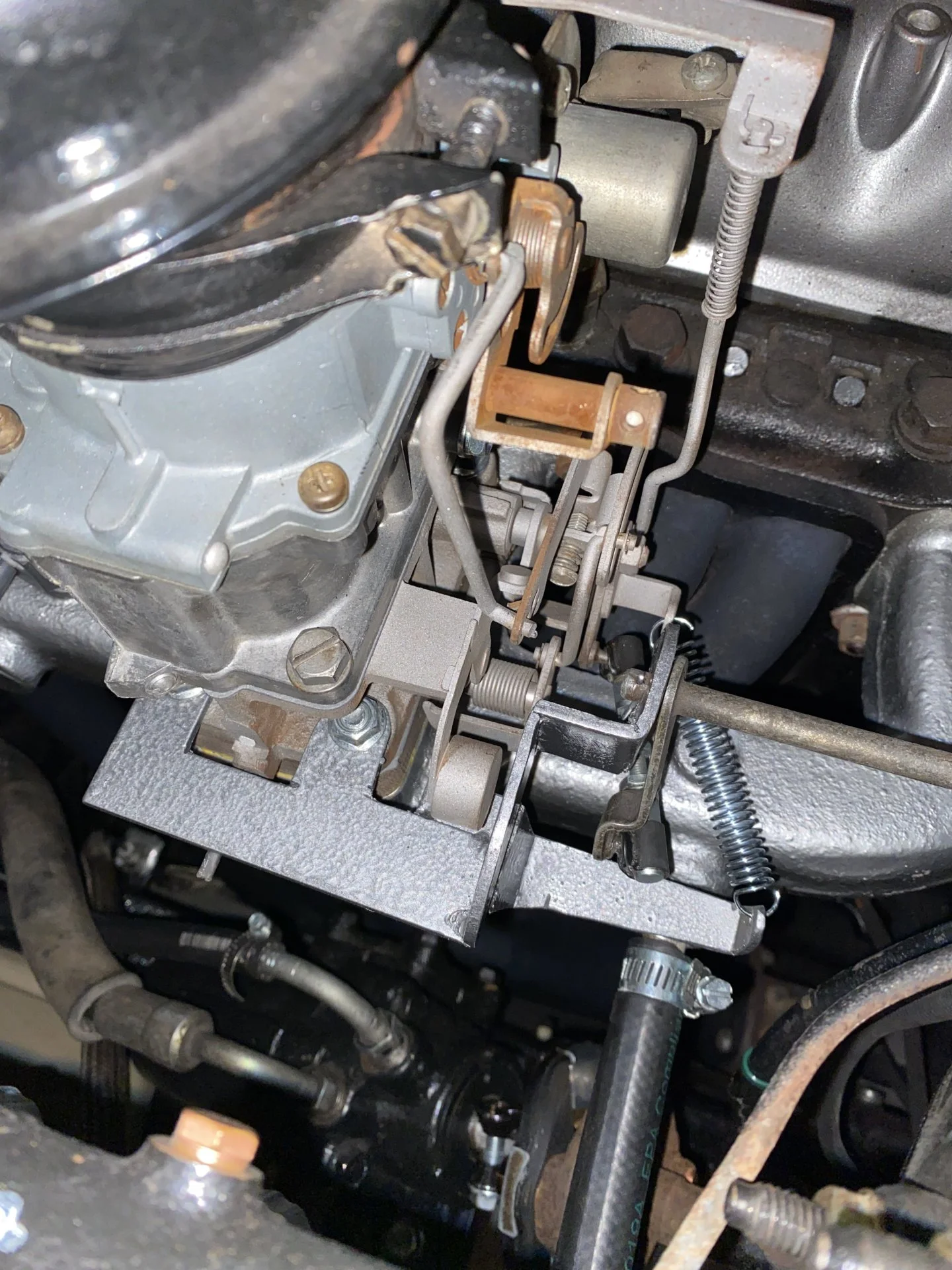

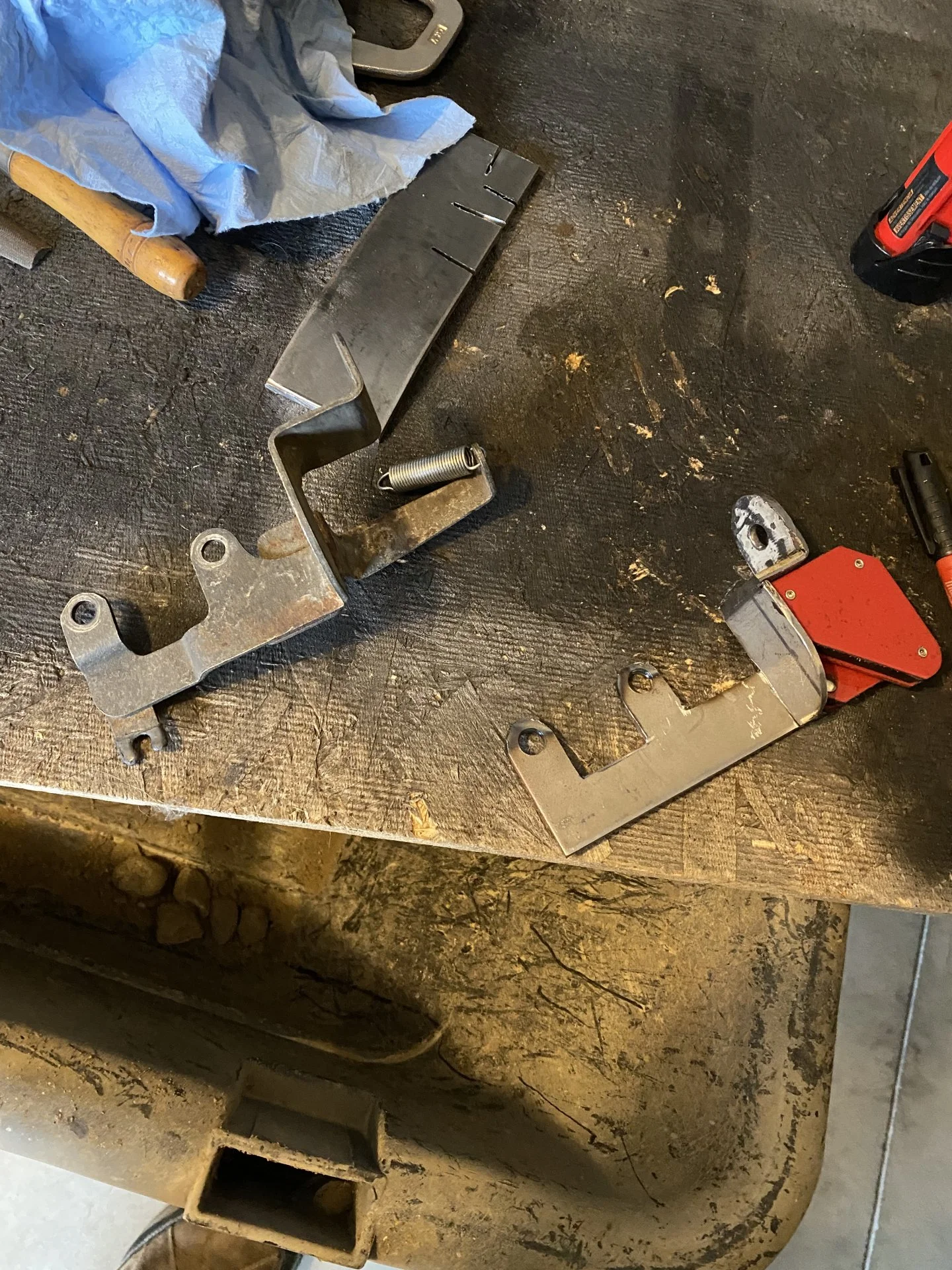

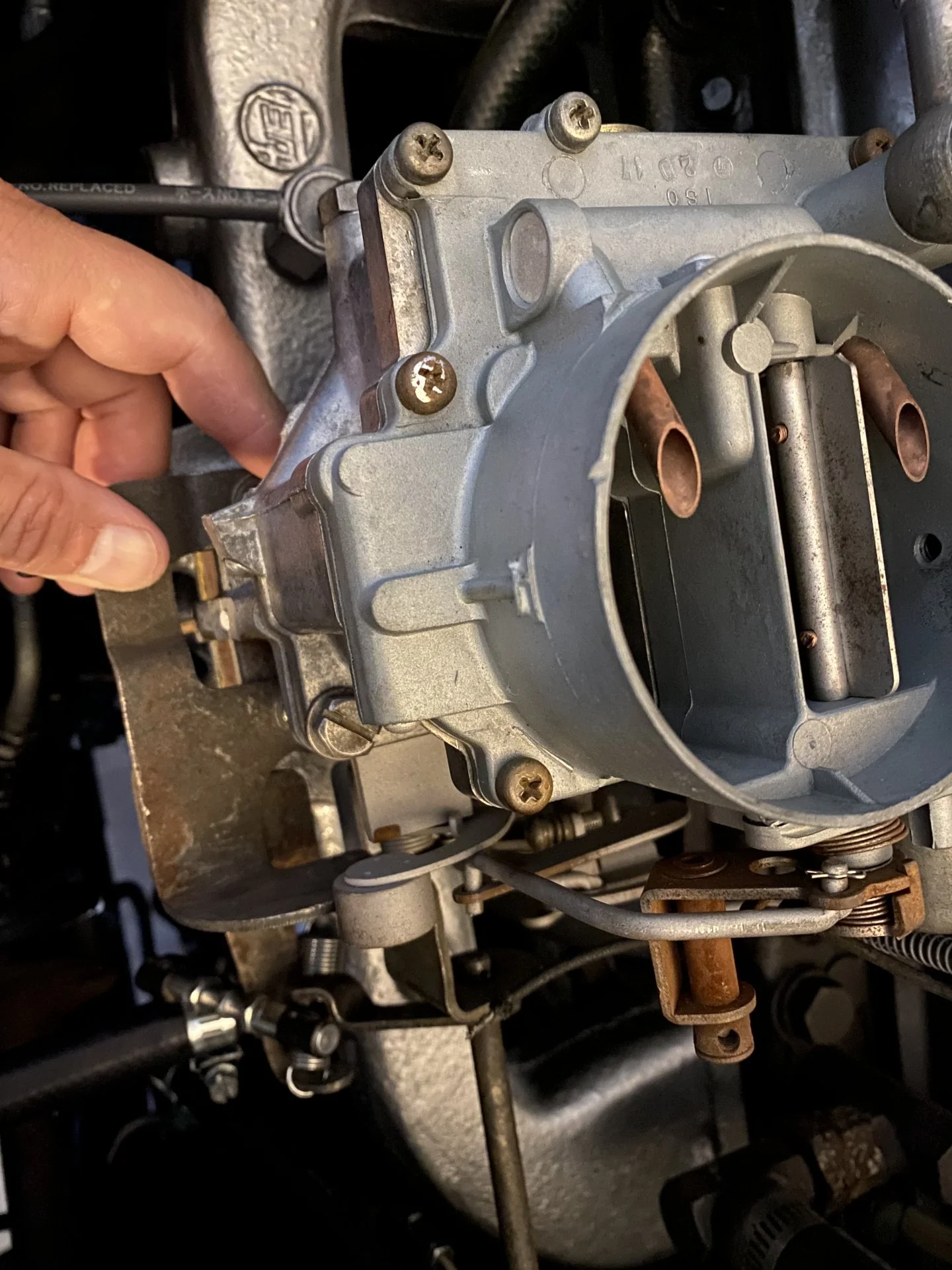

So, carburetor update. Started with a Weber when I got it, then to a Chinese knock off, Holley Sniper and now a Mark A. Carb. Ran in to an issue as the brackets I had wouldn’t work with Marks carb and I had planned on going to the car show this weekend. A little fab work and bammmm, up and running again.
now ............
that's some SKUNK-WORKS There for dam sure.........
A+ work sir ! :cool: 🍻 🍻 🍻

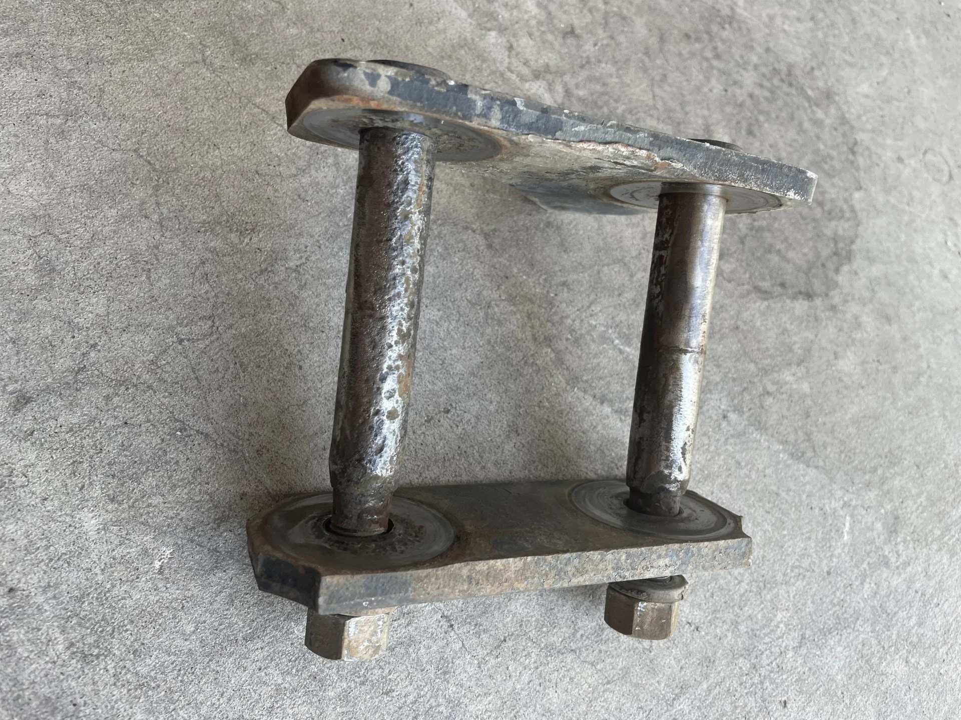

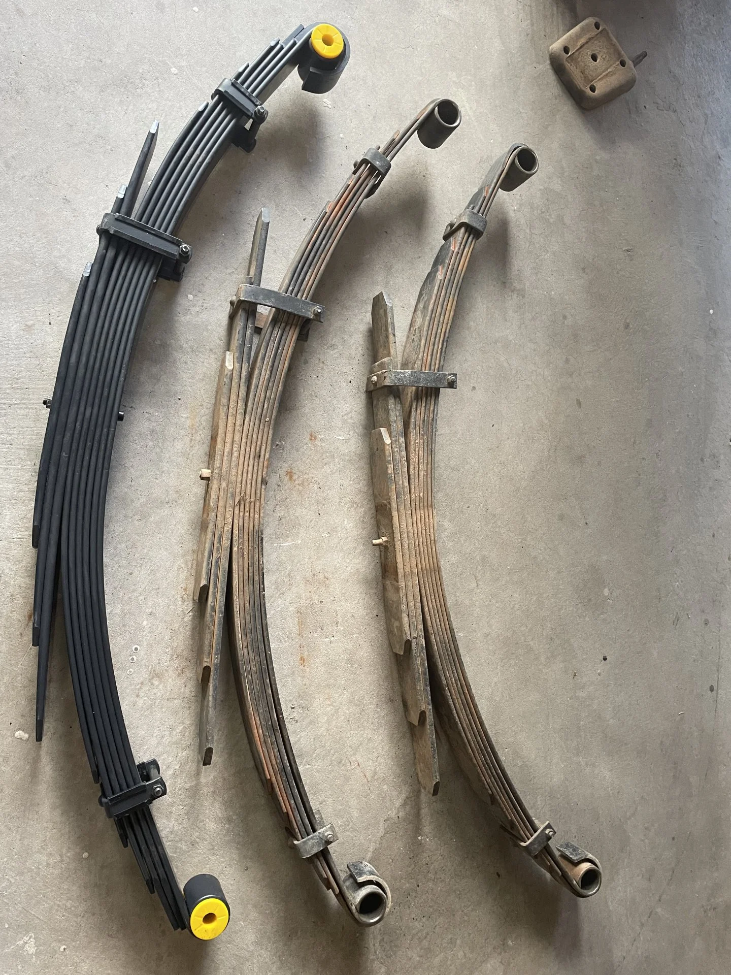

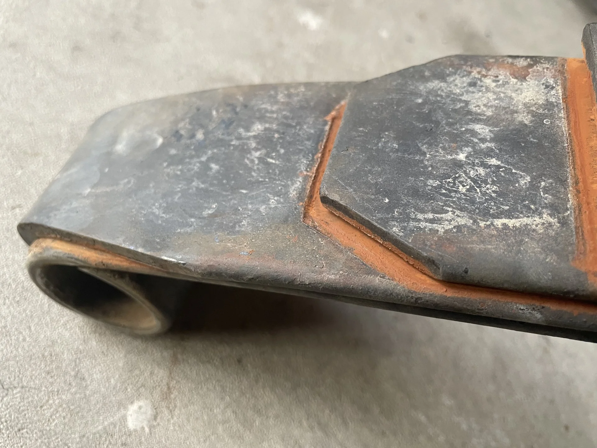

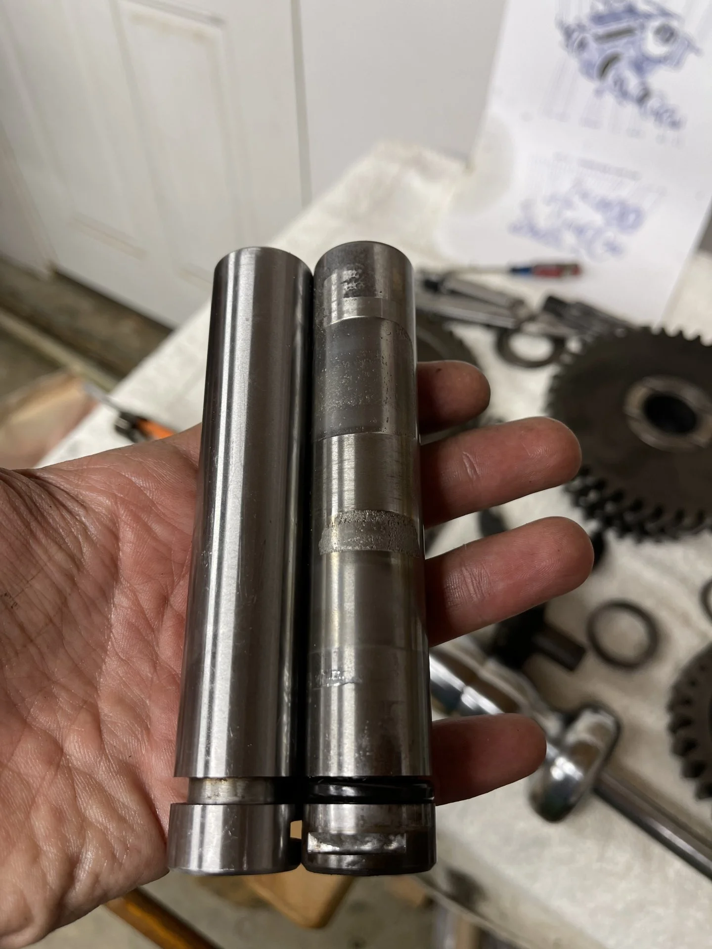

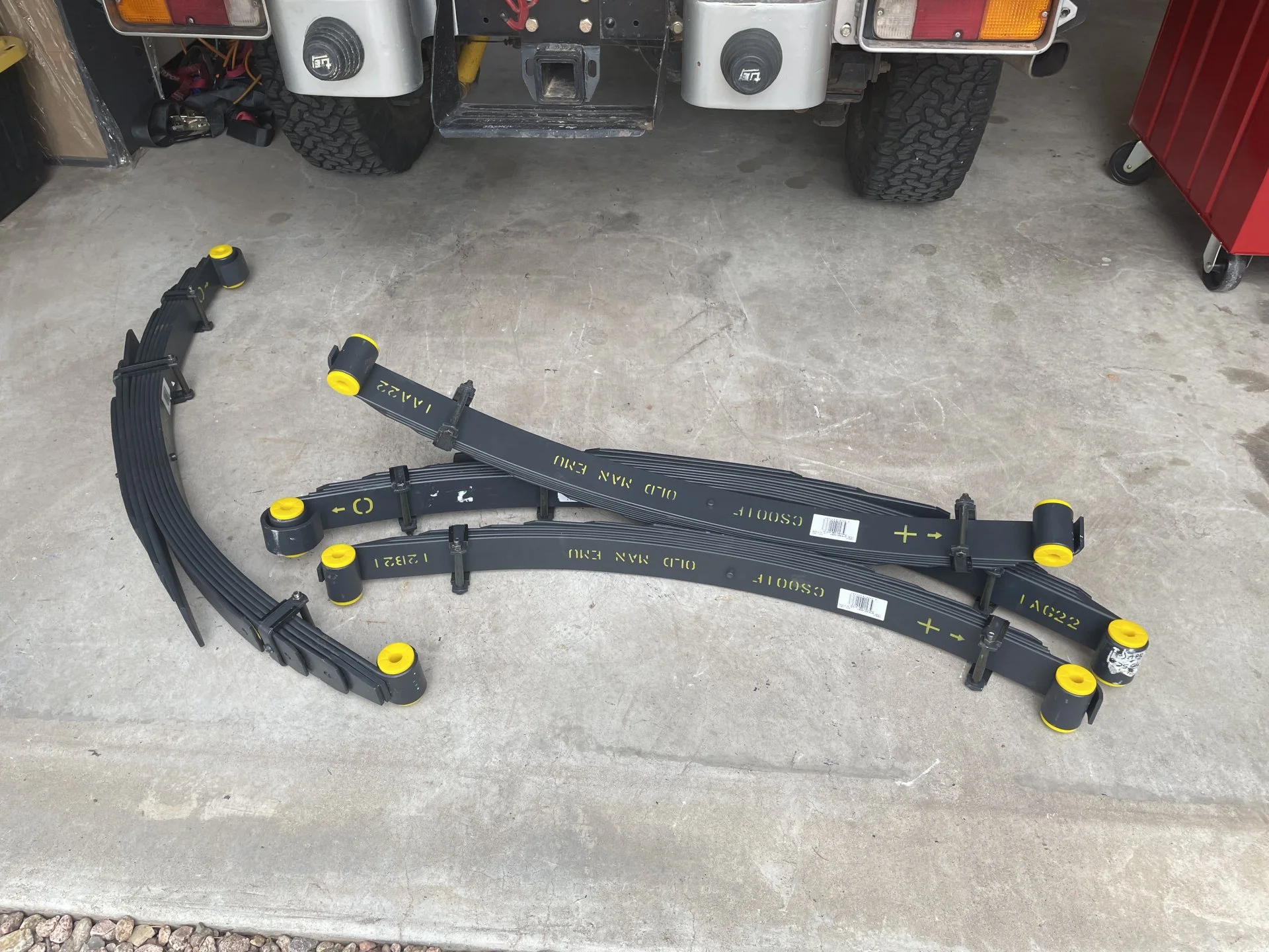

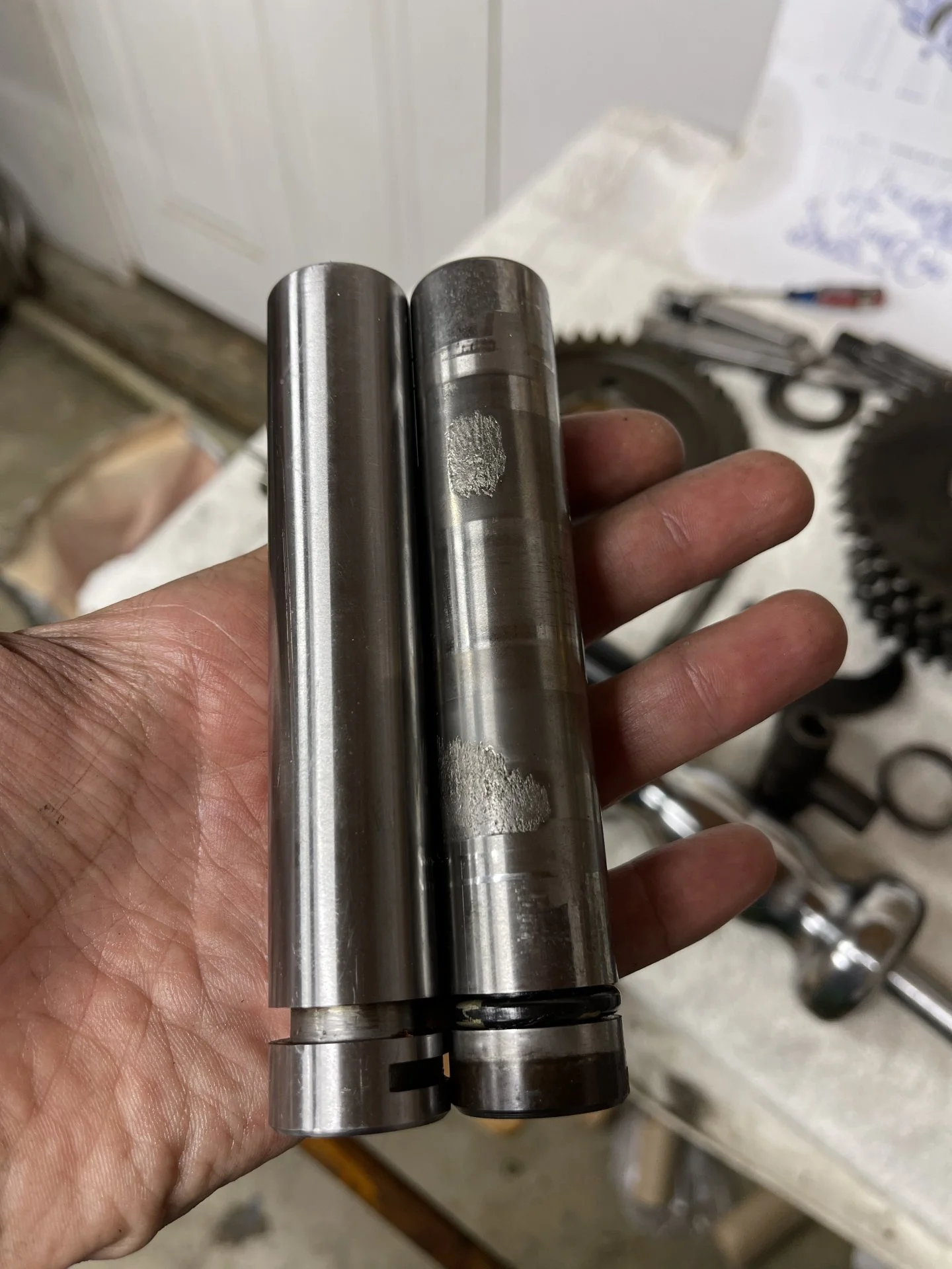

Installed these bad boys the other day.
This sweet OME complete kit from @ CruiserOutfitters .
The 40 year old springs don’t look like much up against the OME leafs.
In one photo you can see how the leafs were wearing into each other.
Another photo shows the pitted shackle pins.
In the end, not bad for 40 years of service.

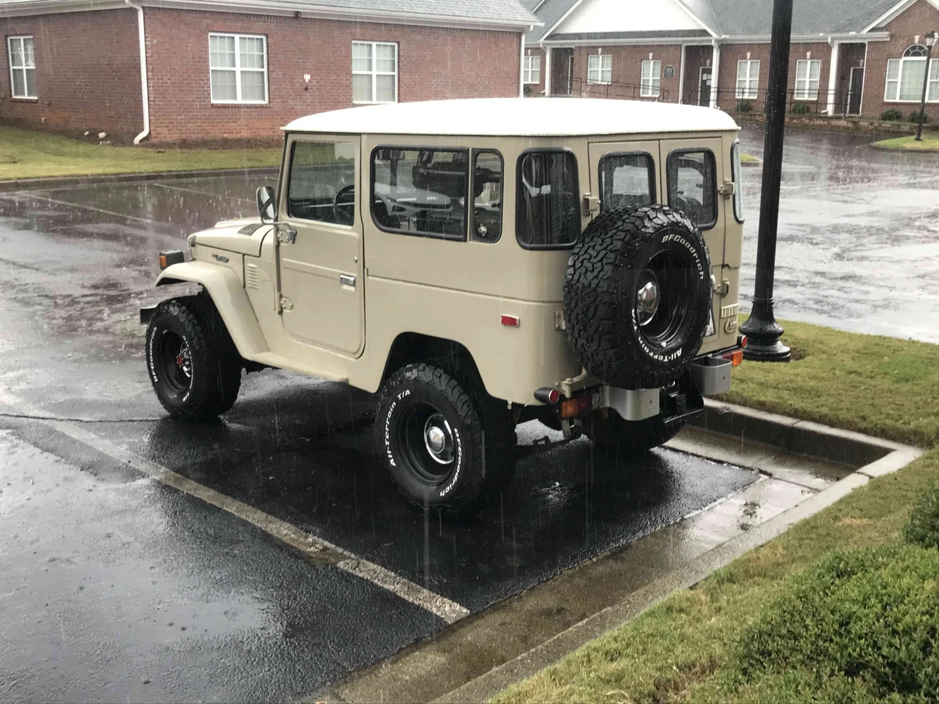

Did absolutely nothing to it..........was at the beach on vacation!
While down in the Panhandle, had dinner with @thatcabledude in this place, The Bay Restaurant.
However, we got back yesterday, fired it up this morning and took it to work! It's getting a Mother Nature bath to wash the dust off.

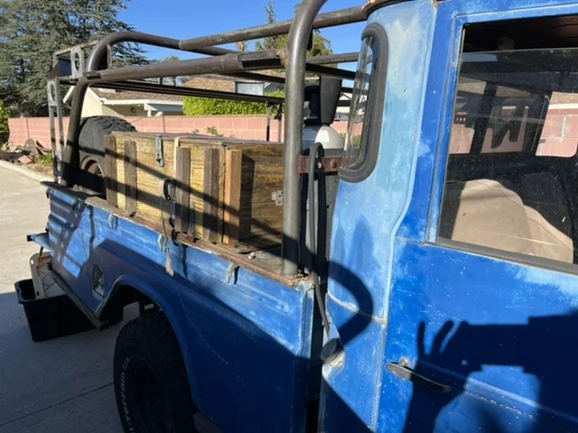

Starting the usual fall systems checks before heading out to Death Valley. Tighten left rear engine mount bolt… again (love the original castle nut design). Discover Speedometer cable outer sheath burned from contacting modified exhaust. Install new cable retainer for tow truck jumper cable system and re-route cables. Remove and clean fuel filter housing (no dirt in the glass bowl though😊) Put a new coat of varnish on the kitchen box and add some oak staves to keep it in service a while longer.
