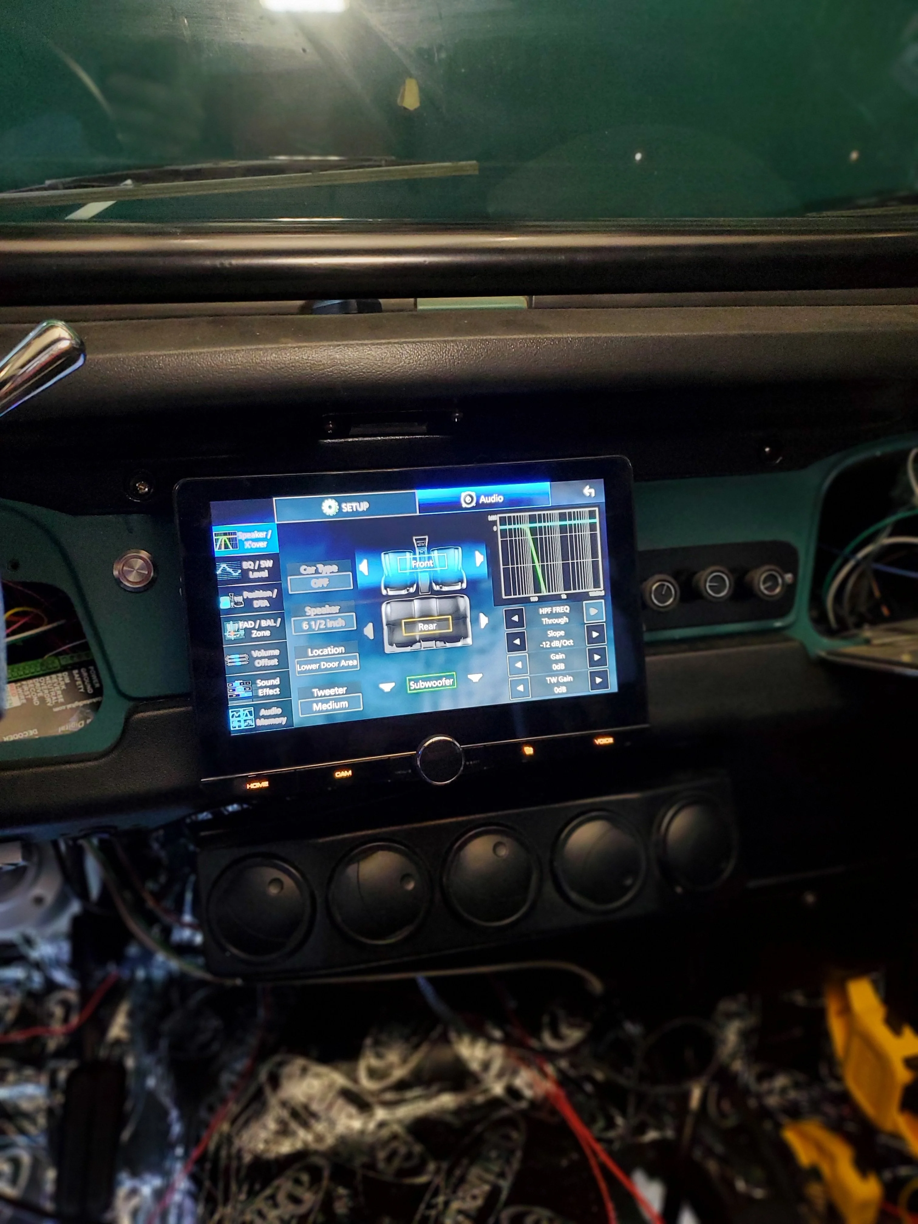

Installed the Kenwood dmx1057xr double din in my resto mod FJ40. Super tight fit. But I also fired up the cab power so I got to see my dakota digital light up for the first time.
Some how the wiring has turned into a rats nest. I'm not sure how I'm going to organize it before I call it done. Speaking from newly gained experience, if you are rewiring in a new fuse box, MAKE ALL THE WIRE CONNECTIONS LONGER THAN YOU THINK!!!

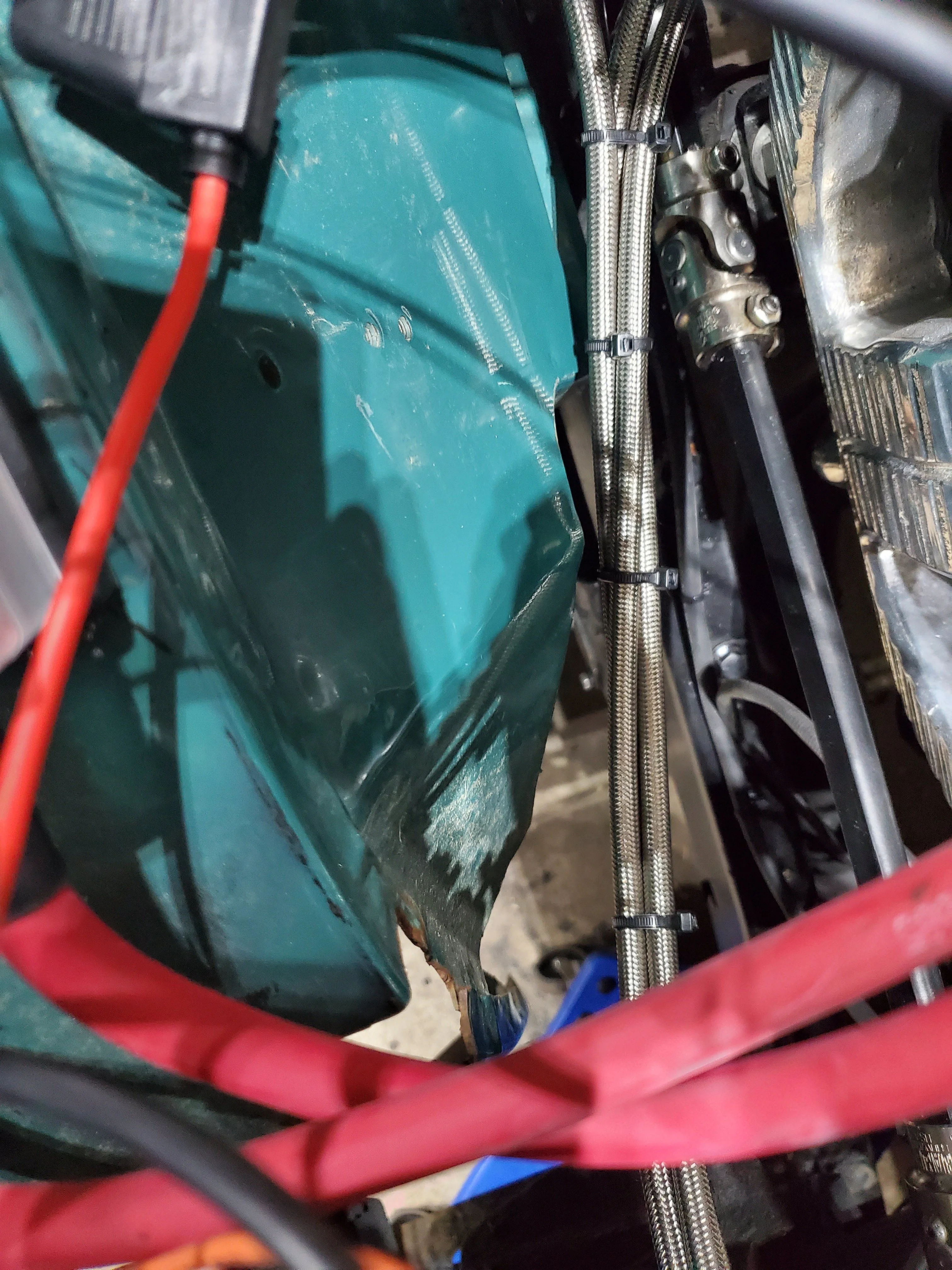

Where did you find that heat shield for your steering box?
It was on the 40 when I purchased it from the salvage yard. These are the brackets that mount it.

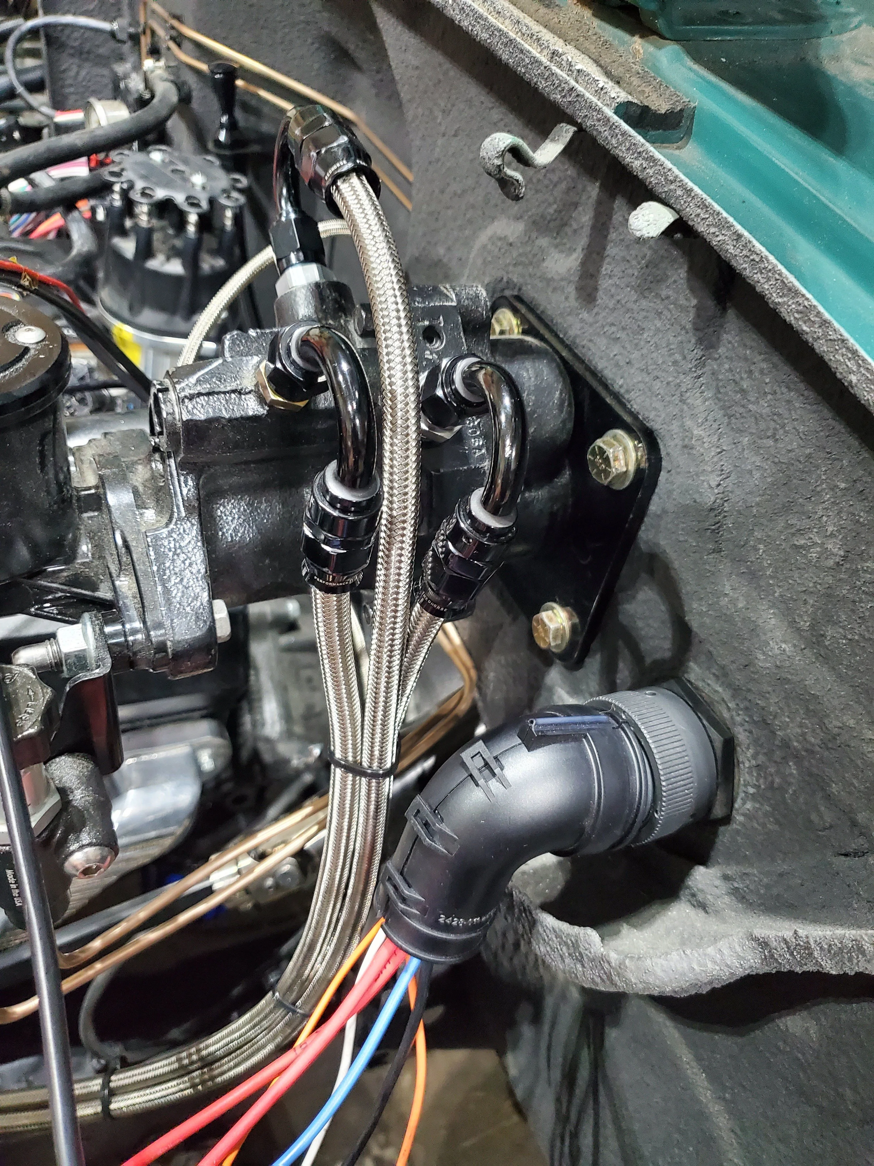

Built hoses for the hydro boost braked. Two nights ago was setting up the keyless ignition but I need to tap into the brakes for a brake signal. I've had zero pressure so I unscrewed the brake clevis so I was definately bottoming our the push rod instead of hitting the floor.
I bled the MC, followed by all the fittingon the portioning valve. Found two brake leaks from loose fittings. Now I have super firm brakes...and that's before I pressurize the hydro boost. Looking forward to the first drive!

Hey @MaltbyPenn , is that brake booster/mc a kit? Or are the components pieced together? Front and rear discs? What proportioning valve?
I dont have model numbers (let me know if you need it). We have a local hot rod shop, Dreamers Rods and Pickups. Jamie took a bunch of measurements and put together a hydro boast wilwood m/c combo with proportioning valve. I know it's a 1" m/c but I cant comment on stopping performance yet. I have stock disks up front and Monte carlo disks in rear.
I would love to get the m/c and booster numbers, if possible!
Thanks for the pictures. I will need to fab something up for mine and am looking for ideas. I am doing a mini truck P.S, conversion. so the stock parts won't work.
The power steering gear is a bit longer than the manual one but the manual heat shield will work on it with minor modification of the mounting brackets.
