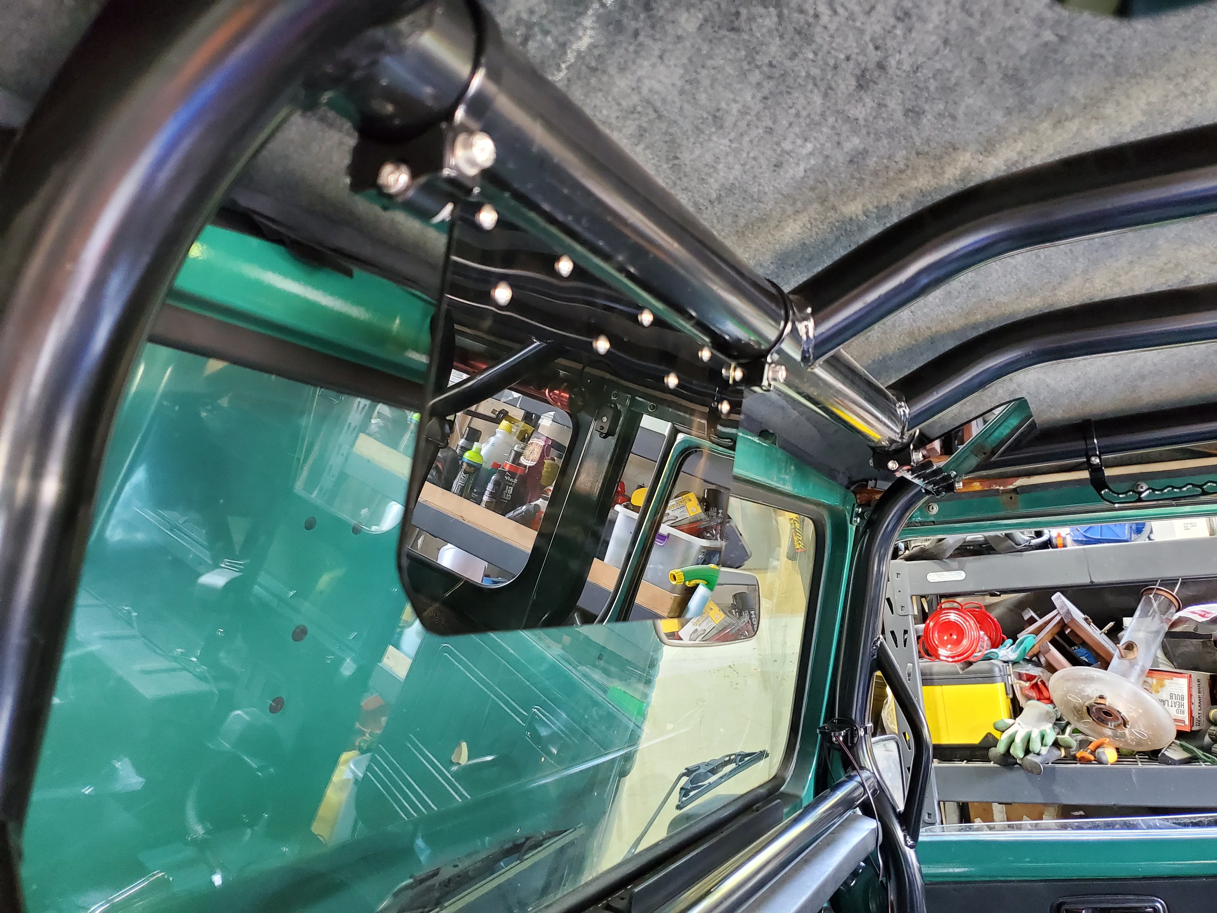

I really liked Reily's sun visors on his UZ40 build so I bought the tinted ones

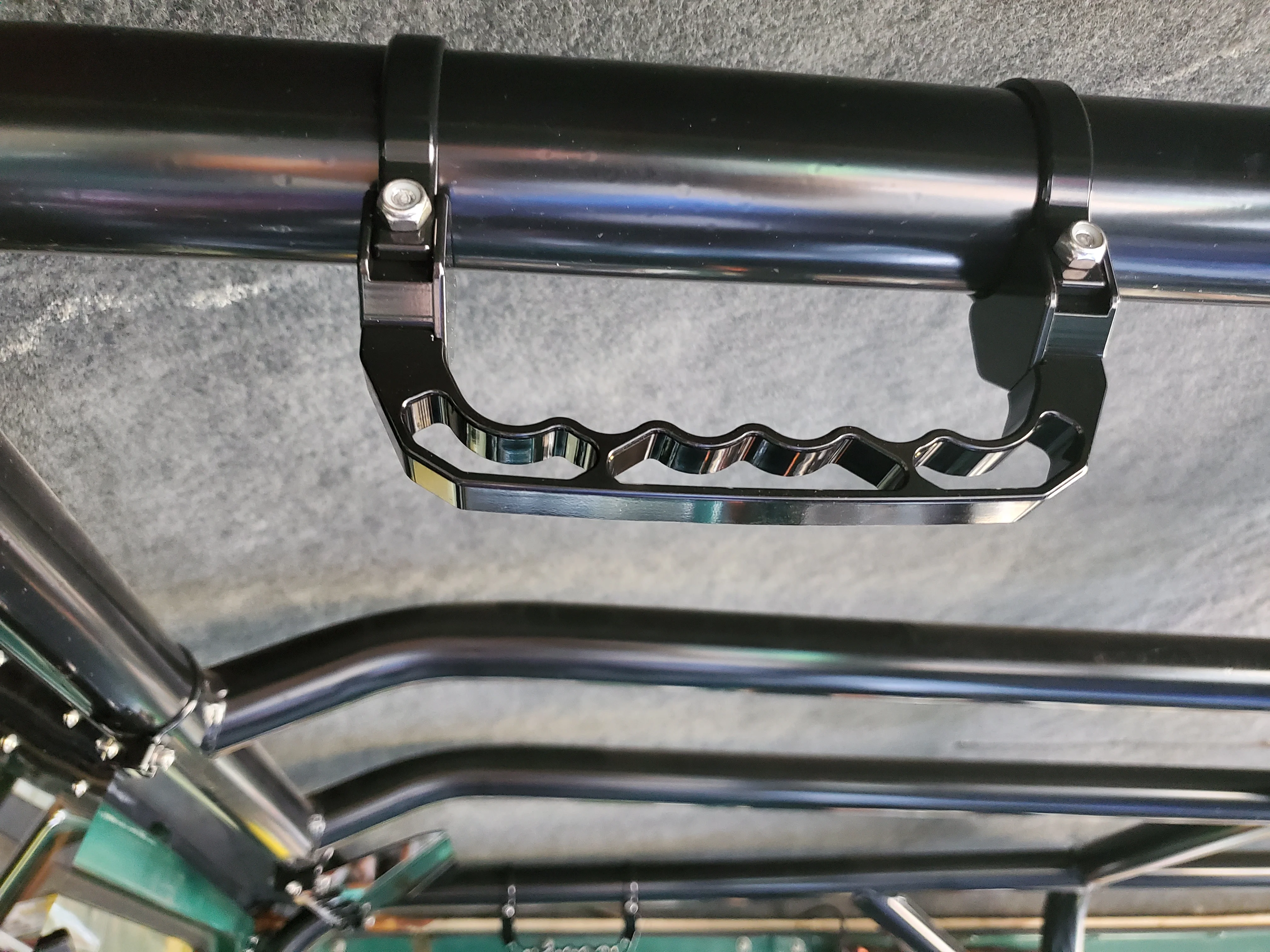

My wife complains about not having an oh sh&% handle in my Tacoma so I also added a pair in my 40 .
