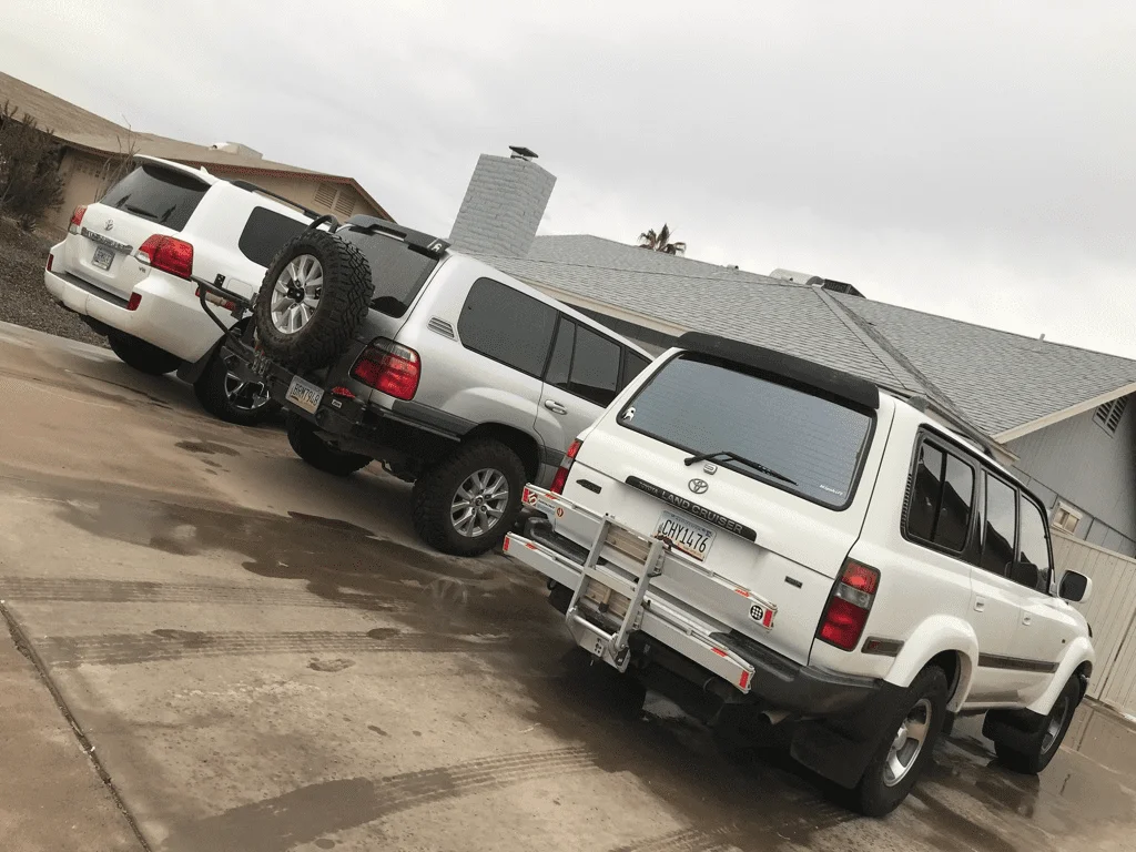

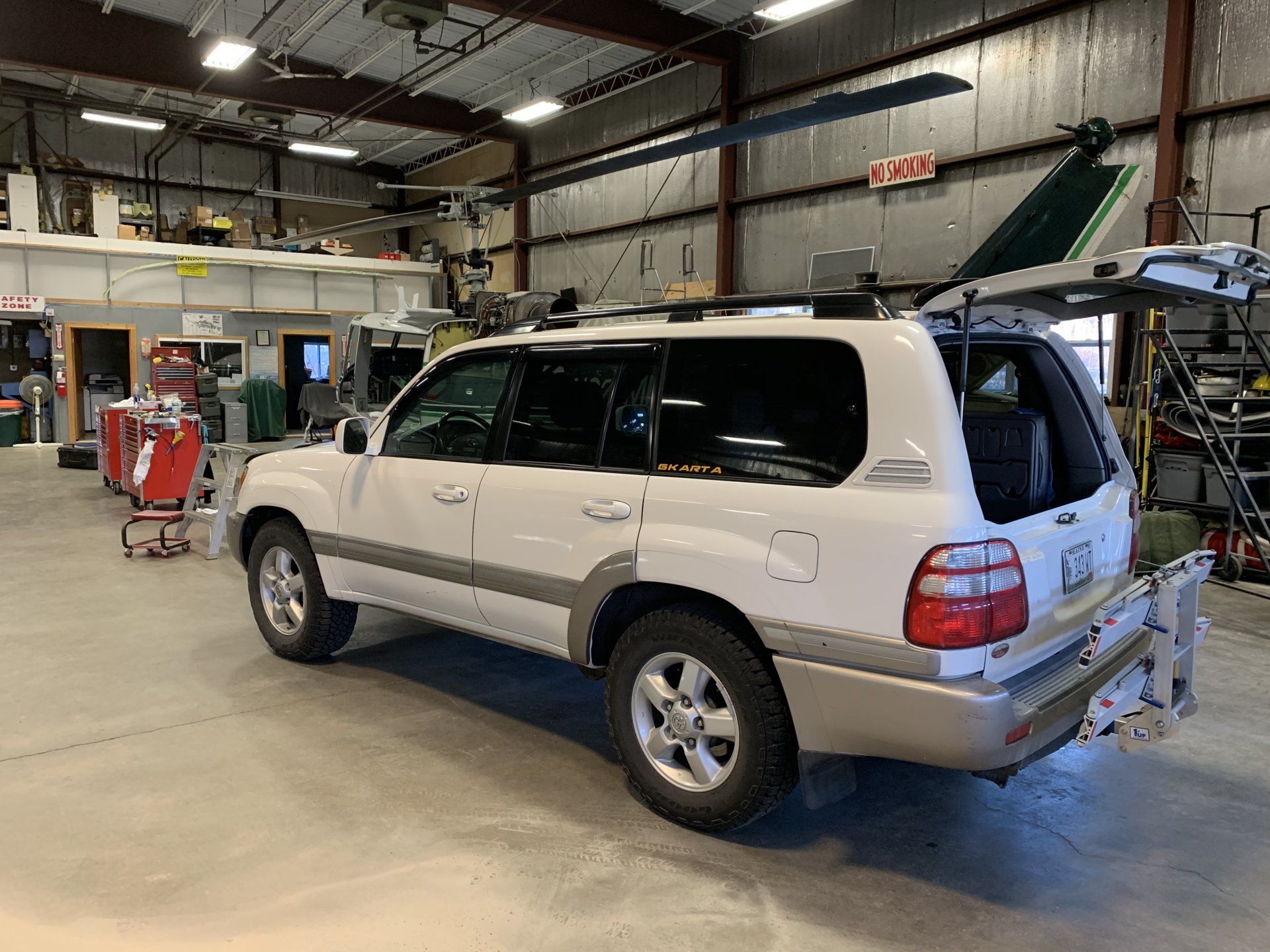

I parked the 100 between her older and younger sisters:

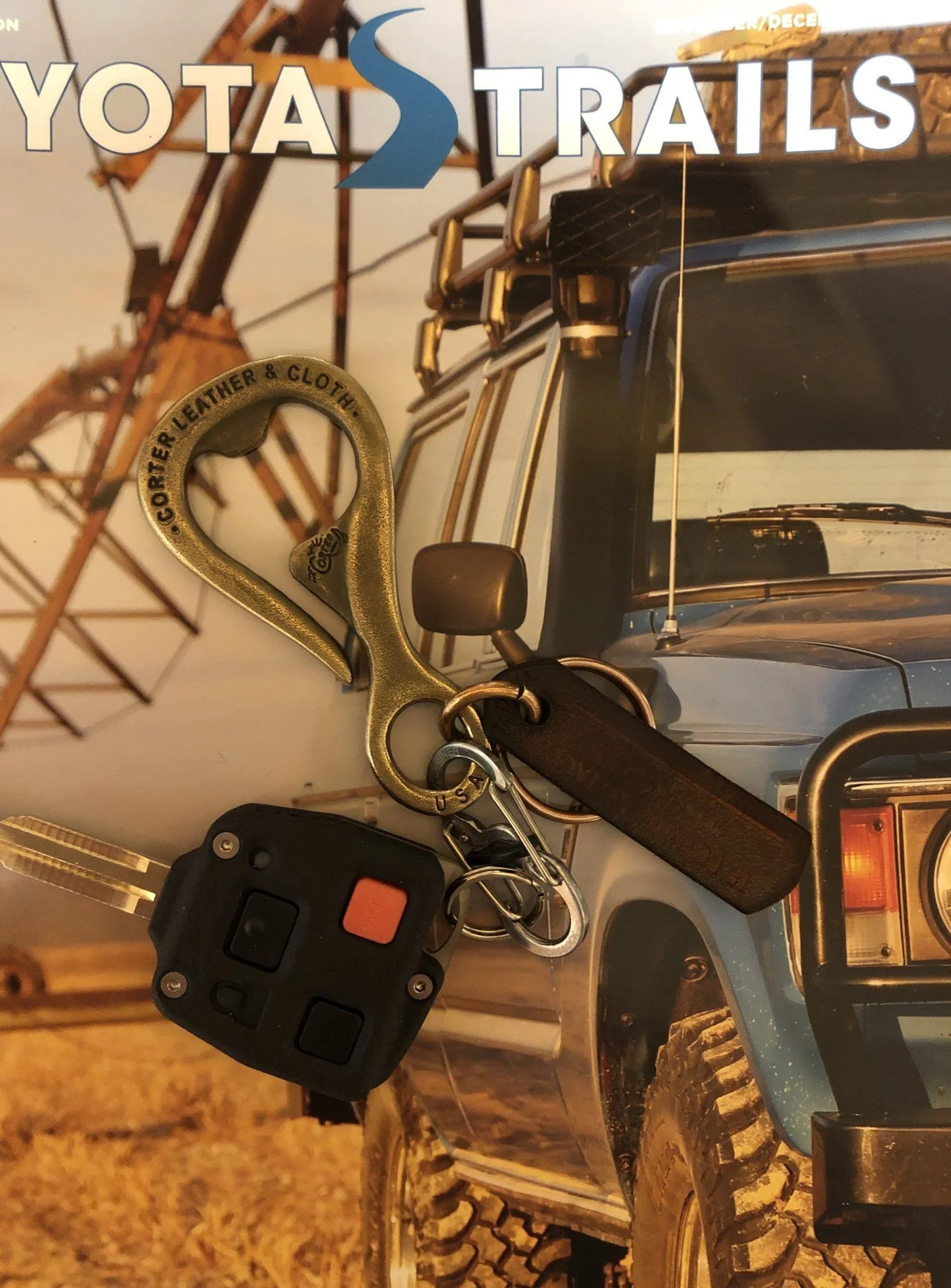

Thanks to the YOTAMD Black Friday sale, I now have three good master keys. I bought a pair of blanks with remotes from Amazon. I had the dealer look up key code from VIN and cut the keys. I then used Techstream to program immobilizer and programmed remotes with the door trick.

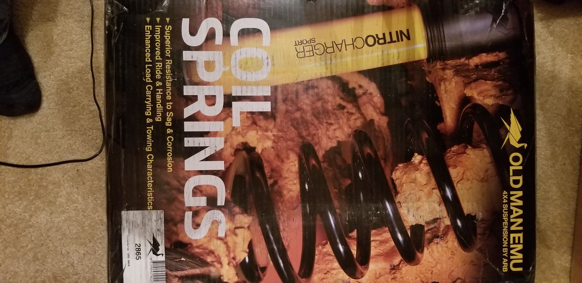

These showed up today!! Can't wait to get them on.
Are you keeping the stock torsion bars and shocks?
Replacing the rear springs just by themselves is a half banana job. Replacing the rear shocks can be a curse-everyone-for-half-a-day job.

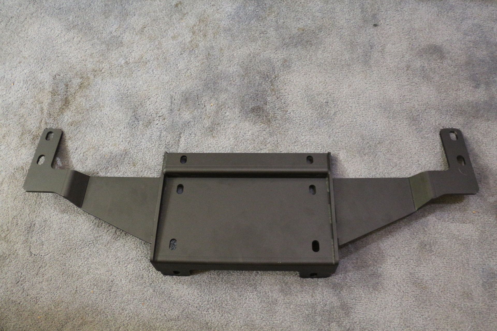

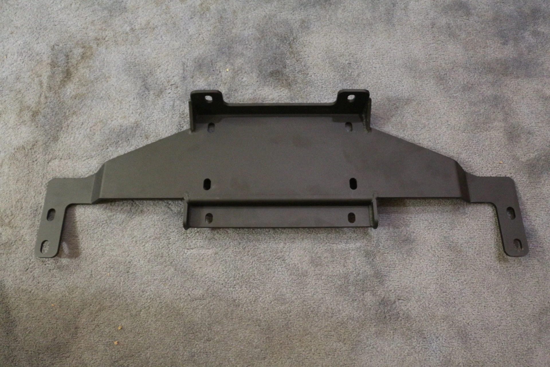

Very happy to get my winch and plate installation underway on my @Kavik front bumper
The Kavik bumper is modeled after the TJM T-17 but the winch plate is a much better design IMO. The winch plate gets its support from all 4 sides something TJM did not do and is a nice feature. Brian did a great design and beefy construction with the mounting plate slightly above the frame rails, Nice!. The plate then rises to meet the bottom of the bumper making making the fit again very nice. The front holes where it bolts to the hawse fairlead is slotted giving adjustment for my future 10mm body lift, thanks Brian. The attention to detail is first class along with the ability to mount tons of winch options. I will be using an older Warn M8000i and its bolts in place with no other mods something I wish my slee 80 series bumper provided.
I did need to mod the center brace on my LX470 for clearance on my Warn M8000i something they may only be needed on some winches. But a few bends in a piece of aluminum and we have the needed clearance and a little bling.

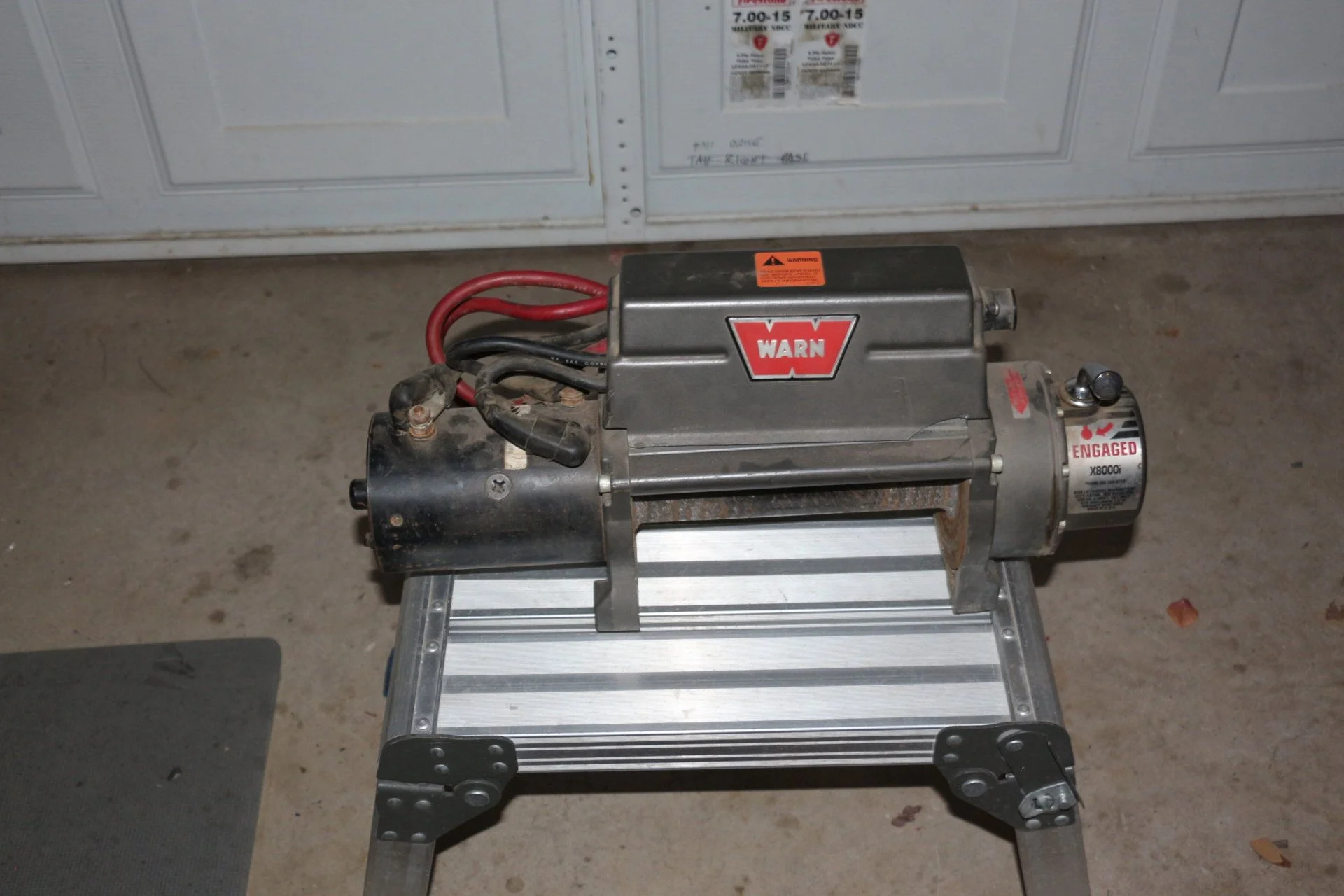

Im using the same model Warn M8000i on my 80 series that I have had and used for the last 23 years. Rarely do I use or need a winch but when I do I want the confidence to know it will work so experience said another WARN M8000i for me. Mechanically and electrically the winch has been gone through some time ago. A little cleaning up and some paint and I look forward to many years of service. A new Dyneema synthetic rope and aluminum fairlead has been ordered along with some new power cables. I will continue to use the factory tie down brackets for recovery point.
View attachment 1849389 View attachment 1849390

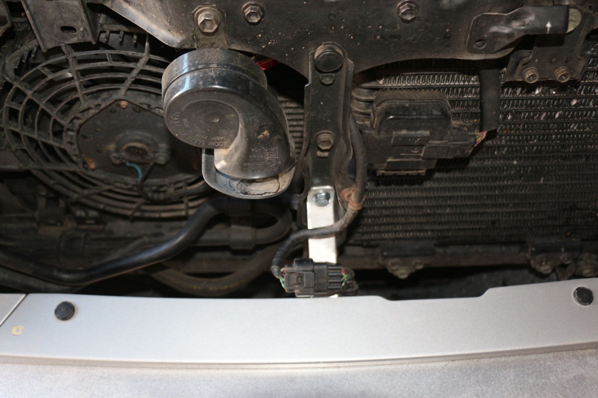

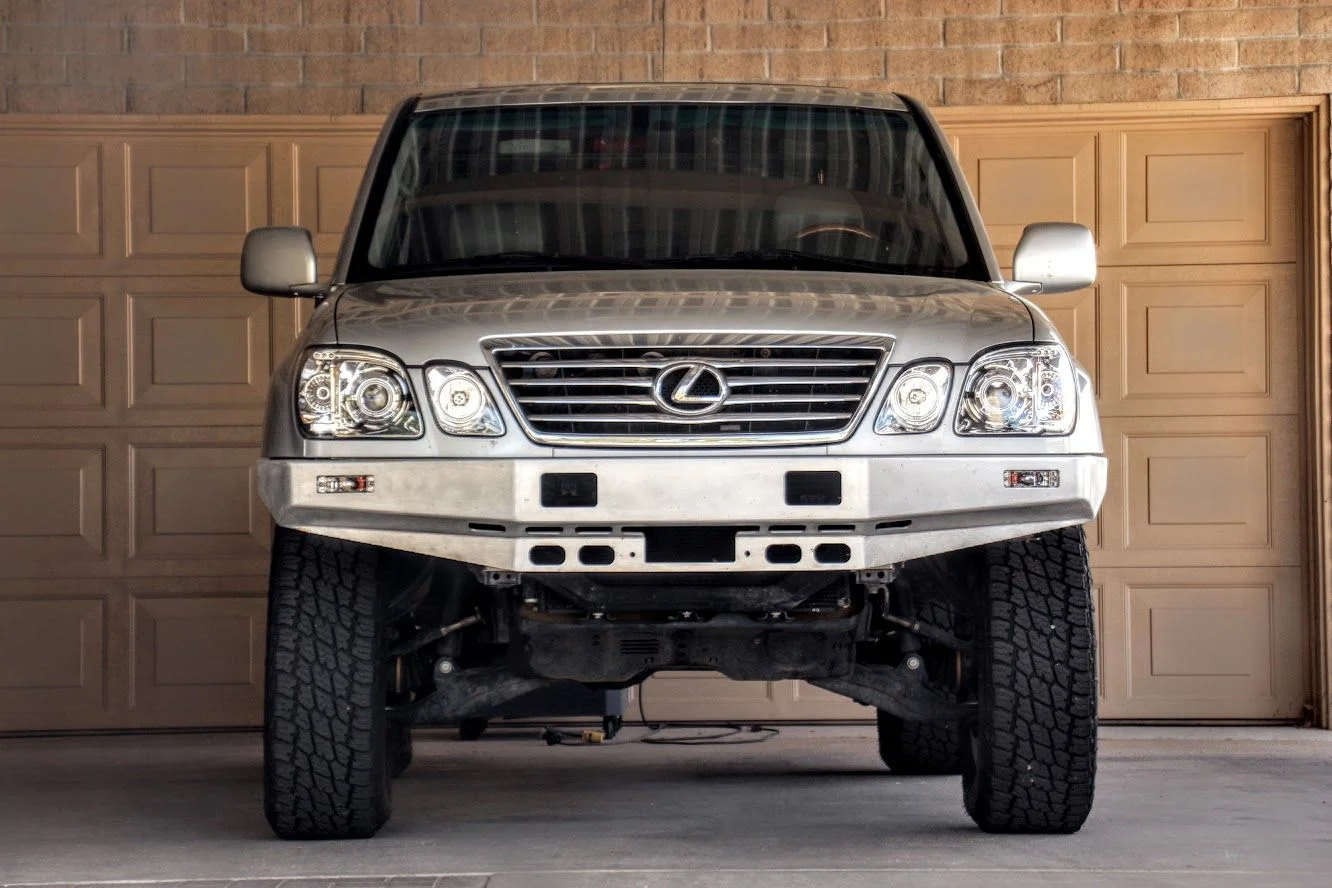

Is that the basic Kavik? I’m considering the TJM but this looks pretty nice. The Kavik will end up being at least $300 more I think once shipping etc is factored in....so I have to consider that. :(
