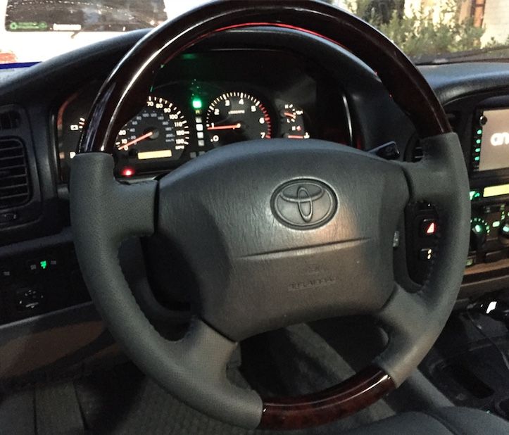

Installed one of the eBay steering wheels on my kid's 2000 TLC
how is the color match on the leather? I've heard mixed reviews.
In my son's grey interior, the leather color is a little bit too light. It appears closer to the lower dash color than the upper dash color, but it's still much better looking than the 18 year old wheel that we pulled out.

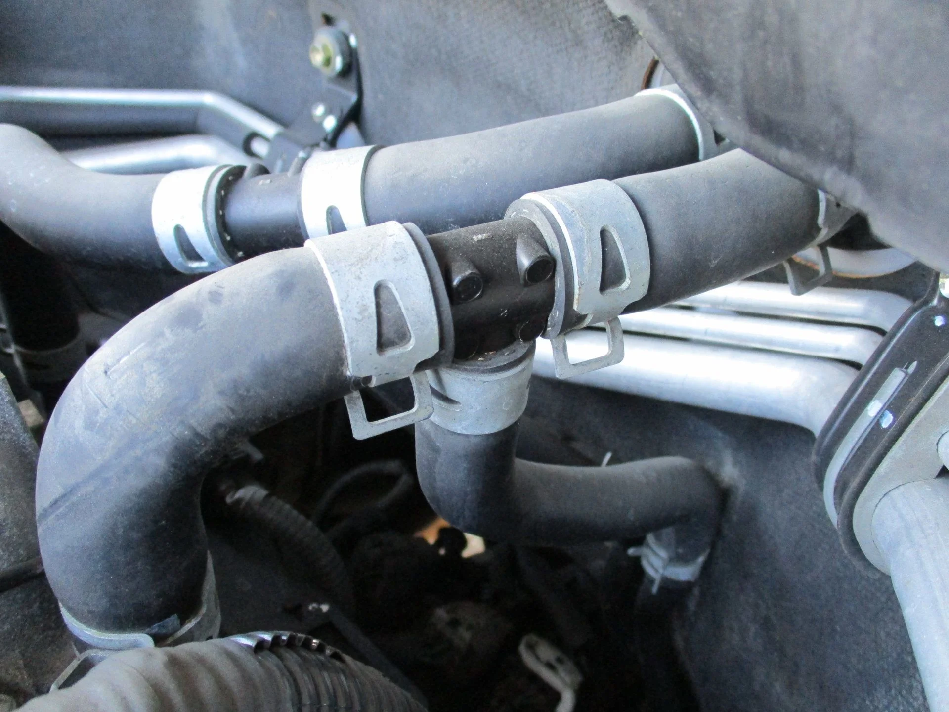

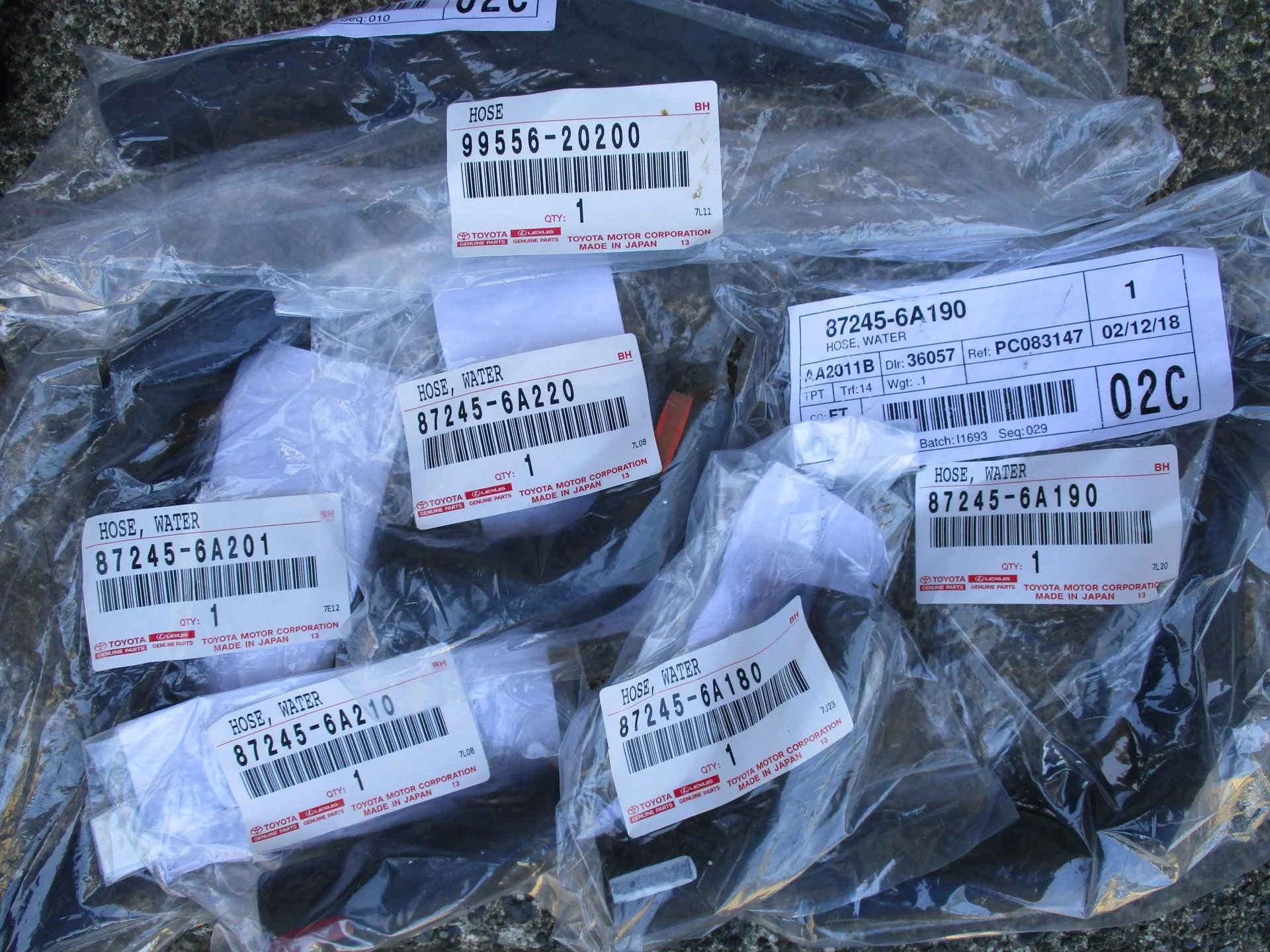

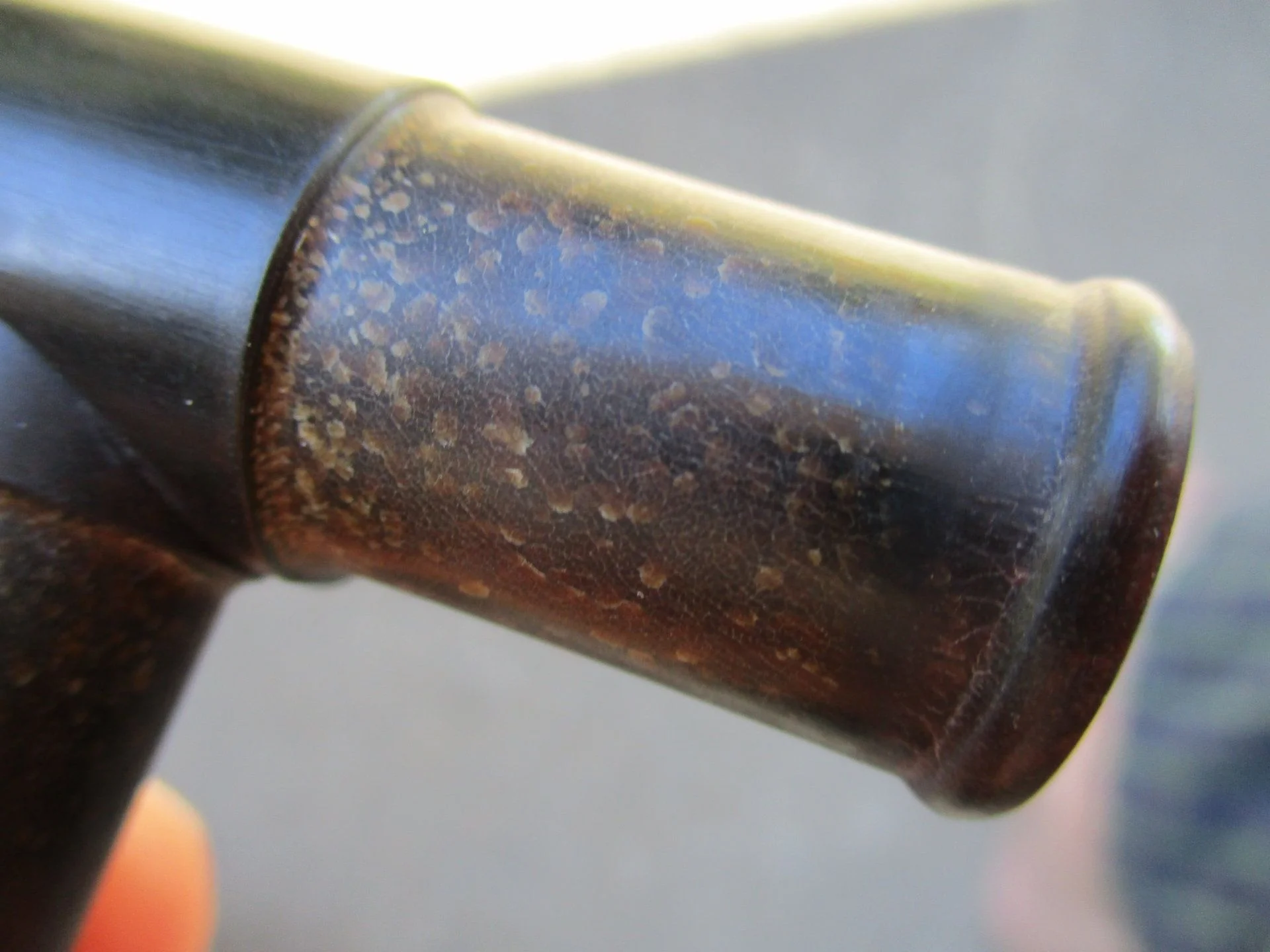

Replaced both heater T's, all six rubber hoses, used old clamps. Yep, it is a pain. All originals at about 212,000 miles, looked flawless before I started so questioned need to do it, but why take the chances of a catastrophic failure? Like most everyone, driver's side was flecked probably due to heat but not weak, and passenger side also discolored but lesser, hoses in perfect shape no cracking or swelling, no hardness. Total coolant drain, 2x flush with distilled then final fill with 50% Toyota Red and distilled. Radiator and overflow very clean. Old coolant looked brand new, but did flush out a reasonable amount of flakes/flecks, really good overall, but last fill was probably not a flush. Drained from radiator petcock and both block drains.
