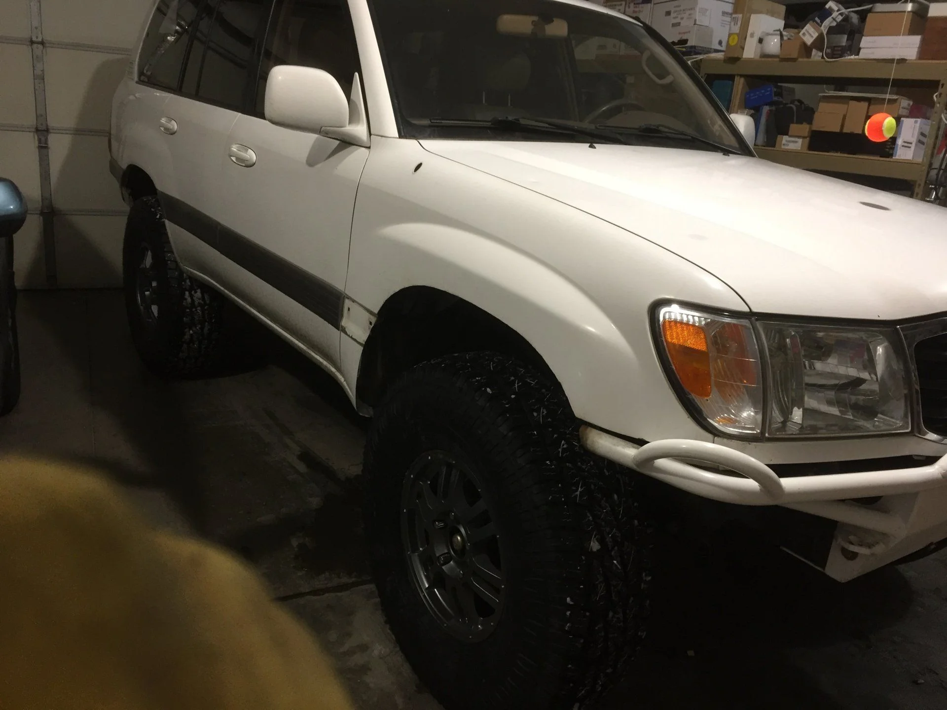

wow 37s??
Where can i see pics of your rig?
I put a couple pics in the photos thread and a couple videos in the videos thread and one boring video in the “37’s-anyone done it?” thread. I’ll see if I can get a build thread started, but it may take me a little bit. Here is about a useless one from my garage Sunday night right after getting them on. Sorry it’s so dark.

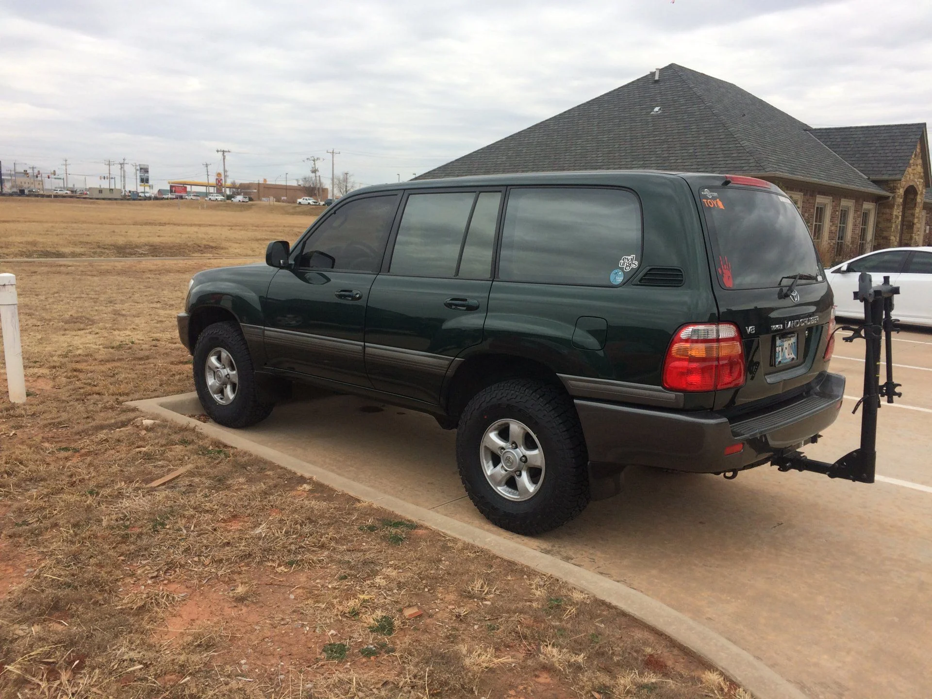

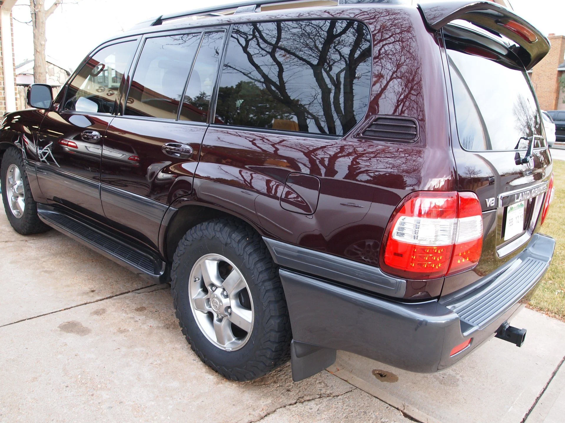

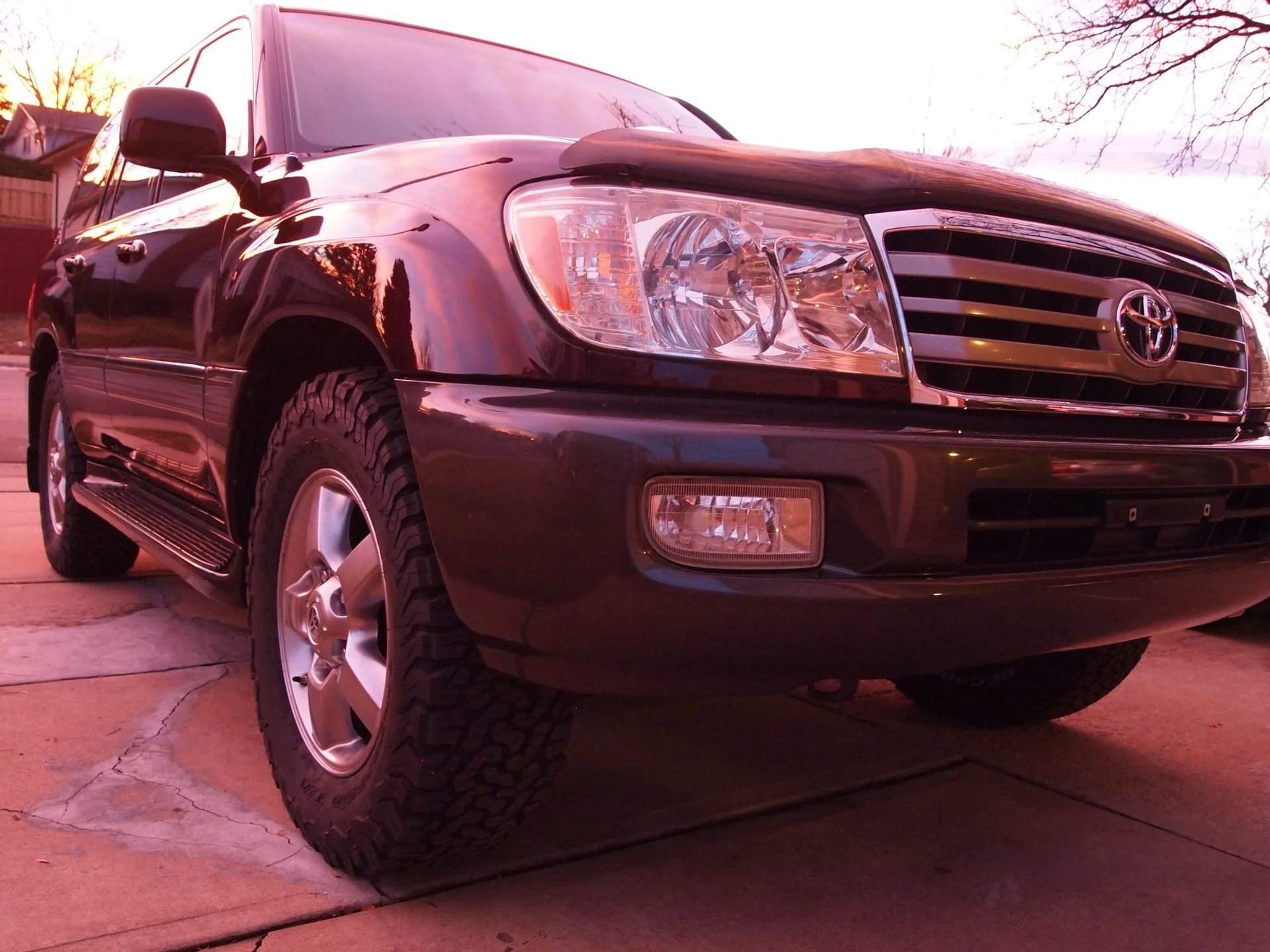

Got a smoking deal locally on 5 Falken 285/75-16's the day before my brake booster failed. Replacement booster worked, but ABS light went on and seller sent a replacement I got today, so once I get that on, hopefully that's it for a while. Next up, tire testing and maybe enough free time to repaint my side moldings and door handles..

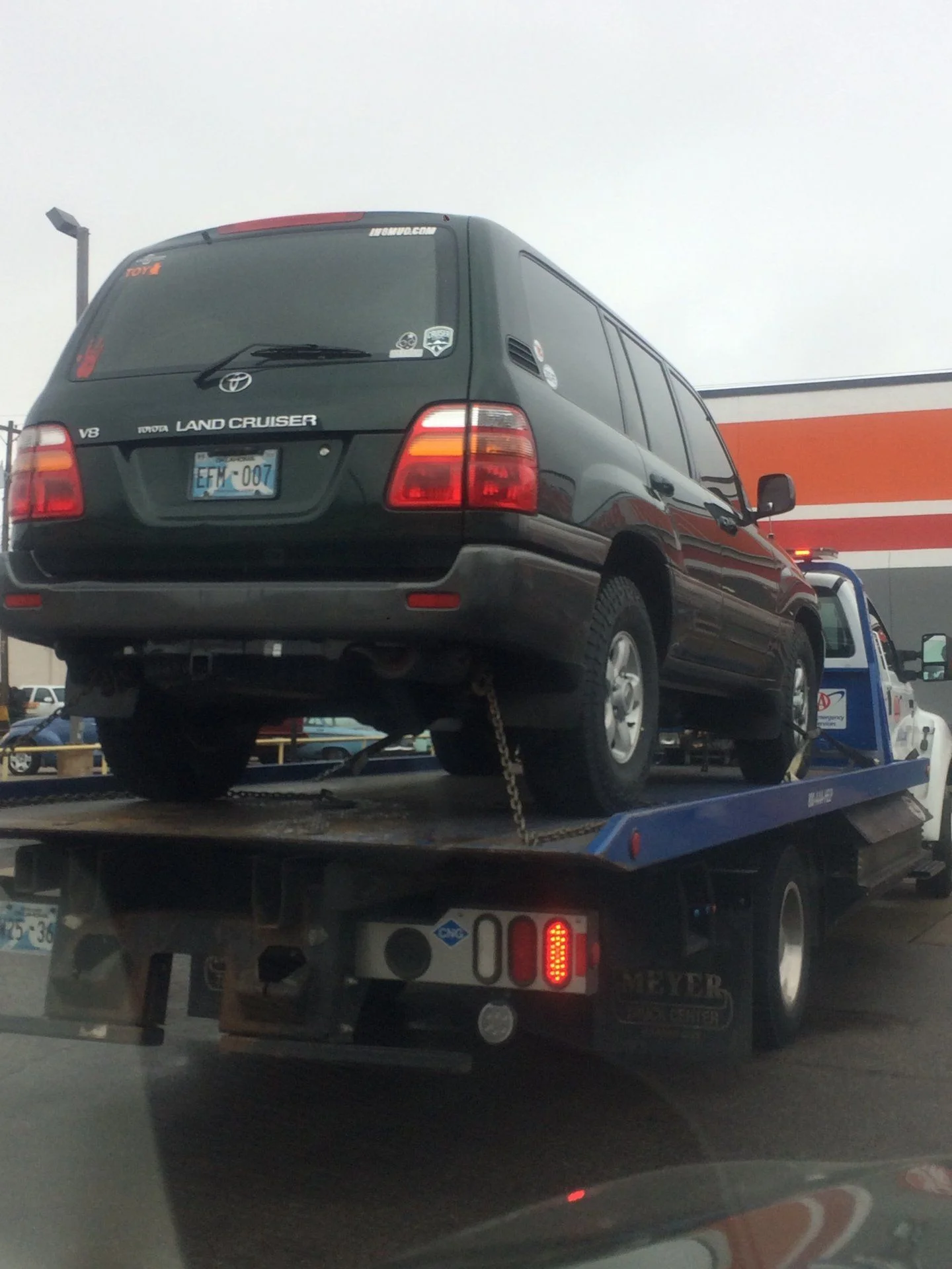

The rare view of a Cruiser on a flat bed..:(

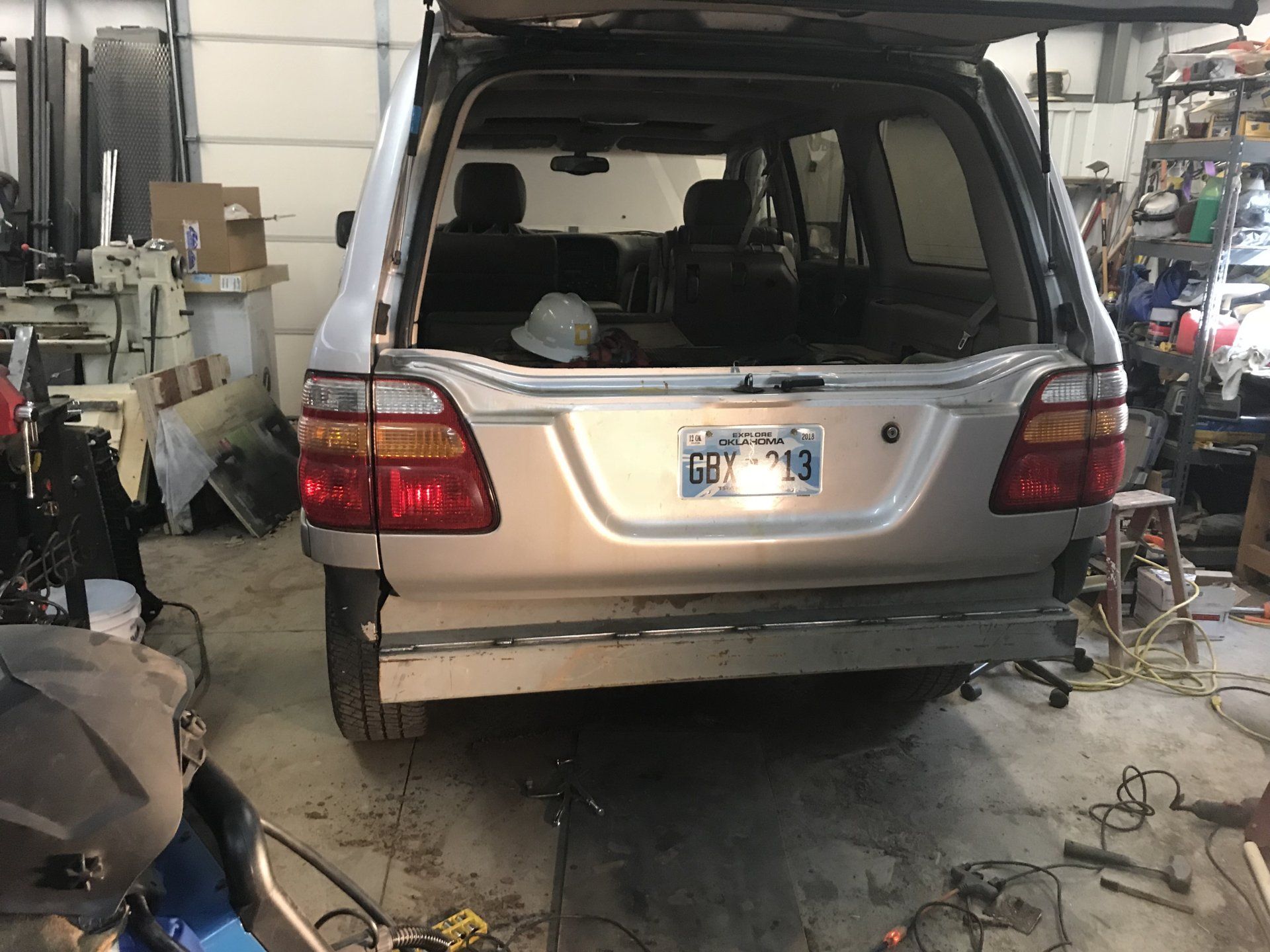

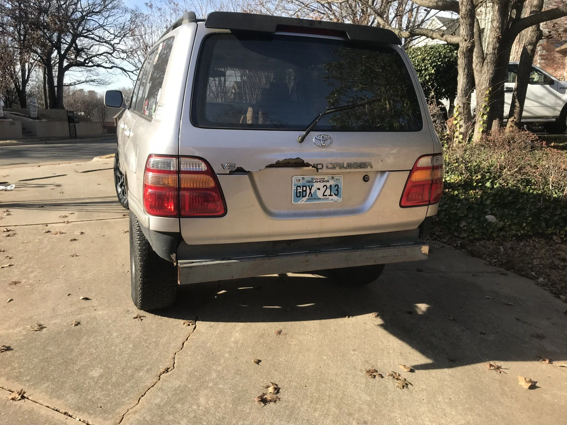

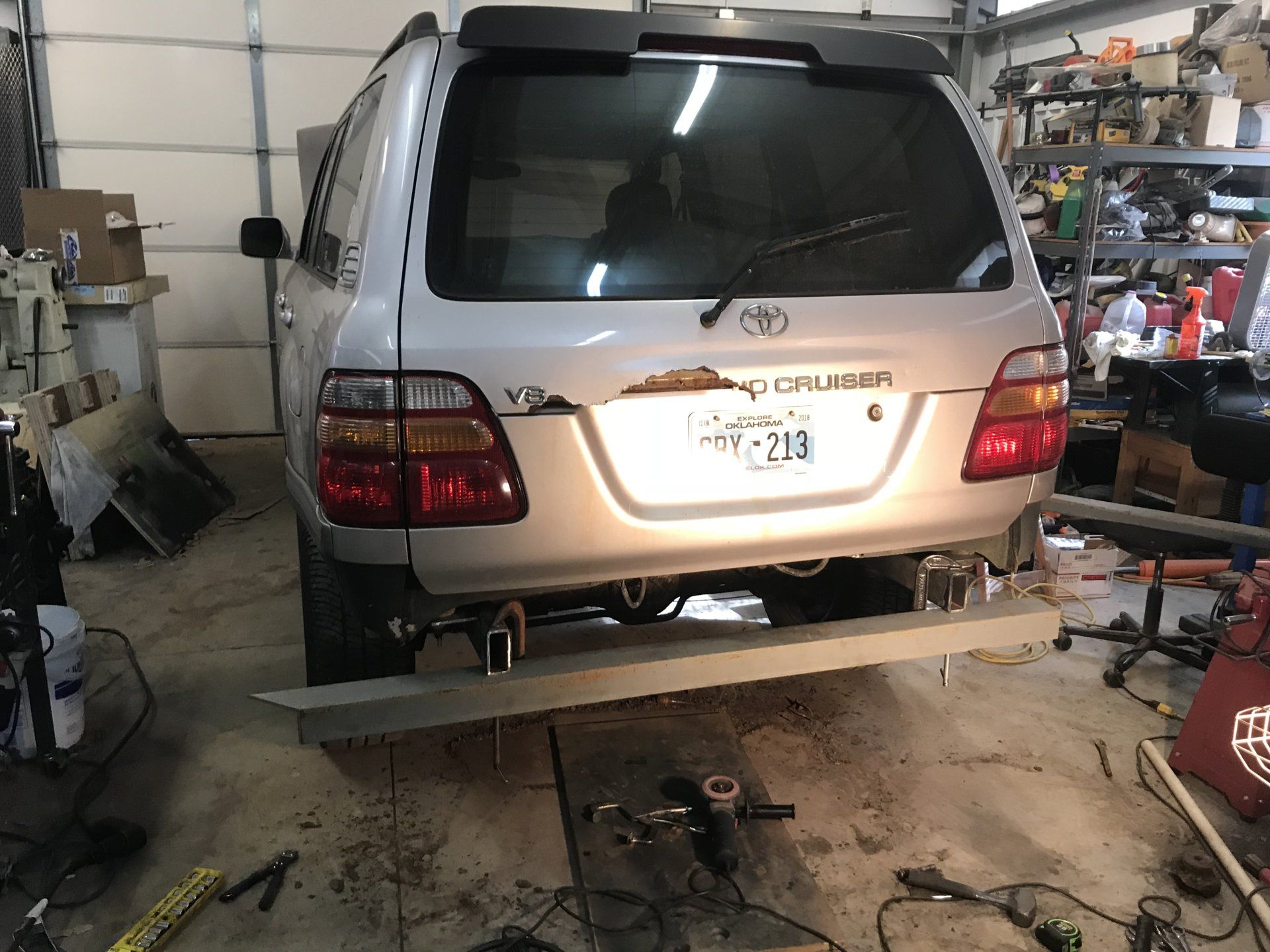

Built a square tube bumper. Ended up having to replace about 2’ of frame on both sides. Rust is an evil beast!
Frame section replaced with 2x4 .25” and notched the frame so it was c-channel and slid the 2x4 into place and welded also has plug welds. Will finish with scab plates in the next week.

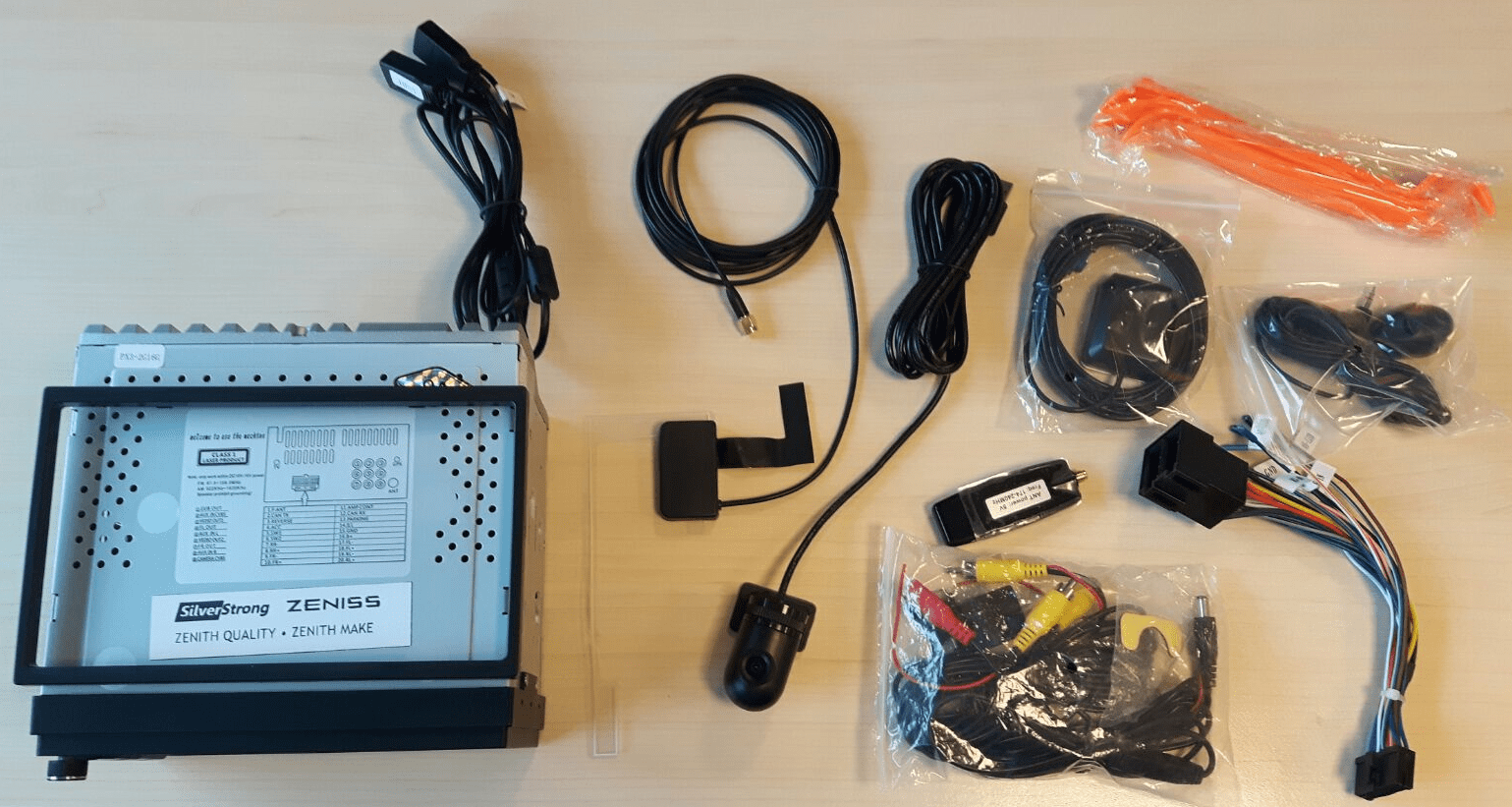

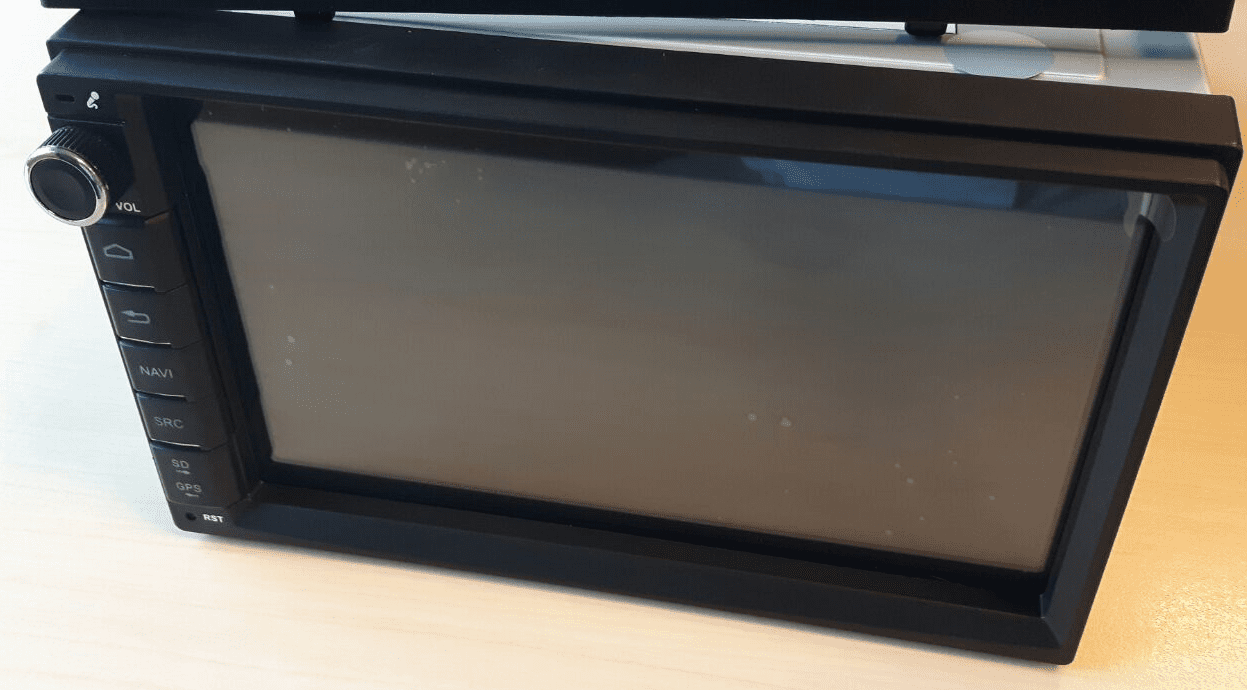

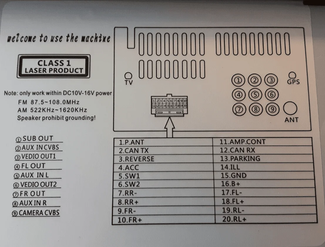

Received my new android headunit.
I also ordered a DVR camera, back up camera, DAB+ antenna and an external microphone:

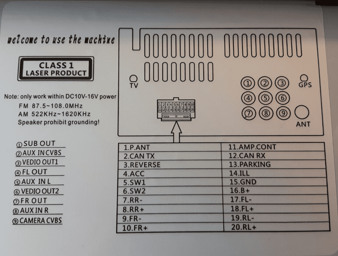

Connections:
I will install it and report back on here.

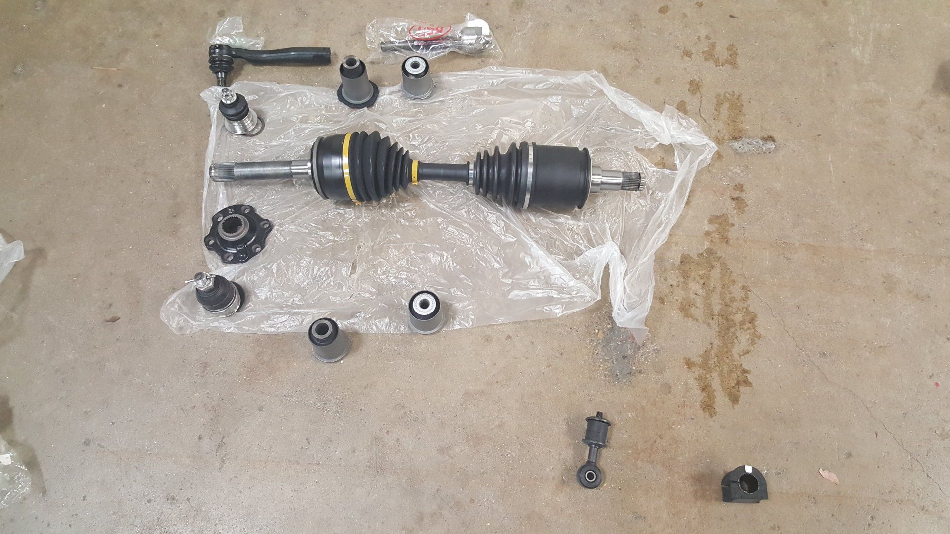

Been fighting a fever so it took me a few days to change the PS wheel bearings and put in a reman CV axle from Detroit Axle. Did I mention that it was 28F today? But none of those things are comparable to this birch-and-a-half job of pulling the axle just far enough to fit the thinnest snap ring I have. Took me an hour to get this far.
Good news is that I'll have to do this again because the teeth on the flange are worn out. :flush:
If that's a OEM reman, that snap ring will be way to thin (very large gap). You most likely have excessive grease between knuckle axle bushing & front drive shaft. This grease will settle after short drive, and then you should find it much easier to pull axle out when you replace the hub flange. I'll bet you need to use a 2.4mmm or even 2.6mm snap ring.

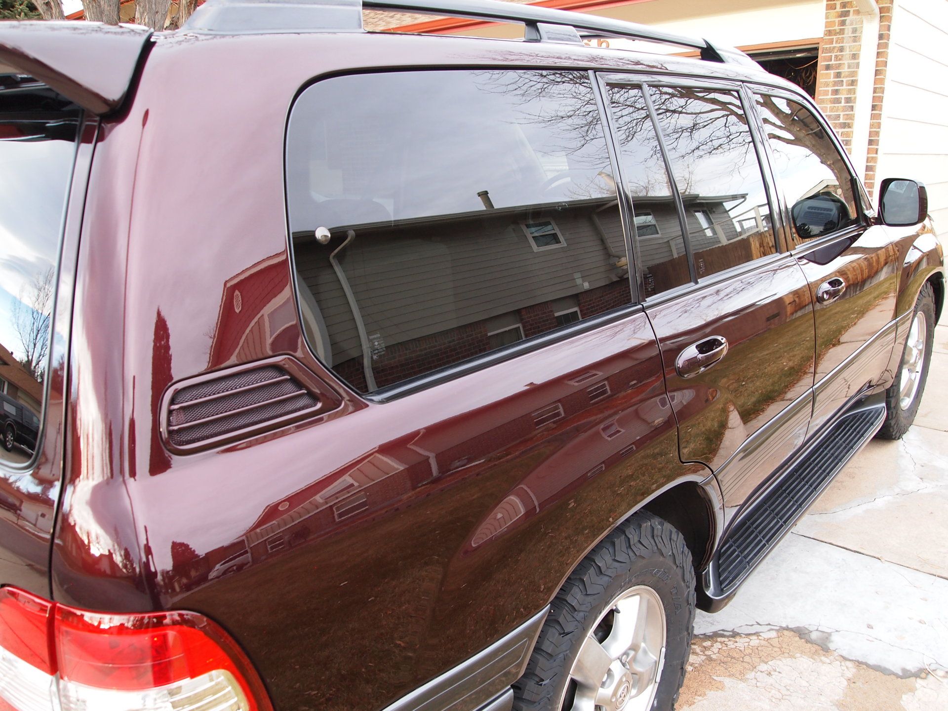

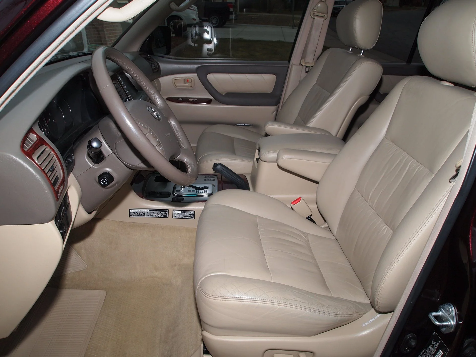

Finished!
Sadly I must let The Black Knight go now:cry:

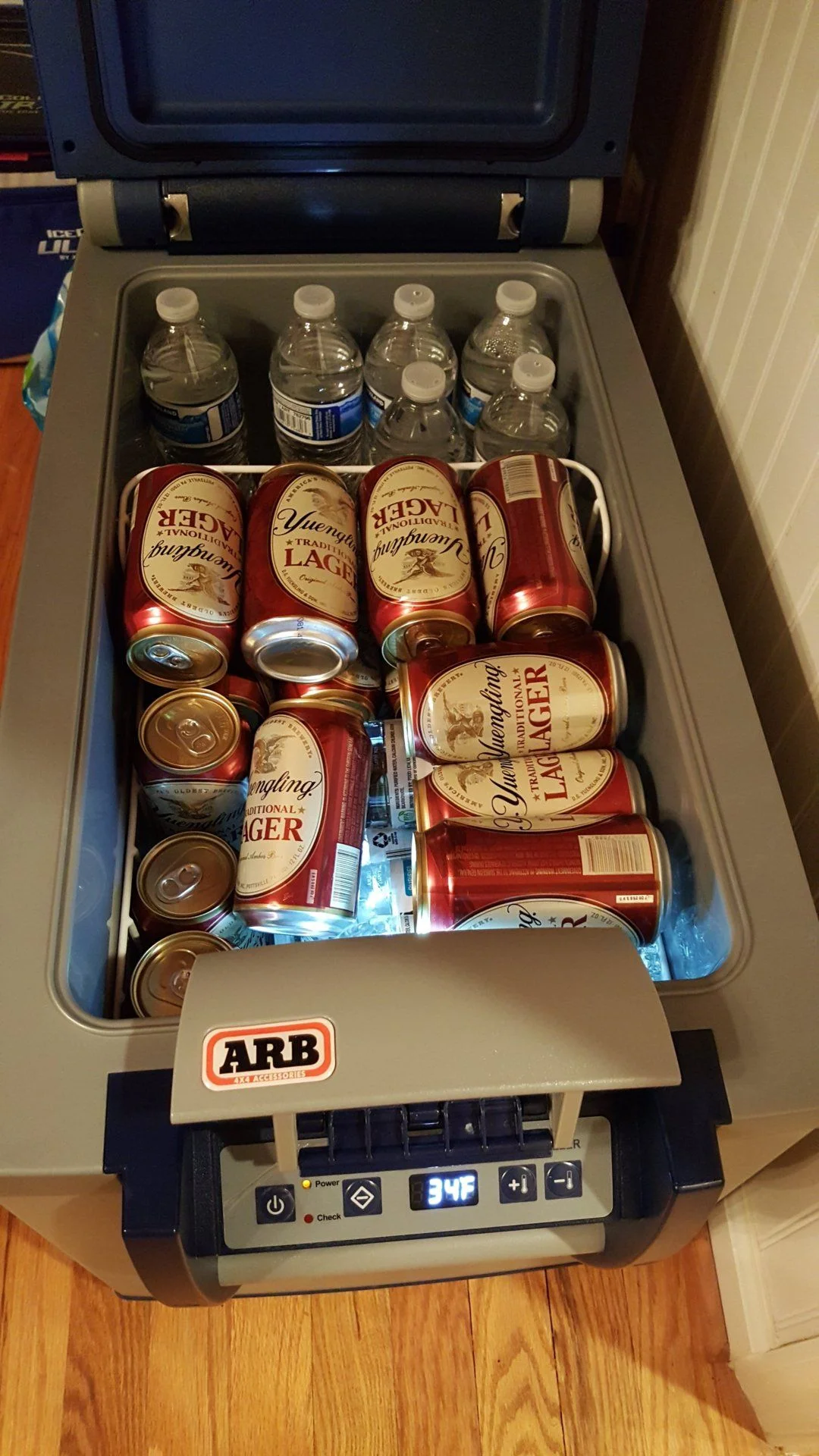

Testing out the new fridge and drilling holes in the firewall.
