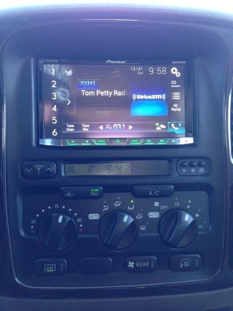

Finally pulled the trigger on, and installed new head unit. Pioneer NEX-4201 with extras like Sirius XM and backup cam (not 100% installed yet). Replaced an ancient Kenwood Excelon unit from about 12 years ago.

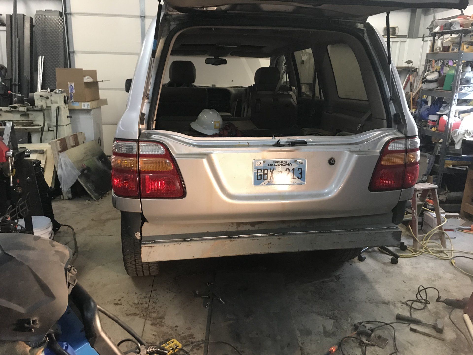

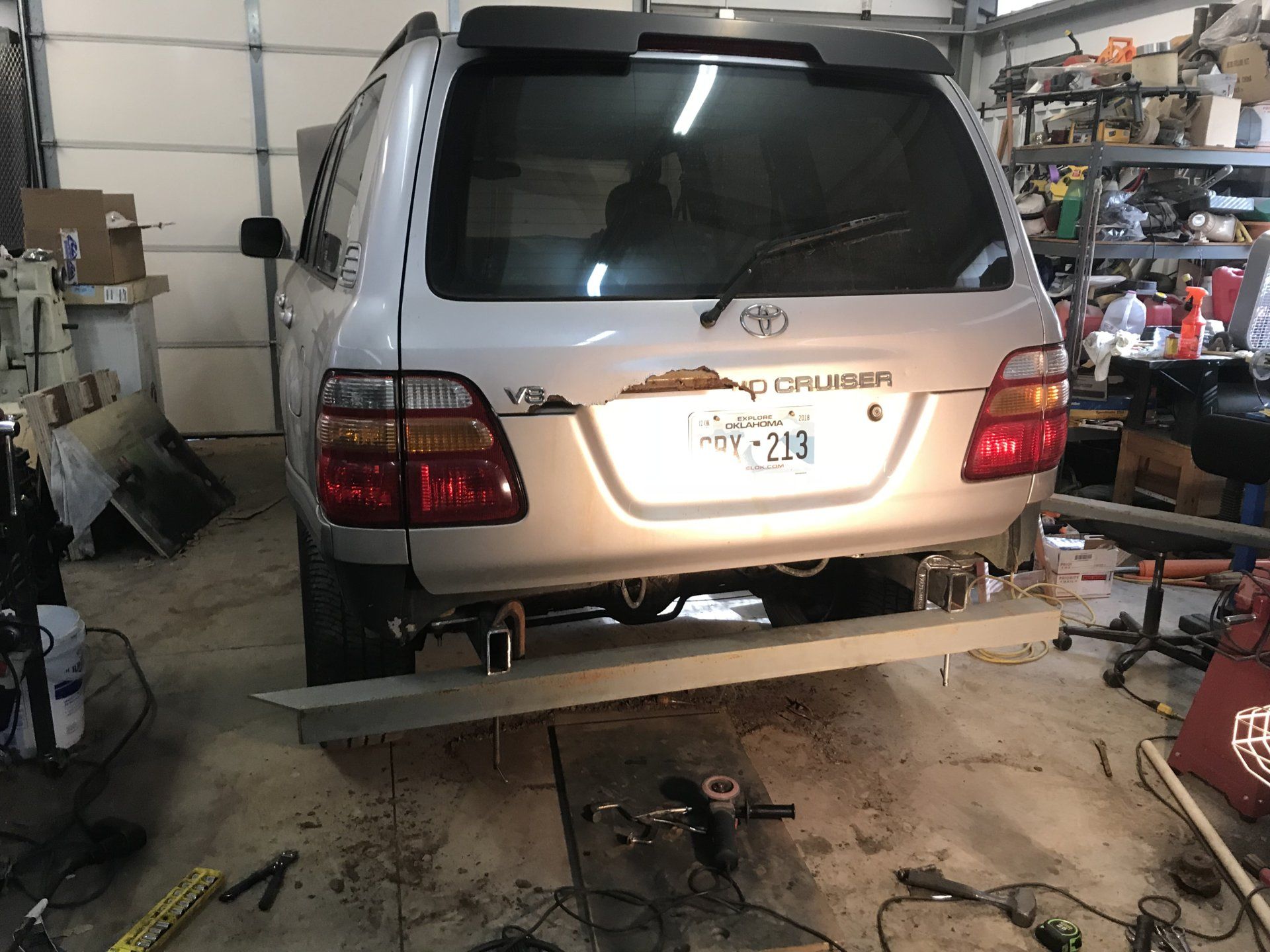

Built a square tube bumper. Ended up having to replace about 2’ of frame on both sides. Rust is an evil beast!
Frame section replaced with 2x4 .25” and notched the frame so it was c-channel and slid the 2x4 into place and welded also has plug welds. Will finish with scab plates in the next week.
