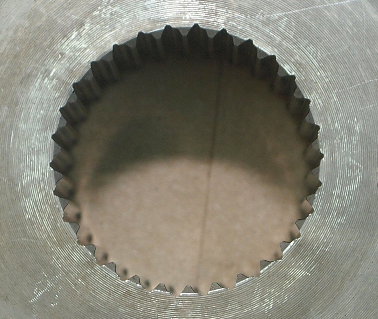

Flange teeth worn from loose bearing chatter & wide snap ring to flange gap. This creates a sawing action wearing on teeth. Give that N to D clunk.

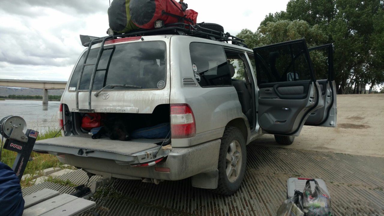

View attachment 1288358 View attachment 1288360 Had my Cruiser shuttled to Judith Landing after a 50+ Mile float down the Missouri River out here in Northern Montana.
I had to then drive my brother and his wife back to their Prius because it would have been awful on that road.
4 peeps, one 115 lb. German Shepherd, gear on roof. And two rafts in tow and all my gear for a month. AHC performed fine with the help of airbags. Love my LC.
Air bags + AHC? Cool idea! I am guessing you had to sag the rear axle to get the coils out enough to insert the air bags? Did you replace the coils while in there?
