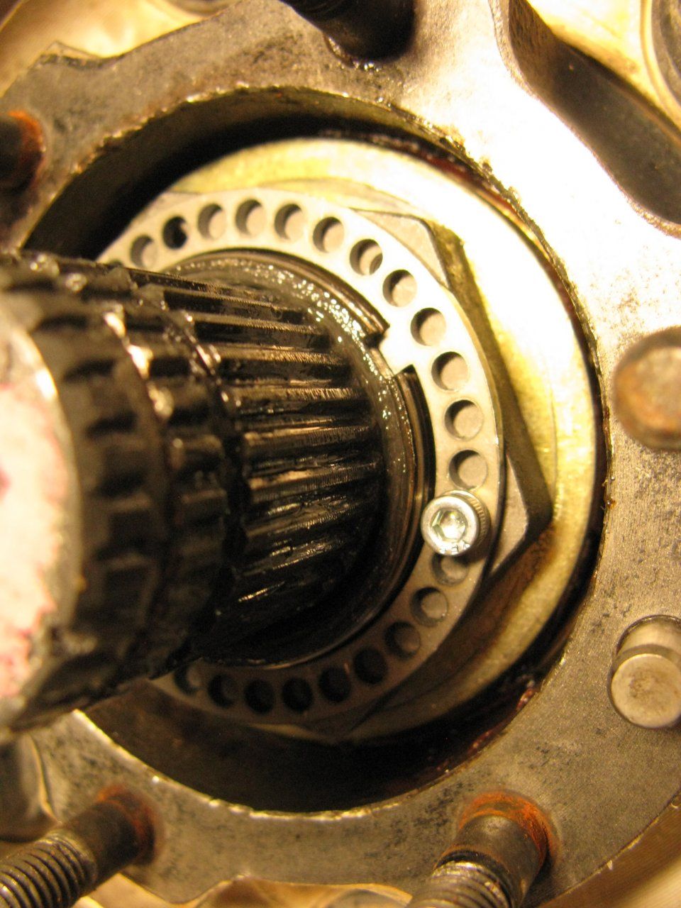

In the past I have used a similar setup on off road race vehicle and really like them. So when I saw they were available for our Toyota from Trail Gear I ordered some up.
Takes about ~1hour to do both sides maybe a little more for the guys with hubs. My bearing preload and grease was spot on and fresh enough that all I did was the upgrade.
Down to the old stuff
New beefy nut (~10mm thick) installed with preload set
Locking ring installed. The ring has plenty of hole options to get and hold your preload exactly the way you want it.
A nice product and I will never need to buy a star washer or worry about loosing my preload or a nut loosening again.
New beefy nut (~10mm thick) installed with preload set View attachment 1050654
Locking ring installed. The ring has plenty of hole options to get and hold your preload exactly the way you want it. View attachment 1050655
EDIT - I did swap during the week not the weekend:oops:
Nice I have my 2 kits sitting in the garage waiting to go on...
Wasn't aware of this option so thanks for sharing! I need to rebuild my front axle before Cruise Moab so this will get added to the list.
I just installed those. They're awesome. Same stock setup on my Nissan Frontier. The star washer is a really stupid design. These are a win. Picked up this to make installation even quicker.

That's odd. Did you have a 2.5mm key to try it? Even this guy said 2.5mm:
Mine came from CoresWest in a vacuum sealed package:meh:
Checked I got the light weight cheap stuff:( and the 2mm is still on the bench:confused:
The possibility Im wrong existed but I carry a full set of allens (that I hope I never need on the trail) so Im cover if that case.
TG instructions say 2.5mm. Going to order one of these shortly.
