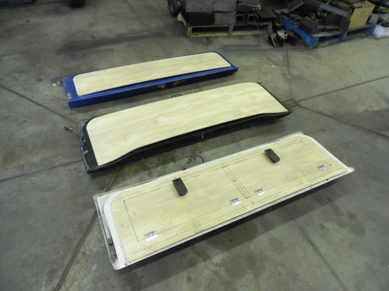

@LandCruiserPhil Isn't that similar to the 200 series design? I thought I saw one at the dealership and it looked like the included tool kit was built into one of the two dual doors. I really liked that idea and have been waiting on someone to bring that to the 100 series platform!
Toyota possible copied my tailgate storage from a couple years back:grinpimp:
Rear Tailgate Storage Solution - The $55 version
Yea! Is this to be brought into the USA market?
Depends on costs. Just in the R&D phase now. I've trashed many hopes over the past few years because they are just too expensive.
I hope this one will be cost effective.

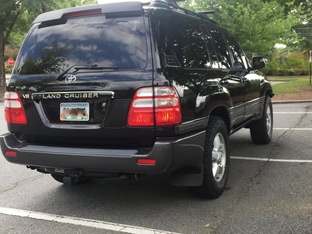

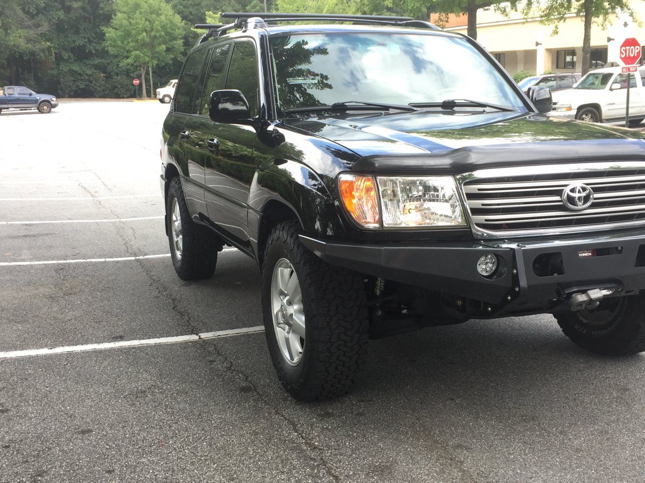

Installed a set of 30mm Bora spacers.
These pushed the narrowish 275/70-18 K02's outward toward the wheel well quite nicely. Took a quick spin to test; steering input feels better, maybe a little less body roll with the wider track. I'll do a hwy test tomorrow after the locktite sets up.

Thanks- Yes the Bora spacers are Hub-and-Wheel centric, and the front spacers are machined to fit around the front hubs correctly. Hardware is included- the lugs are grade 10.9, slightly longer than the stock lugs but not too long. Made in USA with lifetime warranty- @ $55ea. They are made to order, so expect to wait a few weeks. They can be found online at motorsport-tech.
I dont have any 1st hand experience with Spidertrax (Its probably a good quality product or Slee wouldn't carry them) but they've been backordered for a while and I moved on to this option. Time will tell, but I felt it was a good alternative. Close friend owns a rover repair shop, and has been using Bora for several years on customer rigs and his own- no complaints. He's the one who recommended them to me.
