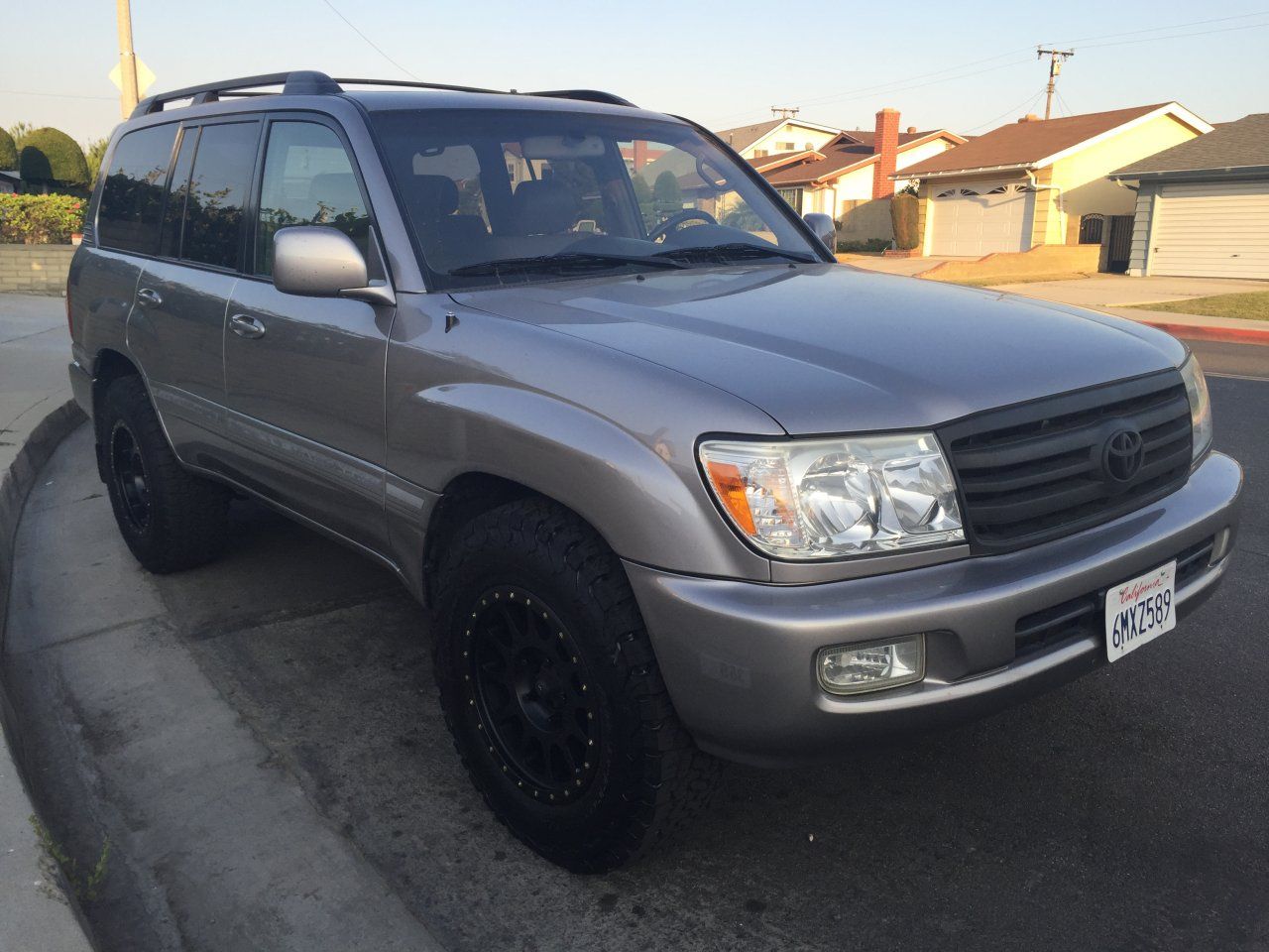

@Lacalusa literally just ordered a set of NVs yesterday. I'm assuming those are 18x9 with 25/6 offset? What size tires are you running? I ordered 275/70r18
@DirtDawg yes these are 18x9 with 25/6 offset and my tire size are 275/70/18, I guess we will be twins hehe...
Love how the offset made the wheel come out and have an aggressive more look to it, didn't like how the stock wheels where more in looked a little weird. Love the look now
Literally gonna be twins.... I ordered ko2s as well. So much for being original ;) I guess that just means we both have good taste?
Also good to know that they clear fine with no lift. I'll want to throw mine on while I'm waiting for all my lift parts to show up.
@DirtDawg they clear fine but slight rub when hard turning and hitting bumps faster than normal. I still have to find out where they rub or just buy a lift kit n not worry at all but probably won't fit into garage with lift sucks. Yea my tires are ko2 also hehe.

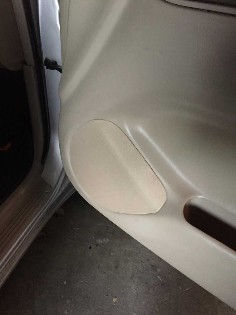

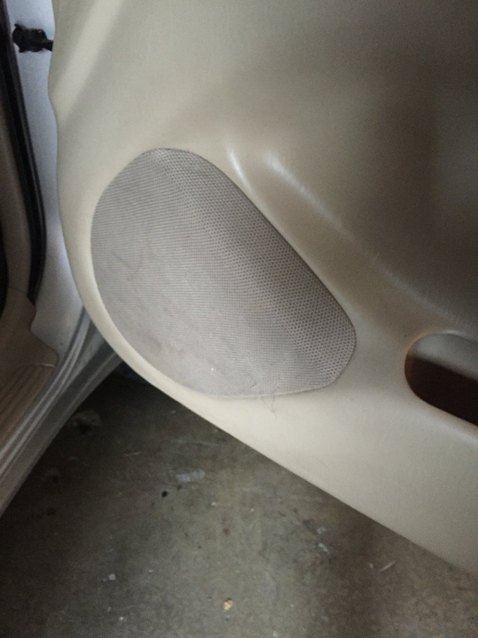

Looks good how'd you do it?
Door panels have to come off. There are 4 screws behind the panel that hold the grill in. This is the cloth I used and they come in different colors.
Speaker Grill Cloth Light Sand/Tan/Beige Front Fabric Mesh Home Car Audio 36x66"
I removed the old cloth and used it as a template to cut out a new sheet, but a tad larger. Turned the grill upside down and sprayed 3M adhesive around the outer edge where the original cloth stuck to. Spread the new cut out and put the grill on it, then slightly stretched, folded over and pressed on the adhesive.
