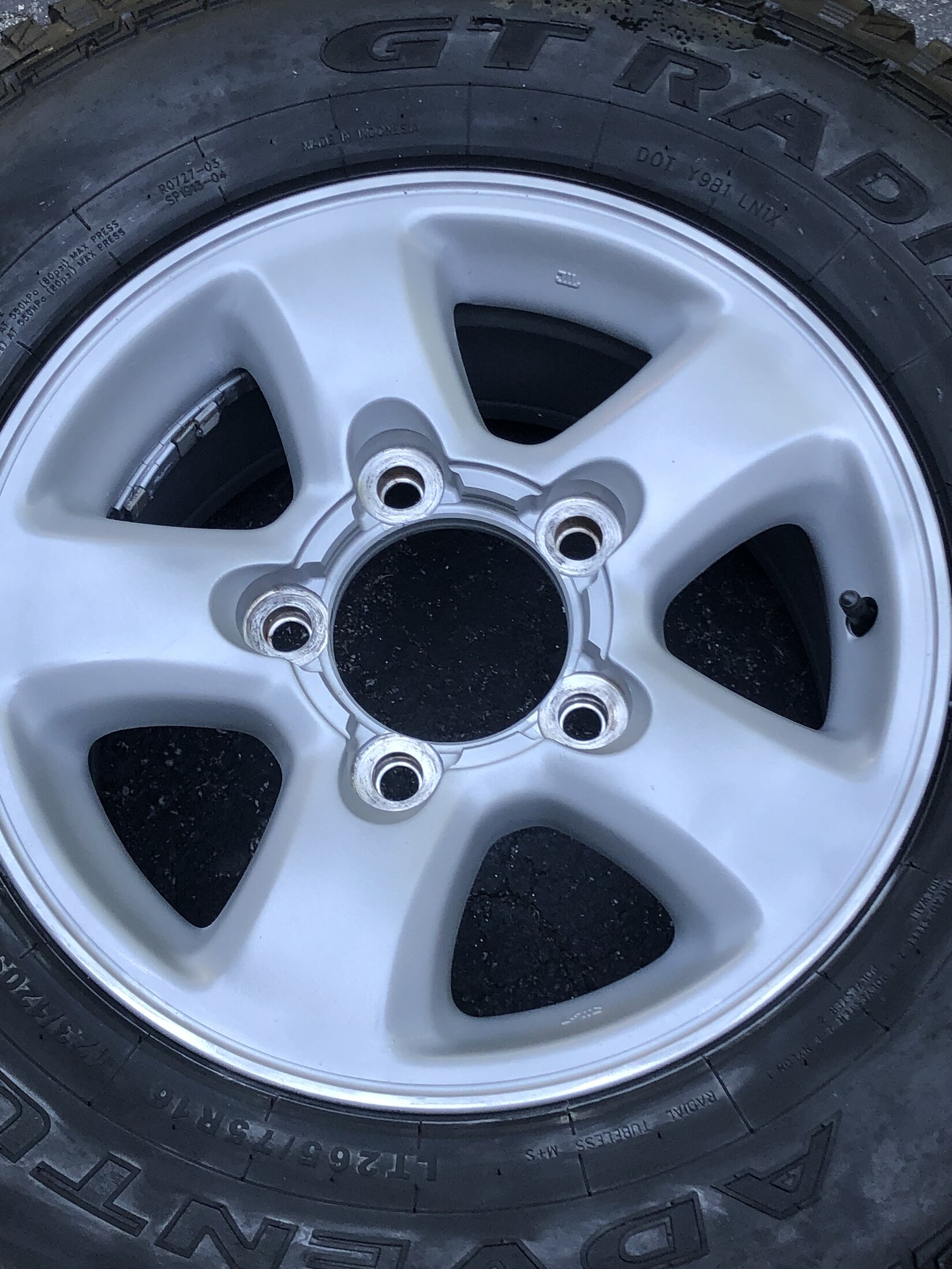

Also reconditioned the wheels on this new to me truck :)
VHT high temp flat aluminum with clear coat. Not bad from 5 feet, LOL

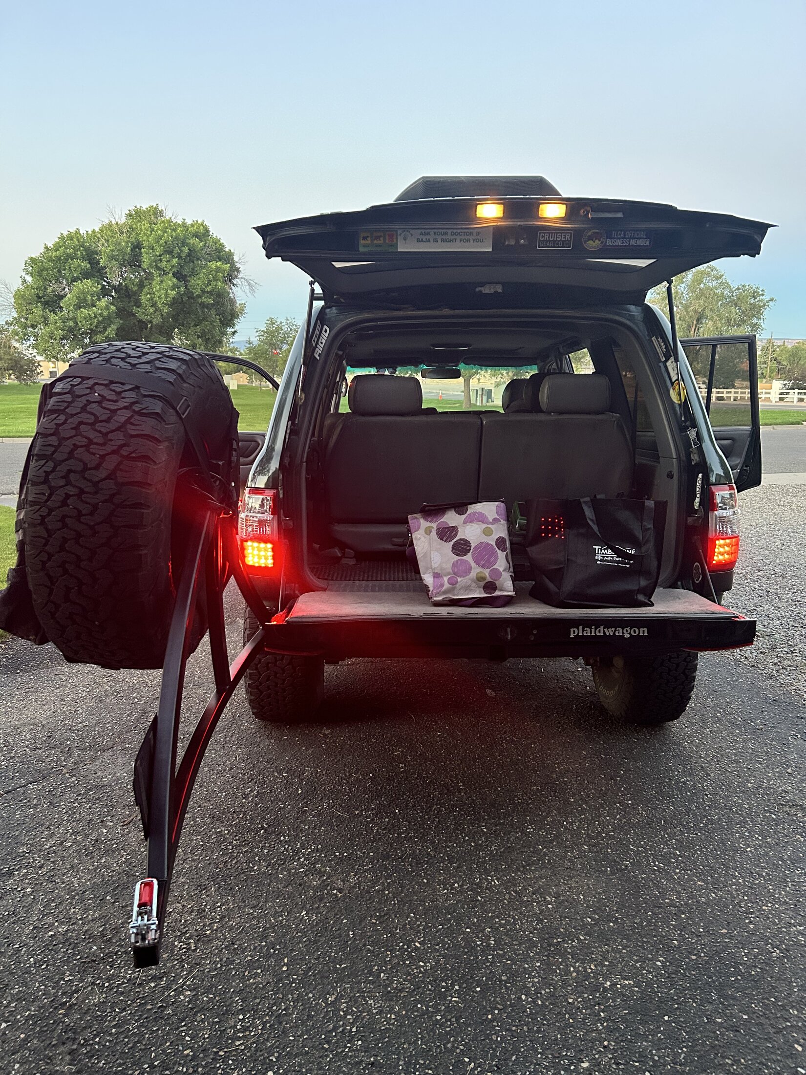

Chipped away at my rear bumper build. Center section is almost done, few more gussets and tubes to add so it’s all tied in together. I was in a mad scramble trying to get something roadworthy for the holiday weekend trip over to my folks in Kansas, only had 2 nights to work on it. Everything is rolled to match the body lines, frame is chopped and boxed with 3/16” plate. Still need to make the sides and a small cooler tray above the license plate.

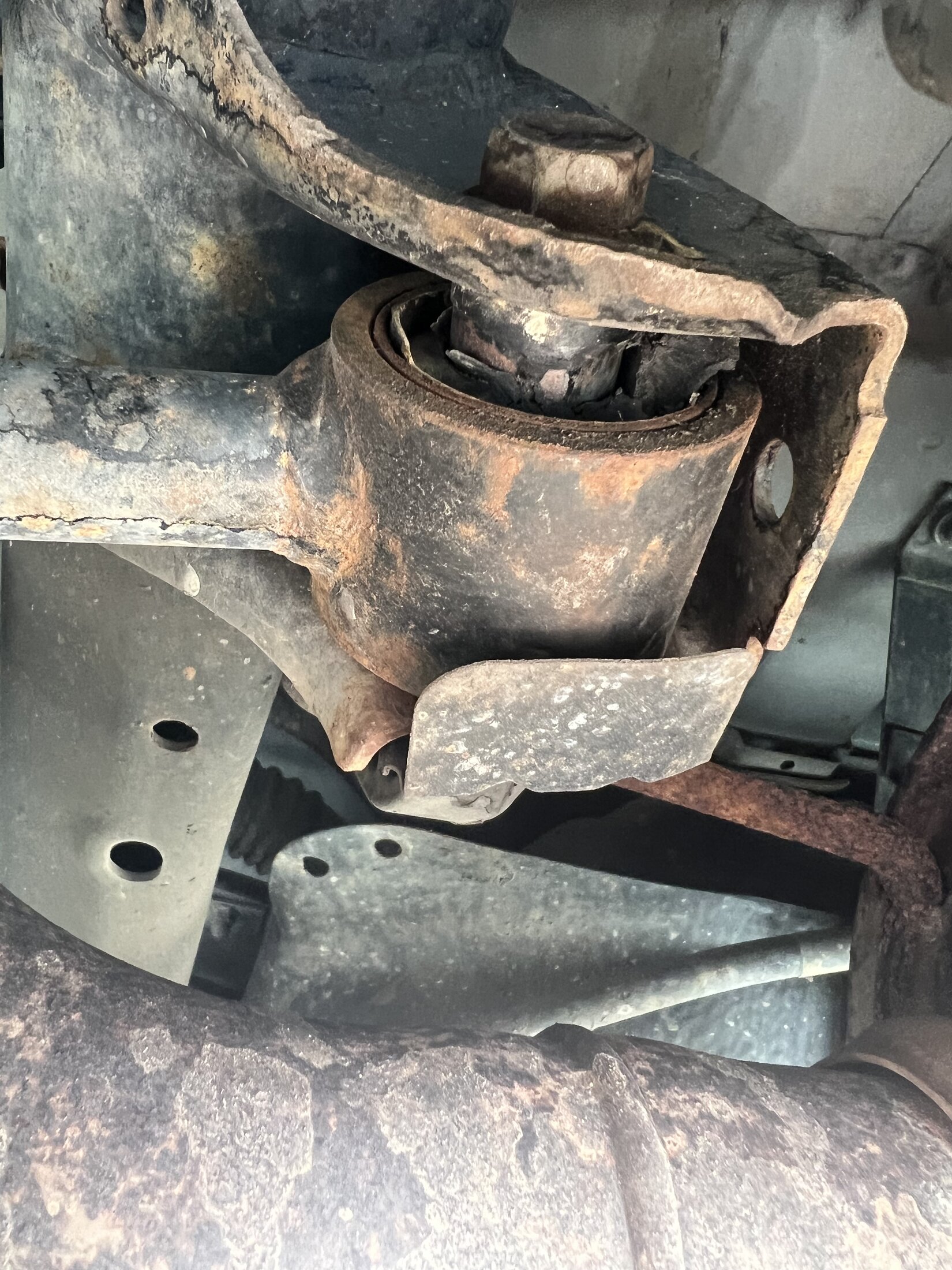

Had a squeak coming from the rear end. Worked on tracking it down with a stethoscope and was between the shock and the upper control arm. Had a trip planned so decided to run it as is. On the trip we noticed the noise went away and didn’t come back so figured I should look again when we got back.
Driver side didn’t look too bad.
But that passenger side…..
Very sleek design! ...But man is that swing out long. Any concerns about trying to manipulate it to open the rear in a parking lot?
It doesn’t seem as dramatic in real life compared to the picture. Pretty similar to opening the rear door on our GX. I knew for sure that i didn’t want two swings to deal with, i have this idea of making a drop down panel that lines up with the tailgate to create an L shaped workspace at camp. We’ll see how it all ends up, pretty much building on the fly at this point 😅
