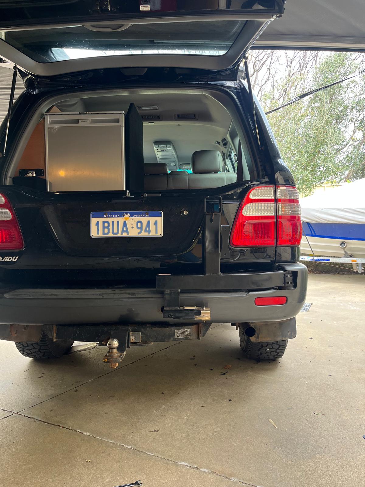

Working on installing a 200 series Kaymar tyre carrier, now just need to sort the latch position along with replacing the bumper reflectors with some brake light / indicators

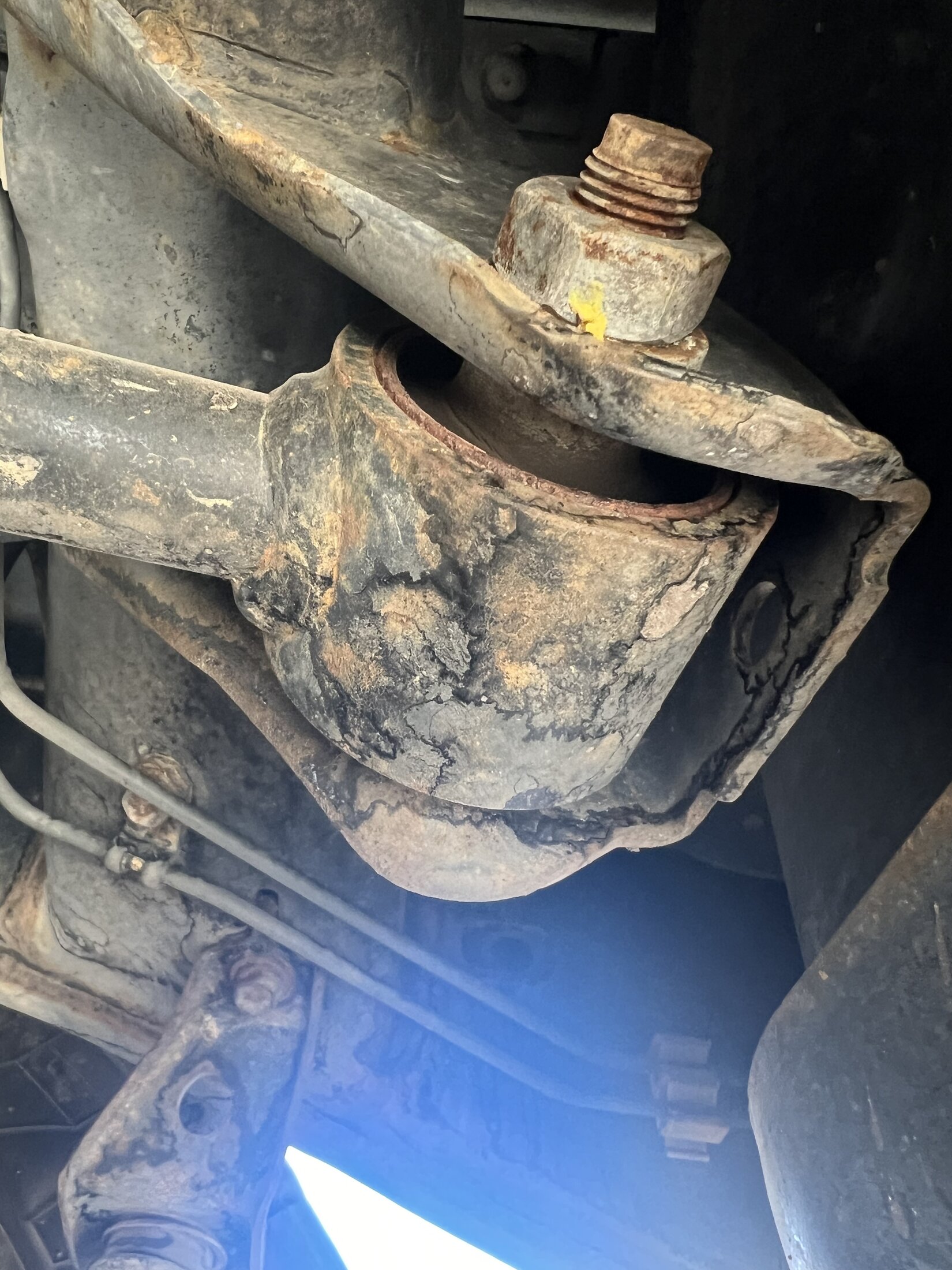

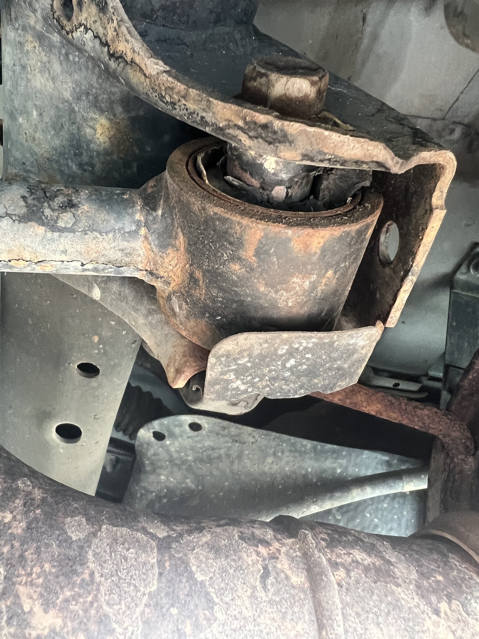

Had a squeak coming from the rear end. Worked on tracking it down with a stethoscope and was between the shock and the upper control arm. Had a trip planned so decided to run it as is. On the trip we noticed the noise went away and didn’t come back so figured I should look again when we got back.
Driver side didn’t look too bad.
But that passenger side…..
I’m wondering if the squeak I have is the bushings or potentially this. What’d you end up doing? Bushings swap and other rubber pieces are my next to do after this windshield gets installed.
I have receipts that the previous owner had the UCAs replaced in 2020 with some aftermarket units. If I was 100% sure new OEM bushings would press in I would go that route. Since I have some uncertainty there, I am just going to replace both with new OEM UCAs. I am also going to add some head shielding on the passenger side since it seems to get cooked more from the exhaust pipe that runs adjacent.

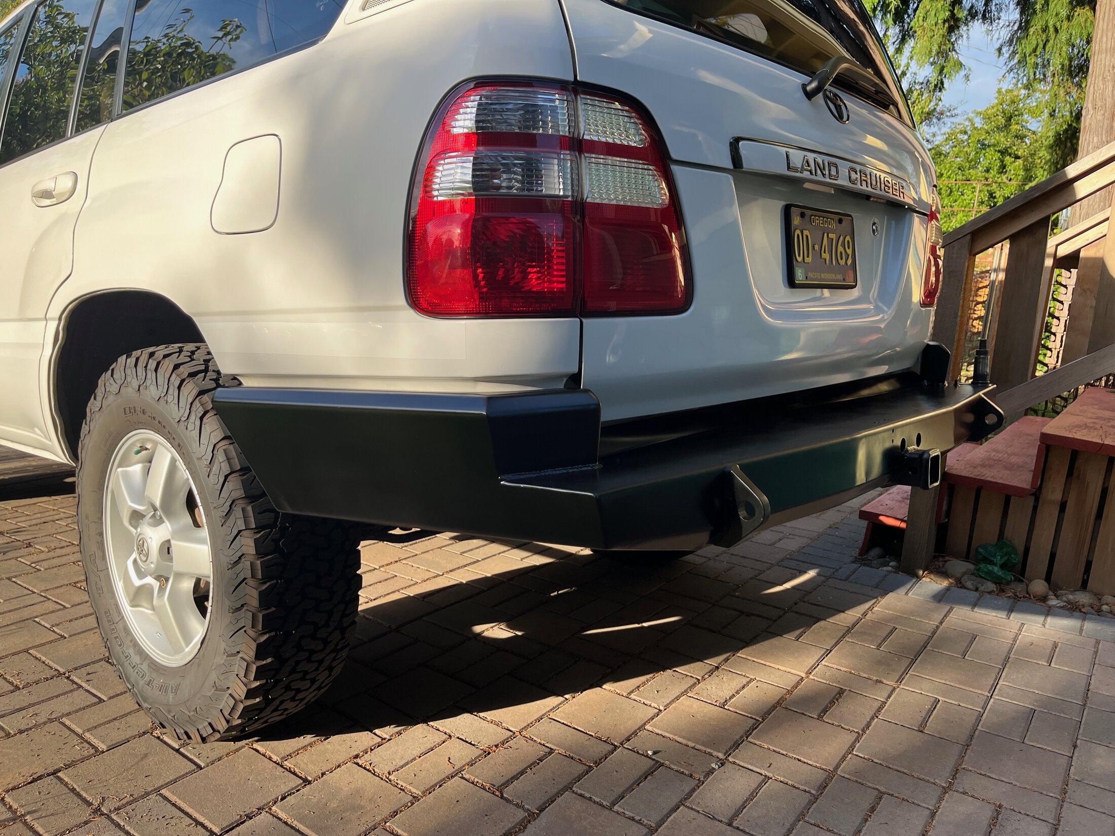

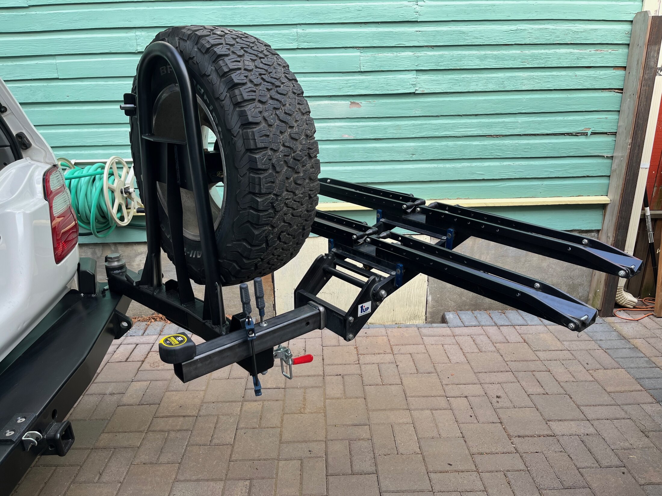

I recently found a good deal on a Slee single swing out rear bumper that I just couldn't pass up. This thing was heavily neglected though and the swing out bearings were completely rusted out. Over the last few weeks, I rebuilt the spindle with a Slee kit, gave it a fresh coat of paint, and mocked up a 2in receiver for a bike rack.
I also ran into some issues though...
My 2003 LC has the pass through rear crossmember (thought this was only on LX's?) and 6 of the bolts don't work. The 4 bolts in the center don't line up, which is ok according to Slee, but I also can't figure out a way to tighten the 2 nuts that go in the back side of the frame. Anyone with a 2003 and Slee rear have any tips?
The tire carrier also sits leaned back by a few degrees. I think this is due to the right side not being perfectly level/aligned, but it also could be bent I suppose.

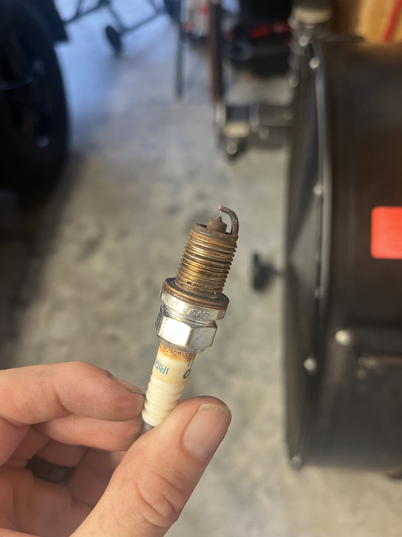

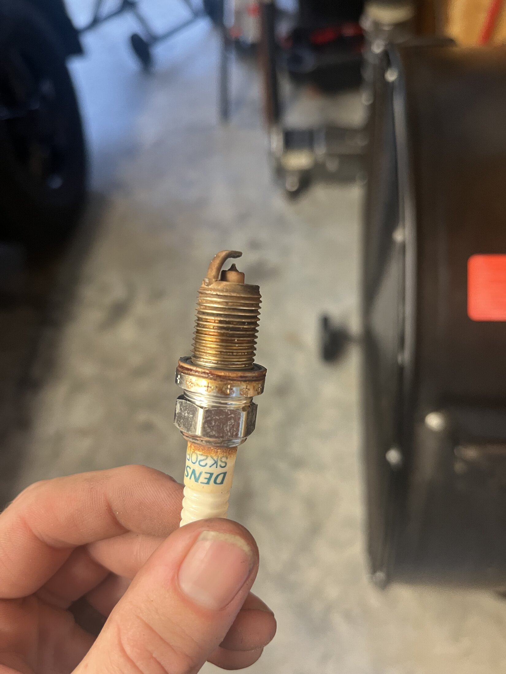

Pulled the front passenger spark plug this morning (not sure the numbering system) to take a look.
I’ve never been one to deduce anything from looking at plugs other than if they are soaked, so posting pics for any thoughts.
07 168k guessing they might be OG. Combing through service reports now to see.
