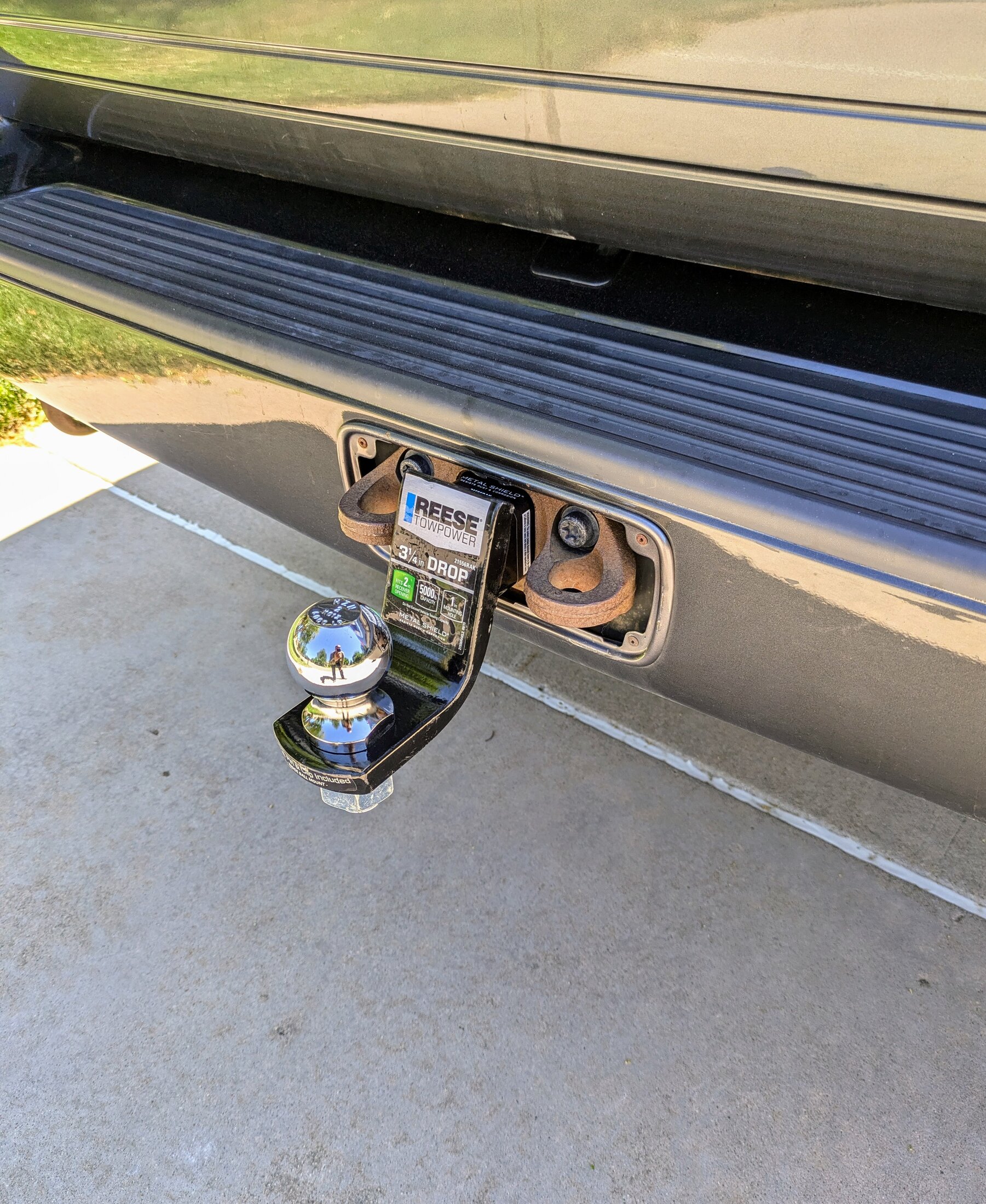

Worked on my towing setup today in my new to me 2004 LX470.
As others have mentioned in this thread, the integrated hitch in the bumper is a unique idea that requires some additional planning and possibly modifications to use when compared to a more traditional under the bumper setup.

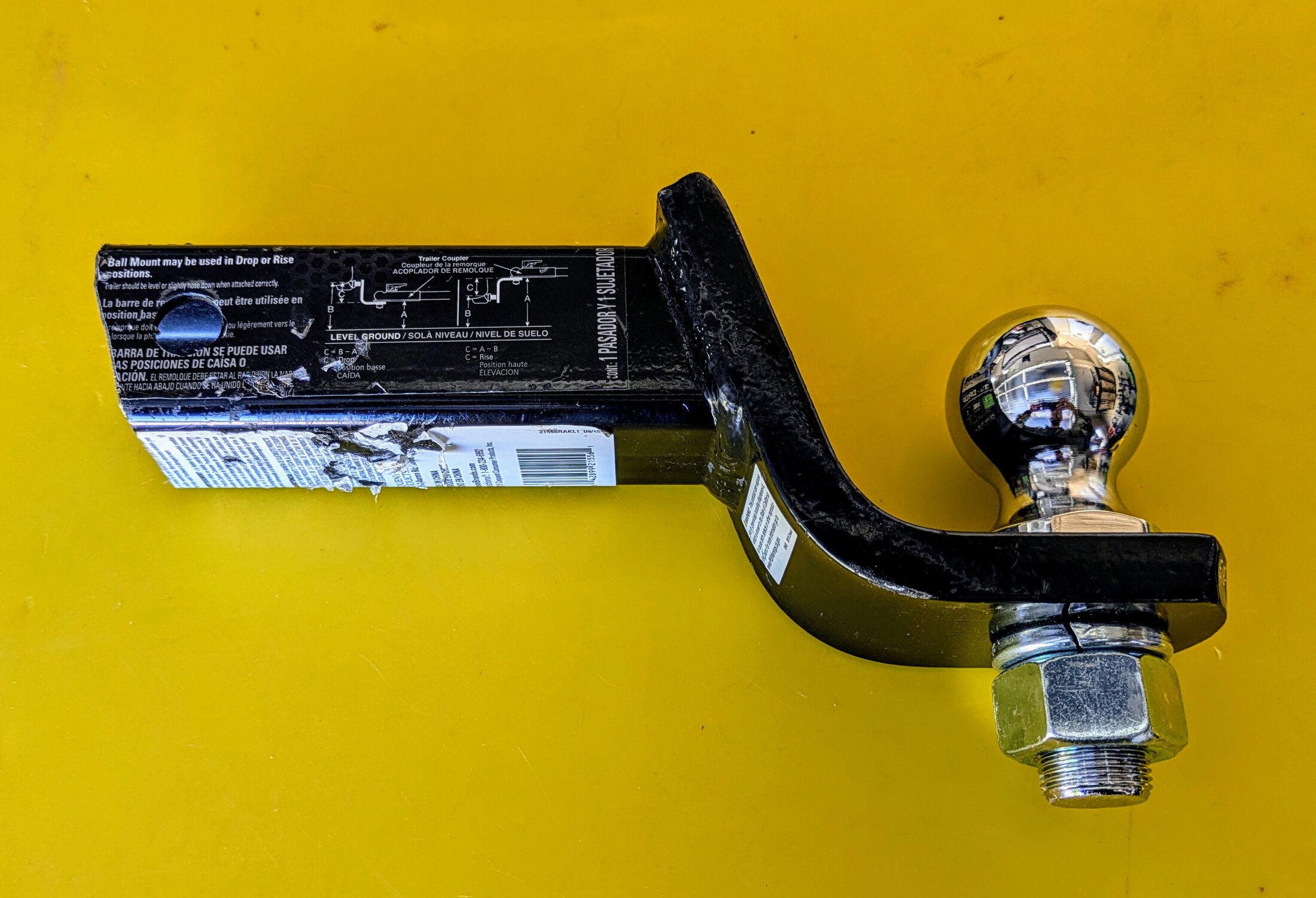

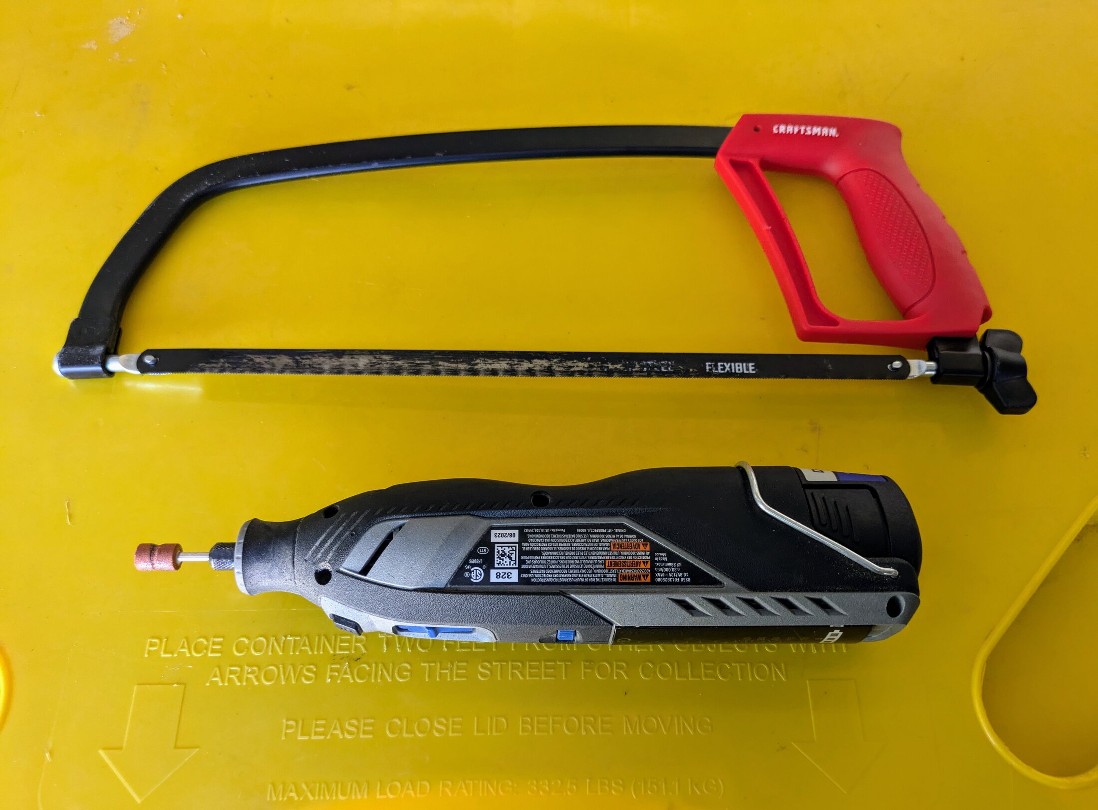

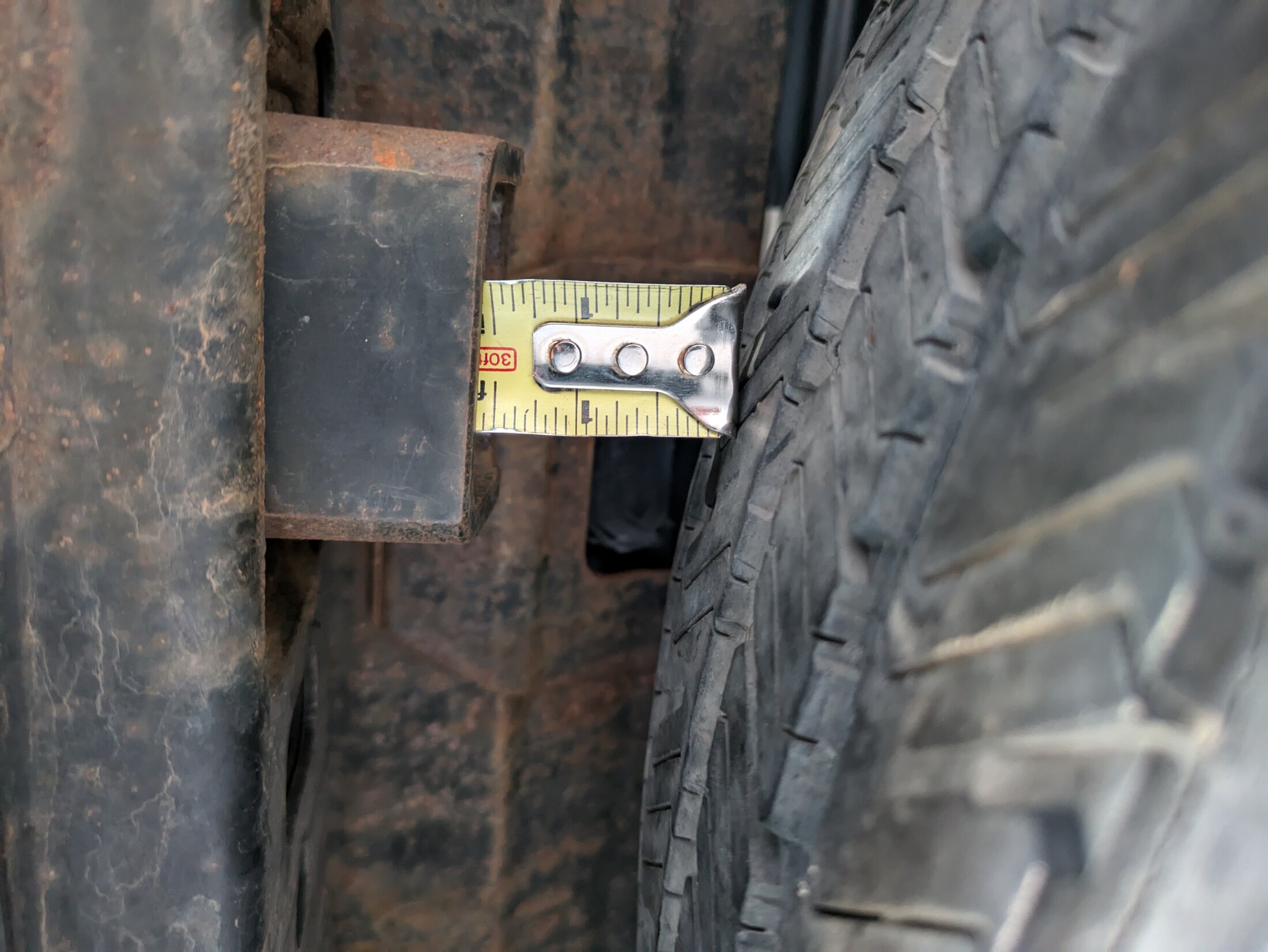

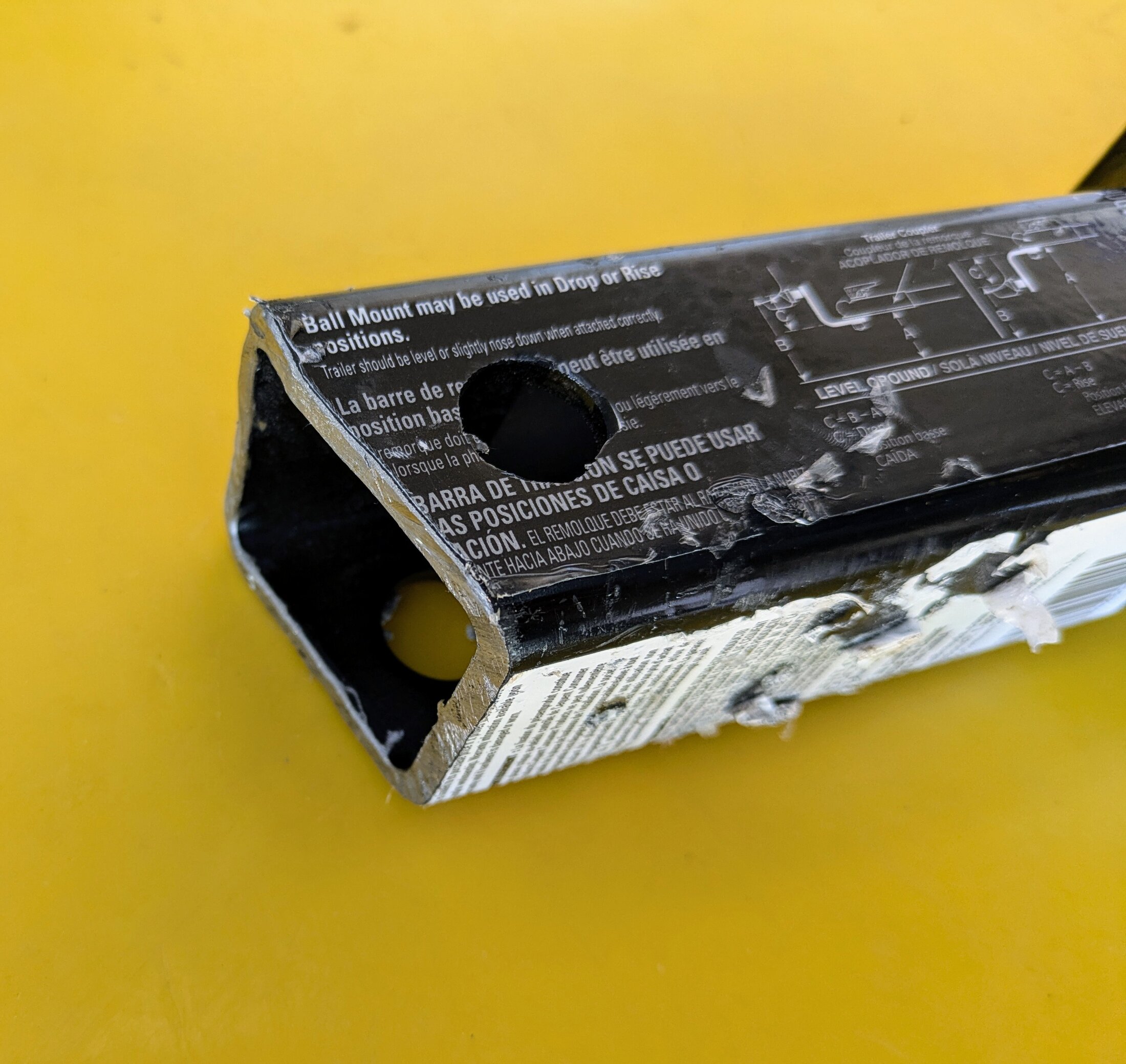

For my setup, I intend to run 33" tires including a matching spare. To ensure the spare can fit in the stock location, I needed to shorten my ball hitch connection by about an inch. I made it about flush with the sleeve, which should provide just enough space to fit a 33" spare. I'll know for sure in a week.
Reese 3 and 1/4 inch drop hitch before cutting. You can see the hitch extends into void that houses the spare, limiting the size tire that can fit there.
Hitch after cutting flush with sleeve.

Space between OEM hitch sleeve and stock size tire.

The next problem is the hitch pin hole alignment, which hasn't been compatible on anything other than the Toyota OEM receiver (a very nice piece, BTW) and a Yankum Ropes Hitch Receiver Recovery Point. Alan at Yankum is a Land Cruiser guy, so maybe that's why... Toyota allows 1" between hole center and the end of the receiver before spare tire interference is possible. Most domestic products have 2" between hole center and the end of the receiver.
