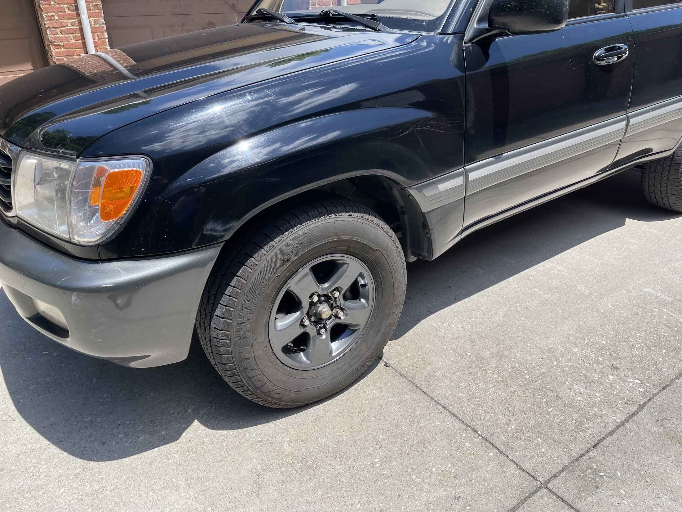

Powder coat job. Member here @TRLBOSS gave me the idea, or rather I stole it. The wheels caiman out great. Just doing my diligence to post here on ih8 mud as any good citizen would do. Speedway Gray.
This place in Maryland did it.

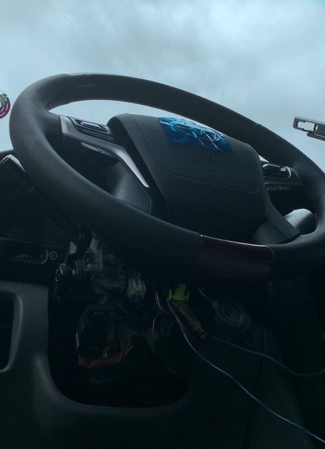

Just fitted the 200 Series steering wheel including hardwiring the (left side) controls and illumination on my 2001 (1HDFTE) with just the 6-Pin clockspring and without a third party module :steer: I wanted them for years!
I havent run the wires behind the dash yet, as I hope I will get the right side to work as well.
Can you post another picture of the top view, that’s looks sweet!

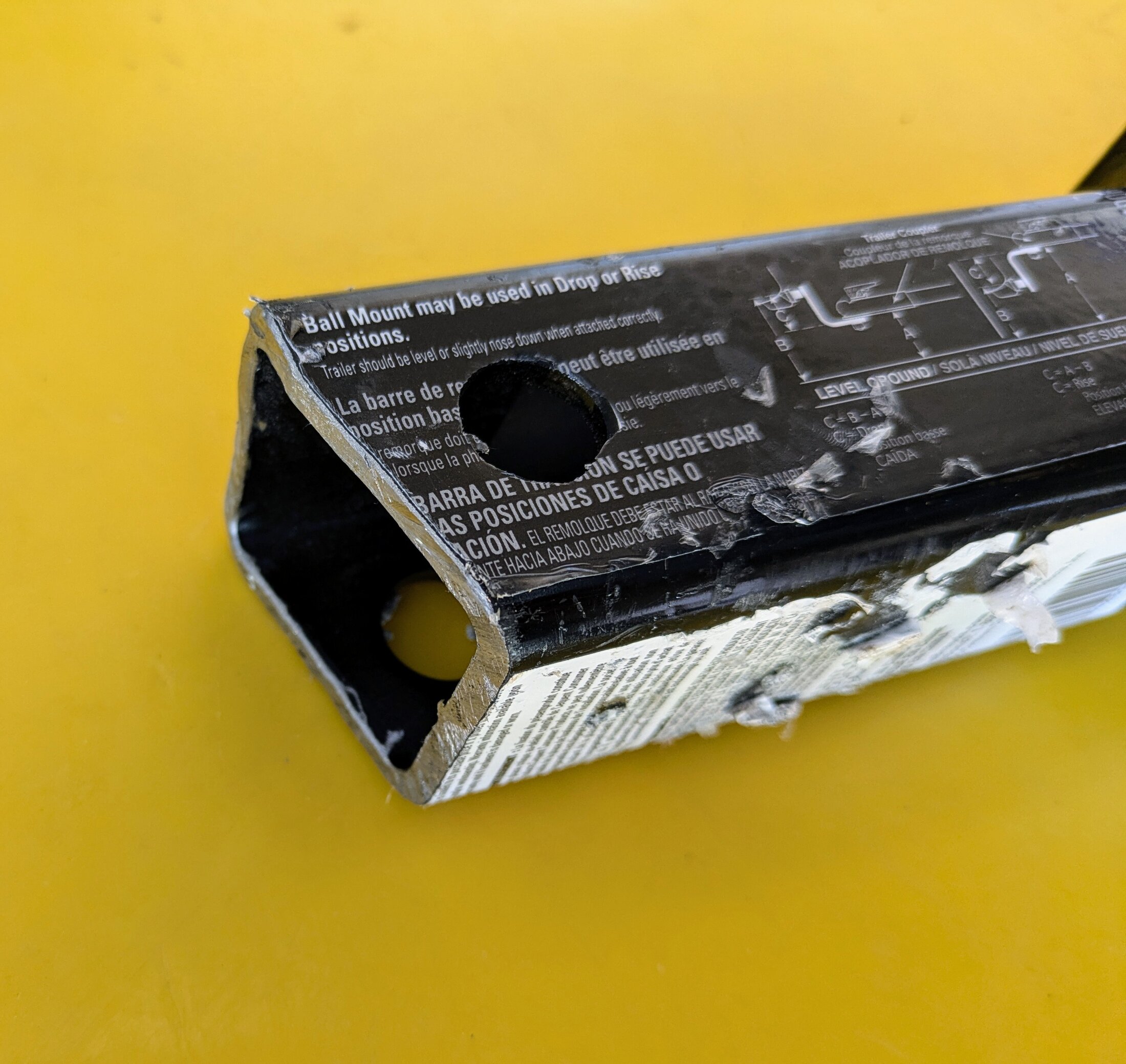

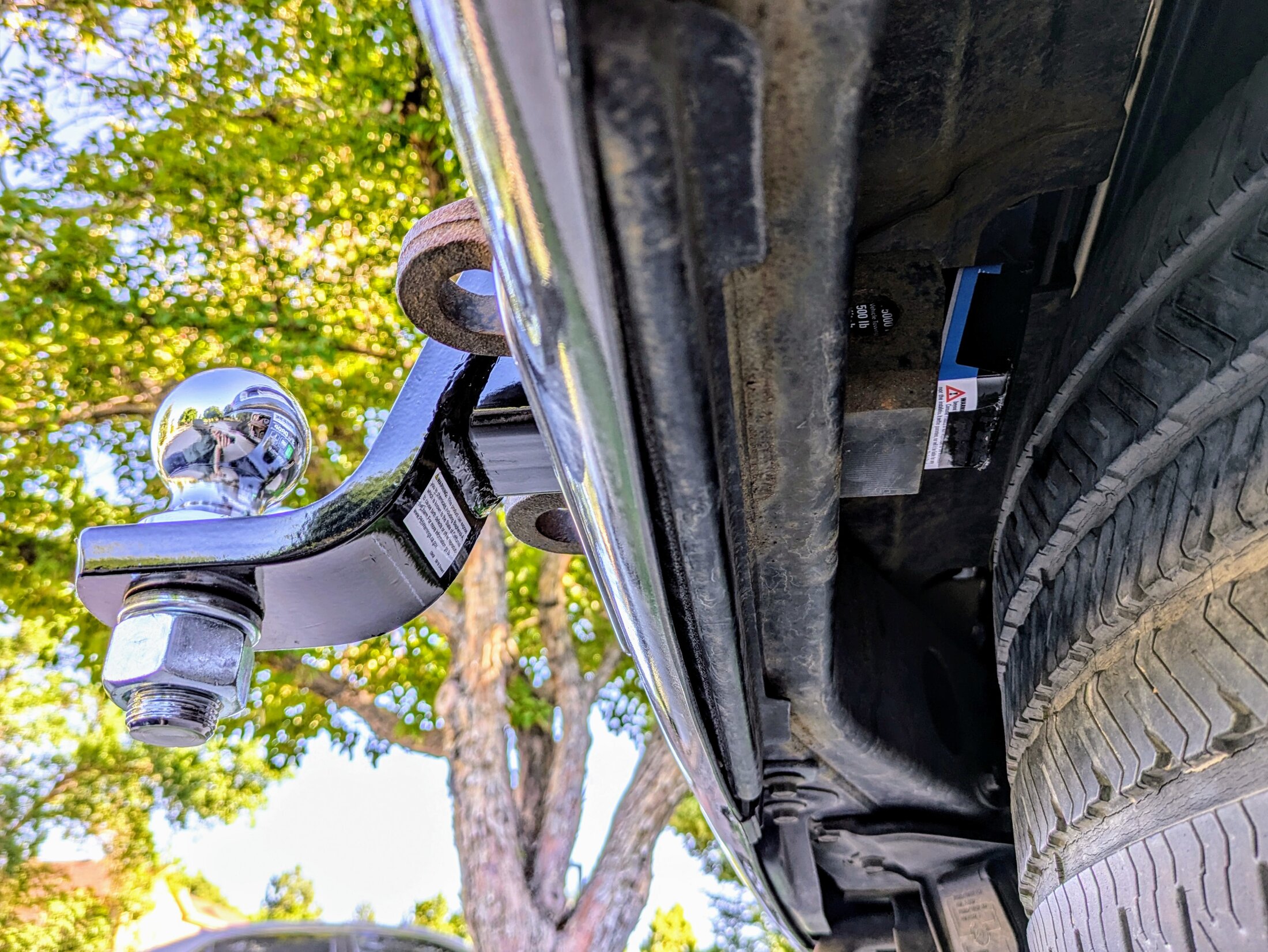

Worked on my towing setup in my new to me 2004 LX470. Based on the thread I linked above, feelings around the integrated bumper hitch of the mid generation LX470 are... mixed.
I like the idea of it but we'll see how reality compares to expectations when I tow with it in the near future.
