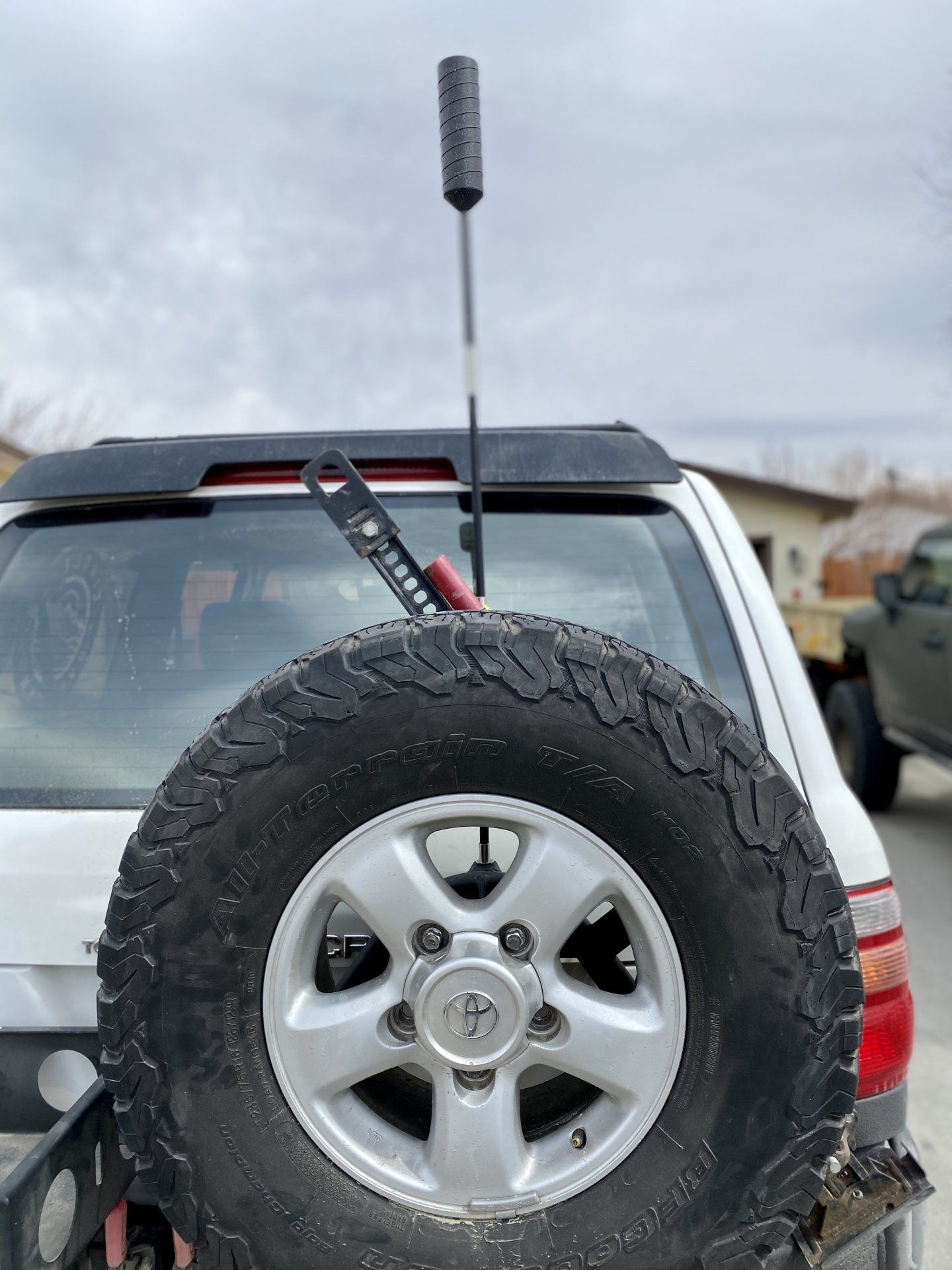

Used it for work one day, did the usual exploring and installed a weboost.

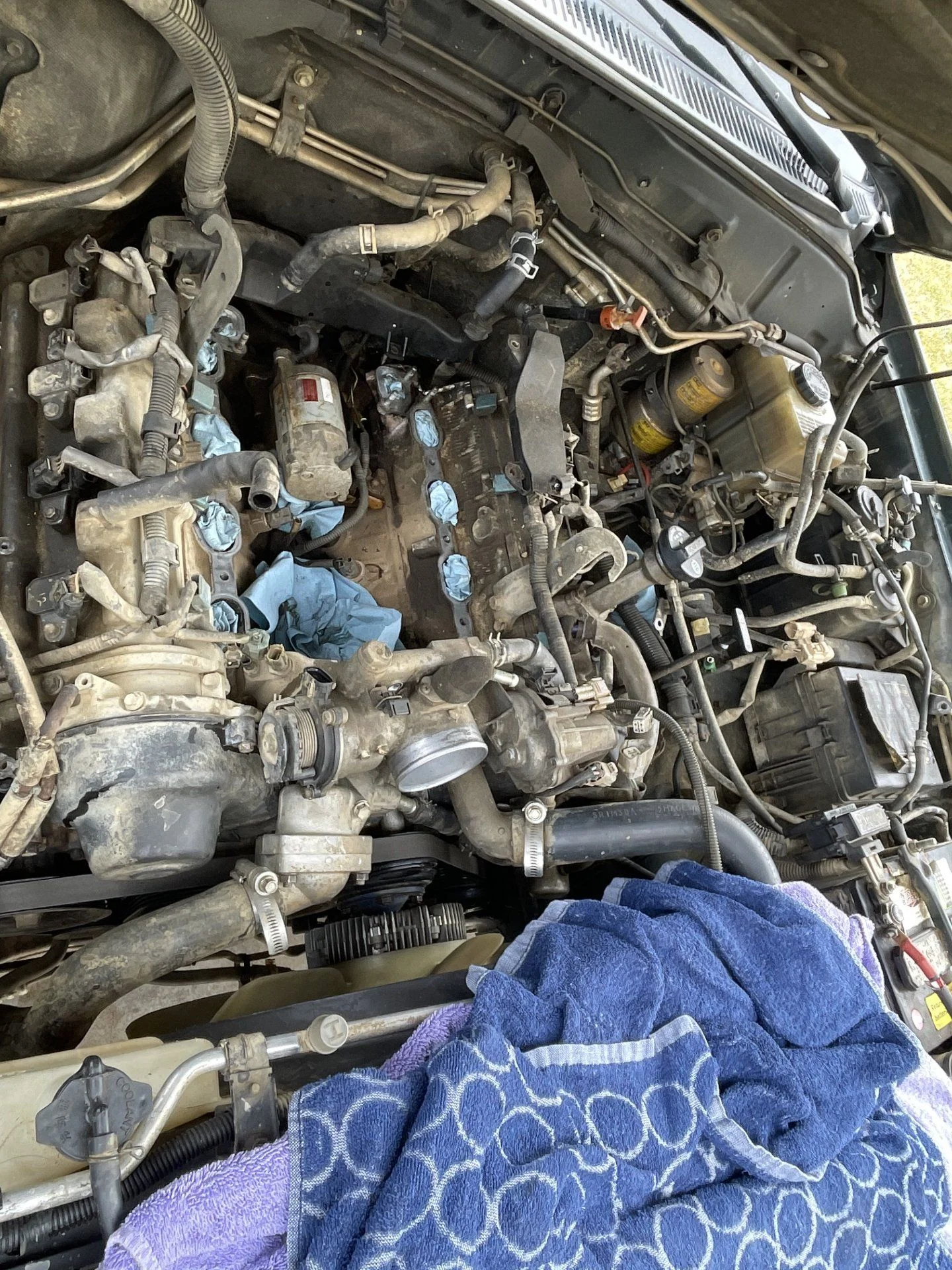

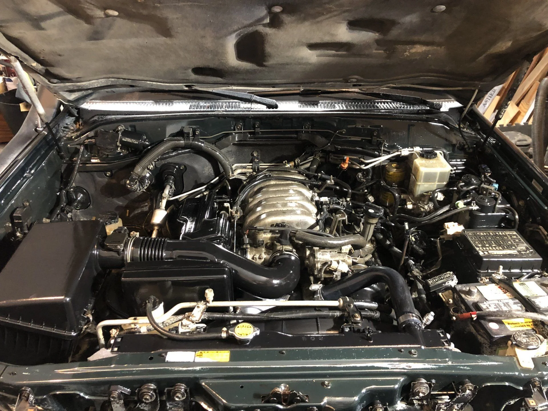

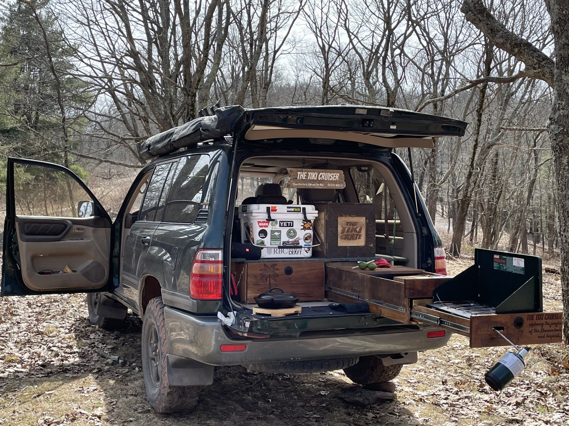

Heater by-pass pipe leak fixed (replaced the assembly), both by-pass gaskets replaced, plenum gasket replaced, intake manifold gasket replaced, carbon deposits cleaned, throttle body gasket replaced, immediately went offroading up in the mountains for picnic....no leaks so far.
More importantly than all that boring stuff I finished the driftwood tiki bar sign for the back:
View attachment 2615121View attachment 2615120
Good job.
Washing that engine bay might be your next good weekend project? ;)

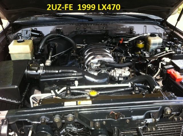

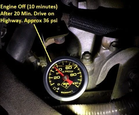

Engine on (idling) 47 psi. Haven't had time to test it in other modes. Just threw it on there today and went to doing other things, but I'll make note of it and post back when I can.
Edit/Update:
Took a couple readings tonight to follow up on this.
Wife came home and parked the vehicle. It had been driven for 20 miles at highway speed. I let it sit for 10 minutes and then went and looked at the pressure. It had dropped to about 36 psi.
I then cranked the engine and let it idle for a few minutes before recording the pressure (about 40 psi).

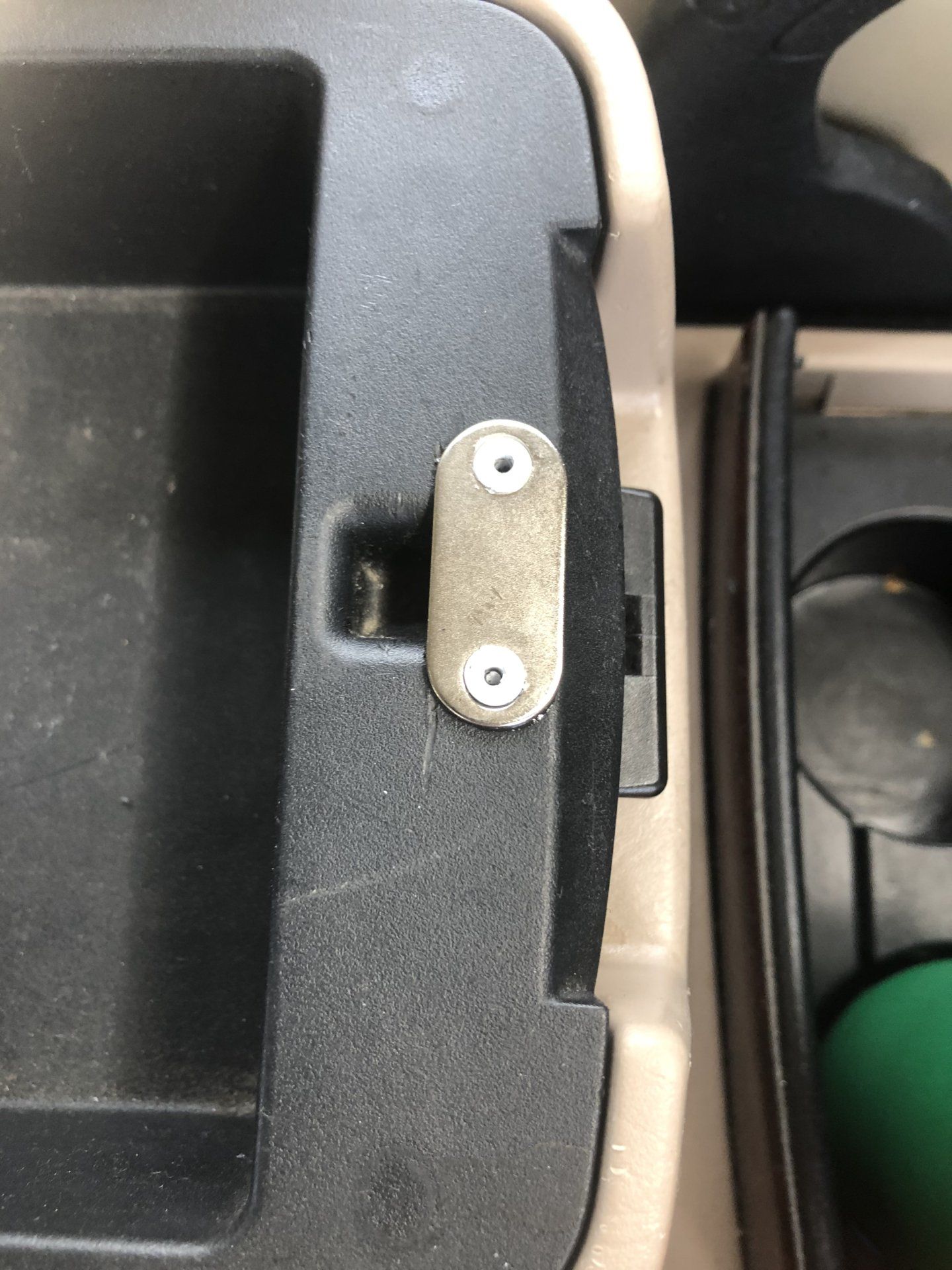

Ever since I bought my LC nearly two years ago the top door/compartment on my center console did not latch. I had a strap holding it to the second door/hatch to keep it closed. I had been looking to buy another upper section and replace, but all options were $$$. So I came up with my own solution that was nearly zero $. I bought a magnet latch off of Amazon and some rivets at the hardware store. View attachment 1719478
And less than 10 minutes later......
Works perfectly. $13 ish for the latch and rivets. Saved myself about $137 compared to my other options.
How has it held up over the last few years. Functionally all good?
I fixed my center console latch by building up the plastic "hook" that broke with JB weld, then sanding it down to shape. Works just like intended,

Thanks flint, I'll add to my date base.
There is one more reading and a side notation, I'd like to see from you, next time your in tech stream. If you don't mind me asking.;)
It's with engine off, running fuel pump through tech stream. FSM range is 38 to 44PSI. States replace FPR if pressure high. I'm seeing in 3 I tested 46 to 47PSI. Accuracy comes into play with any gauge. But still, I don't think 47PSI enough to justify replacing FPR.
One other thing I once notice (need to check closer, on some more fuel pumps) was; Fuel pump would pause about every 20 seconds. I do know others paused, but I did not take the time to see if keep repeating every 20 seconds.

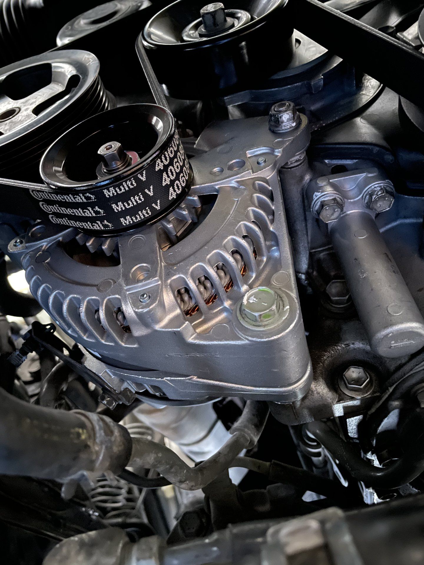

Took a visual inspection of the reman denso and looks to be fine, I just noticed I’m just getting 13.5V on an average with this alternator.

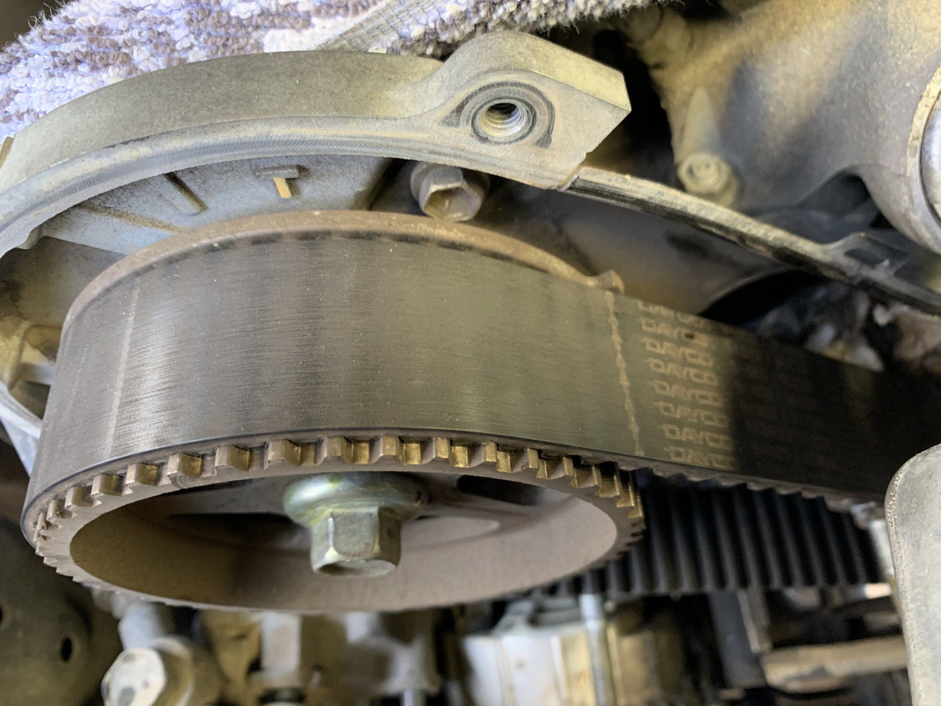

Got in to do the drive belt tensioner, you guys think i should do the timing belt too??
It was supposedley done about 25k miles ago but im not so sure now that im looking at it!
Not an OEM t-belt. Odds are the water pump, tensioner, and pulleys aren’t either...I would replace with the Aisin TKT-021 kit just to get that aftermarket and/or never-replaced-high-mileage stuff out of there.

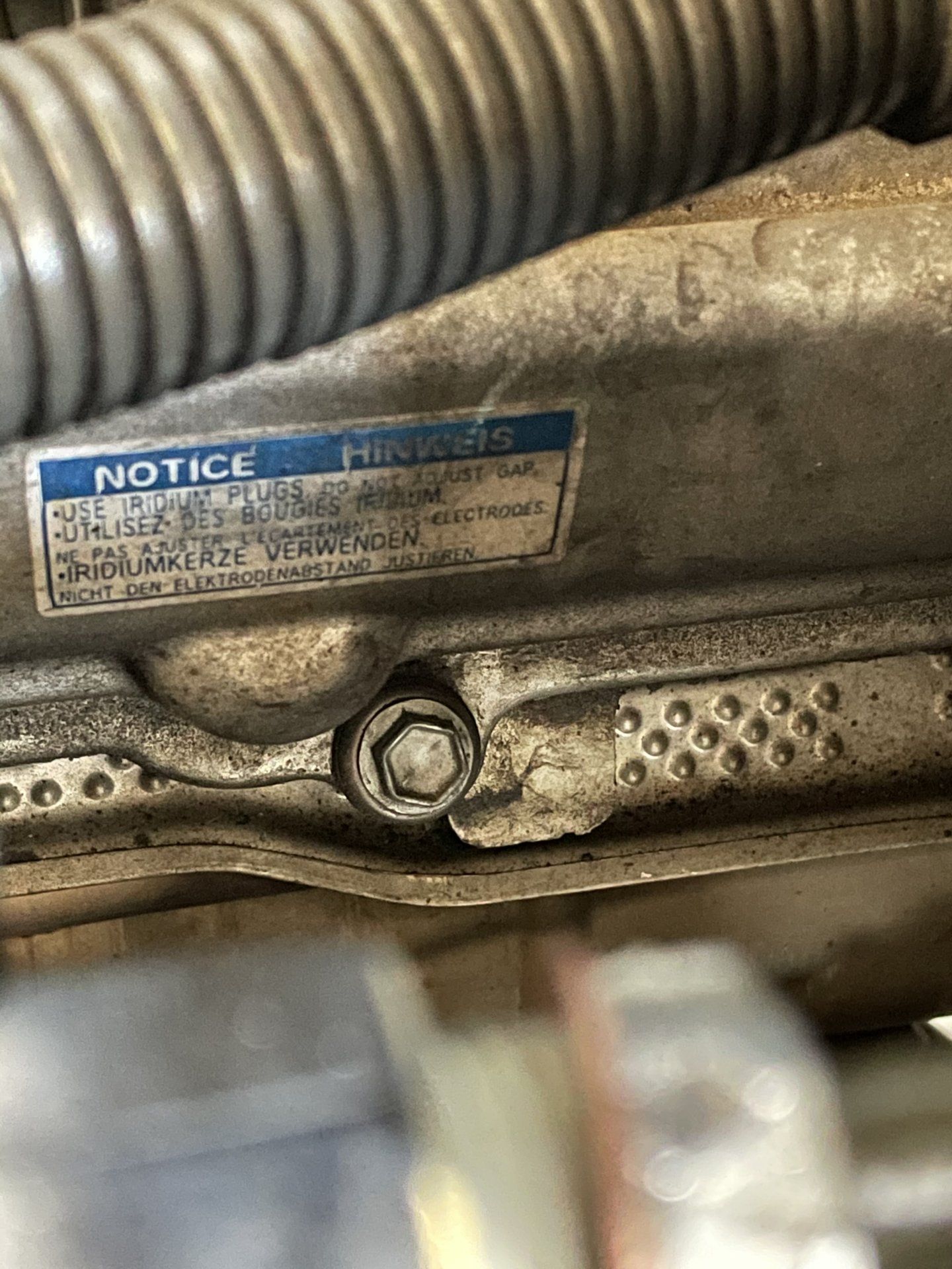

650+ miles after I tightened the valve cover bolts on the driver, confirmed that no more oil is leaking.View attachment 2616233
Once my engine warms up and the Denso Reman (from NAPA) the voltage is in the mid-13's. I have had it tested a few times and it has always tested good. Both on the truck and pulled and tested at my local Starter and Alternator shop (Dayton Quality Starter).
Once my Denso Reman (from NAPA) warms up and has been running the voltage is in the mid-13's. I have had it tested a few times and it has always tested good. Both on the truck and pulled and tested at my local Starter and Alternator shop (Dayton Quality Starter).
x2 - mine starts out around 14.2 and then stays mid/upper-13s after warmed-up.
