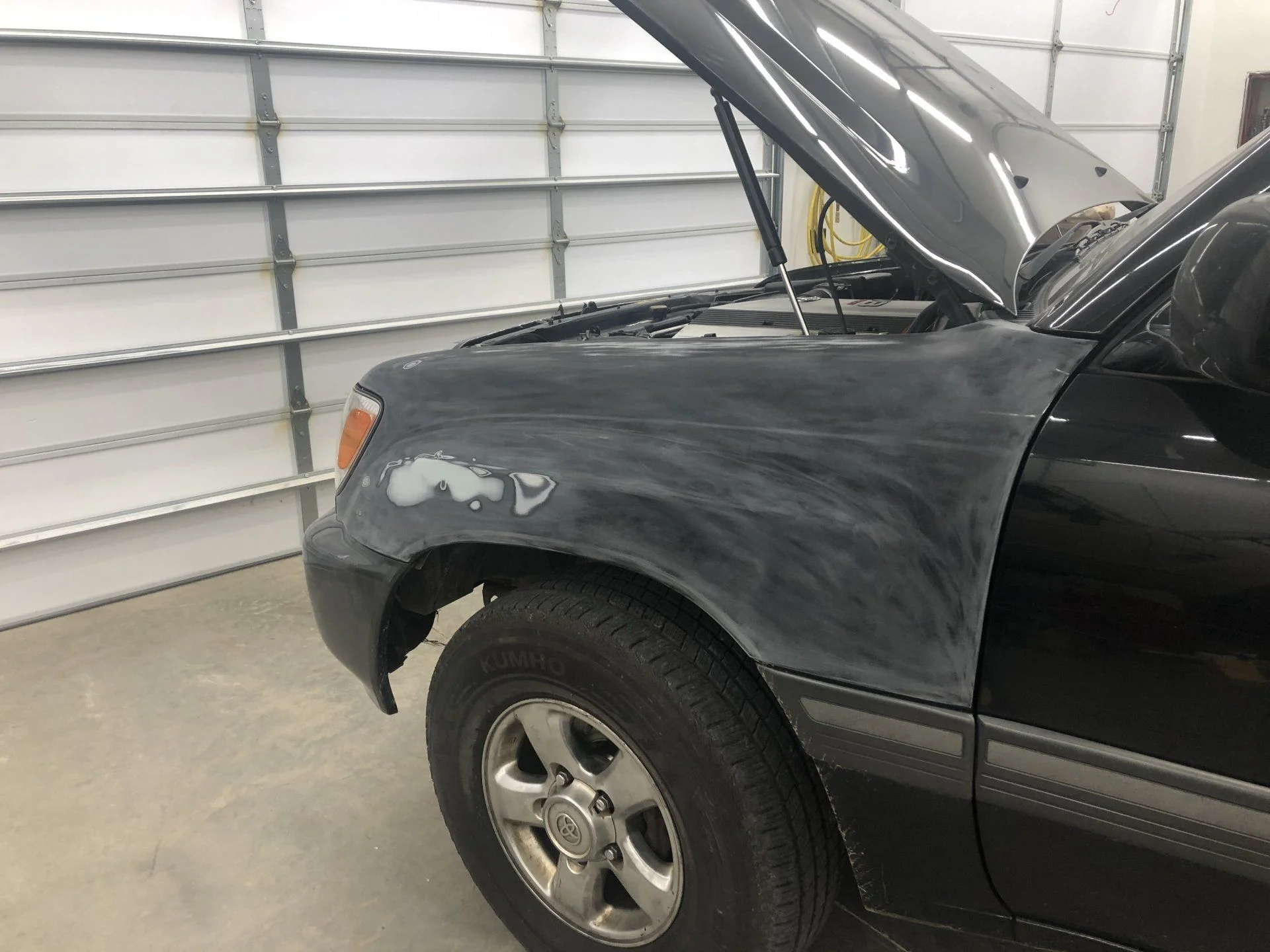

Removed running boards, roof rack, rear spoiler, and fender flares. I have had my hundy for about 4 months, and I have to say I should have done this the weekend I bought it. It looks so much better without all of that "stuff".
What did you use to cover the mounting holes?

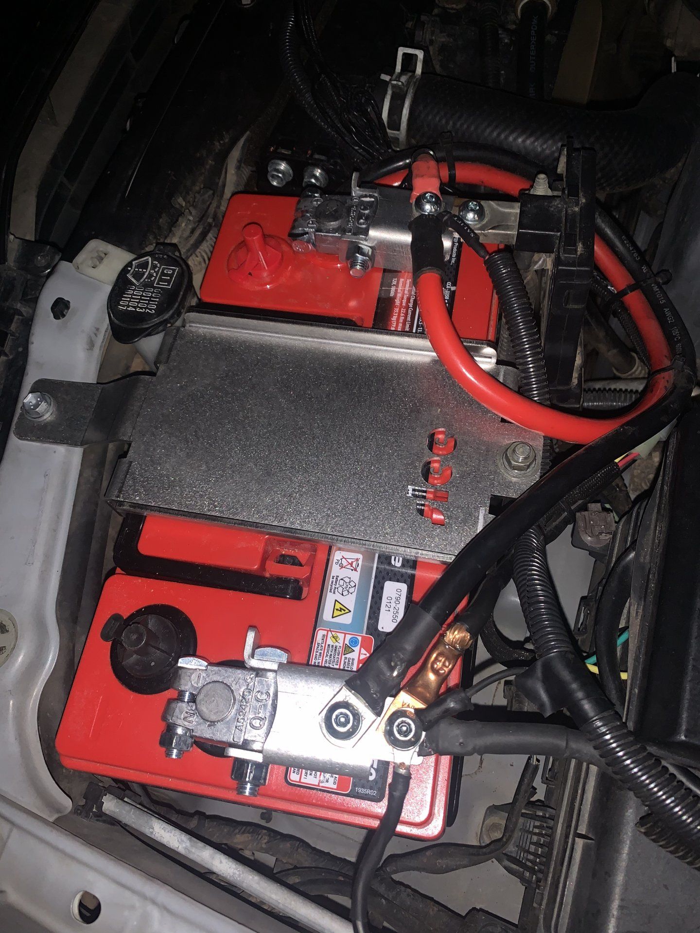

Added SLEE main battery upgrade, Alu-Cab tilt fridge slide, Odyssey 31m-pc2150 and installed fridge

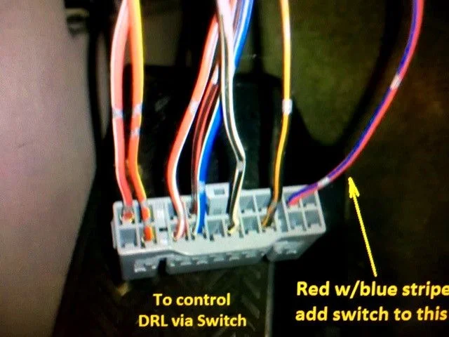

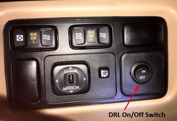

Finally got around to adding a switch to my DRL's (Daytime Running Lights). I made up an On/Off switch with pigtails, God only knows how long ago...and its been sitting on my computer desk just begging to be installed.
I finished up some chores around the Ranch a bit early...so figured I'd stuff myself up under the dash and do the surgery needed to splice in the switch wires.
I'm sure its no big deal for you younger/slimmer guys, but I'm 6'-5"...250 lbs and 66 years old. No problem finding the connector and appropriate wire to snip (Red w/Blue stripe). But getting the tiny wire stripped back, the butt connectors in place and crimped in such tight quarters wasn't much fun. I sure as Hell didn't want to withdraw myself until all was done, because getting back there would have been an ordeal.
So.... holding a flashlight in my teeth, reading glasses on, wires strippers in my right hand, crimpers laying on my chest....I went to work.
Finally got it done and the connector plugged back just as I started getting a cramp in my left leg. Kept my fingers crossed that all was right and tested the switch.
Eureka....! We now switchable DRL's. Not entirely sure it was worth it.....but I have it now.

Plan to poach deer at night?
No, got a freezer full from 'legally' hunting them. And I have deer in the pasture behind my house day and night anyway, thanks.
Yummmm.....
I just don't see the need to always be burning the high beams, regardless the situation. They are a safety feature 'supposedly' but I've observed over the years that folks have learned to ignore (not notice) them. They don't really seem to make your vehicle 'stand out' anymore as people have become accustomed to them. With the exception of it being 'dusk' and some fool not yet turning on their headlights, I'm not convinced they do much anymore. Anyway....I have the choice now of running them on or not.
