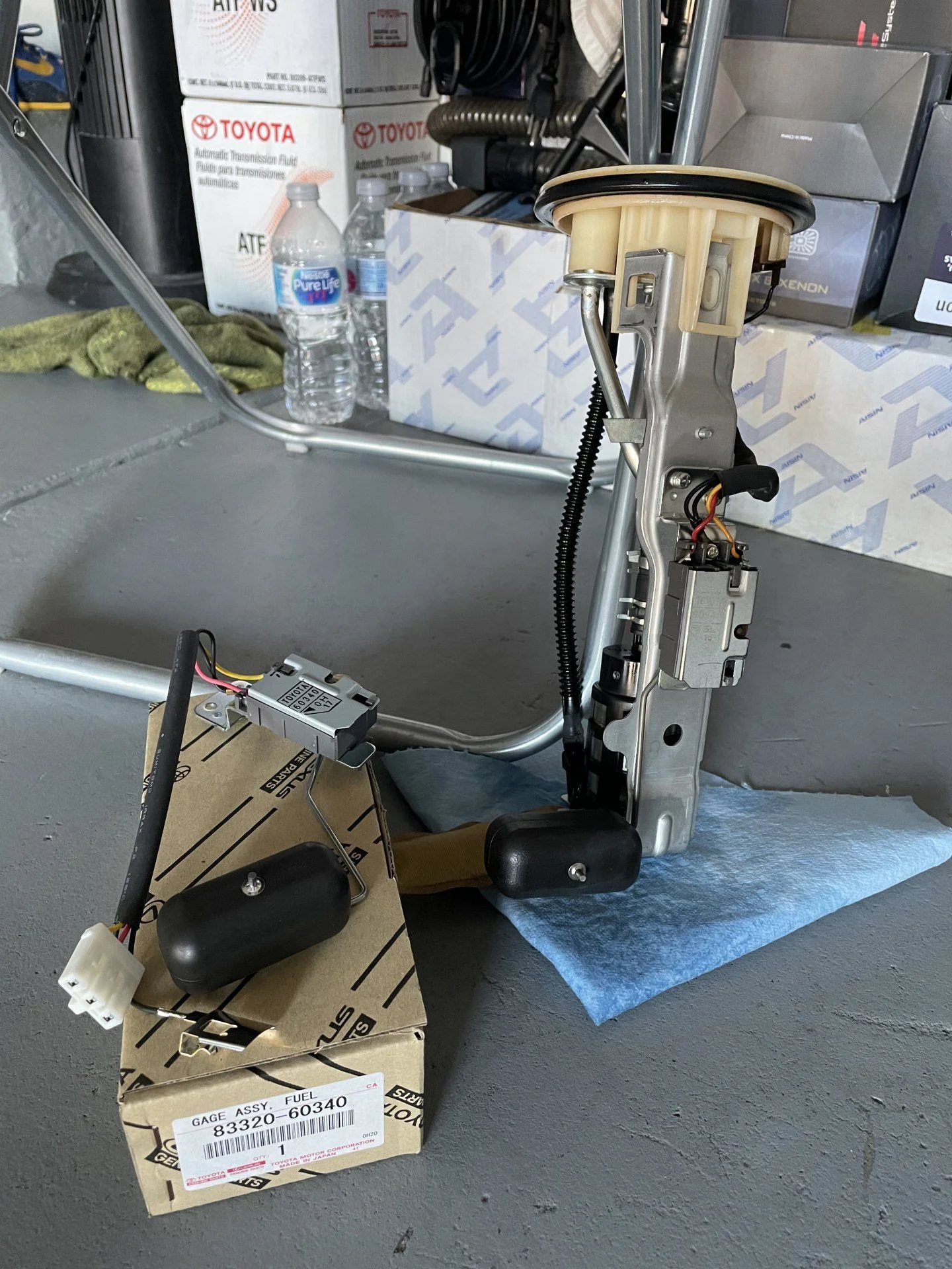

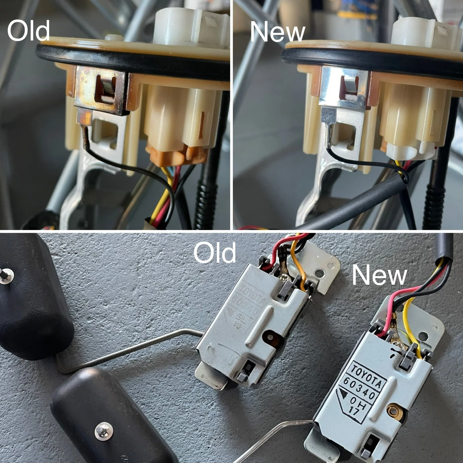

Back to today’s diy, the fuel sender I ordered last week came in, had fluctuating reading on the fuel level gauge even after a new alternator and 27f battery.
Replacement-install was straight forward, the heavy work was with taking out and installing the second row seats, would rate it a one :banana: job. So far fuel level seems to be accurate, and the one thing I noticed instantly is how the fuel needle jumps right up and how quick it goes up to the correct level/spot. One tell tale symptom I can share that the fuel sender is going bad, is how slow the needle settles to its correct level, it’s like watching it crawl.

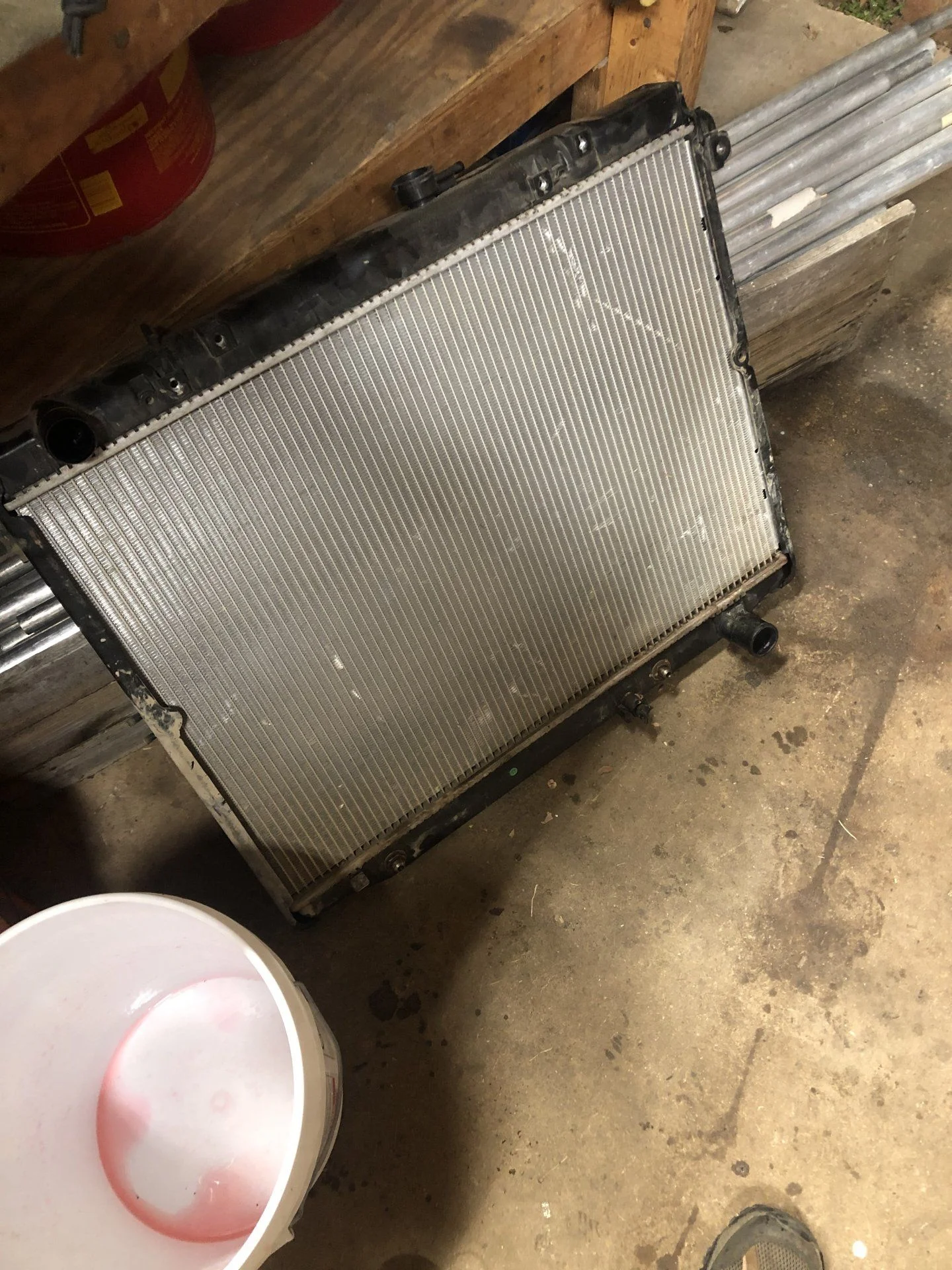

CSF Radiator. $157 with a lifetime warranty. Not too bad to change but still a couple hour ordeal.

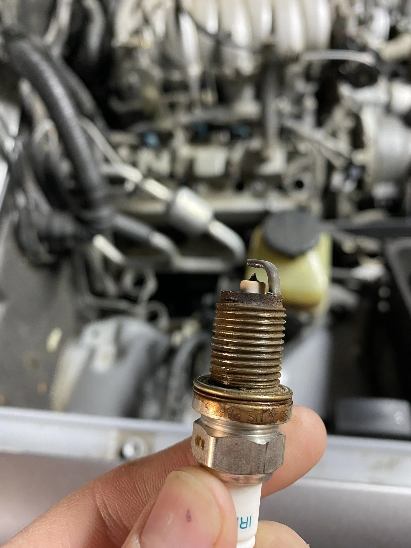

Tearing into this valve cover job more and replaced the spark plugs... boy were the old ones hard to get out! They all had rusty threads, I was worried about the head they were so hard to turn. Thankfully they all came out and fresh ones are in the engine. Not sure how old these are? :rolleyes: We have only had this cruiser a year.
