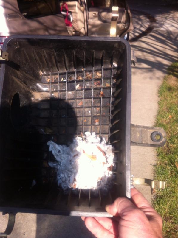

Changed oil and filter, cleaned TB and MAF, then cleaned out kibble that some feral vermin hauled into the air box, and changed the air filter.

Figured out why Bubbles stalled-out while merging onto I-80 the other day...

Figured out why Bubbles stalled-out while merging onto I-80 the other day... Sent from my iPad using IH8MUD
That's ugly. You ingest any rodents?

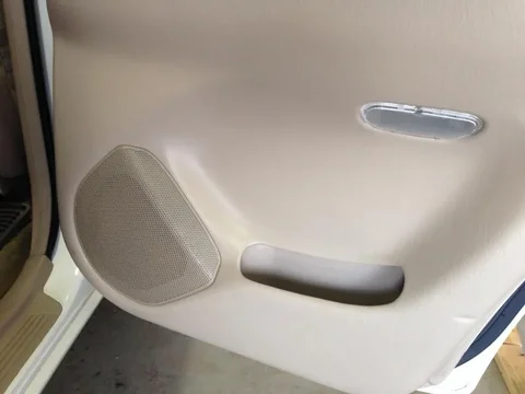

I found a sweet deal on amazon for 4 Alpine 610 speakers, one pair with separate tweeters and one pair with them integrated. My wife helped me install them and we decided to paint the speaker grills instead of recovering them. I think it worked out really well. First she lightly sanded (steel wool) the old glue residue off and then multiple light coats of Rustoleum Dark Taupe flat spray paint. It matches well and we expect it to hold up much better than the fabric. Our '03 Tacoma has the same look - sans fabric.

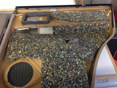

While doing the speakers, I noticed that the front door covers have some felt backing on them and that the rears did not, so I added some foam carpet underlayment to the rear doors to absorb some more sound. It fits well. I have also noticed that some LCs have a layer of foam over the vapor barrier on the front doors, while others do not (based on pix here on MUD).
