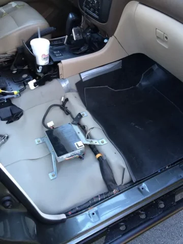

I'm using the sound deadener showdown products. CLD tiles placed strategically them closed cell foam then mass loaded vinyl. I had a few sheets of luxury liner pro left over from an old job that I used in the driver and pass foot wells.
Hoping for a really big improvement. $650 in materials and lots of work!
