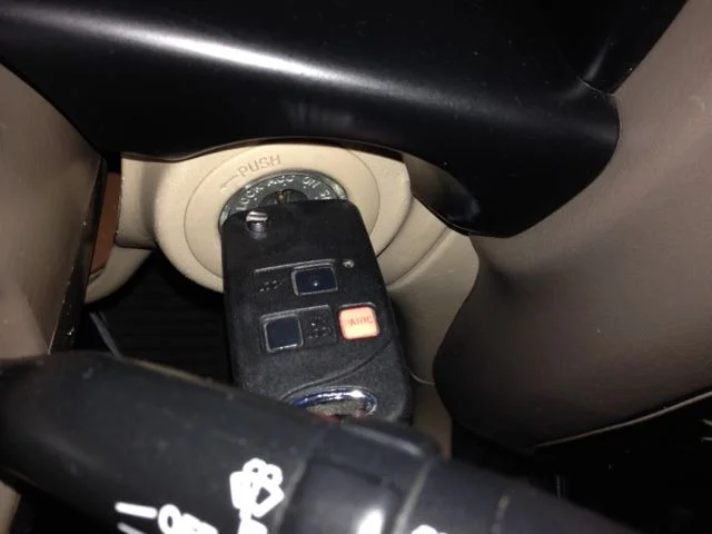

Here are some more pics of my flip key (and I'll link/repost to the flipping key thread ;-)
Not sure why mine works, but I am glad. Its a snug fit when the key is in the lock, perhaps either the key body is different and places the transponder closer to the antenna, or, when Ace cut the blank they cut it higher on the shaft? Here're the people I bought it from on ebay:

I have an idea why my flip key won't work in my rig.
I WILL HAVE TO DO SOME TRIAL AND ERROR TO CONFIRM MY THEORY.

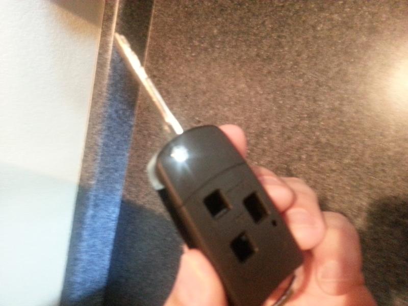

This a pic of LostAfrican's key.
This the same key I have that WILL NOT WORK in my rig. Due to the immobilizer. Anyone see what is different between the two and maybe why the immobilizer won't pick up the chip in the key?
I am going to assume that the bottom one the key FOB is installed sideways compare to Lostafrican's key which you install the old remote facing into the key tumbler.
On the bottom remote the panic button would be on the bottom left hole. Notice the small hole for the remote's red indicator light, compared to the top pic where the panic button is on the right side. And the hole for red light is closer to the tumbler. I am going to bet you that is the side of the remote where the chip is located inside. So when it it is on that side making it closer to the receiver when the key is in the tumbler.
I have the same one as the bottom pic, so my rig cannot pick up the chip because its on the other die of the flip key.
Singha-
The transponder is on the right side of the key (tip facing ignition). It the remote is turned 90* clock wise the transponder may be to far from the ignition. Try folding the key when it's in the ignition and see it that turns off the security light.

singha, I have the flip key with the buttons rotated 90*. Works just fine on my '98 and the imobilizer chip is right near the key part so it's really close to the receiver behind the dash, just like a stock key. Are you sure you're mounting it in the right place? I posted links in another thread that links to the Amazon page where I bought it. Another owner uploaded pics of just how to mount the chip.
I don't doubt he's having problems. I also bought the Amazon key you linked and it didn't work in my '04. There's only one way to mount the internals. I have the eBay key en route, will post up if it solves the problem. There may be hardware differences in the immobilizer between years that would change sensitivity.
Wait, does your '98 have a separate immobilizer chip, the little bean-shaped one, or all in the three-button piece?

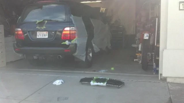

Alex,
Did you use plastidip on the trim as well as the emblems? If so, did you have to do any prep beforehand? Looks good.
Happy Thanksgiving all!
I used plasti dip on the emblems only.
As far as the trim goes, I did the following:
1. Taped and placed plastic sheeting to prevent overspray
1. Used 2 scotch brite pads to rough up the paint (very fine, then ultra fine)
2. Used tack cloth to clean off the dust
3. Base coat of primer
4. 5 coats of Toyota 8L4 (Atlantis Blue
5. 2 coats of clear coat to finish it off
Couldn't be happier with the way it looks. It sure helps to have a friend who works in the automotive aftermarket department for 3M :)
