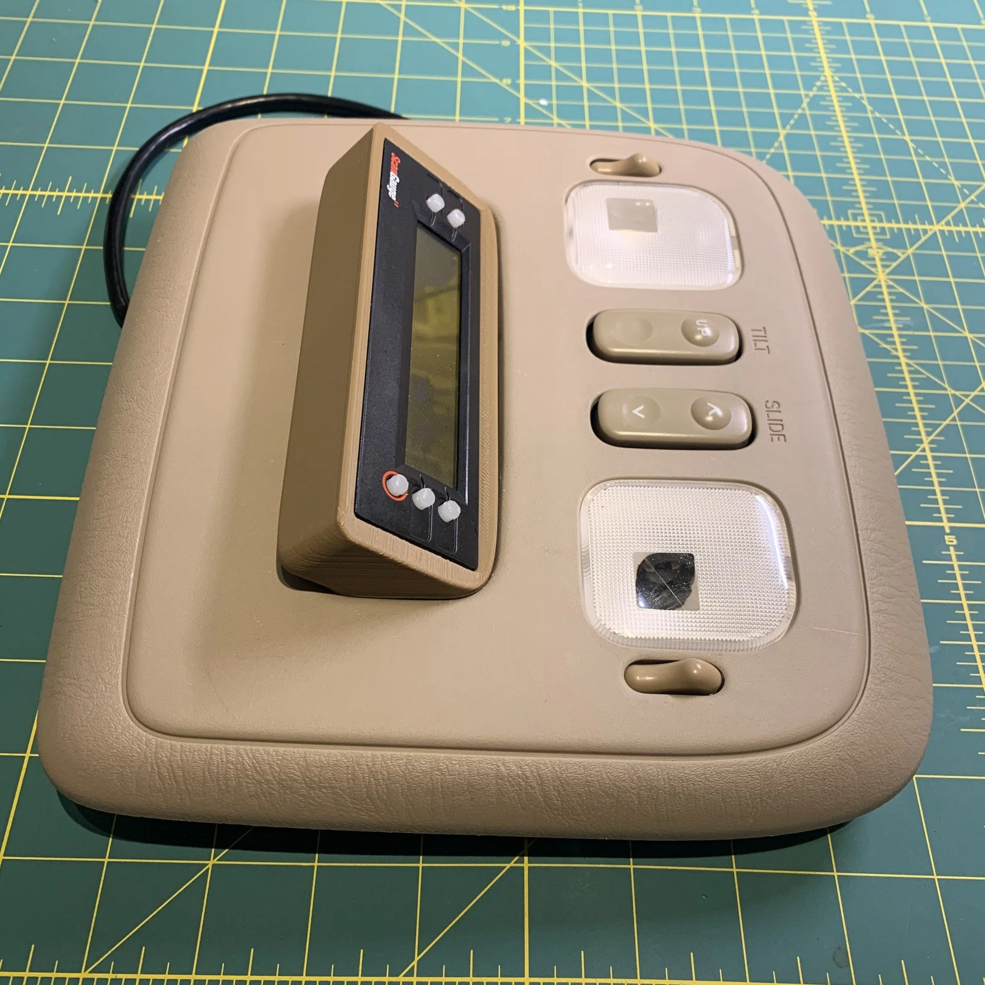

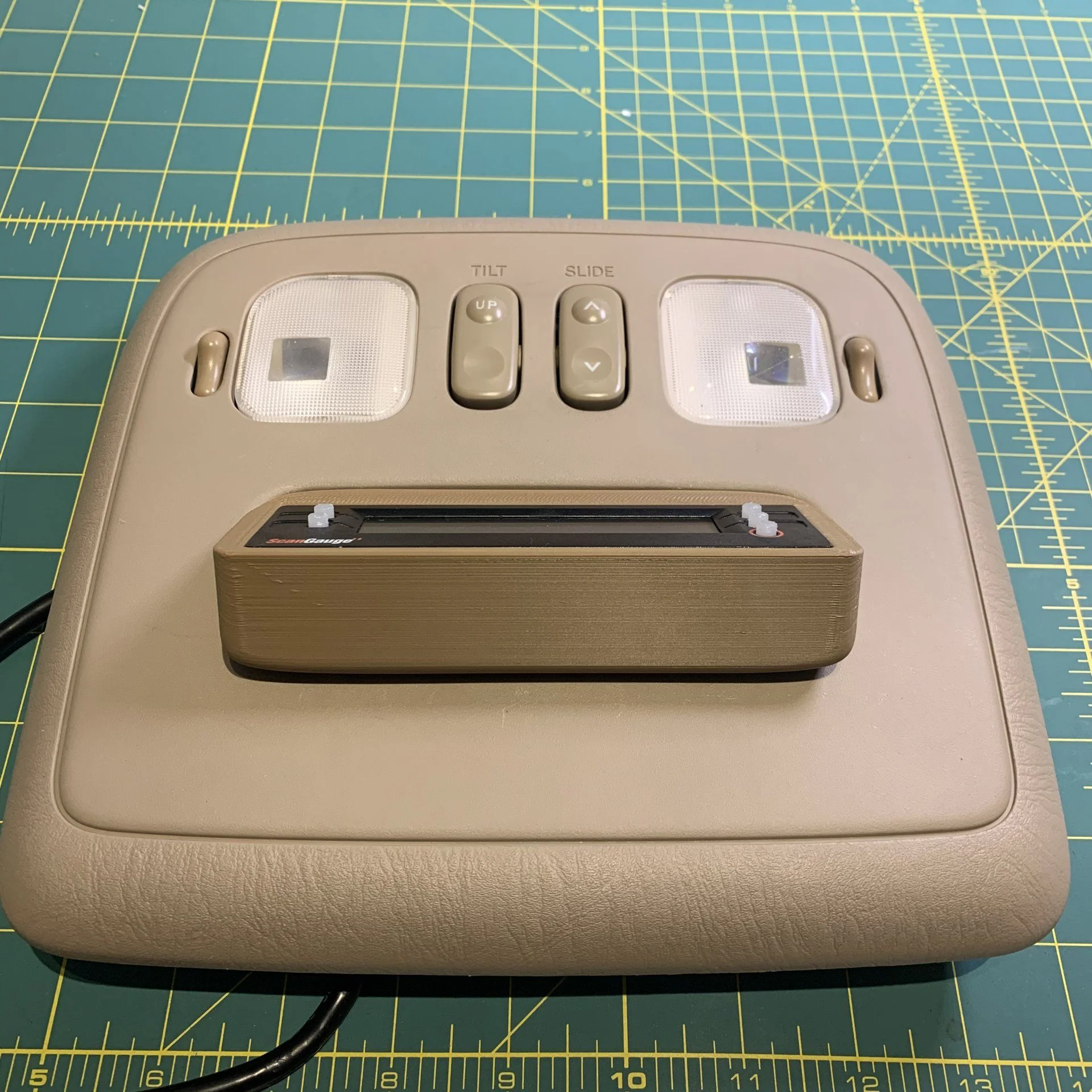

Made this Scangauge II mount for overhead console with mini-Link.
Click here if interested.

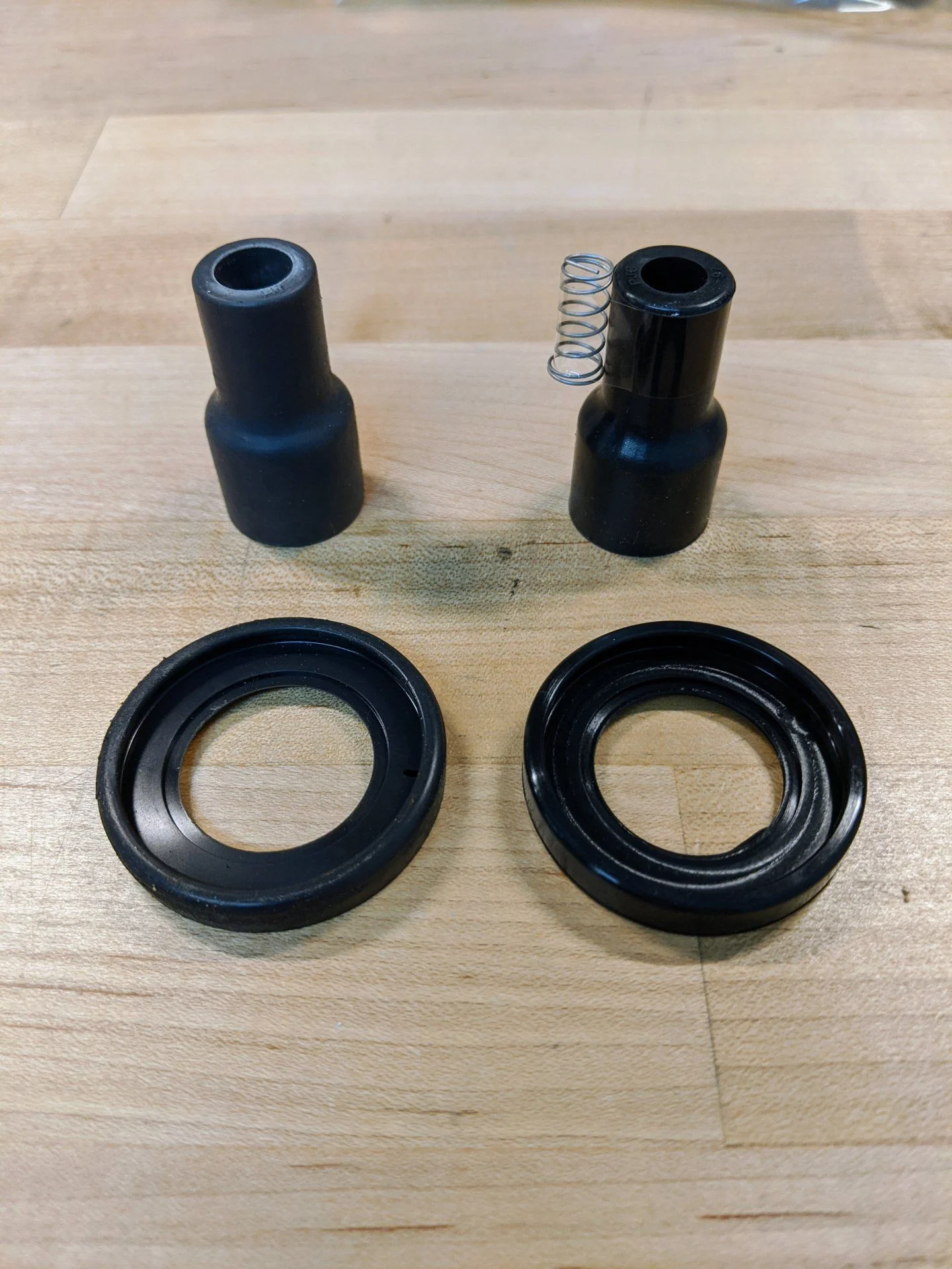

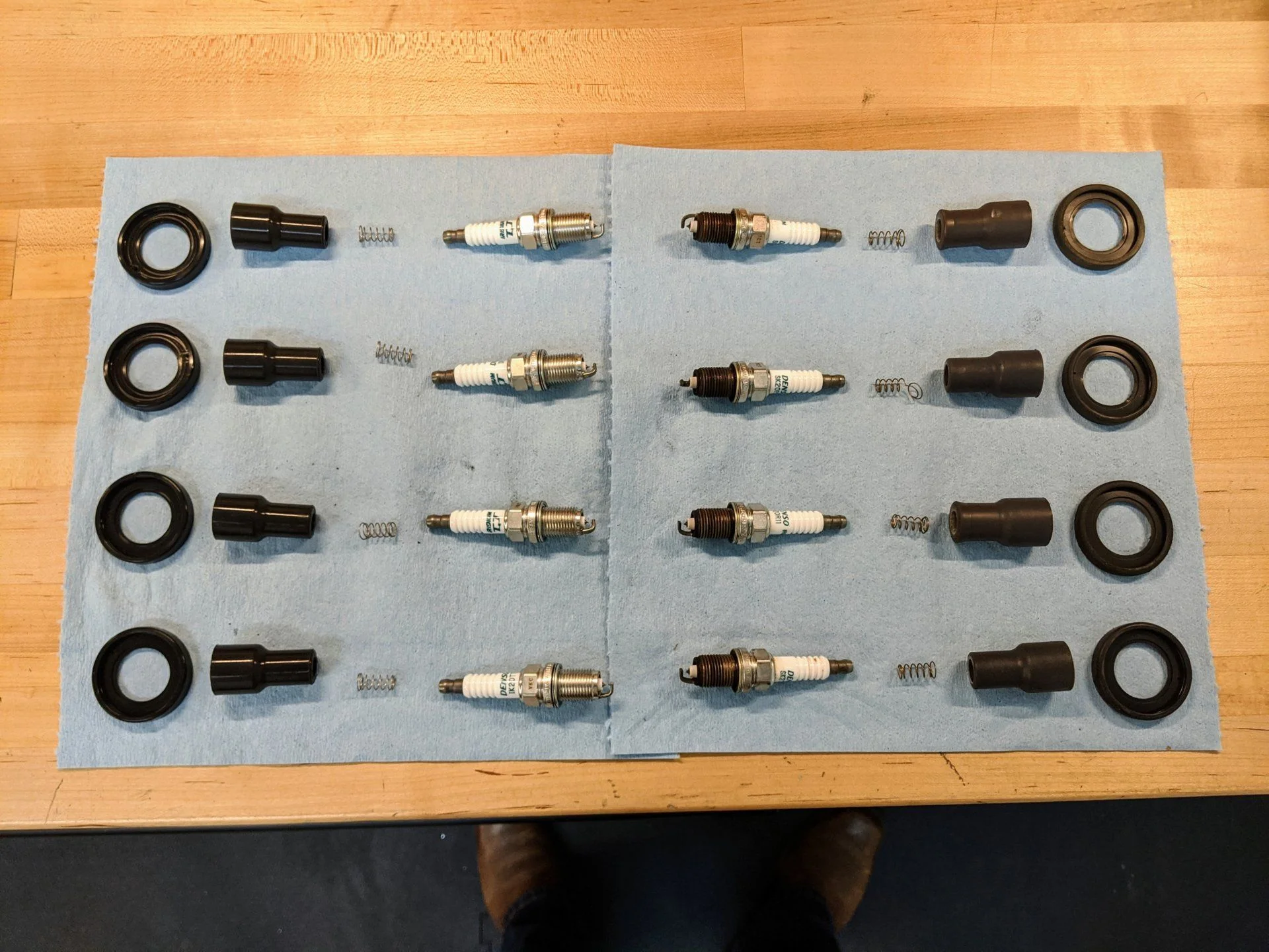

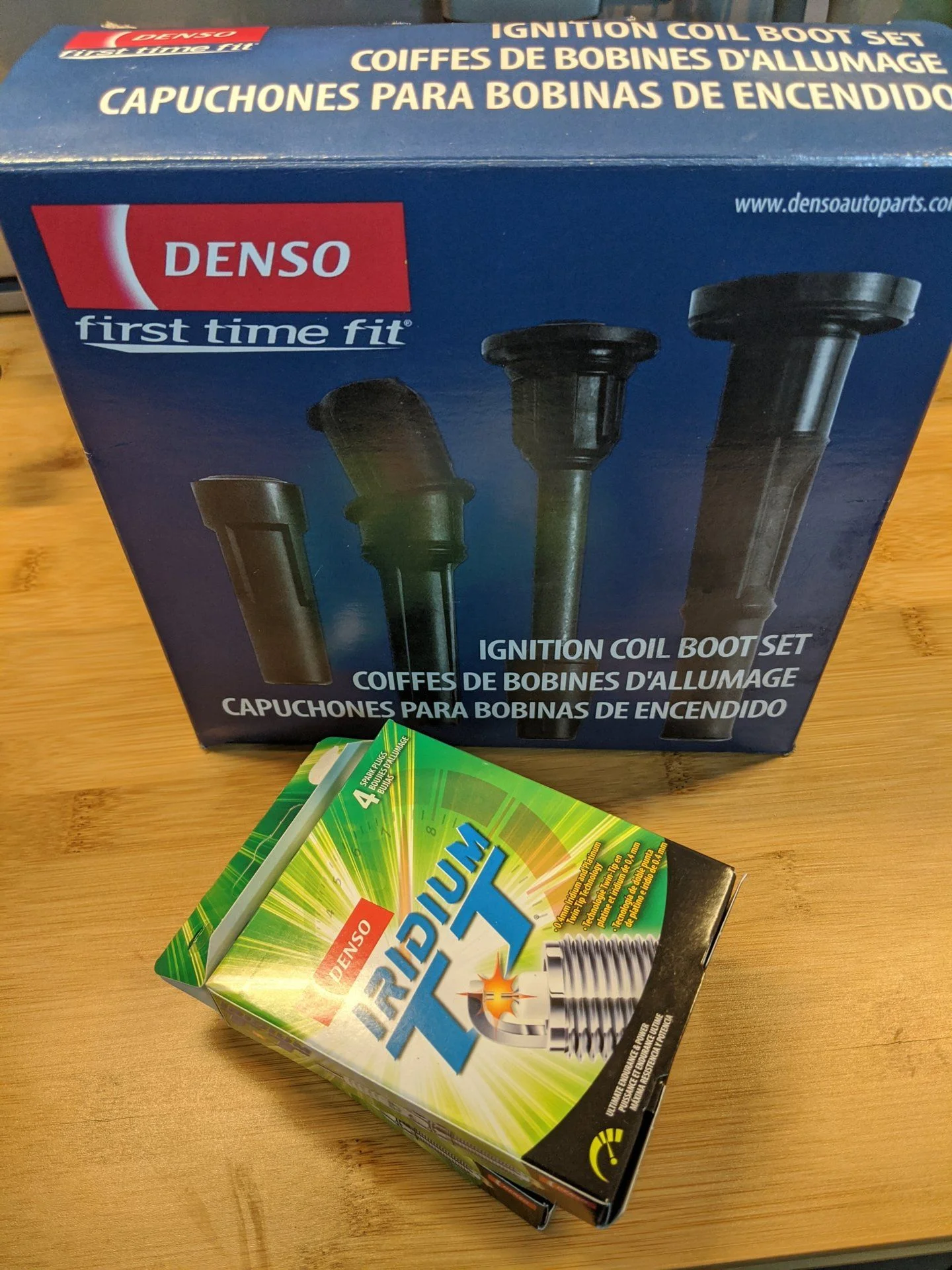

Installed new spark plugs and ignition coil boots. The old plugs were Denso Iridium Long Life and were at roughly 80,000 miles. Coil boot ages unknown.
I went with the Denso Iridium TT after reading some recommendations.

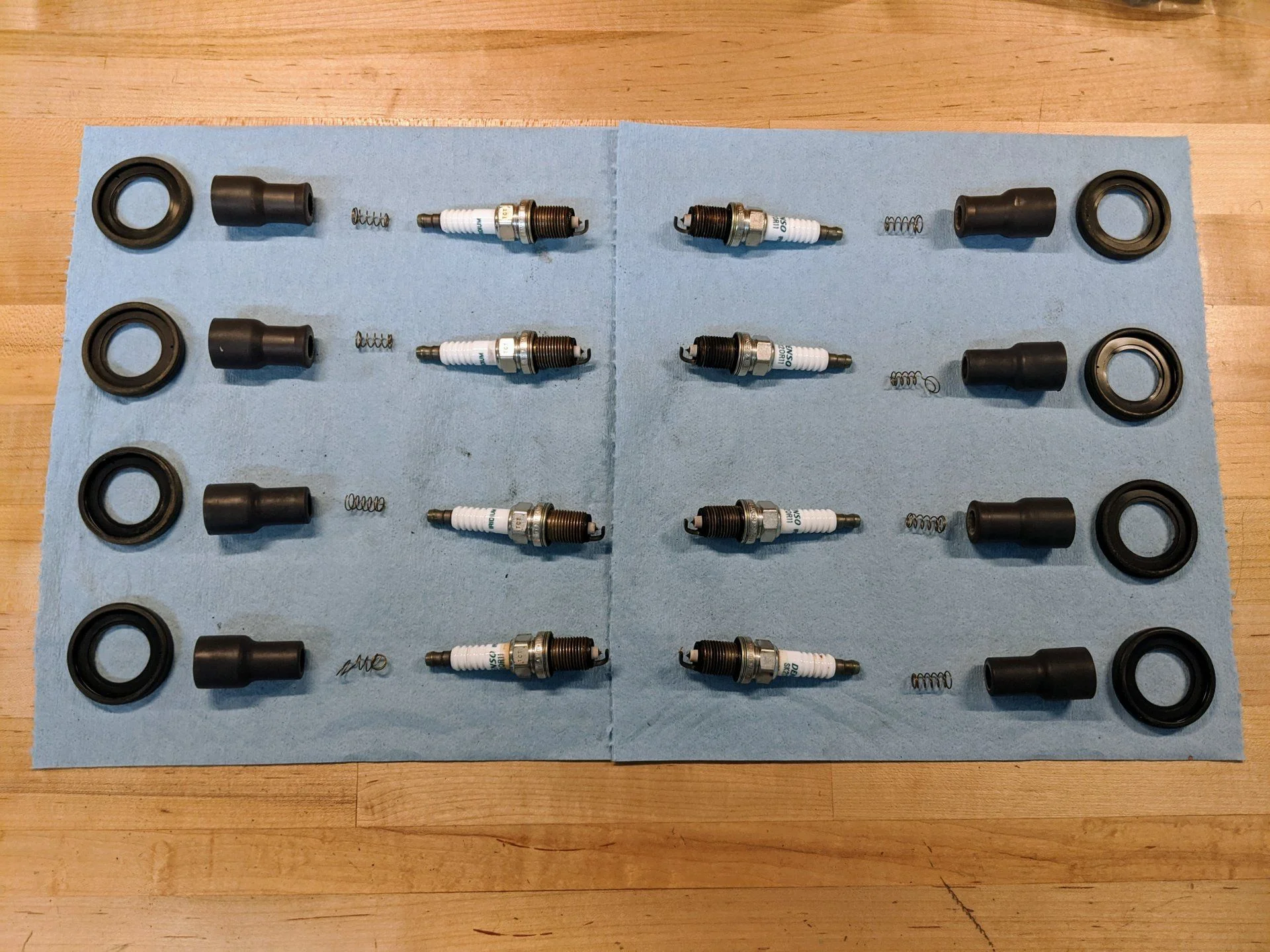

New spark plugs and coils on left, old ones on right.
Old ignition coil boot on left, new one on right.
All old spark plugs and ignition coil boots.

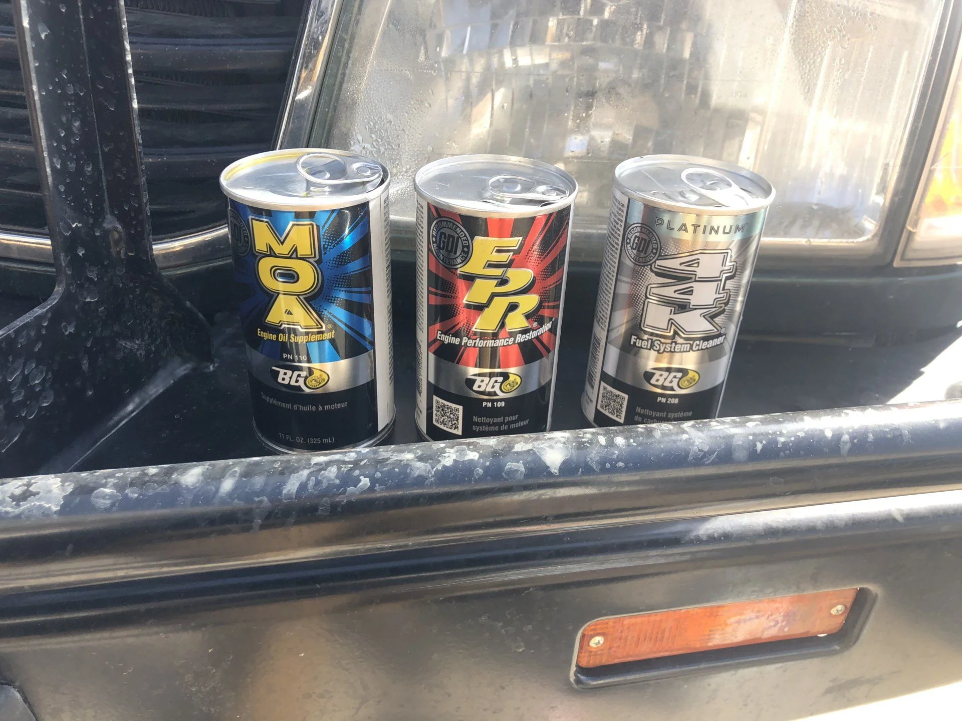

Trying these products from BG:
While looking at induction cleanings and all that stuff I read about of a lot of people using BG44K instead of Seafoam. On top of that I've been reading lots of threads on bobistheoilguy about their EPR and figured I'd give it a shot. So first, I drove around the block for a bit and pumped out some the old oil (4,800 miles on it @ the time) just before Thanksgiving and sent it off to Blackstone Labs to be tested, kinda just curious what is says about a 1/2 million mile engine. Then this weekend I did the Engine Performance Restoration from BG, got the car warm, then added a can of EPR (gonna do two next time) to the old oil, revved to 1200-1300 rpms for 15 minutes. Then did:
Oil Change (Mobil-1 5W-30 Full Synthetic High Mileage + BG MOA)
BG44K in half a gas tank
Drain & Fill 4qts Toyota ATF WS
Am going to do another sample test to Blackstone at the end of this oil change interval (gonna do a shorter 5K) and just record gas mileage. I figure that's really the only to tell any significant effects. Worst scenario I think I blew like $60 for nothing. It certainly feels good and idles good, better than when I got the truck, but I've also done a lot and replaced a lot since then. Typically I average 13mpg so I'll see if that goes up.
