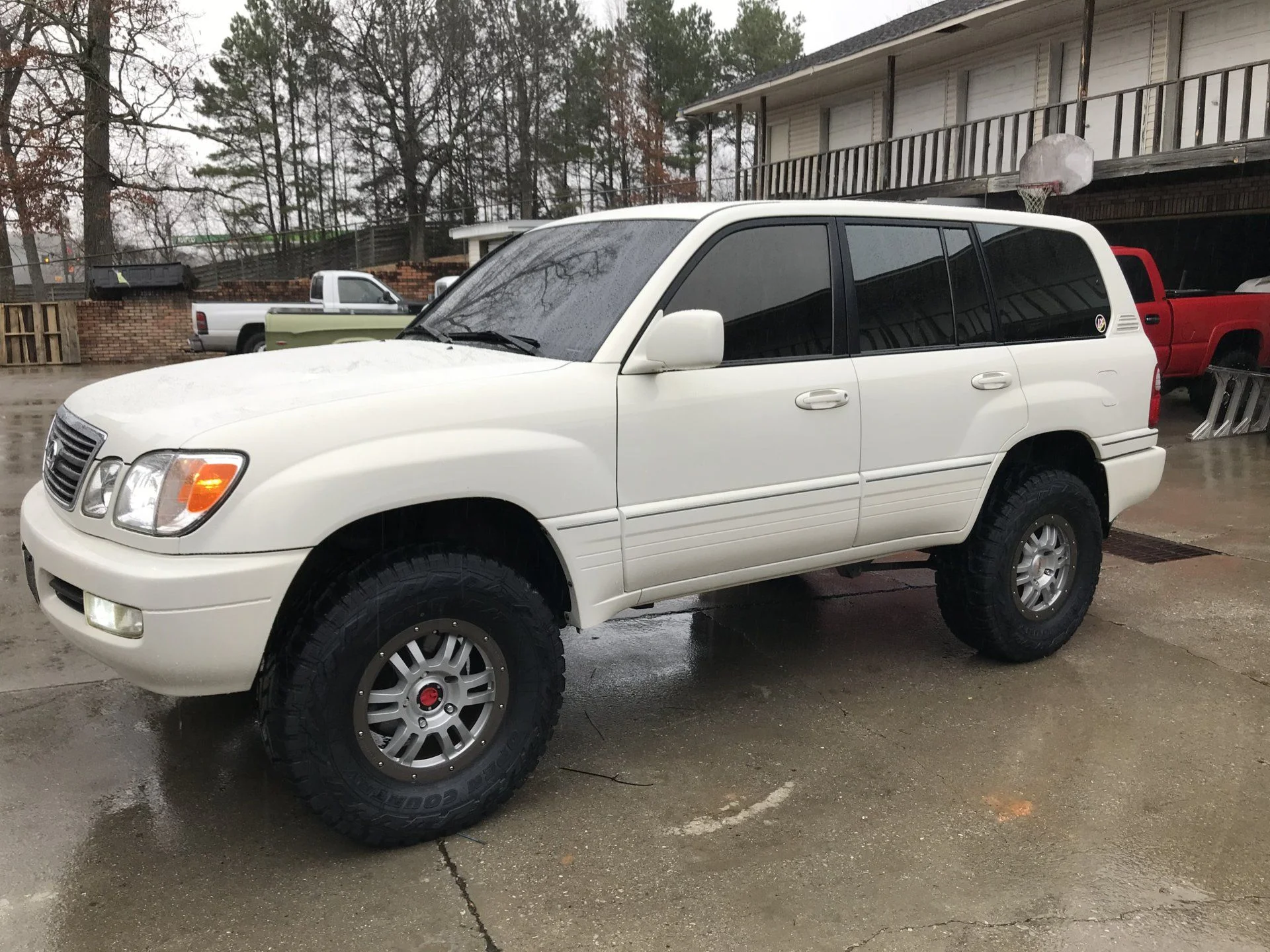

@[B]tellurado[/B] Did you have any issues wit the wheels clearing the hub?
Thanks guys, super happy with the set up so far.
@MongooseGA Yeah, Galactic Grey. only had to trim the bottom corners of the pinch weld. Gonna melt the plastic back to clear all the way.
@OEMGUY0720 FIfteen52 Turbo Mac HD 5x150 4.75 backspacing. They stick out a little more than I hoped but I'm looking at trying to fit the Husky long John fenders on to cut down on the rock chucking.
@implayaz9 No fitment issues at all. The front hub caps don't fit but that seems to be all the case with a lot of 100 series aftermarkets. I dont mind the look. The holes for the lug nuts are tight and a thin wall socket is needed.

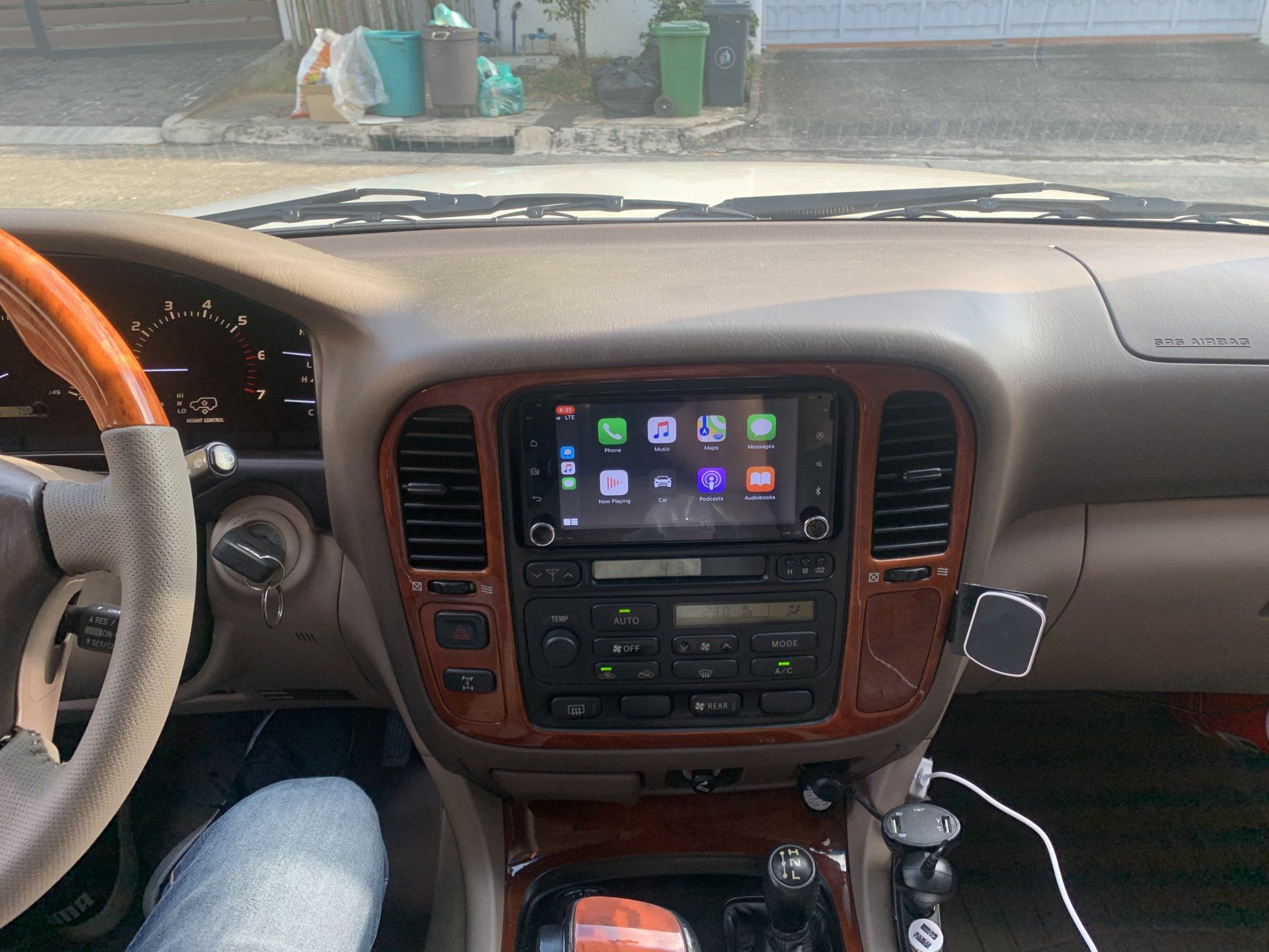

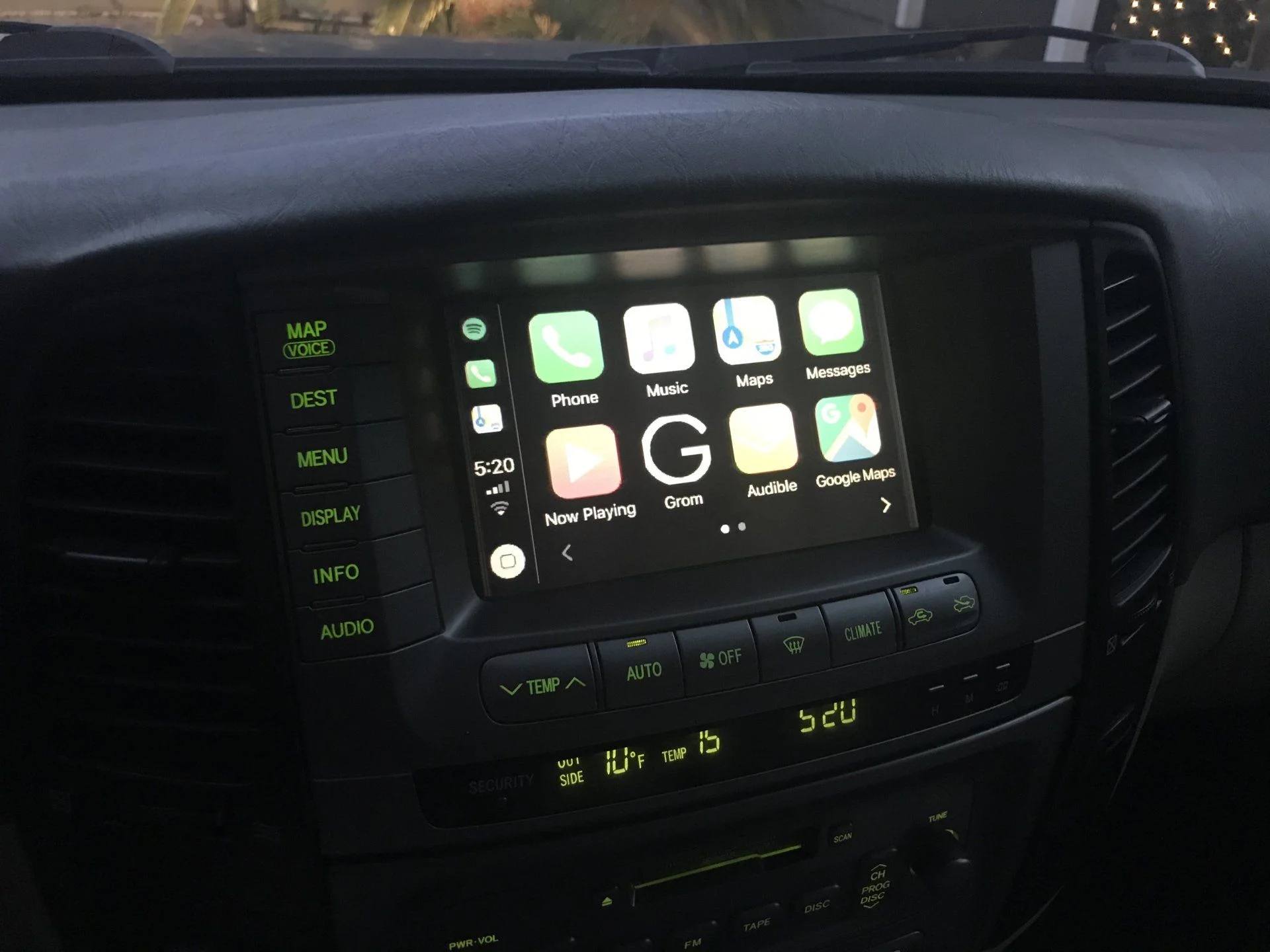

I have an 04 as well, I have been looking for a way to update mine. Does this fit exactly into the space of the old one? I assume the buttons on the side don't work.
Not OP, but it isn't a screen replacement. It's a computer that works in place of your disc changer. So all the side buttons, regular nav, aircon, trip settings, etc. work as factory.
Absolutely massive amount of info here: GROM VLine - Google apps/Android&iPhone integration
You can probably skip halfway through—the early units were kind of buggy/junky, but the bugs seem to have been worked out by VL2.
I have the VL2 as well, and it's outstanding. Not perfect by any stretch, but really good.
Gotcha, I need this but was ideally looking for a screen upgrade as well. I feel the backup cam in worthless with the screen glare and resolution compared to current tech. Would love to add a front cam if at all possible. Thanks for the info. Will read up as this solves one problem.

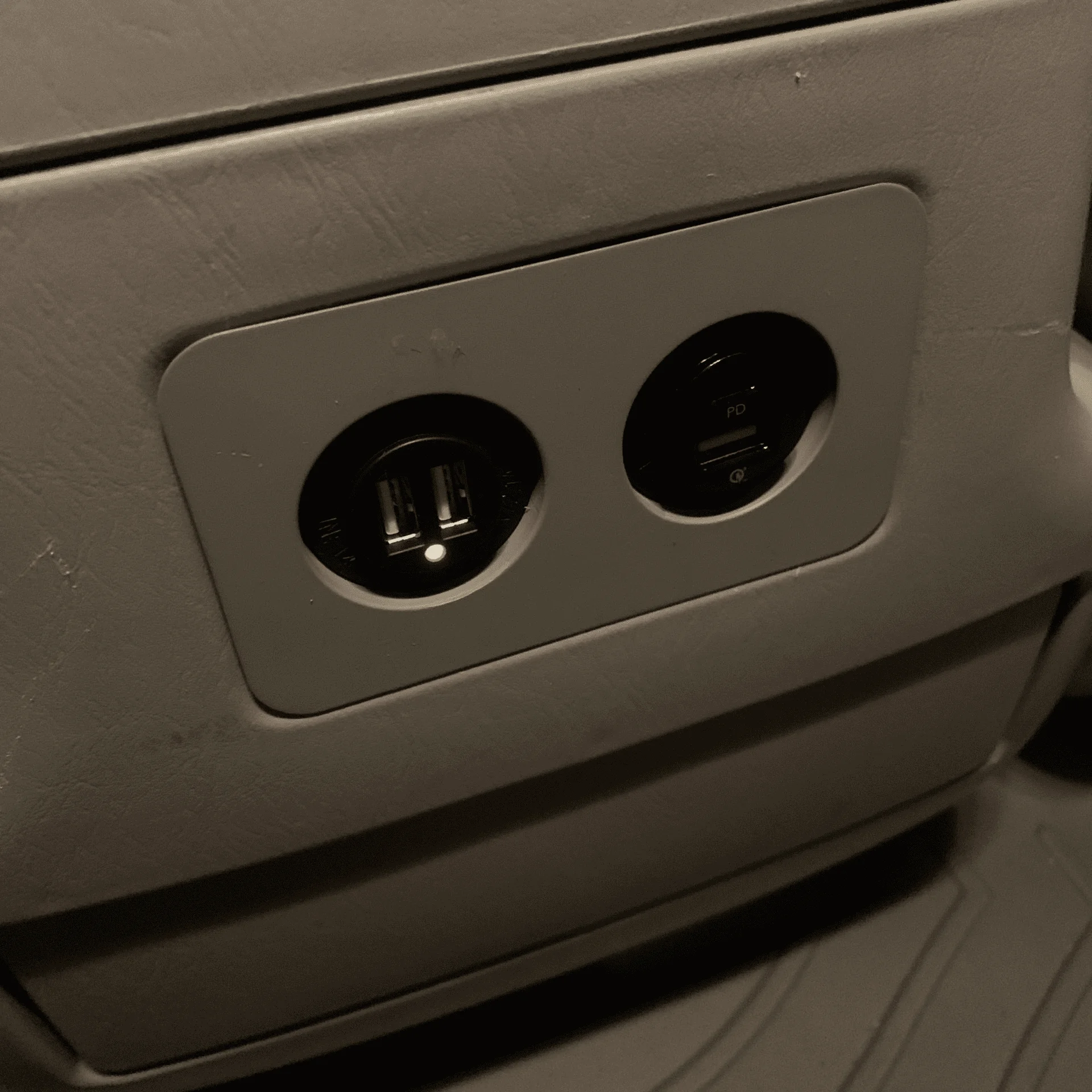

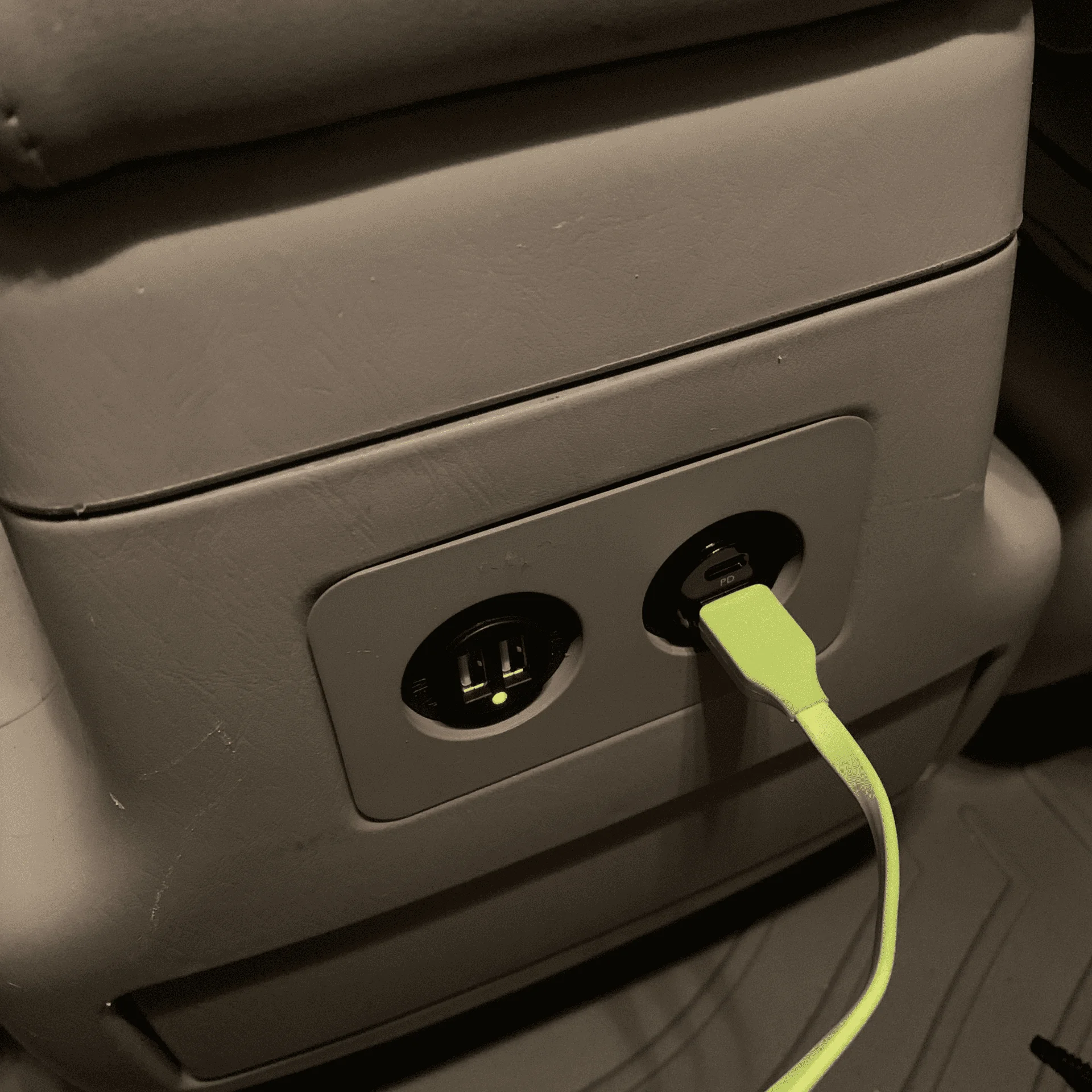

Wired up the rear 12V outlets! Just tapped into the 12V outlet in the center storage box.
Getting modern screen tech in there is hella expensive. Someone may be able to quote the thread, but you'll need parts from outside the US to convert yours to the manual climate controls and make space for that screen.
Or you can go with that big Chinese Tesla-like unit. That's probably cheaper, and some here have done it with success.
Sorta related—the VLine has two RCA inputs. I've got mine set to front and rear cams.
that's smart.
noted for future project. where did you get the trim piece?

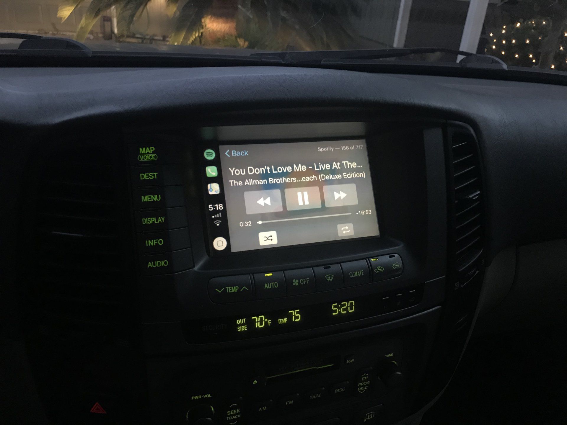

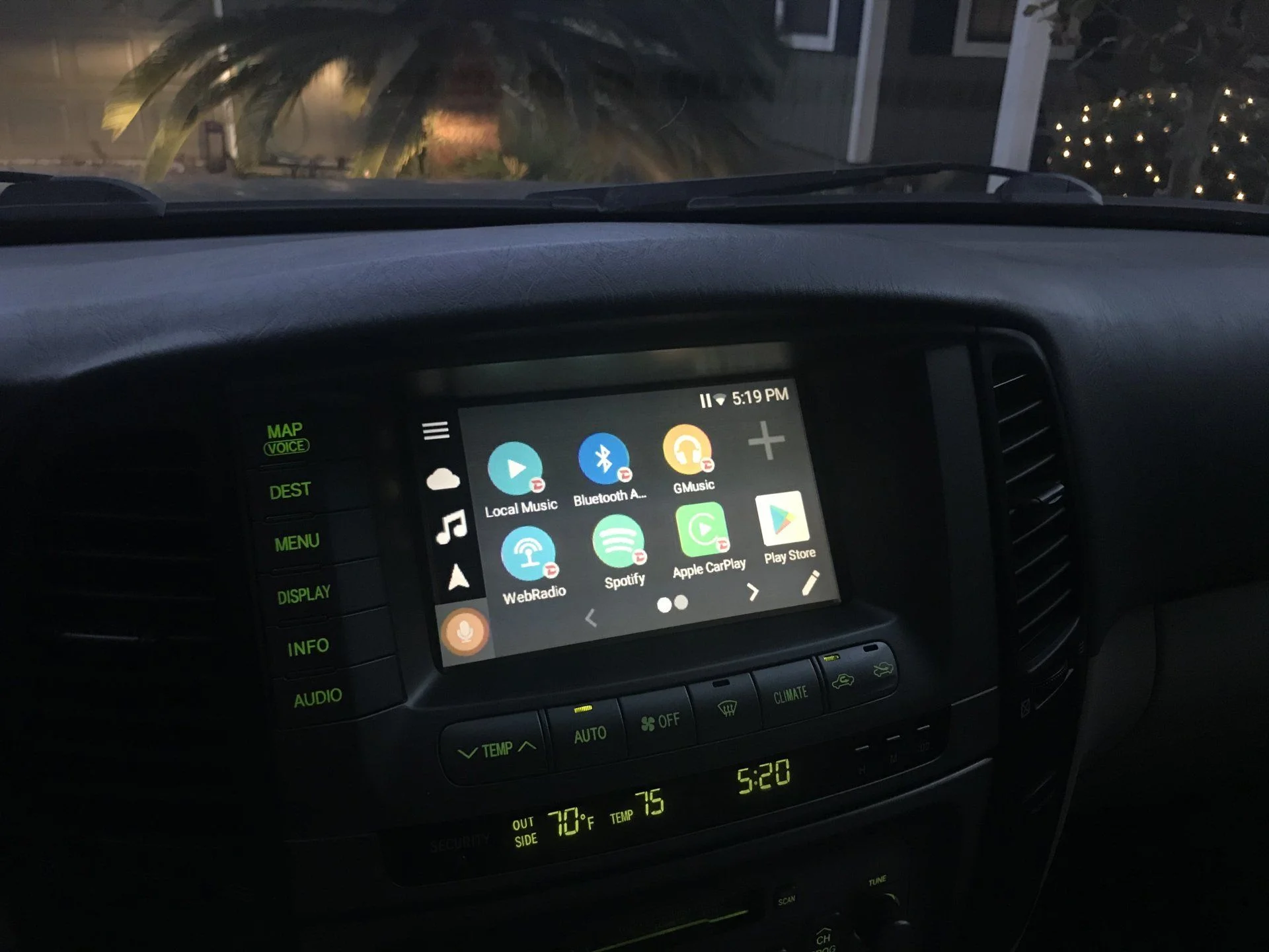

Installed this “Carlinkit” dongle on my Android head unit. It adds Carplay and wow, it works great! Best $30 I’ve spent in a while. I don’t think I’ll be using the Android portion of the radio anymore.
What did you transition to?
