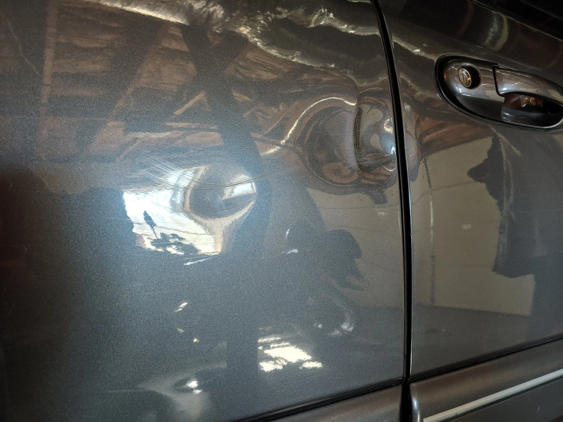

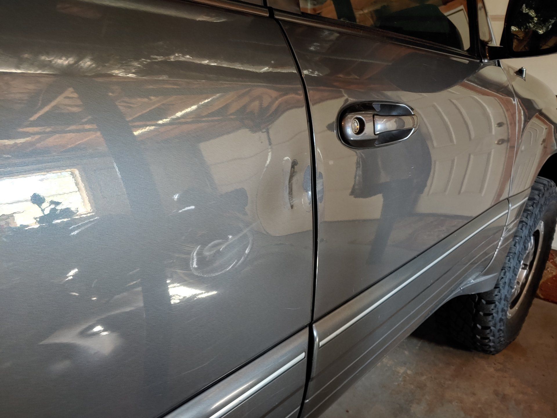

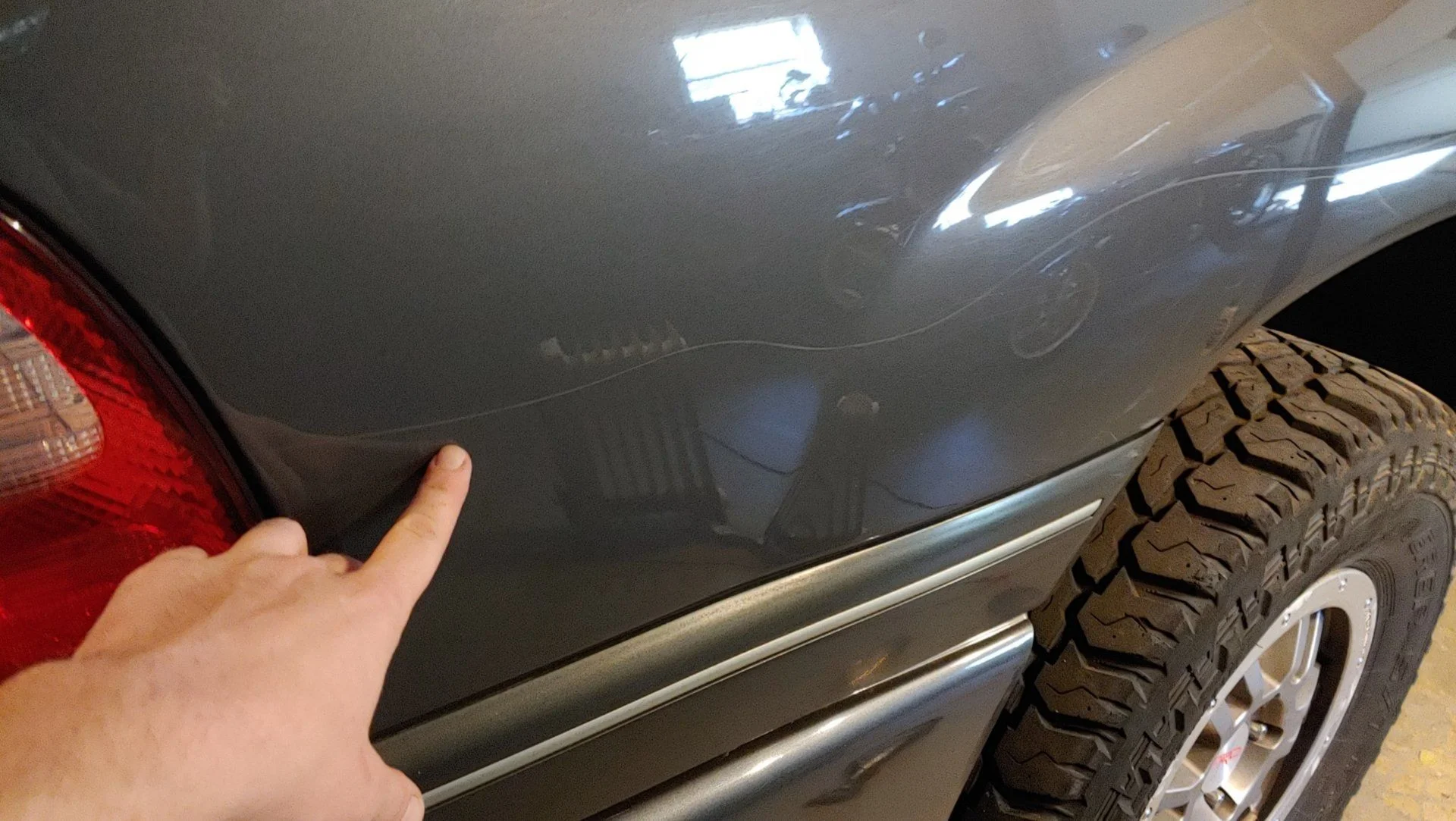

After working the door , I got a little more carried away with the wet sanding and the deep scratch removal. Here's another one I cleaned up. About 95% gone, I'll get it about 99% of the way when I finish my big detail. I did another on the front fender. Some of these scratches ended up into the primer, so I'm sitting on a Dr Colorchip system to do all of that at once.
Gotta keep in mind, it's a trail truck. These scratches were put there by nature, while I was in the process of conquering the crap out of it.

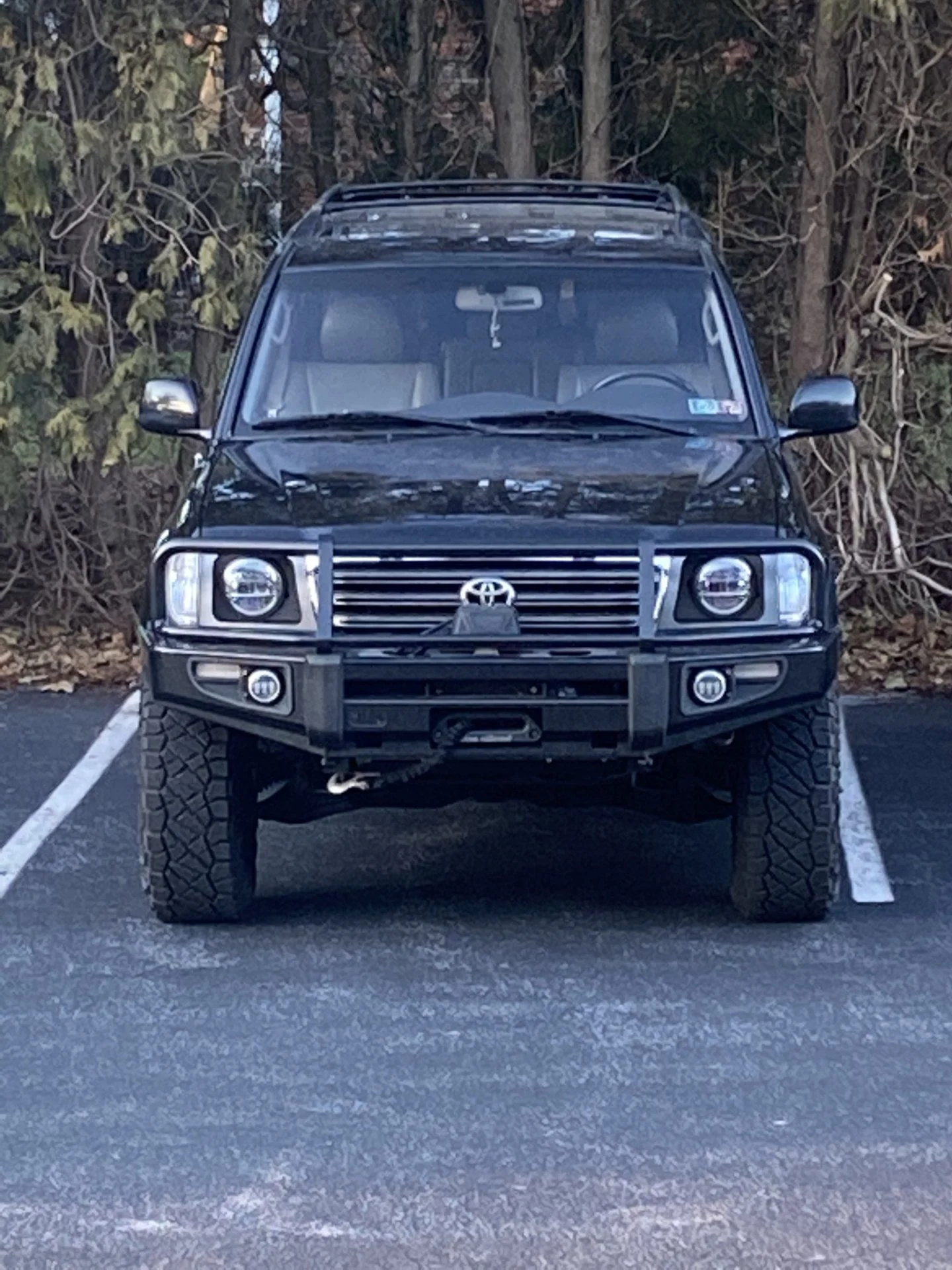

What fog lights are those fog lights?

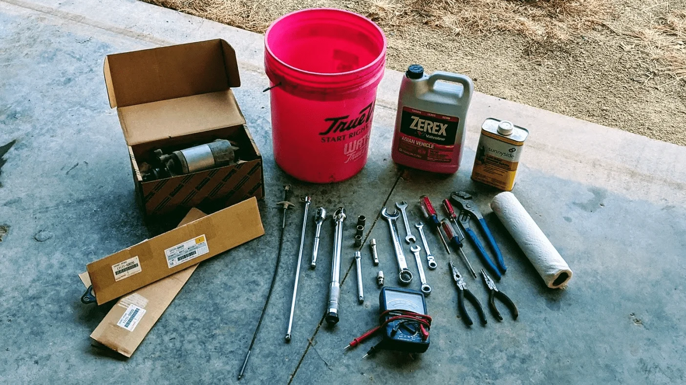

Tools I used are below. I would now be comfortable tackling this job in a parking lot (as if I was on a trip).

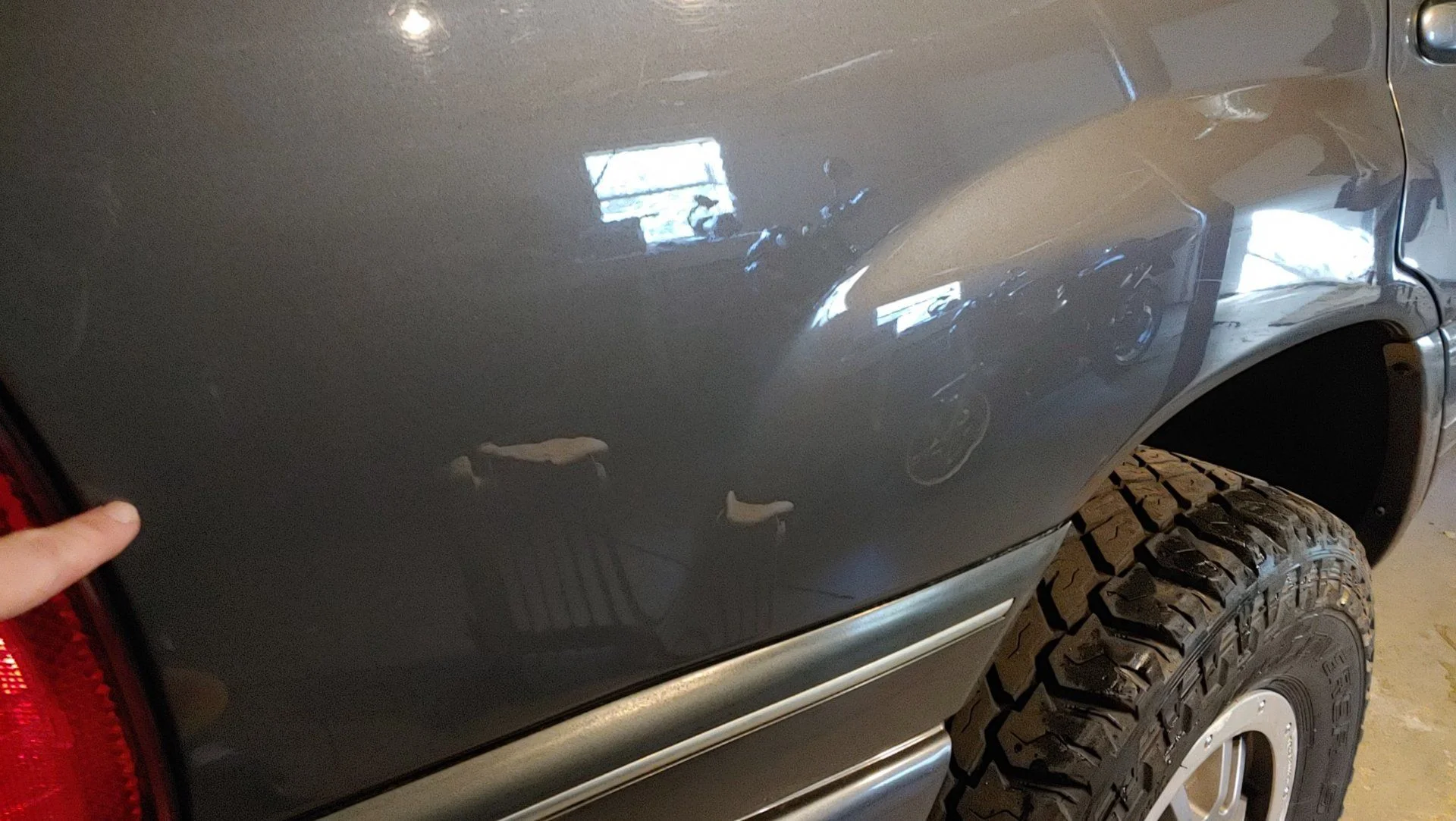

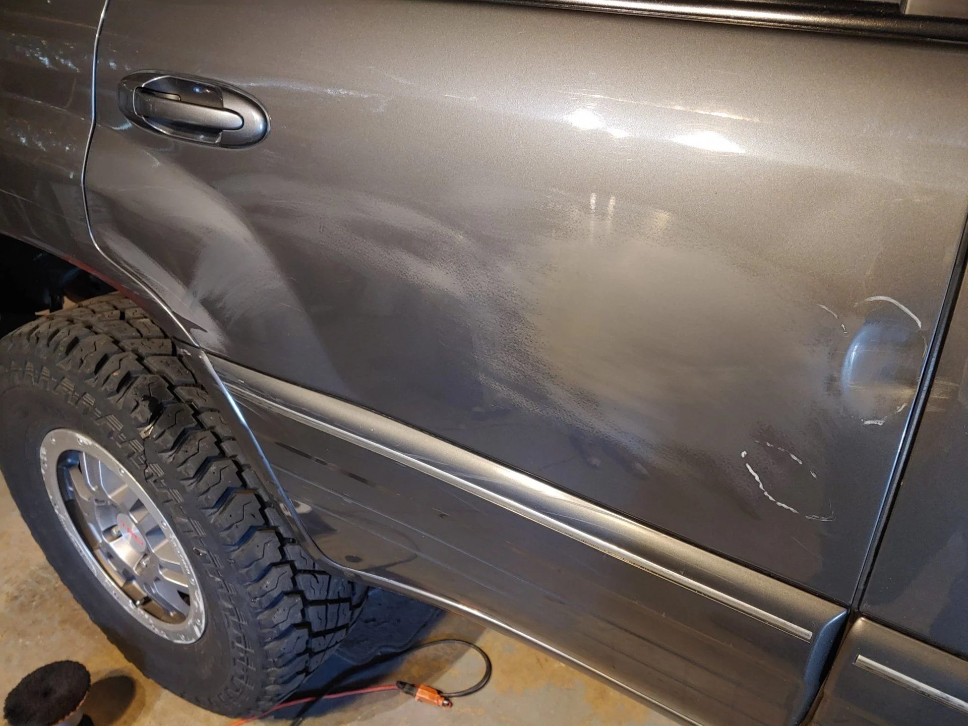

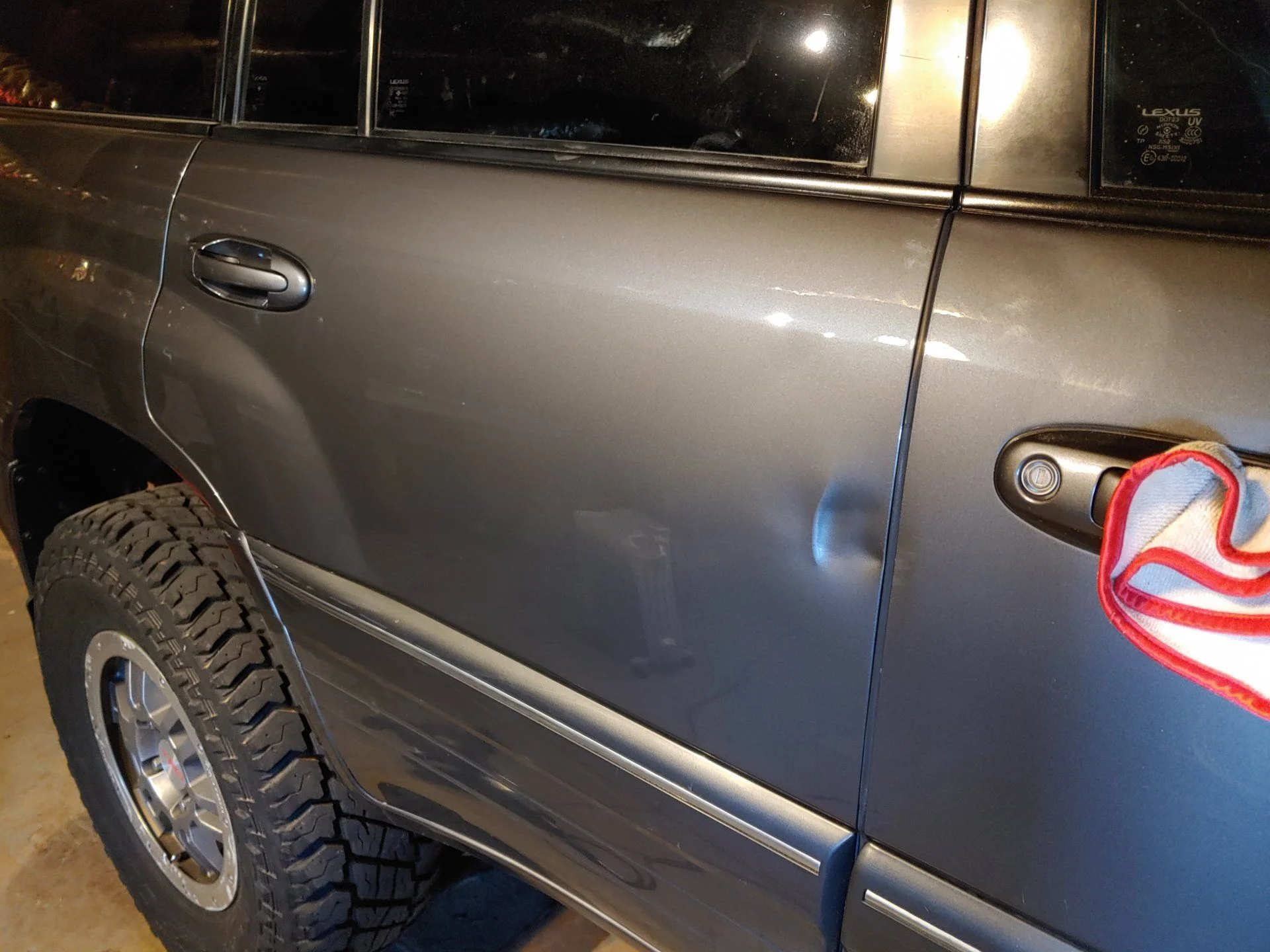

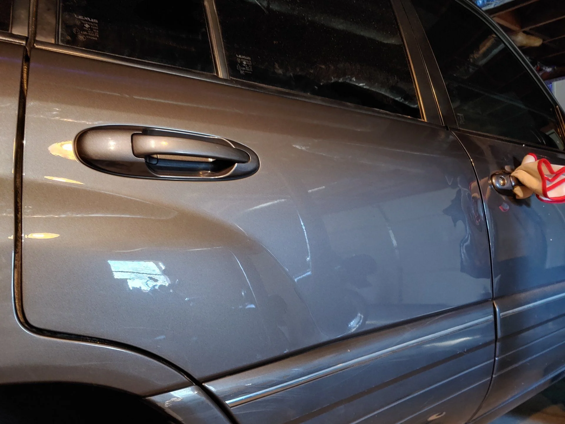

I also tried my luck at a little PDR and some testing of my new MF cutting pads and 3D One polish.
The dents were pretty bad, pretty deep. I'd been told by 3-4 PDR pros that it was just too much for them to try out, so I figured I'd give it a shot for the $60 the tool kit cost me. I was just looking for 'better', definitely didn't expect 'perfect'.
Beginning. Notice the big deep scratches in the dents where the door rubbed a tree root about 5' off the ground:
So I tried a little bit of everything the kit came with. I had a slide hammer, a little gun looking thing, and a metal 3-footed whatchamacall it. I've never done any kind of dent removal before, so this was completely new. If anyone here is an expert and has any tips, I'm all ears. For now, I'd say it was worth the $60 I paid and the ~30 minutes spent.
I also wet sanded the scratches and buffed. the MF pads on my PC weren't cutting it (pun intended) so I switched to my old Makita with a foam cutting pad and that made short work. Followed up with the MF pad on the PC, 3D One polish, and it came out really well. This is all just preliminary work before a full weekend worth of buffing and paint correcting. At least now I have an idea of how the paint reacts to various tools and products.
What PDR kit did you use, and where did you get it? I think I'm going to give this a shot.

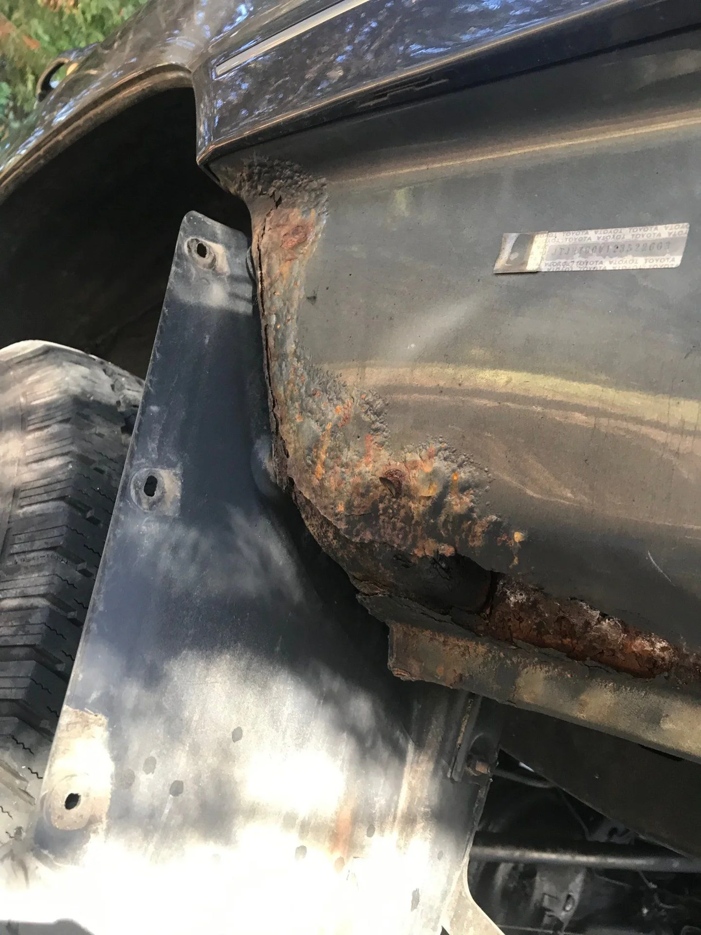

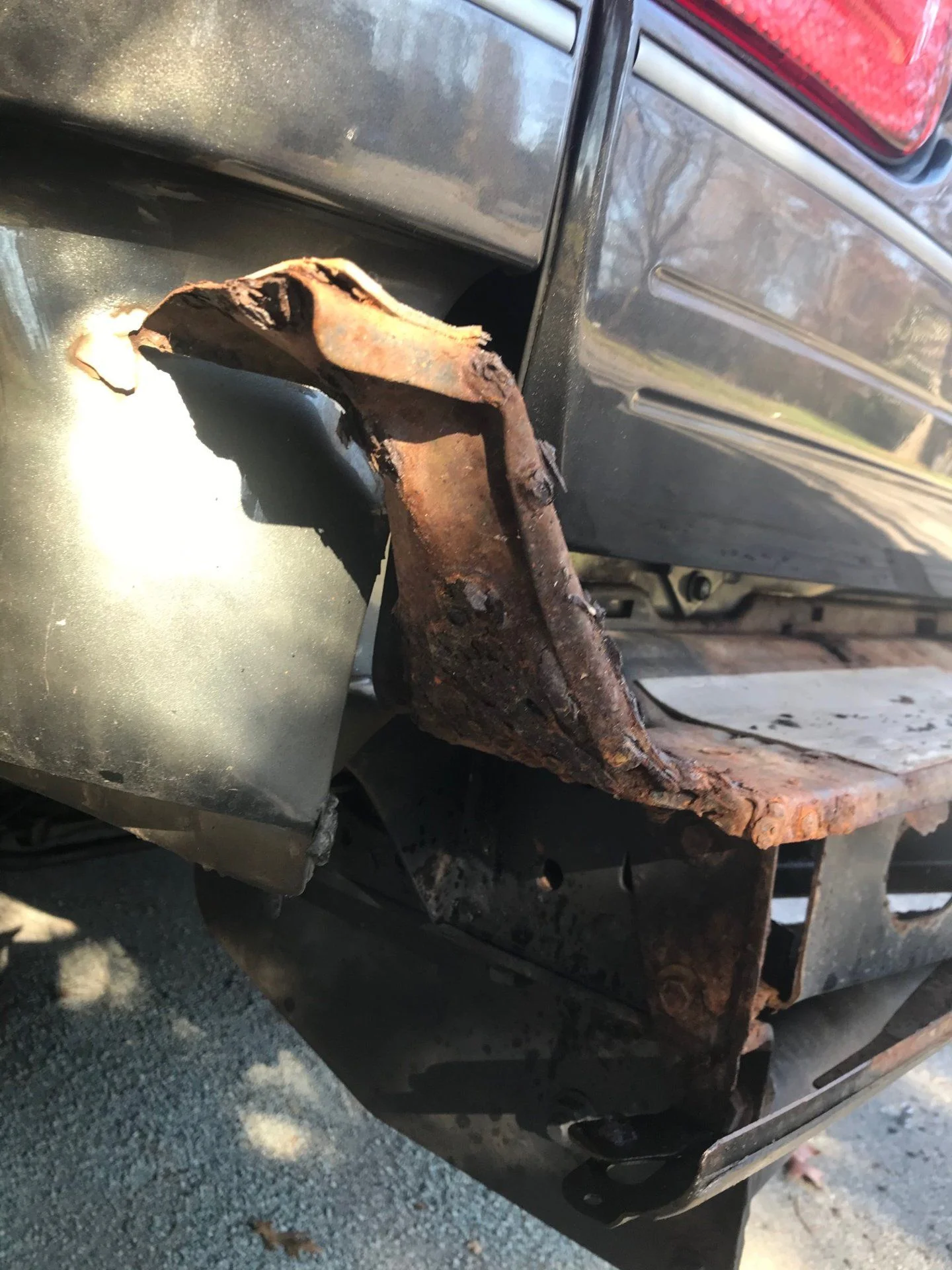

Pulled off the rear bumper cover to see what it looked like under that shiny plastic. FML.
Time for some welding lessons.

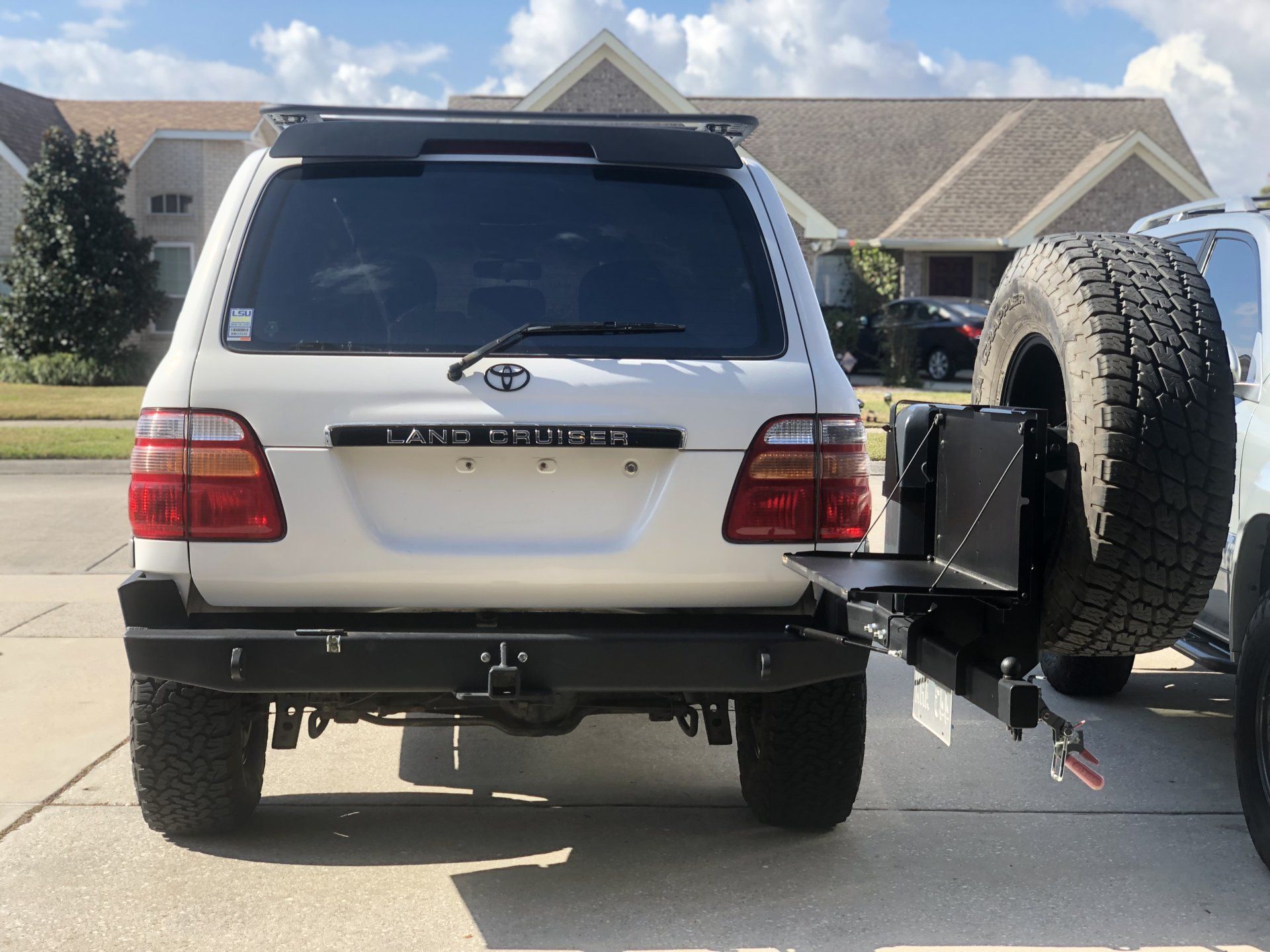

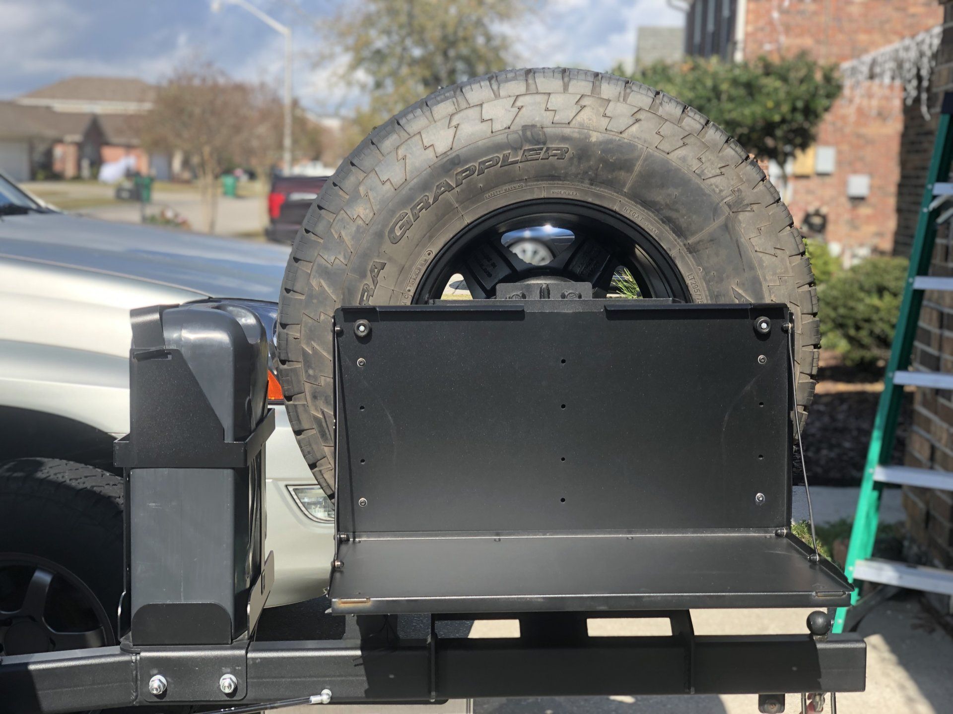

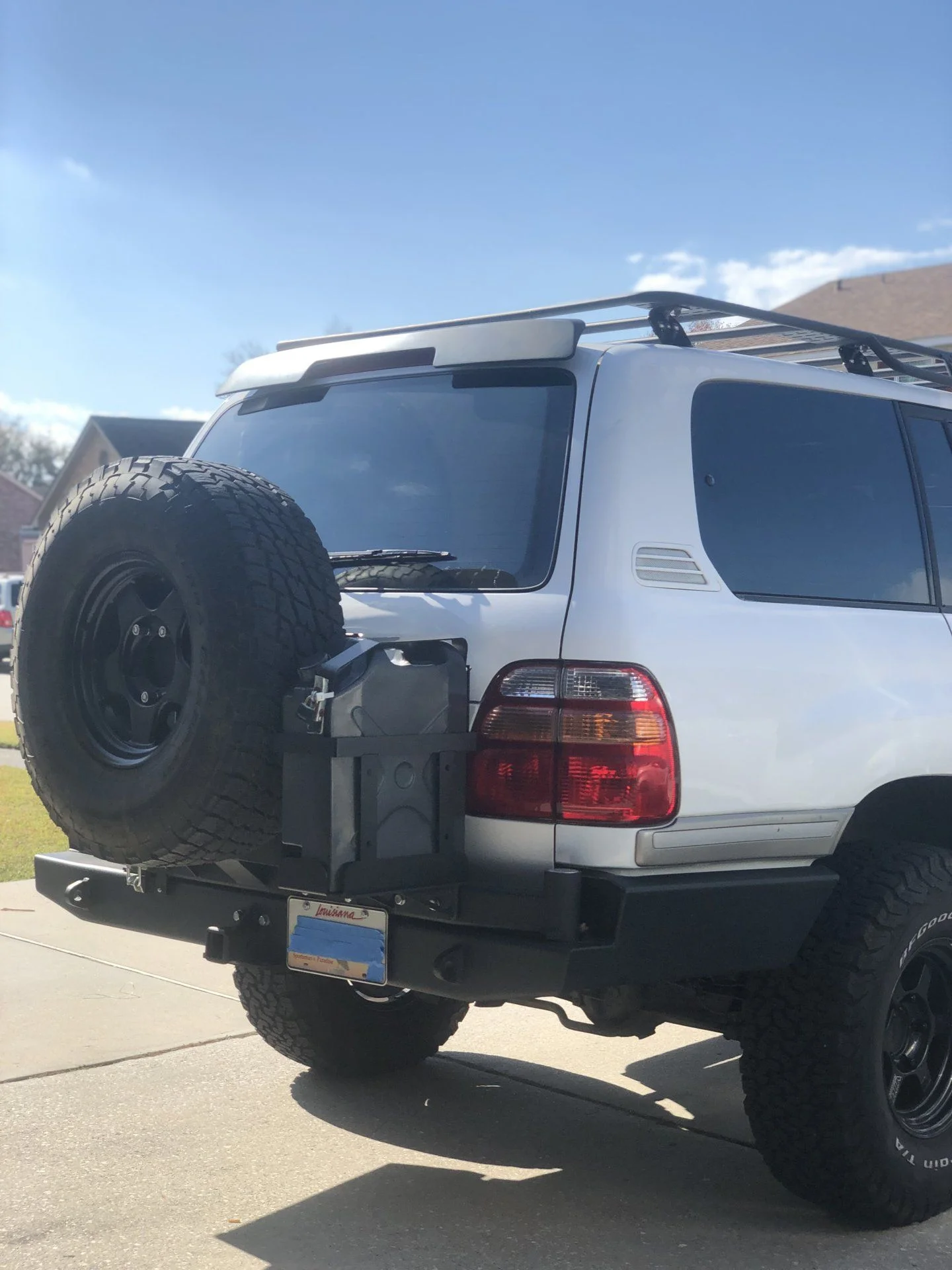

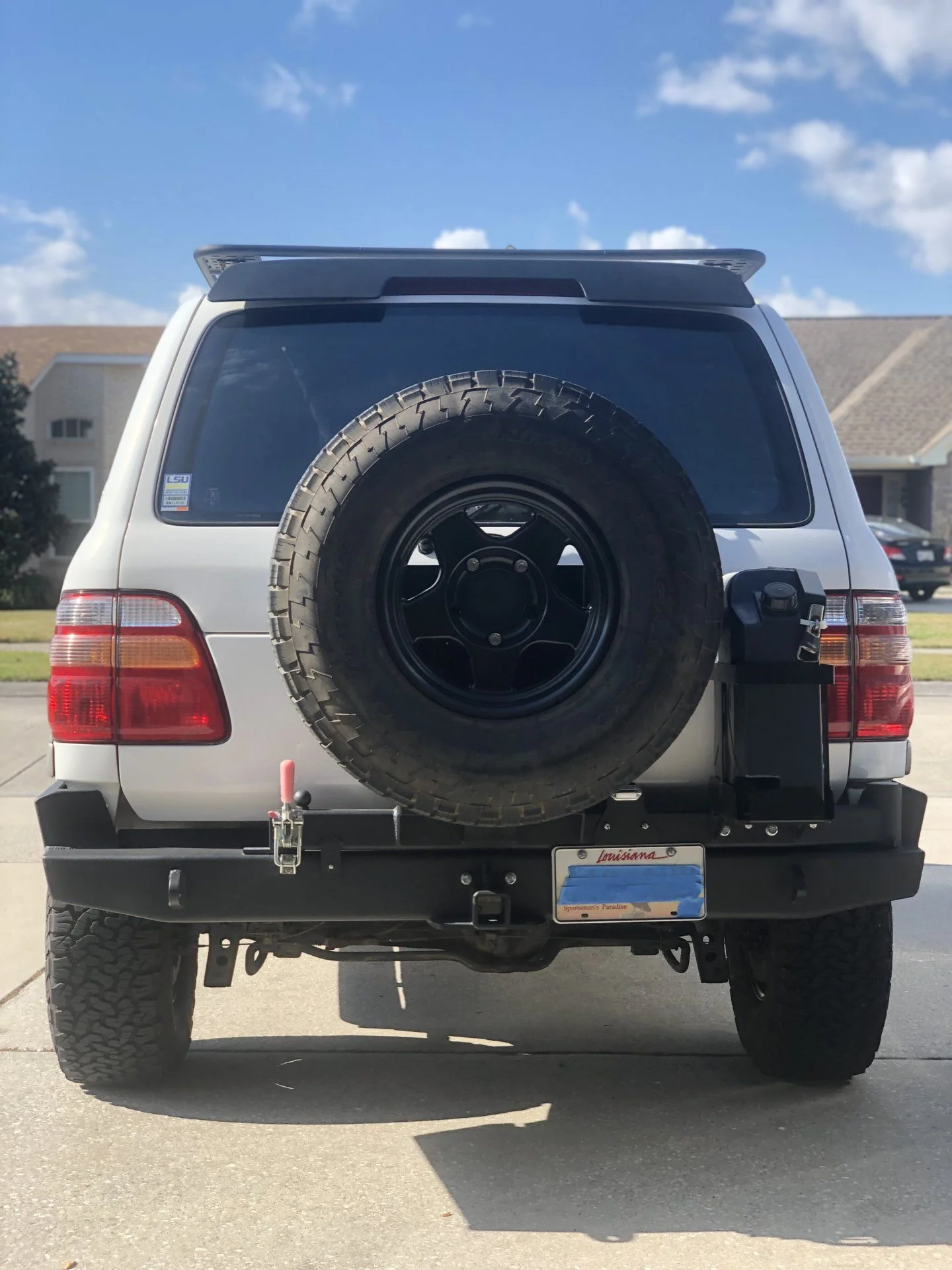

I had this BIOR tire carrier installed earlier this year but never posted a single picture. Big shout out to Mike at Bump it Off-Road for customizing this one. I think he’s the only fabricator that can customize a bumper to your liking for the 100 series. Center tire carrier with jerry can mount. He also added tabs on the back side of the spare tire mount for a front runner fold down table.
