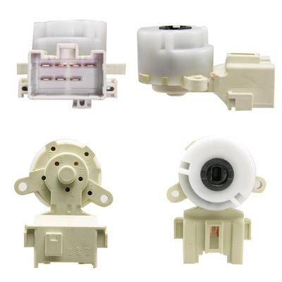

I'm seeing these plastic switches when I google, looks like this would be behind the key lock. I suspect this has the electronics, and maybe the detents for the different positions. It would be nice if this is it and not too hard to get to, but ignition switches are usually pretty well armored to protect from thieves.

Yes that is the switch that controls the power at various positions. The flat pointy device that is at the end of the the key barrel is probably is not working with the key.
This switch is NOT coded so any switch (most toyota's got the same) should work. Remove the battery negative terminal before you do anything. If you want to check what is bad, have the key in the ignition for the transponder to work and then remove the switch unit and with a flat head screwdriver you should be able to turn the switch into different positions manually. If you attach the ground back to the battery, you should be able to start the car just by turning the switch to start mode.
