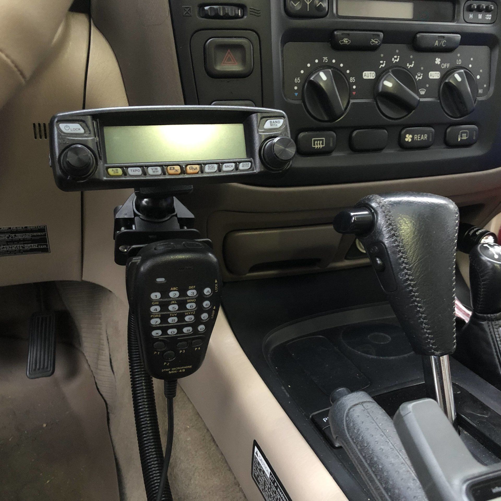

Finally getting around to mounting a YAESU FTM-100DR HAM radio in my rig. Decided to mount the controller and mic on a heavy duty flex arm seat bolt mount by Lido mounts.

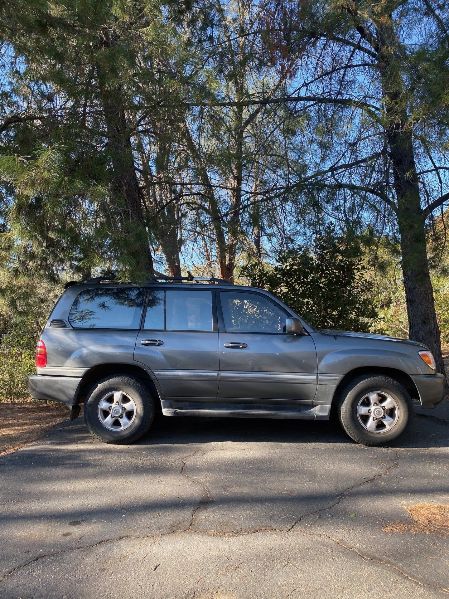

I was just given a 1999 LC with a few issues, plenty of dirty carpets, and past due maintenance, but, she is RUST FREE and now passes smog and runs, :clap: I have new tires and many maintenance items shipped from the Toyota factory and I'm waiting to install them! Besides baselining the LC mechanically what would you guys do to your rig first that is a nuisance fixer as I am new to this generation of LC?
I was going to say running boards gotta g—

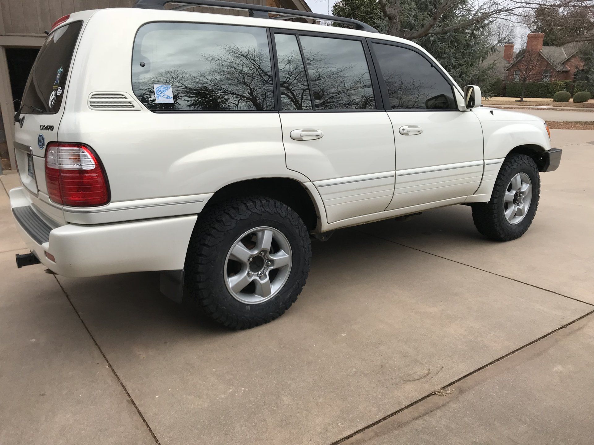

Finished the alternator and tensioner pulley job, then got some LC 18 in rims with 275/70/18 BFGs. Love the look

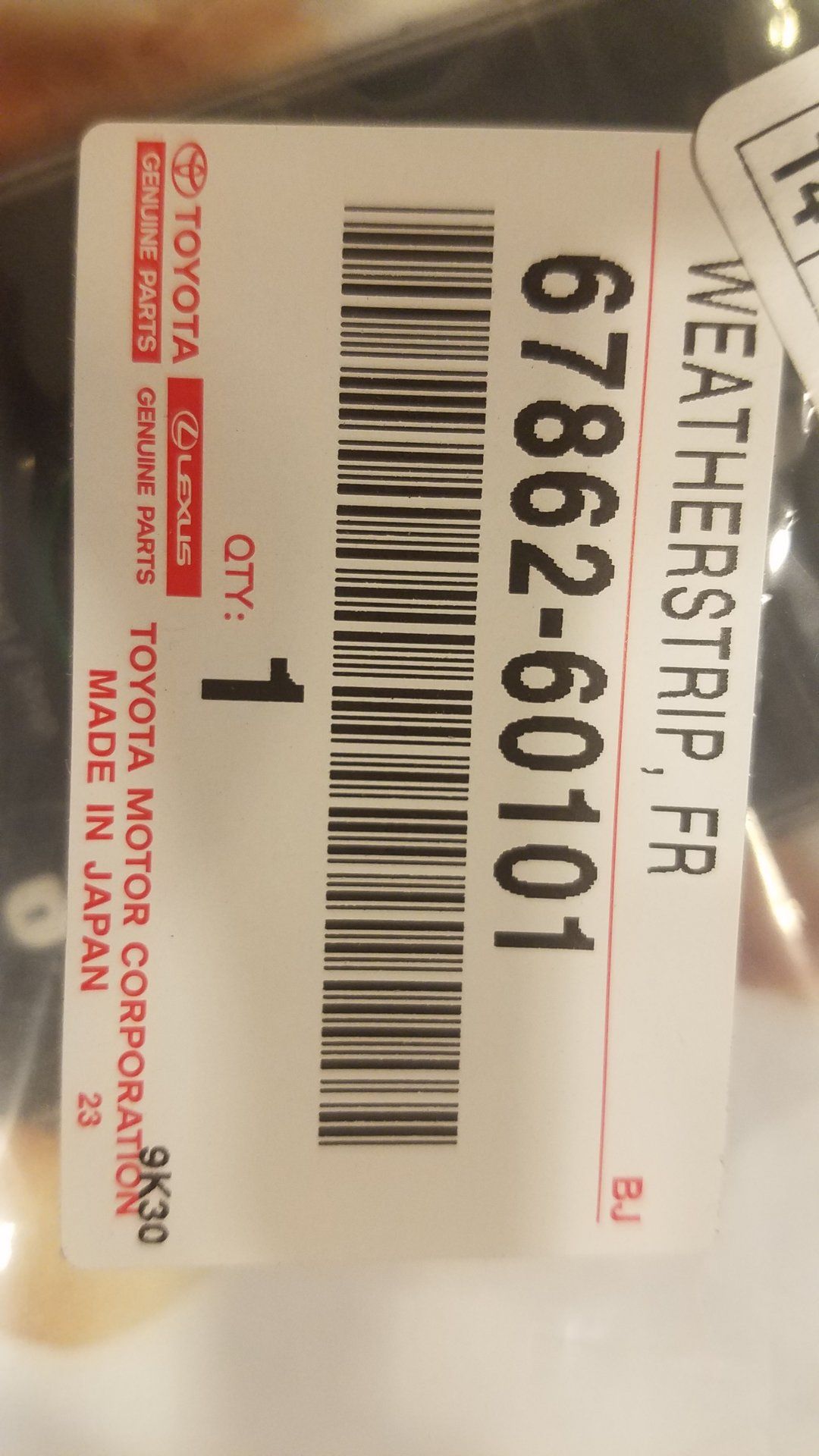

Picked up these door seals at the local Toyota dealership.
Part number and prices:
FRONT RIGHT: 67861-60101 ($57)
FRONT LEFT: 67862-60101 ($57)
REAR RIGHT: 67871-60080 ($65)
REAR LEFT: 67872-60080 ($65)
Also, picked a LC version of rear sway bar (mine still have the thinner LX version). Part # 48805-60060 for $135. But now I am having second thoughts about whether a slightly thicker sway bar going to be even noticeable? Should I just return it and save $135 for something else?

I need to do the driver's door seal, thanks for posting.
I've been wondering the same thing about the sway bars. Idk about you but mine doesn't really lean much anymore. Sure there's some, but with all of the control arms replaced with Jason's and the (mostly the same) TD system you've got, it's pretty tight.
Having said that, $135 for a sway bar is a hell of a lot cheaper than everything else 😄

I got these prices by asking the local dealership to match prices with what I see at McGeorge toyota online parts store. These are about 33% off the MSRP.
Once I replace the front uppers, the front lowers are the only ones, I would have original from 98. Those are kinda pricey at $290 a side.

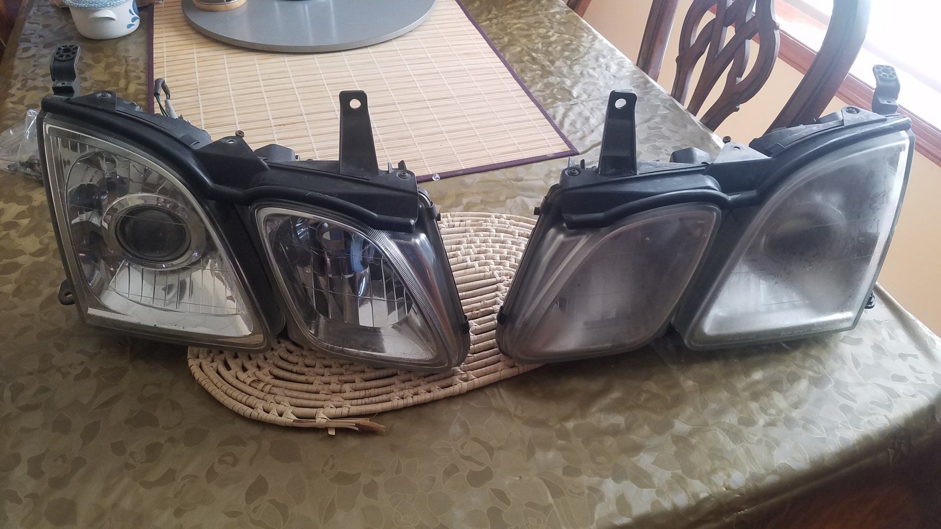

Since it is a balmy 10 degrees American today, I decide to pull the headlights in preparation for mini H1 projector upgrade. Stay tuned! Left lamp is still foggy because there is a 60 deg temp difference between outside and inside

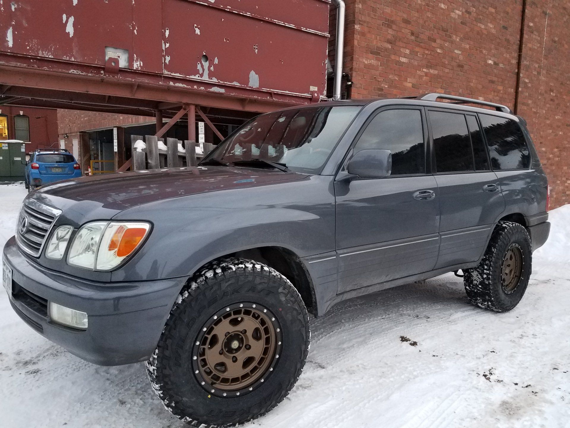

New Fifteen52 wheels with 285/70/17 Falken Wildpeak AT's. Just a little rubbing but nothing a little cutting couldn't fix.View attachment 2154899
Front diff and transfer case flush. Rear diff fill pug was stripped so waiting on a new one to flush the rear.
Very curious as to how they behave in snow and ice. I had a brand new set last year that was at best unimpressive in icy conditions.

Very nice 👌🏻 The bronze wheel color complimented the truck’s color very well. What’s the specs of those wheels?

Is your truck Galactic Gray? The bronze face, and wheel in general, look really good on it!
What did you have to cut? Pinch-weld plastic?
