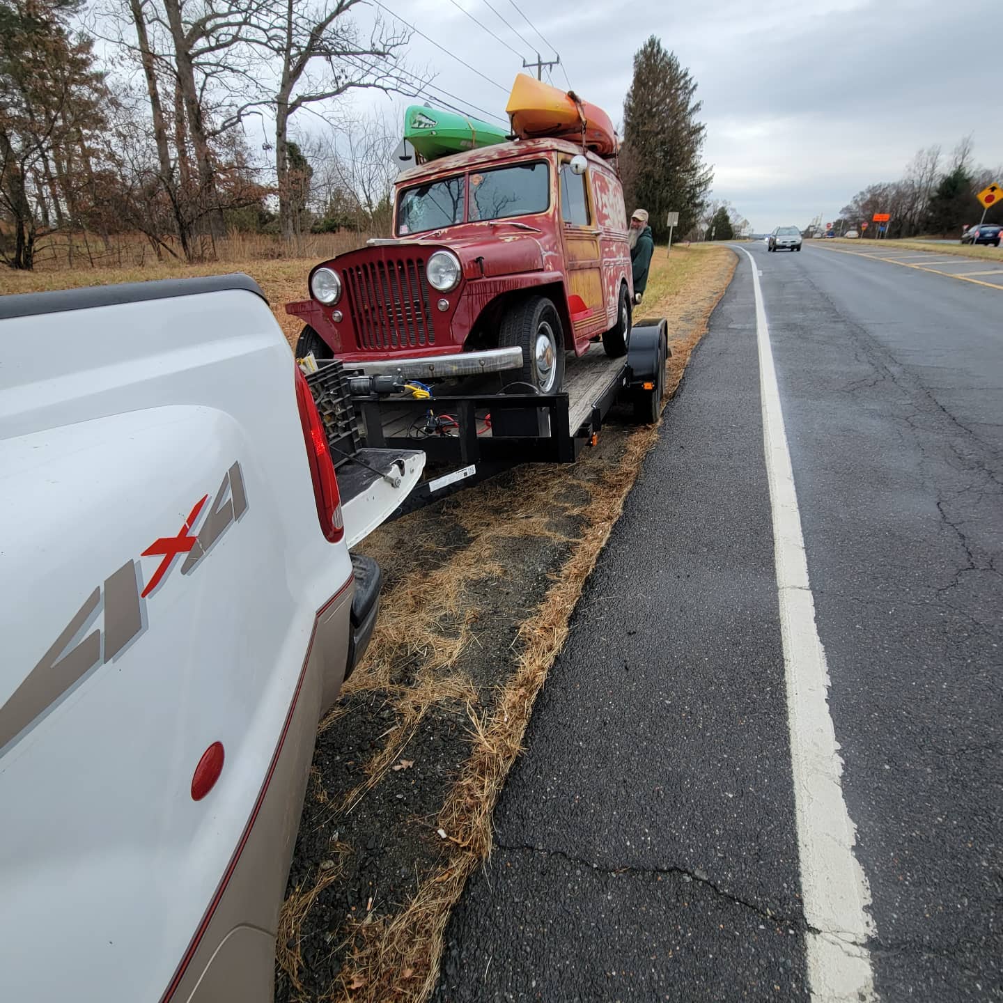

Or a good friend with a flatbed trailer with a winch on it....... I am one of those friends.... Throwing some chains on the trailer and heading your way!
I'm one of those friends as well.

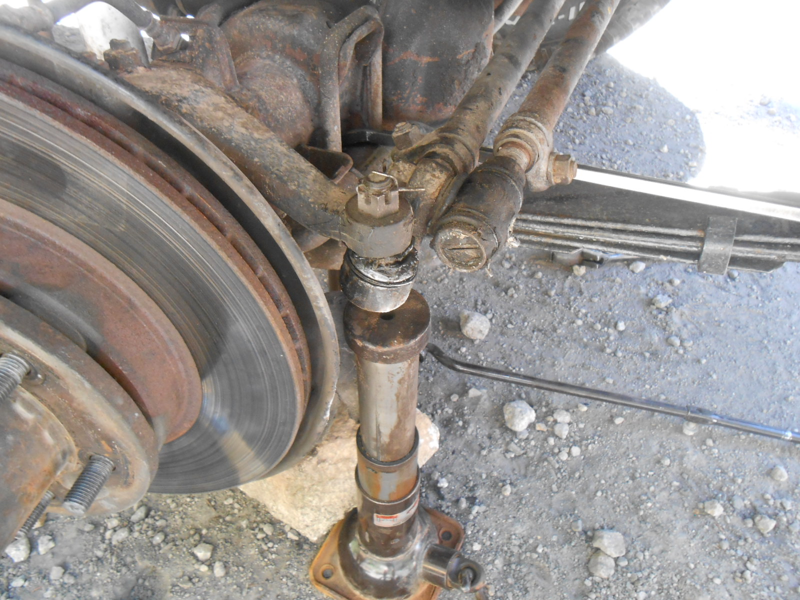

After a true four-wheeling breakdown (tie rod end popped off of my FJ62), I made SURE to add baling wire (soft steel wire) to all my kits - I had to borrow some wire from a passerby on an ATV. I jacked the tie rod back together with a 2nd bottle jack, and then applied a great deal of wire. Got my daughter and I through the entire trip and all the way home.
